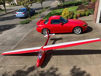

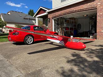

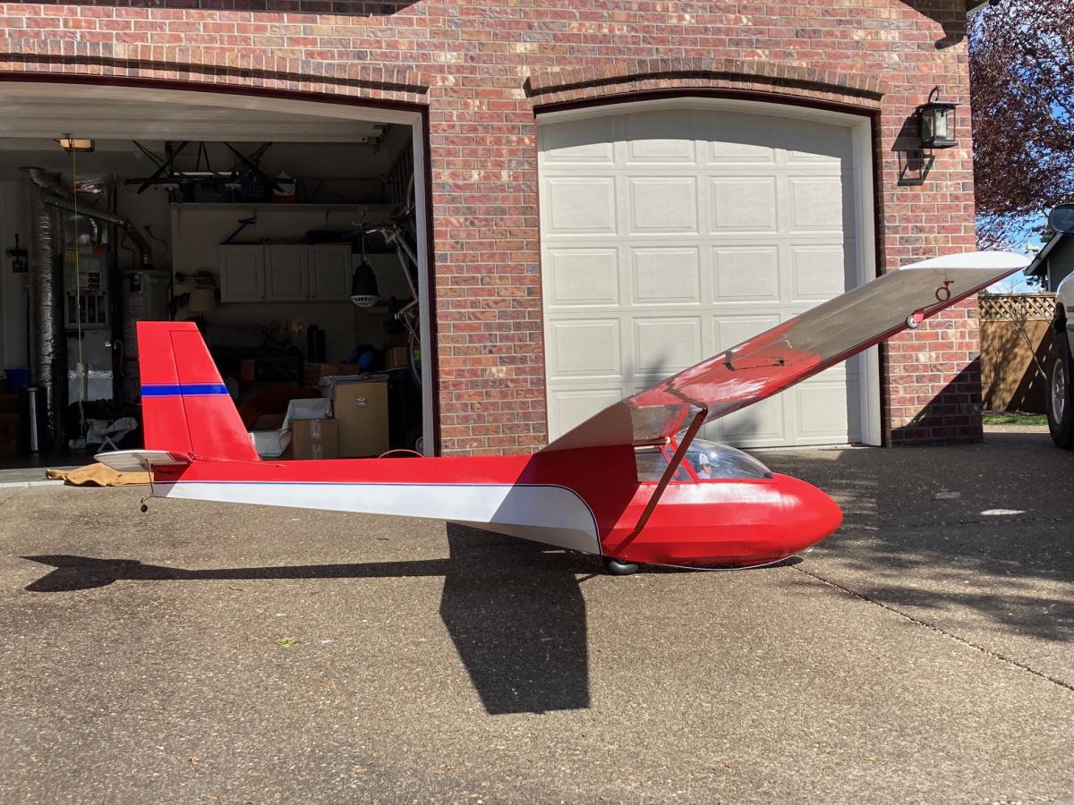

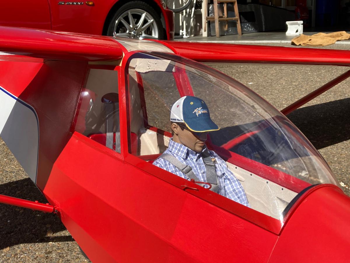

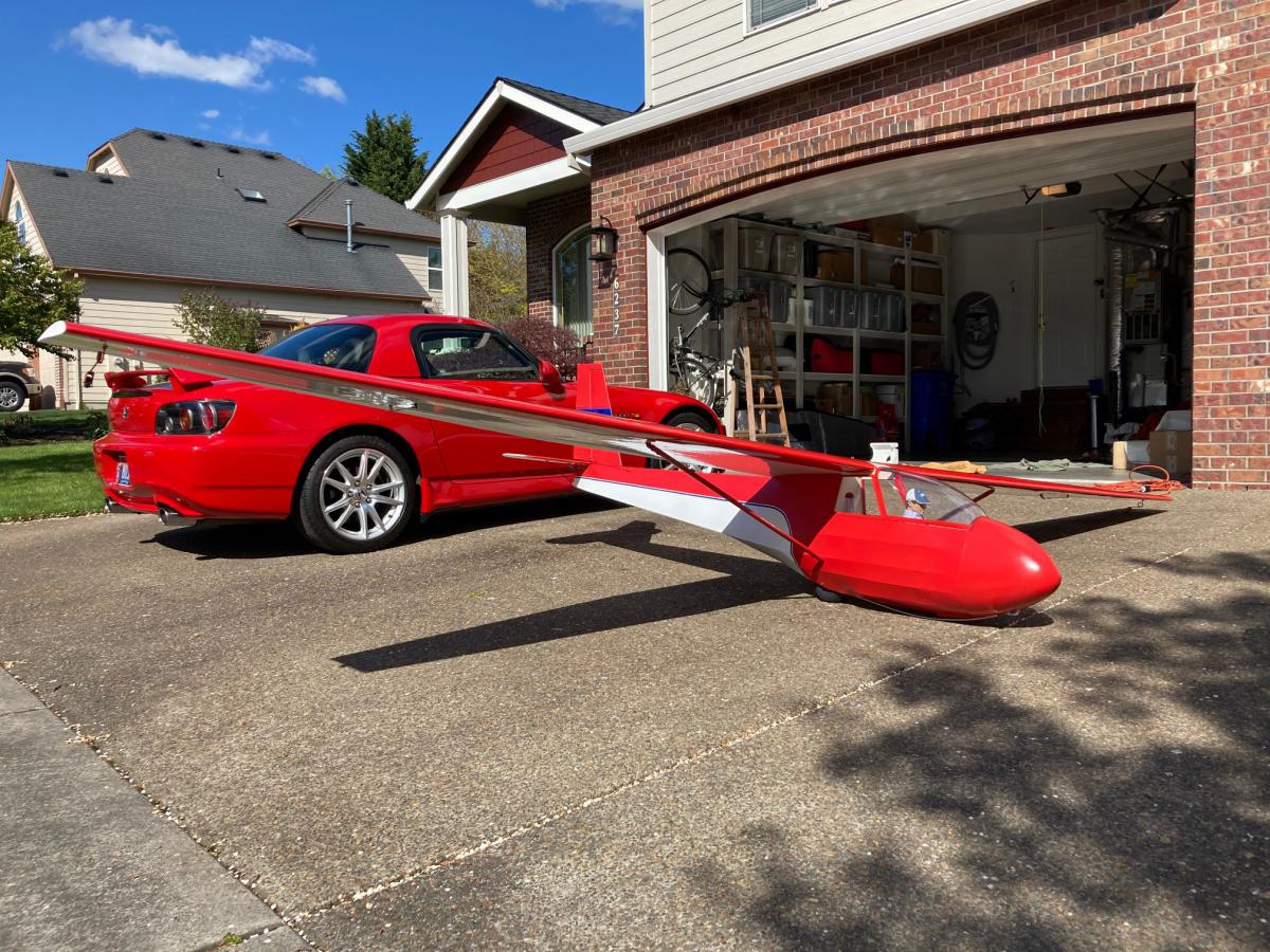

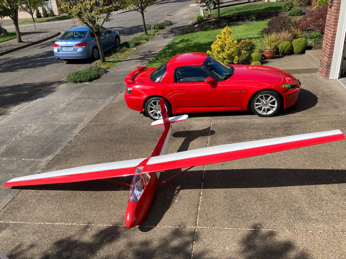

    We finally got a break from our snowy, cold and wet springtime(?) weather for me to do some final setup on the 2-33. I rechecked the CG after adding my 10oz of nose weight and I'm almost right on the center of the CG range. Hopefully I can take some weight out after I get some air time. Also, I bought myself a fishing scale and the AUW turns out to be 26lbs 10oz. Not too bad as Gunny states in the instructions that the prototype ended up at 27lbs. It also was a good time to set up all the control throws and finish the programming on my DX18. I am really impressed with the dive brake operation.

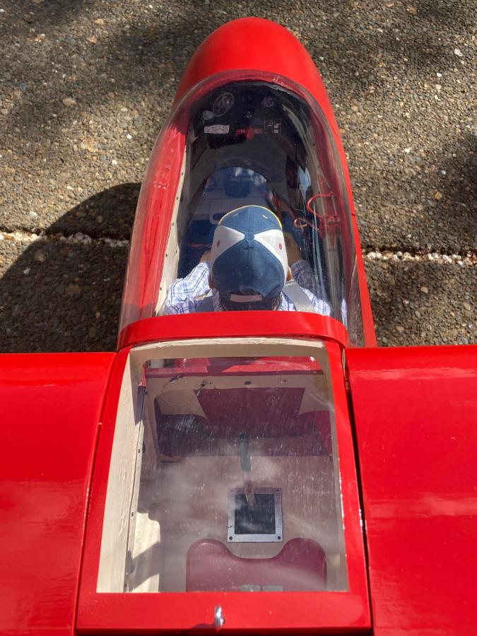

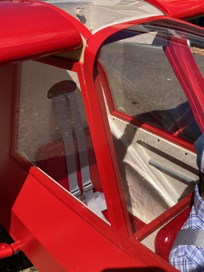

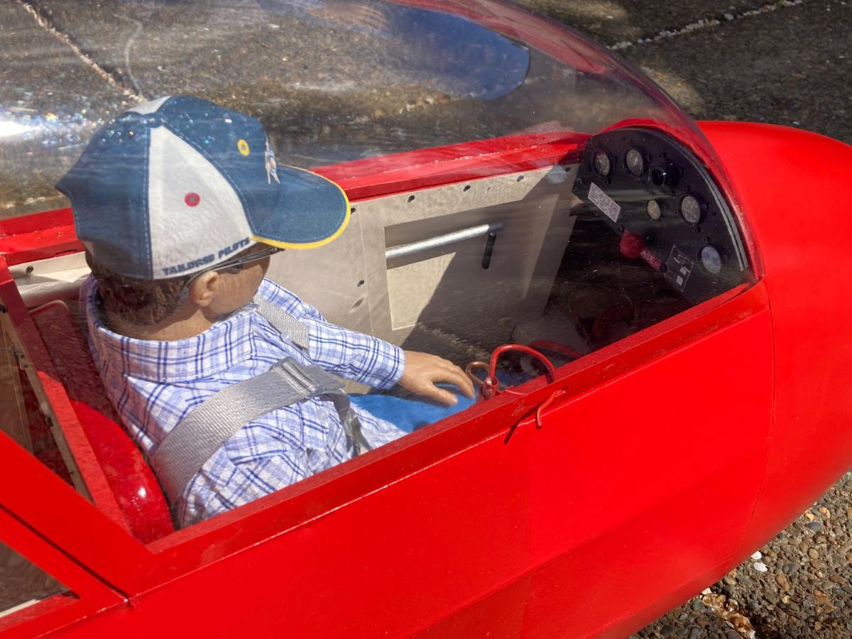

    I also did the final install of the cockpit interior that I had purchased with the kit. I'm glad I did as this cockpit is so massive it really needed some finishing details. The cockpit interior kit supplied by Aviation Concepts is very complete with detailed instructions(of course). I believe I received one of the early kits in that the 3/8" balsa seats were laser cut and there was quite a bit of burnout. Fortunately, a little sanding and filler solved that issue. I wanted to firm up the seats and that was accomplished with 0.5 oz fiberglass cloth and thinned laminating epoxy. Finish colors were applied with Klasskote epoxy paint. The pilot is from Tailored Pilots and is their 1/3 scale civilian pilot.

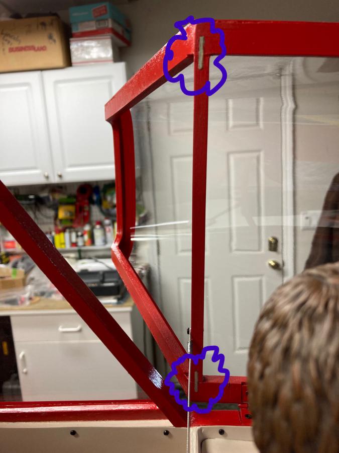

    After attaching the canopy restraint wire I quickly found that the canopy cross piece that it attaches to came loose. I'll have to add some reinforcement to the joints as a glue joint by itself is not sufficient. I'll post a few pictures of my repair, but in the meantime here's a few more photos of the big gal!!!.......................

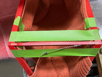

      A little canopy repair was in order as I quickly found that the glue joints failed for the cross piece that one end of the canopy restraint wire attaches to. A little CA stabilized the brace while I carefully routed a couple of narrow slots 1/2" long and approximately 3/16" deep. I've got some thin G10 fiberglass that I cut to fit the slots and glued in place using epoxy with some milled fiberglass mixed in for good measure. This stiffened the area substantially. I'm used to applying thickened epoxy fillets to wood canopy joints during construction, but totally overlook the stress that the large canopy restraint wire would impart on the cross brace. Simple fix.....here's a couple of photos.....
      Jim

        My 2-33 is ready to fly and I've got a couple of questions I would like some input on:
        1. I'm finding it is a bit of a beast to carry fully assembled. I'm considering getting a wing wheel like the photo below and a leash to move the 2-33 around at the field. What do you think? How do you handle it?
        2. In Gunny's instructions he notes that his takeoff mode has 7/16" down elevator mixed in as the 2-33 wants to get high on tow. I'm thinking of accomplishing the same using a slider on my xmtr so I can dial in the amount required. Comments?

          Past time for an update. It flies! I was able to get some airtime on the 2-33 in August at the Agassiz, BC and Scio, OR aerotows. It pretty much flew right off the board with little or no trim changes and the CG as noted by Gunny on the plans/instructions looked to be right on for my flying style. It thermals great and is a gentle giant in the air. The top and bottom dive brakes are very effective and did not require any elevator compensation. This is definitely a keeper in my scale fleet and will be getting a lot more flying time next summer. Below are a couple of short videos at Agassiz of takeoff and landing.
