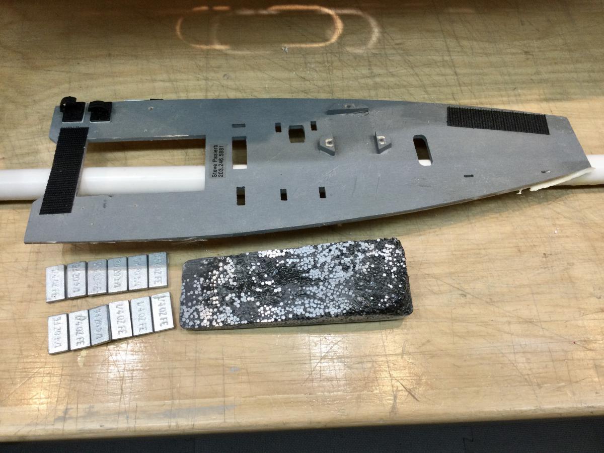

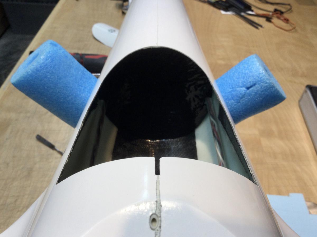

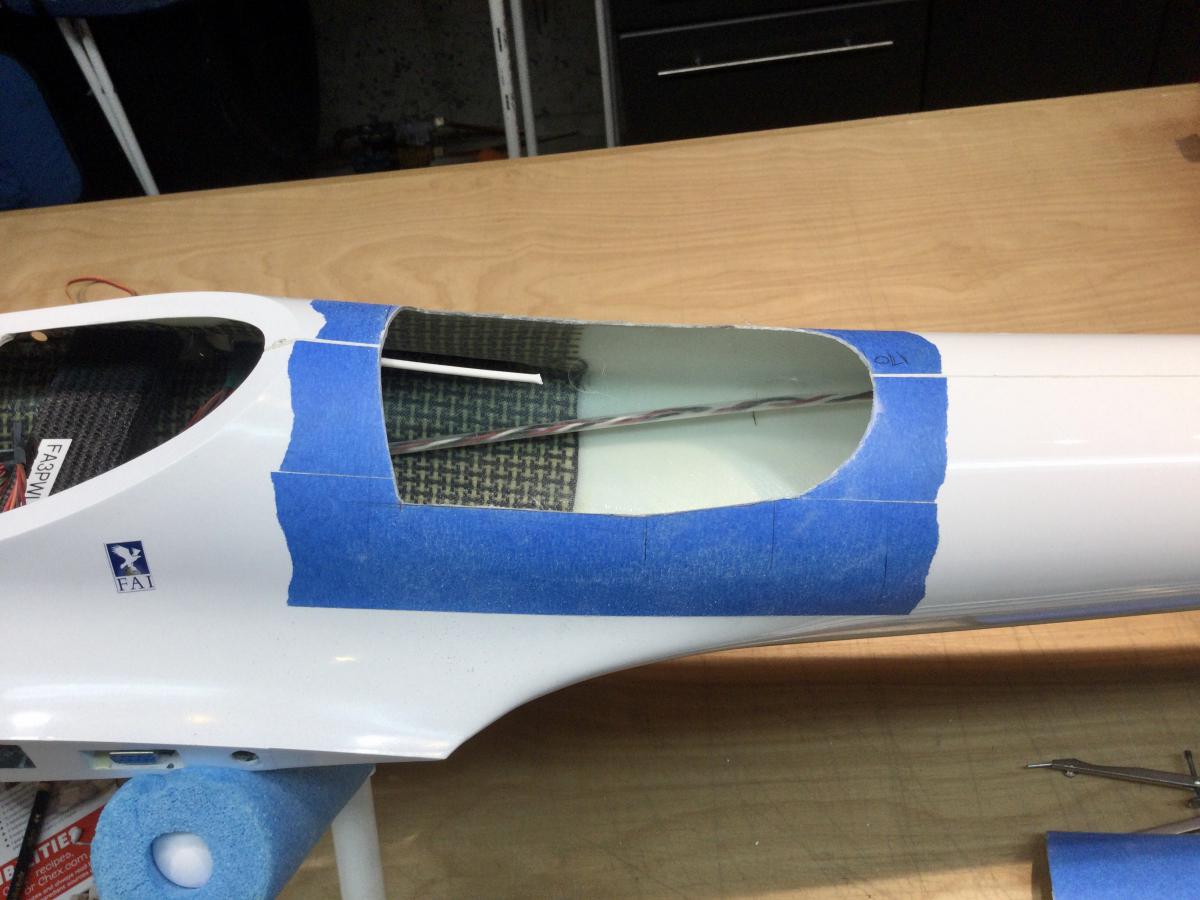

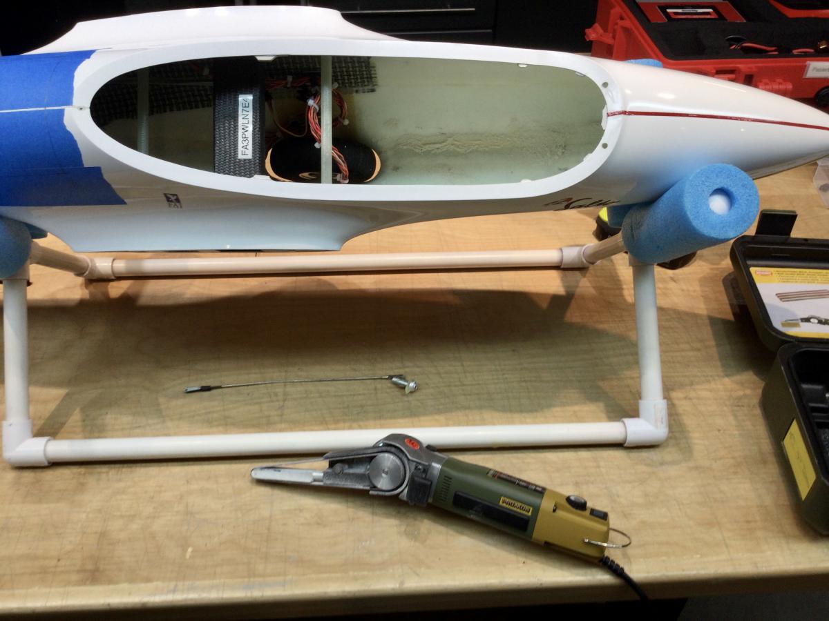

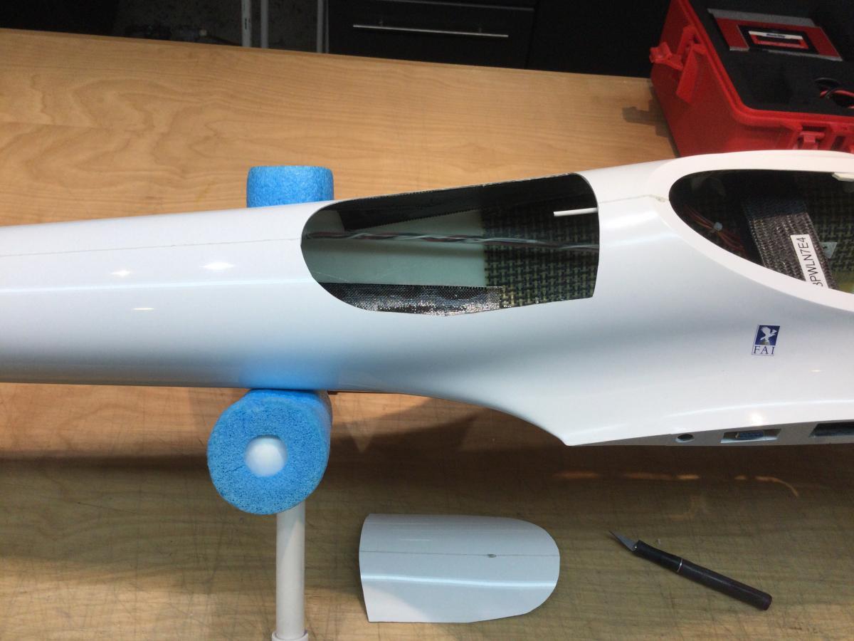

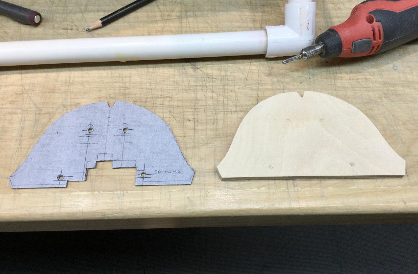

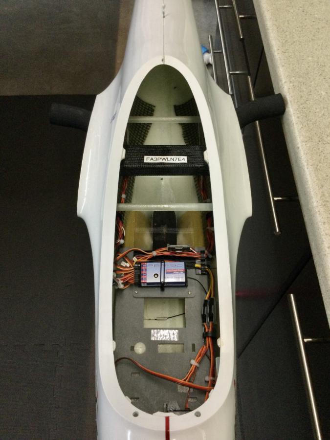

While some scale purists do not like the extended wing on the Valenta Salto, I can say for certain that if flies amazingly well. This thread is an add on to my original -- https://forum.scalesoaring.com/forum...tanced-version

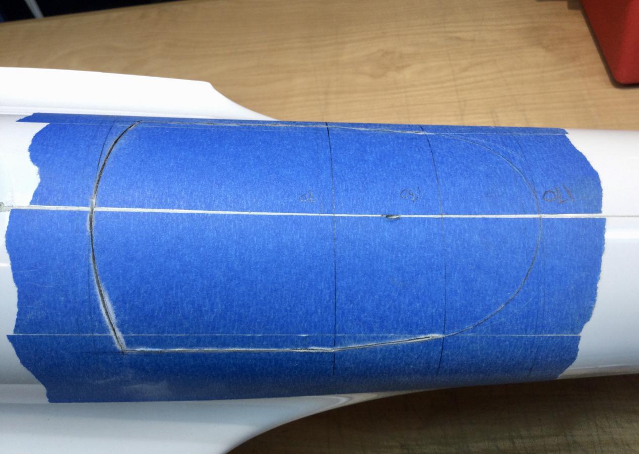

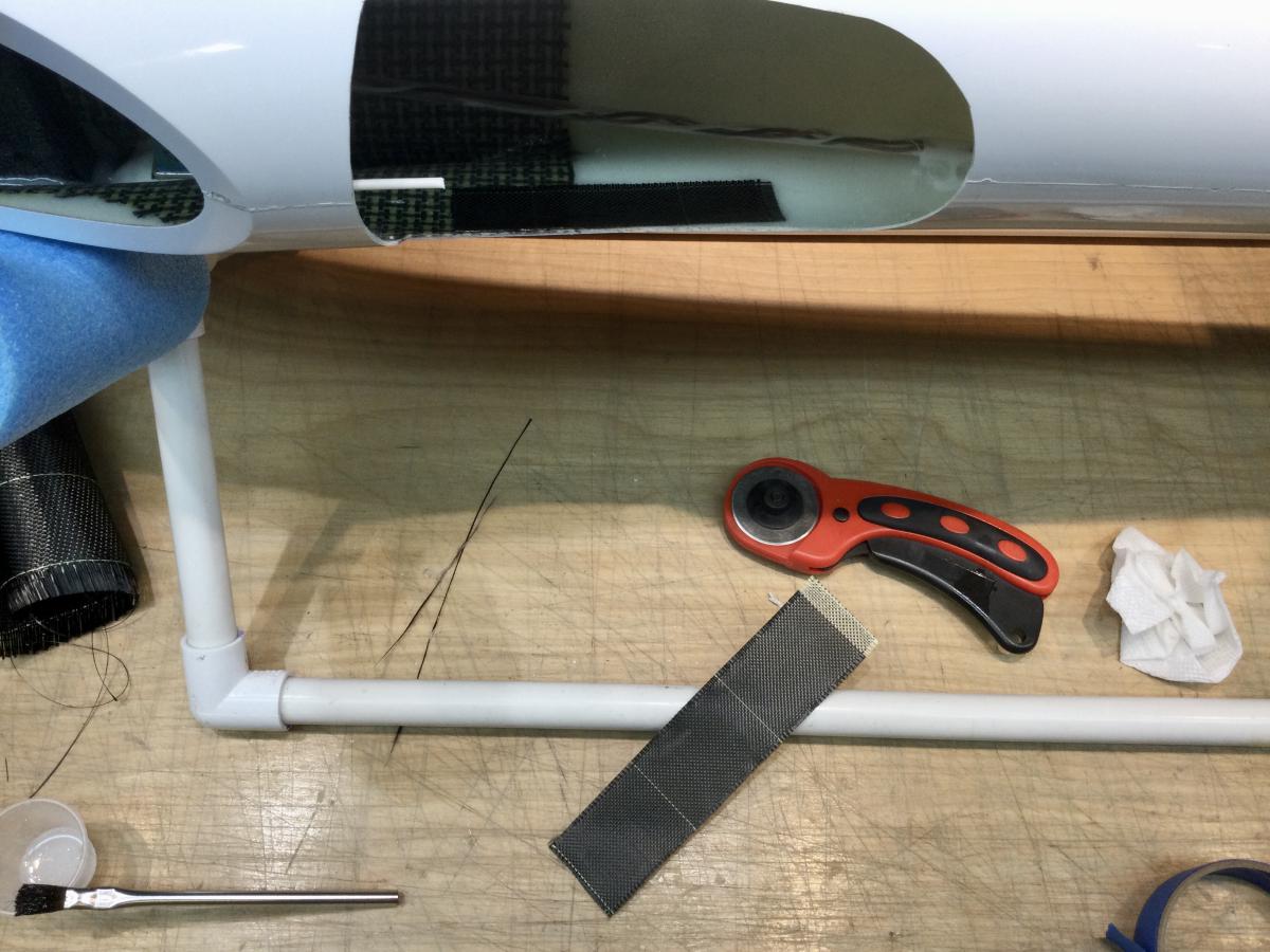

I needed a project and have come to love flying my EMS Arcus with a 12S EDF. So, time to cut a hole in a perfectly good sailplane!
Valenta Salto
4.5 meter span
HQ 2,5/12 airfoil

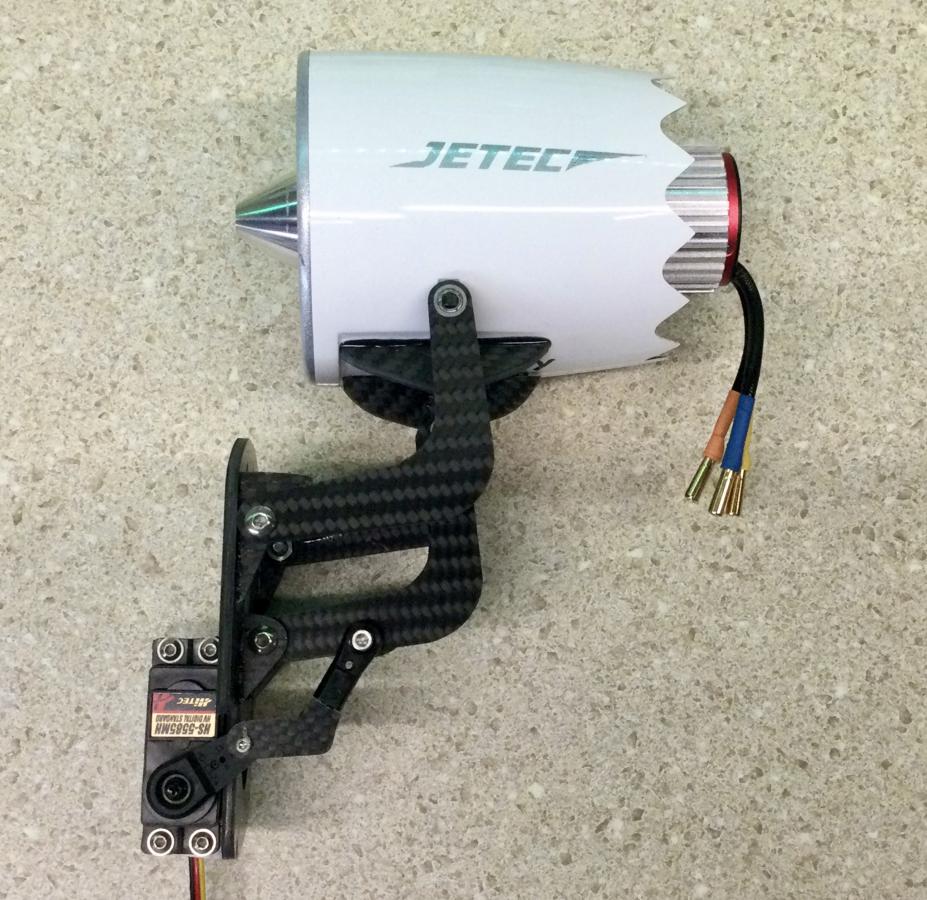

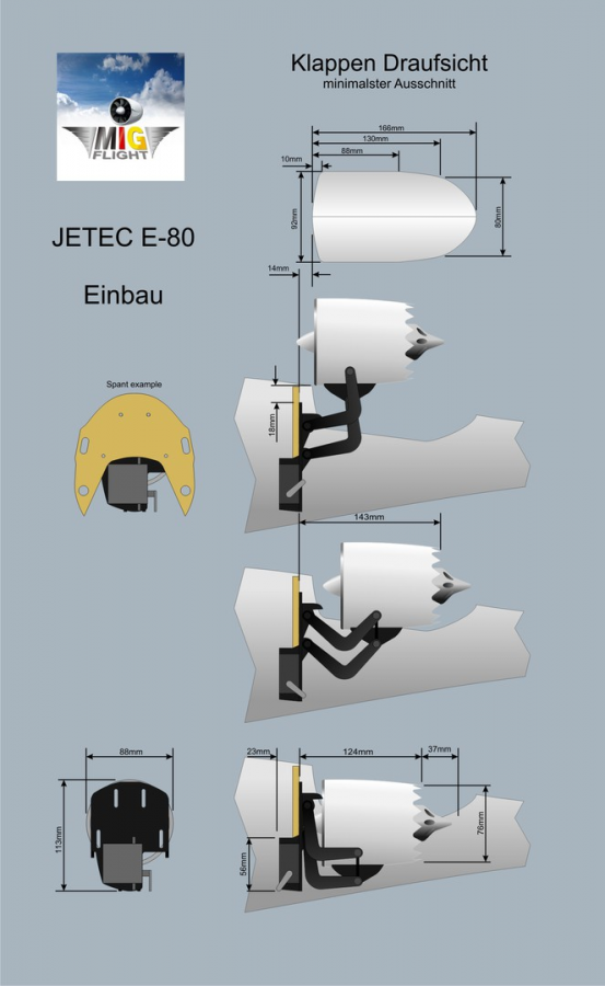

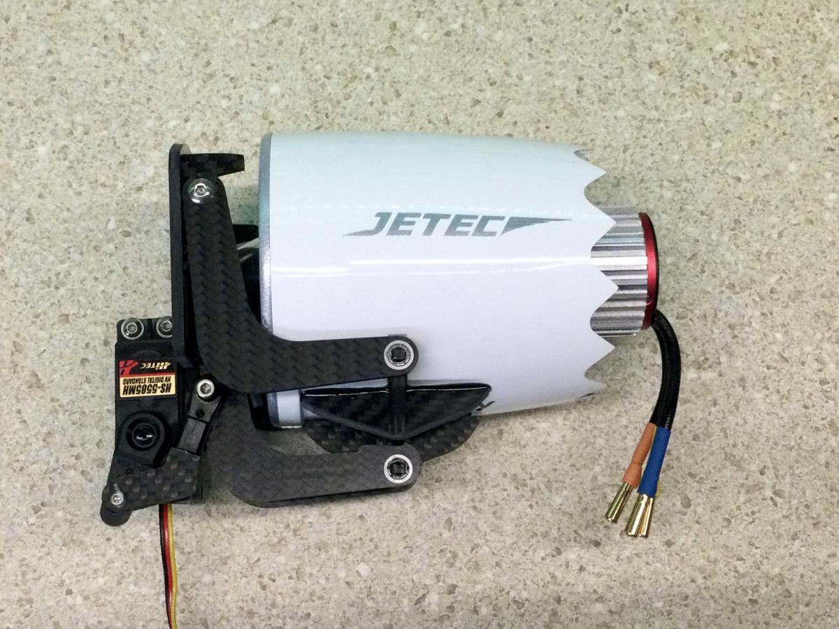

Mig Flight JETEC E-80
Leo 2.5Y motor for 8-10S

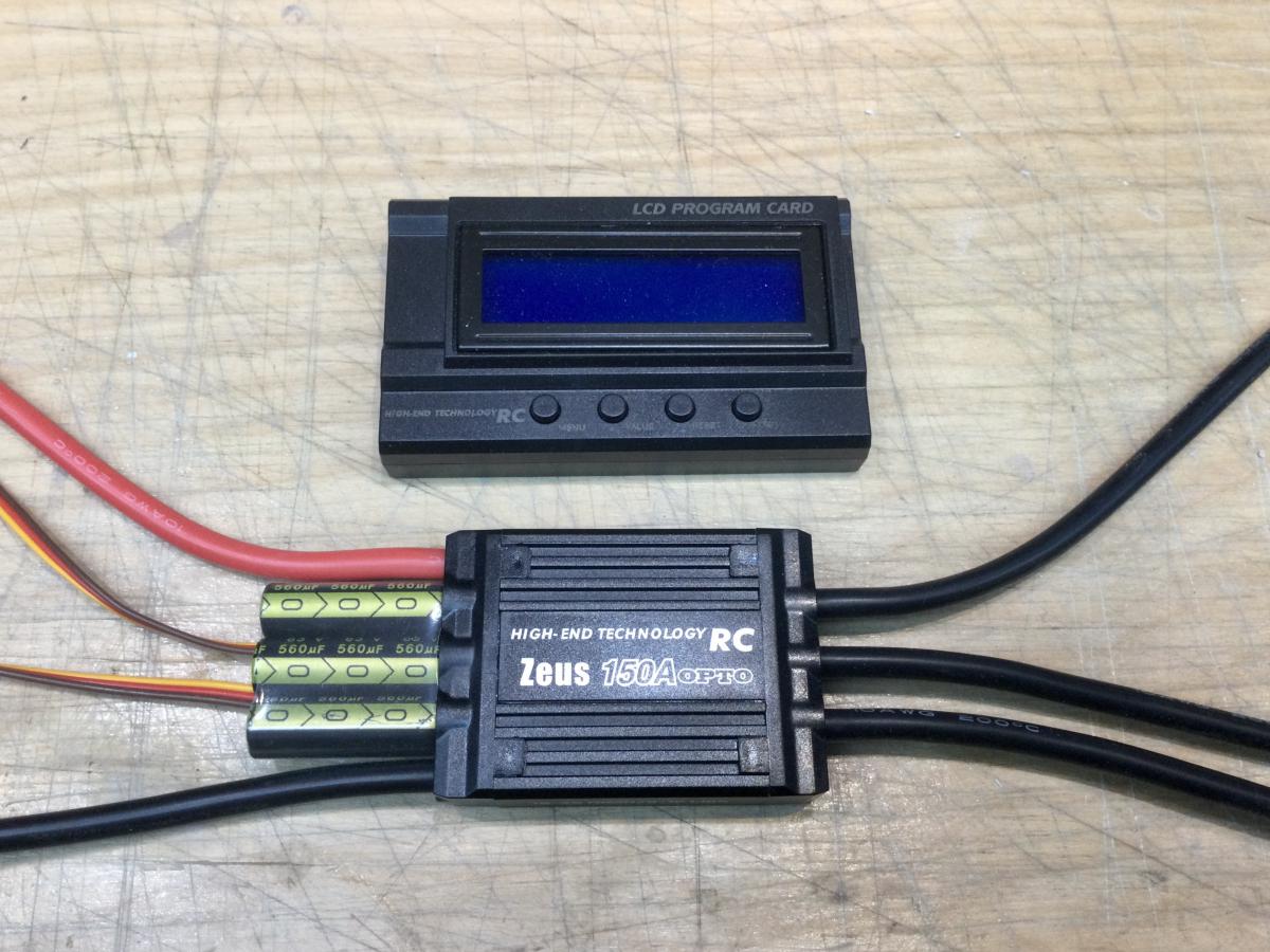

HET Zeus 150A OPTO HV ESC
2 packs 5S 4000, 65C for 10S power
Projected 130 Amp draw
My main concern is that this sailplane has proven to be a joy flying the slope lift at Cumberland. Adding all this weight may not make it a candidate for the evening smooth air, but what the heck.

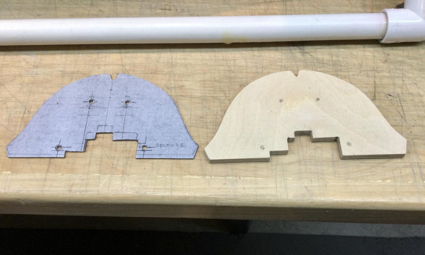

Time to make a mess...
