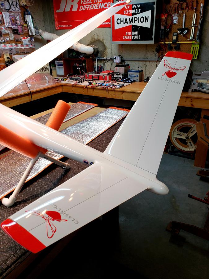

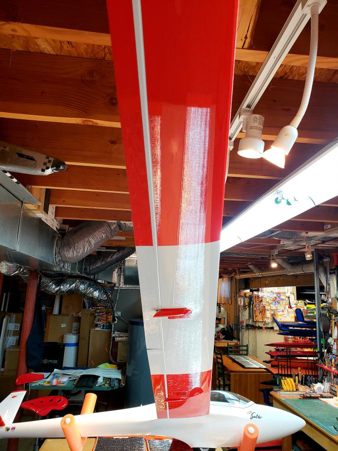

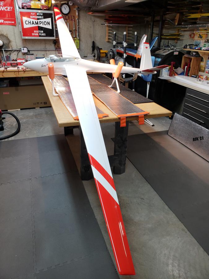

    Instead, I took some time to neaten up and dress out this 4.5 meter Salto that came my way thanks to Wil Byers. The airfoil is a HQW 2.5/12 and while modeled at 1:4 scale, it really isn't as the wings are stretched a bit. Regardless, I thought (and think) it will be a blast on the big slope.
    Yesterday and today I spent a couple hours in the shop and many more in the garden. At least spring is upon us here in CT.
    I really like this sailplane, the huge carbon joiner, and how nicely the parts all fit.

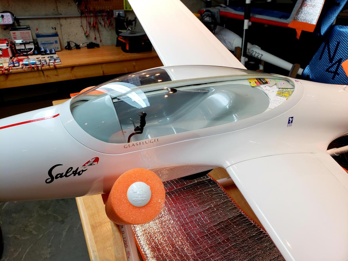

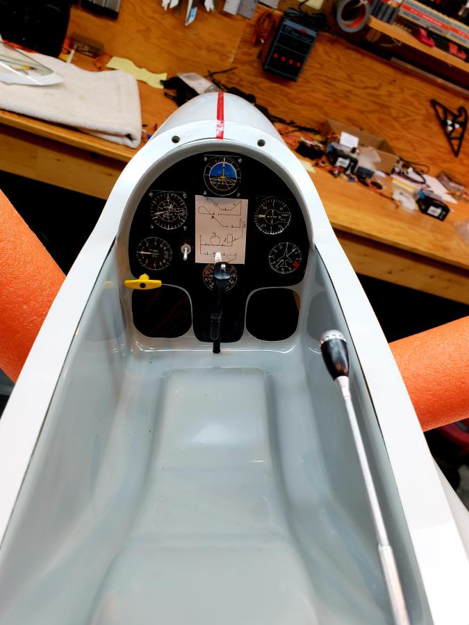

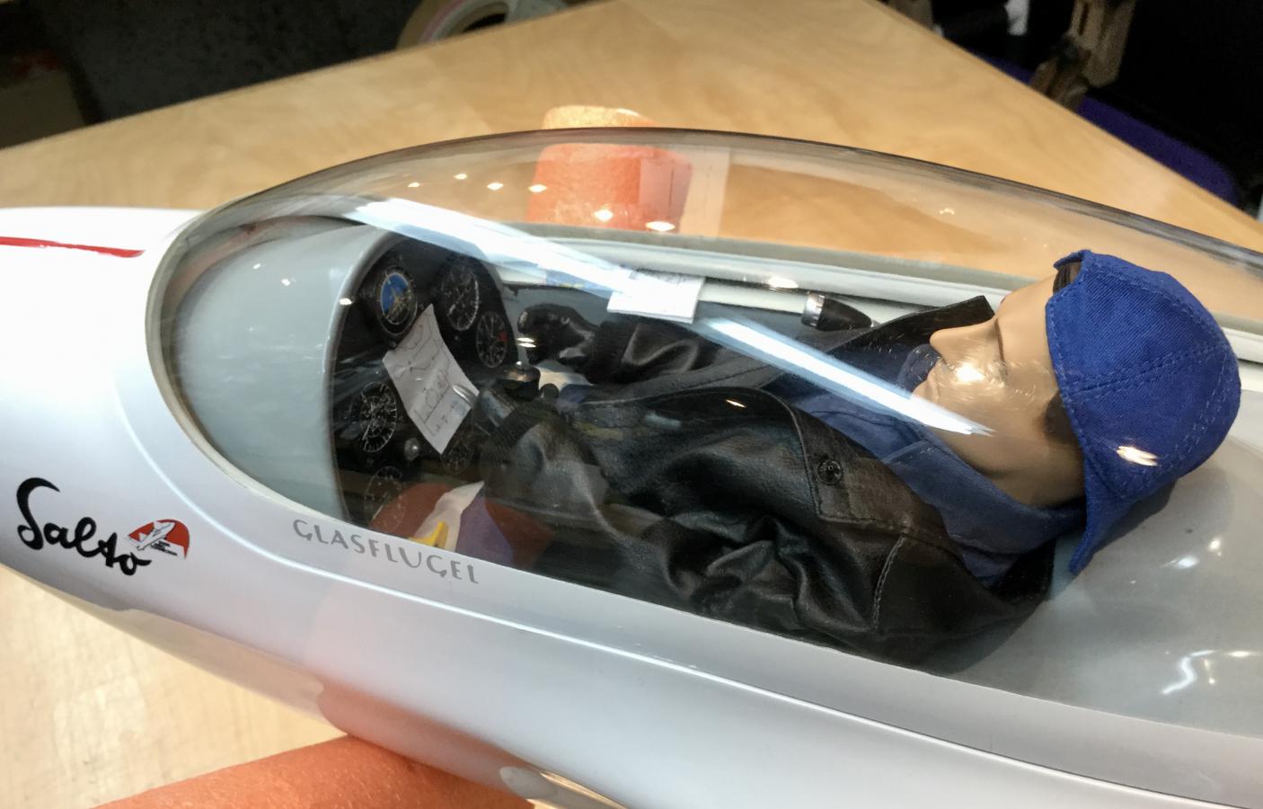

    The plain gray cockpit pan was perfectly fine, but I decided to root through the parts bin and found various instruments -- power, jet and sailplane -- to add (oil pressure anyone?). A stick, tow release handle and microphone add to the illusion. A few Glasflugel graphics. Eventually I will stitch a seat cover and make a headrest.
    The 1:4 Axel pilots I have in storage are way too big to fit. I need to find one of the Hangar 9 1:4 pilots that came with their J3 Cub. Anyone?
    I added 1/4-20 metal inserts into the wing roots that mate with nylon bolts from inside the fuselage to retain the wings. Tape will still be used to make doubly certain all stays together.
    All eight servo covers were re-done and the entire plane got a coat of wax.

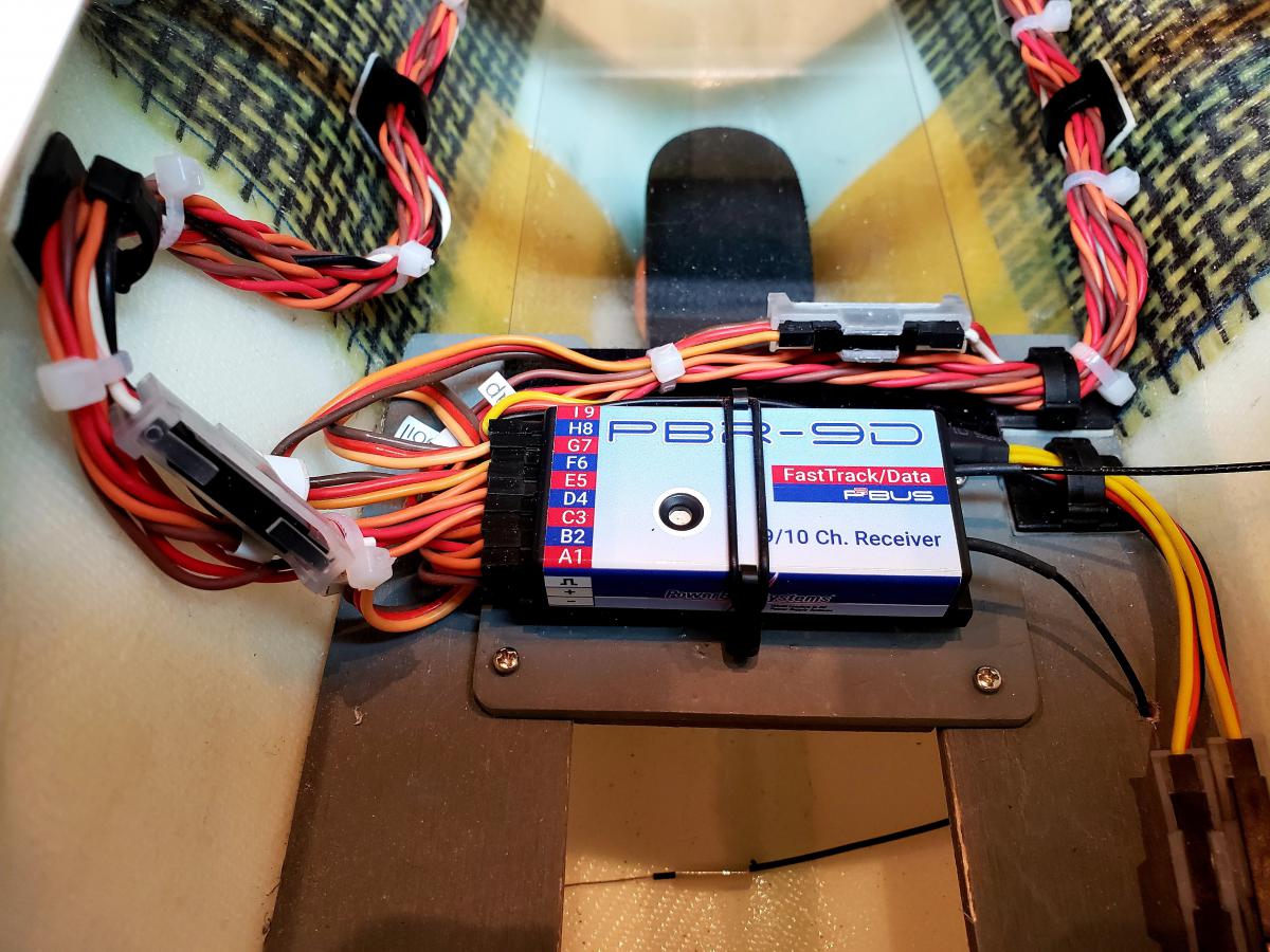

    Moving inside, a bit of wire bundling and re-routing (resisted my usual anal-retentive braided wire wrap) and added a single wheel fender by extending a sheet of thick PETG off the back of the tray. A 9 ch receiver and a 3600 2S LiPo finish out the update.

        Thanks so much, Gunny. I had forgotten about Adam! I sent him an email last night and we landed on the 1:5 scale version. The shoulder width of the 1:4 is 3/8" too wide, so he'd be crammed in there and way too long. We shall see...

        The Hanger 9 pilot for their 1/4 sale cub that they used to sell was fifth scale'ish and that's what Adam has. It will look ok because I had used these in NoBS Batteries (Steves) 1/4 scale 2-33, the blue and yellow one.

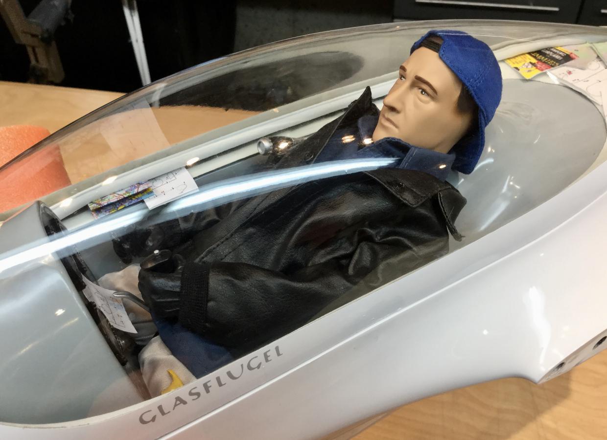

      A bit of learning to share. Adam at warbirdpilots hooked me up with a 1:5 and a 1:4.5-1:4 civilian pilot. The latter is a perfect fit, the former a bit too small.
      Now the Salto is really ready to go — whenever that is.

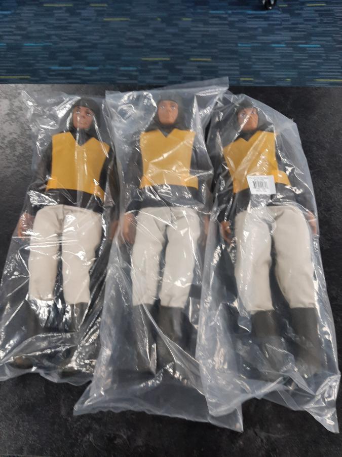

        If anyone would like the 1:5 pilot, it is still in the package unopened -- with hat, headset/microphone and sunglasses. I am about to send him back to Adam for a refund, but can easily send to anyone here. $85 shipped CONUS so you'll save $11.25
