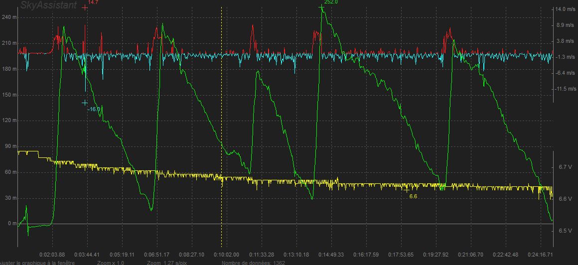

              Tried the sailplane again today, not a great weather but enough to gather data
              motor 90 size Kv420 with 2x4S 5000mA prop 13x8
              drainer 1800mA for 2min30s could go as much a 5 min run time or 10 climbs...
              rate of climb is 7m/s or 23ft/s
              happy of the performance with the steel joiner, should even be better with the carbon joiner...
