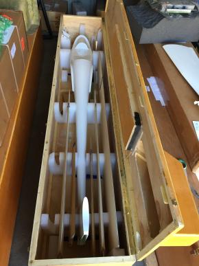

    First order of business was to build a storage box to protect it from the hanger rash gremlins that so often infest my garage (and Van)

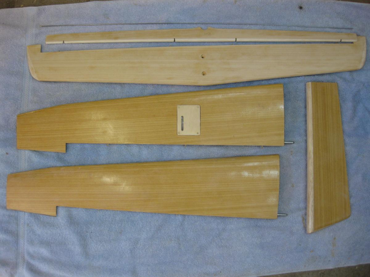

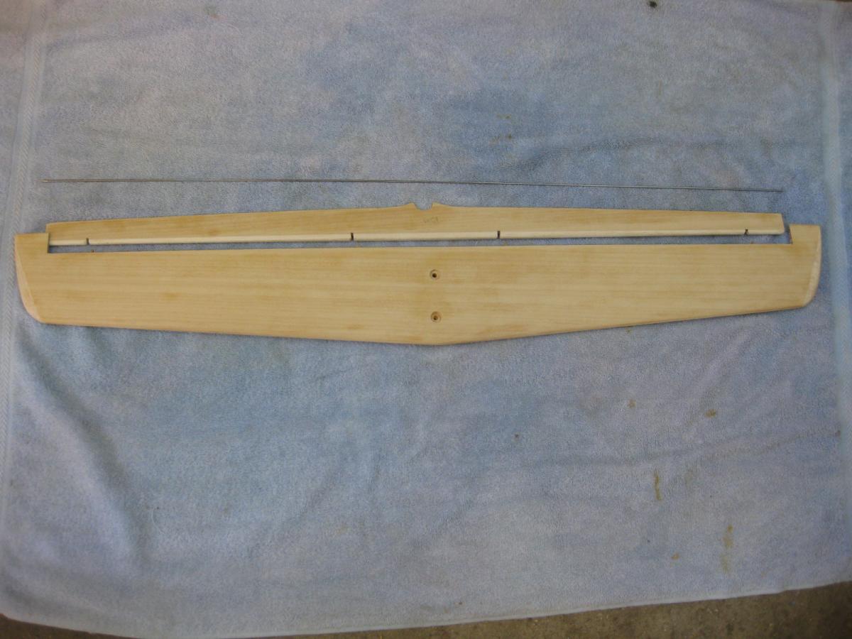

    Started on the 5m tips, Stabilizer and Rudder glassing them with 0.56 oz cloth from thayercraft.com (104) and West Systems Epoxy.

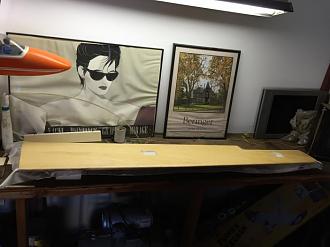

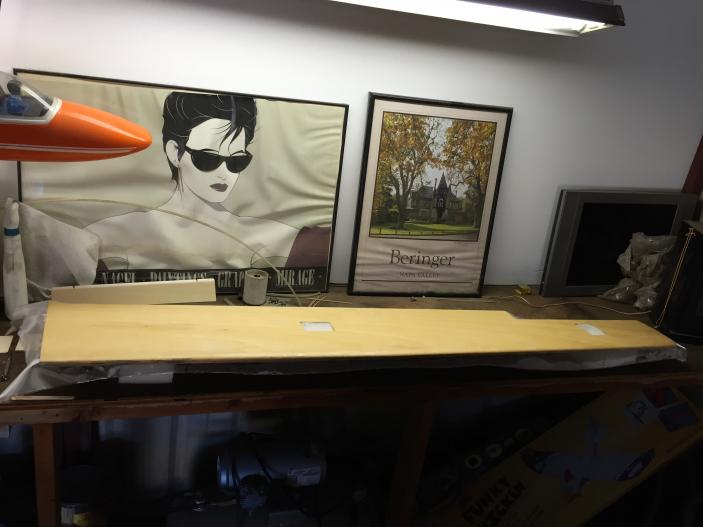

          Started in on the wings......and yes, my hanger does show remnants of the 80's
ID:	3959 Click image for larger version
          Scott

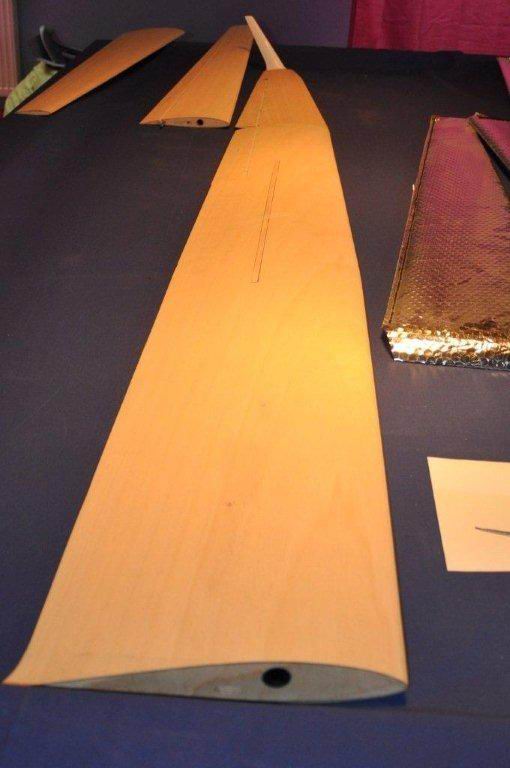

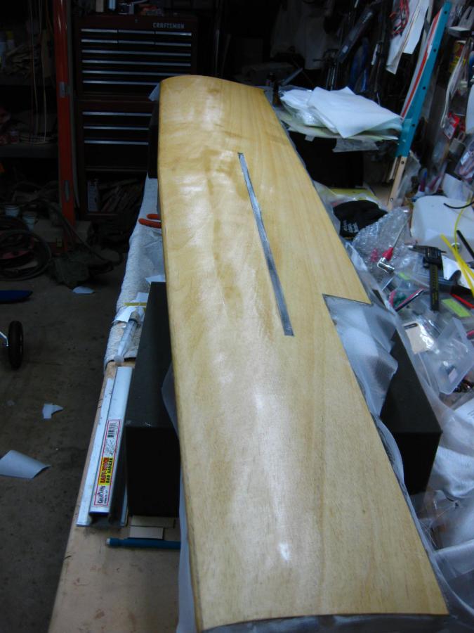

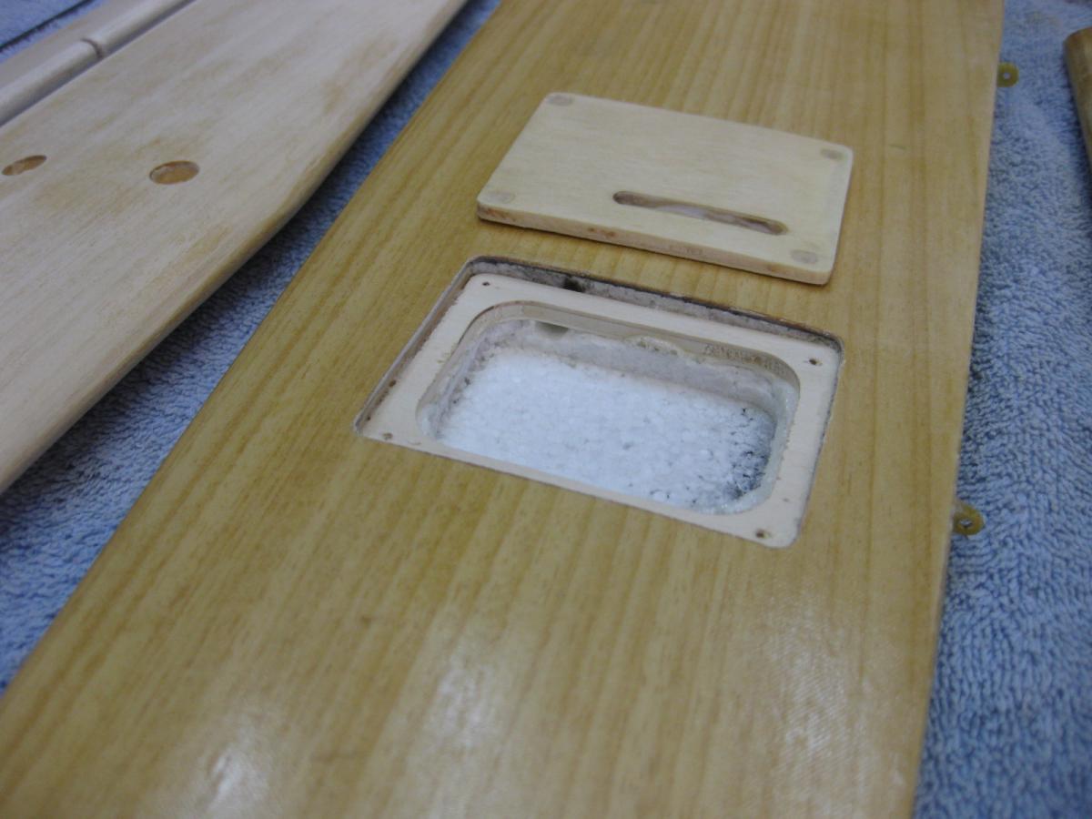

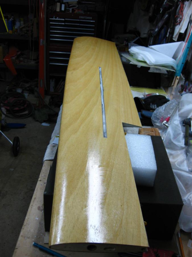

            Ran in to a minor issue when I was smoothing the top surface of the left wing..... the center of the spoiler area skin wasn't stable and had lifted a little. So out came the 10cc syringe and a CA tip to get the epoxy up underneath the skin.
ID:	6883 Click image for larger version

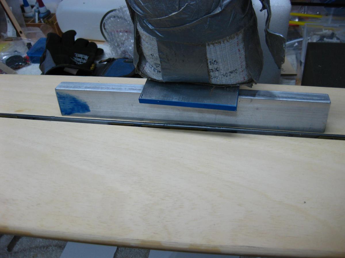

            Then on to the 0.75 oz fiberglass to the top of the wing and the second flow coat to fill the weave.

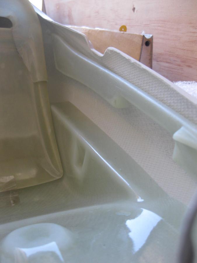

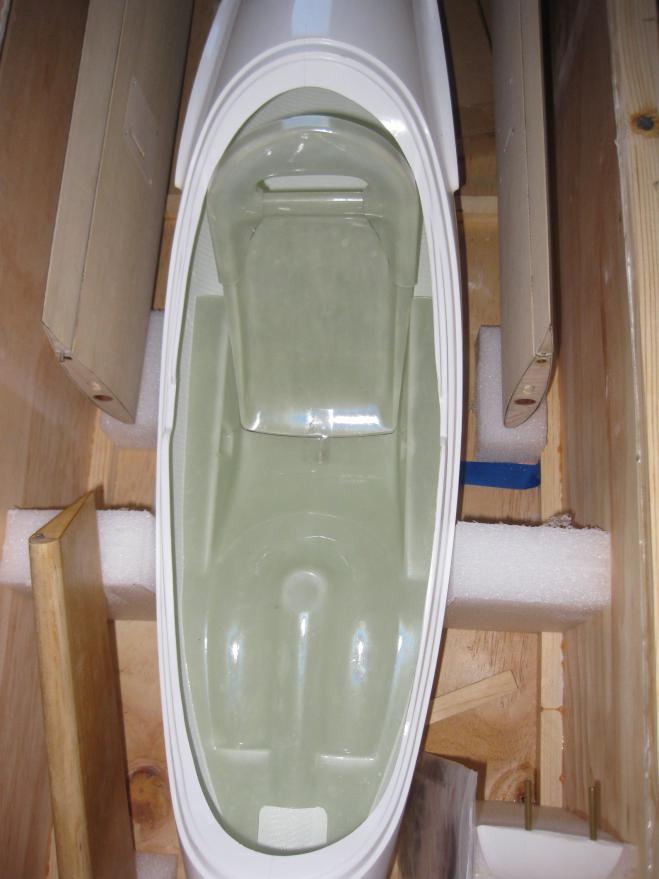

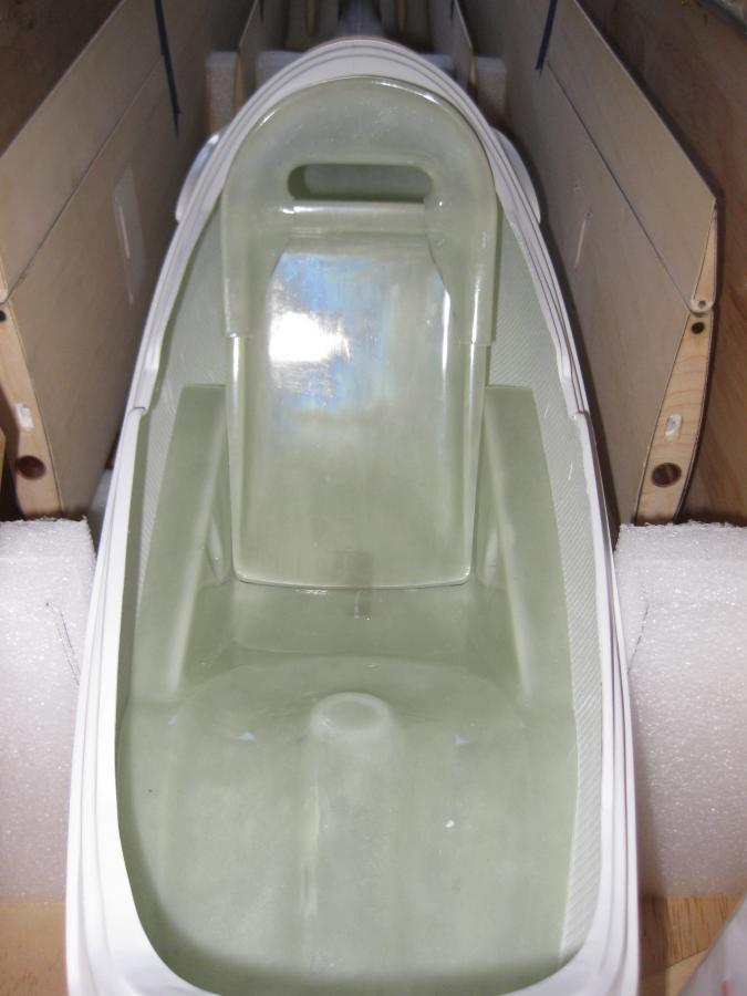

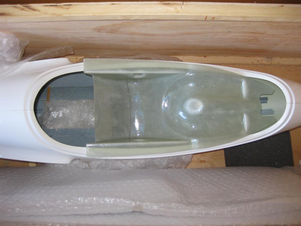

                Many Thanks to Asher Carmichael for his excellent cockpit fiberglass "kit'.
                In this case consisting of seat pan, back, headrest and side comb moldings. Excellent fit in the Rosenthal 28 fuselage.

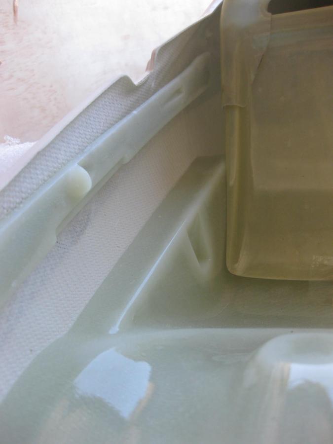

                I came expertly packaged to avoid shipping "rash"
                A nice extra was the cover letter and notes on AS /W /H /Gxx molded parts finishing recommendations Photos of full size cockpit layouts too
