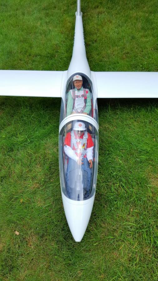

Seat pans all dressed out and a pair of fine lads from Axel fit like a charm.
DG-1000 Carbon Edition @ 6.0 meter wingspan by Mibo Modeli
Well... mostly. Mr Back Seat lost his feet.Originally posted by Xroadie View PostIt's nice when the scale pilots actually fit in the "scale" cockpit

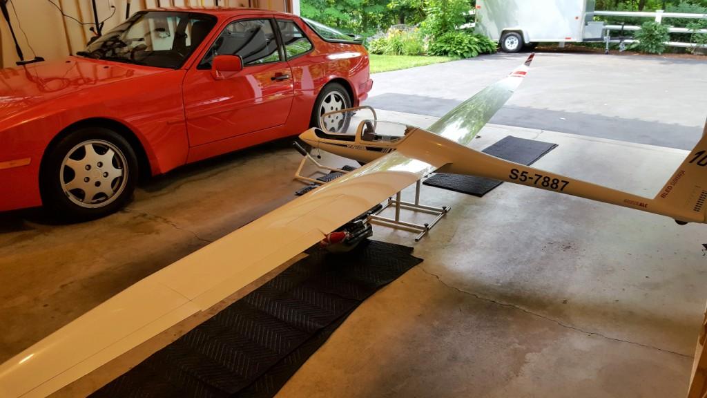

Completely unscientific experiment here: I balanced the DG in my basement workshop essentially holding it up on two CG marks on the bottom of the wing. You know, the old and too frequent way.
[ATTACH=CONFIG]n11068[/ATTACH]
Wanting to be certain, today I reassembled the plane in the garage and placed it on the high quality/accuracy CG balance rig, installed all the pans and equipment, etc. Yep, 6.5 more ounces were needed to achieve the recommended 70mm from the LE CG.
All told, 77 ounces + 6.5 for a whopping 83.5 ounces in the snout of this beast!
