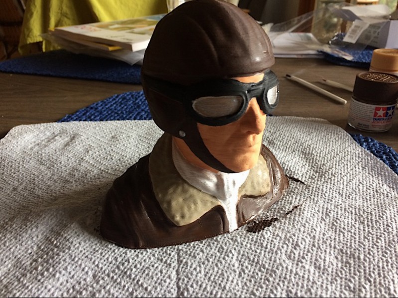

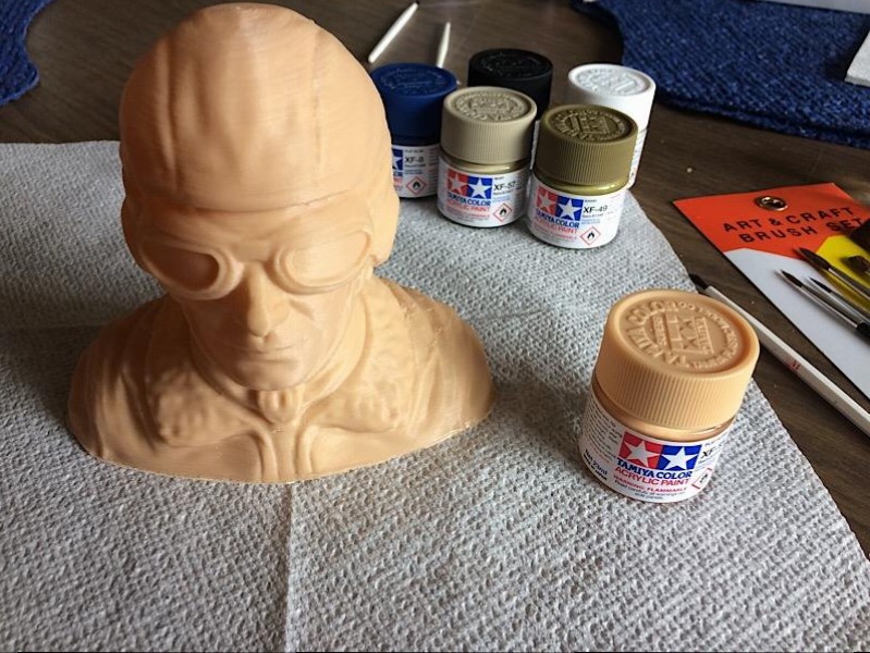

                • #57
                  Scot, I used Tamiya Color acrylic paints available from Horizon Hobby. They are water base, water cleanup, no odor, and one coat coverage. Easy peasy lemon squeezy!
