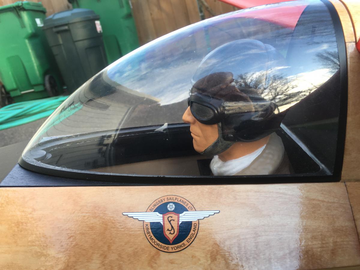

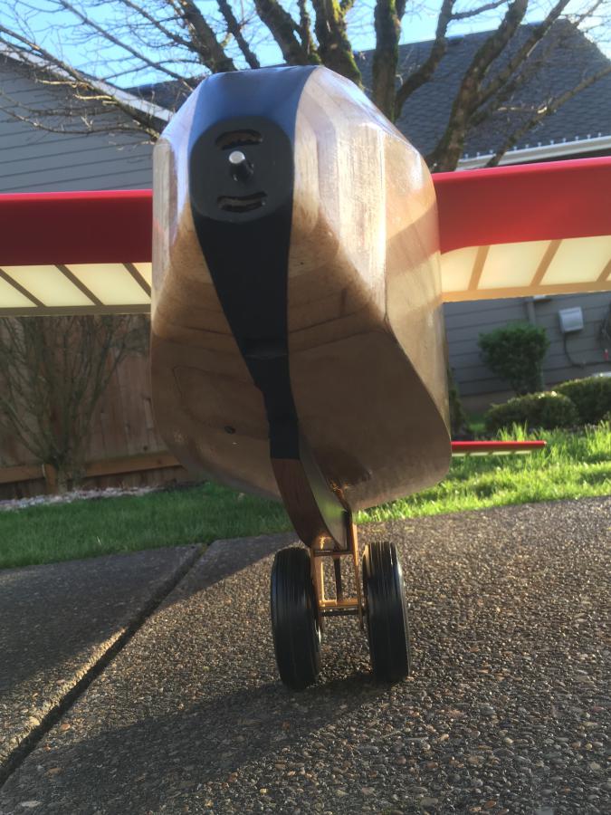

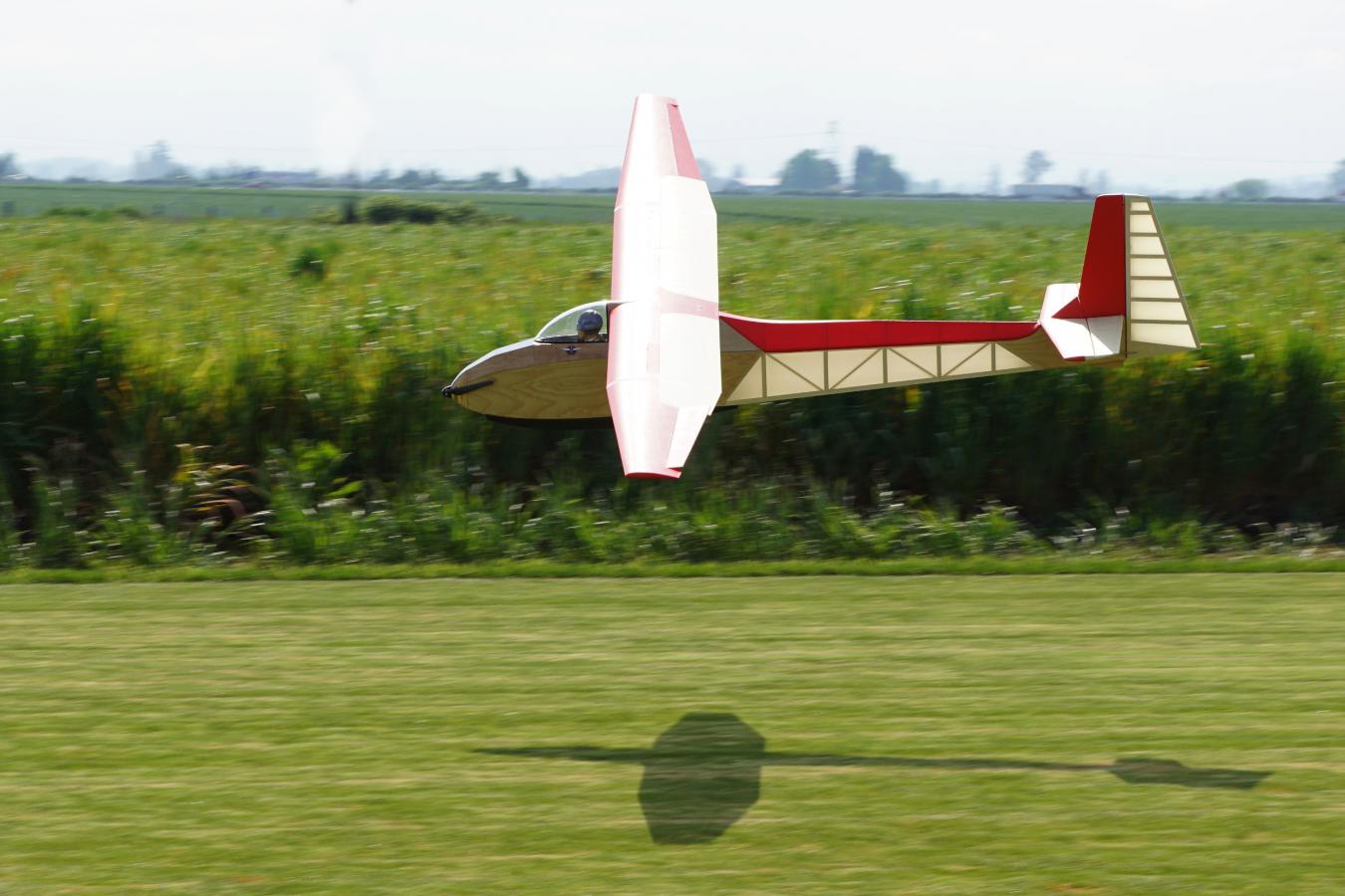

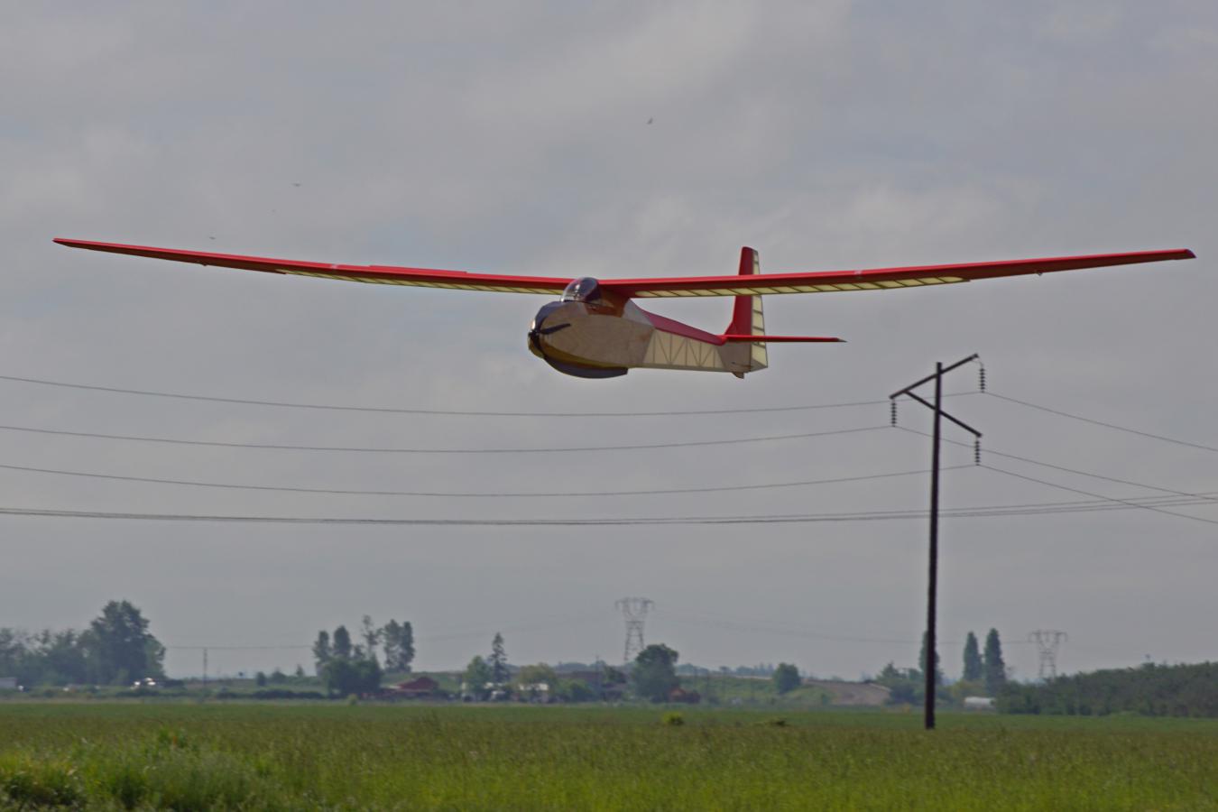

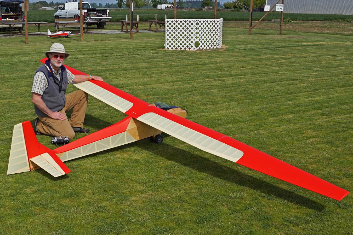

        It Flies!!! Had my first flights with the Skylark today and it was great and a huge relief. The Power 32 was more than adequate for an easy climbout. The dolly works great for ROG. Thank you Peter Goldsmith for a well thought out kit/design and JimD for the build thread. Definitely a keeper

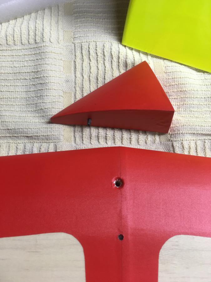

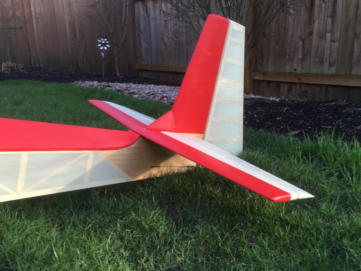

          The front and rear sections of the fuselage were finished with 0.5oz fiberglass cloth and two coats of Zpoxy thinned with denatured alcohol 1:1. I also applied an oak veneer strip to the bottom of the skid and that was glassed as well. For convenience the cloth was applied in sections and very lightly sanded after the first application coat to clean up the edges(any extra cloth at the edge is easily sanded off) and smooth everything out. The second coat was applied after the glassing was completely finished. I liked the Zpoxy as it gave the wood a slight patina look that I wanted as well. The process was fairly quick and easy plus it really hardened up the wood. The black color is Klasskote satin black.
          After the glassing was completed, the covering was applied(Oracover) overlapping the glassed areas about 1/4" Here's a photo of the aft portion of the fuselage..........
          Also, I did not glue the nose of the fin to the stab. I installed an 1/8" CF rod into the bottom of the nose that fits into a brass tube in the stab. It get wedged into place by the fin when the stab is screwed into position.
          Jim G.
