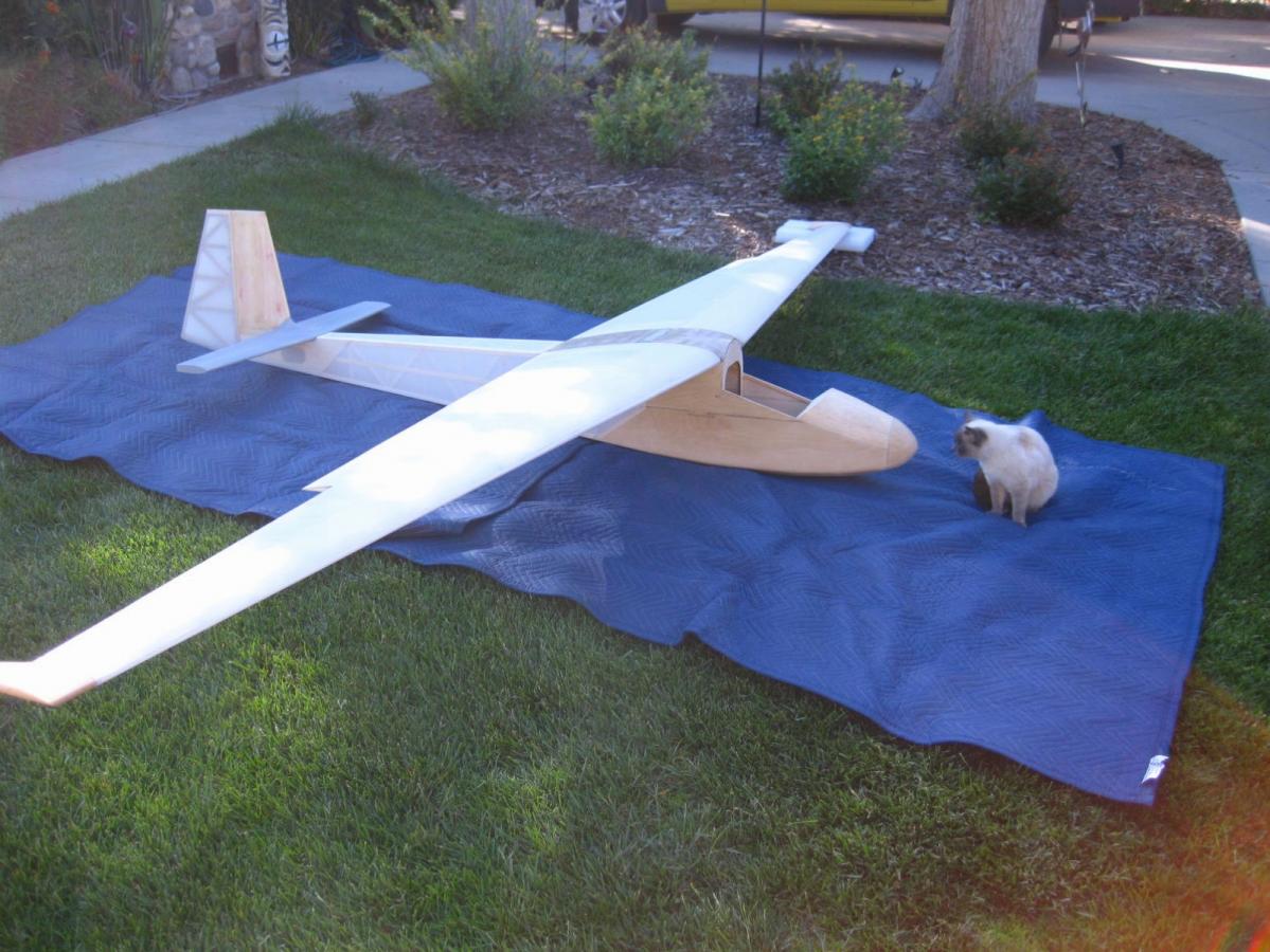

    Non-committal (..typical Cat.....) - She was interested but I was hoping she wouldn't perform a fabric "punch test".

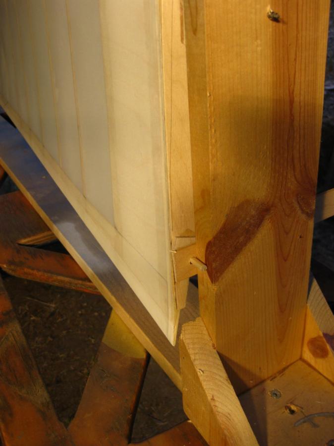

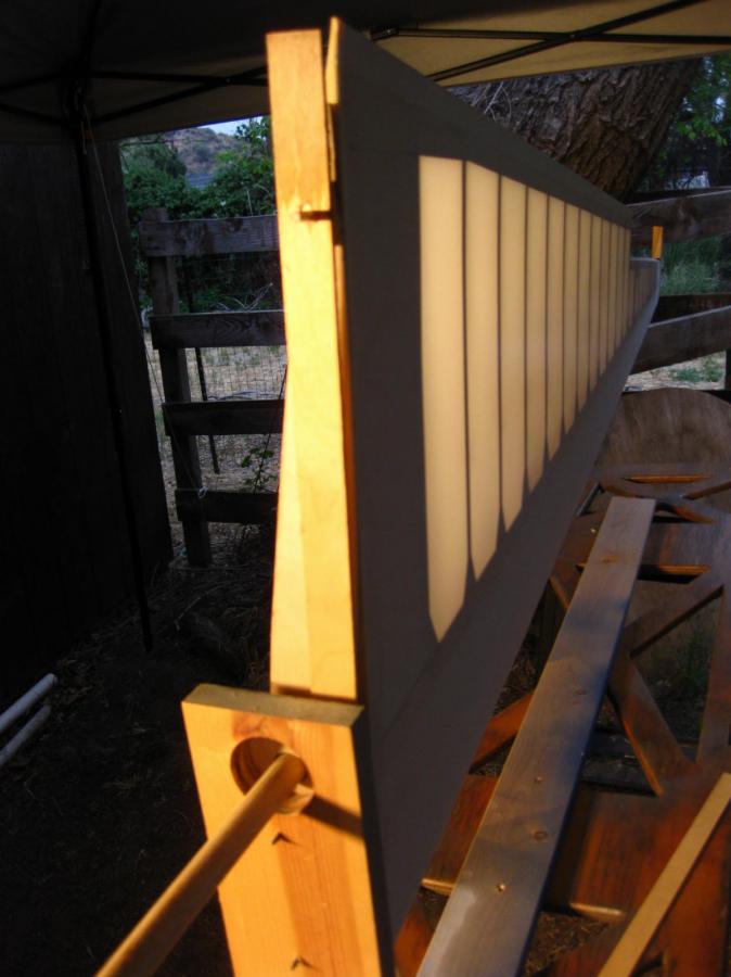

    Some early morning Clear Aero-Thane 100 on one wing. Always a bit of trepidation when painting outdoors with bugs and wind but got lucky today as both were still asleep.
    Wing and painting jig, used 5/8" oak dowels ( with a little bit of sanding ) in the wing tube so I could spin the wing and hold it in place. ( I'm still working on how to do the same with the fuselage )
    The Photos are at the 2nd mist coat stage....with my spot lite painting "aid"
    Click image for larger version  Name:	IMG_4429.JPG Views:	1 Size:	132.6 KB ID:	25974Click image for larger version  Name:	IMG_4431.JPG Views:	1 Size:	52.7 KB ID:	25972Click image for larger version  Name:	IMG_4430.JPG Views:	1 Size:	57.7 KB ID:	25973
    Waiting for paint to dry......the bottom is the sacrificial surface.....
    Click image for larger version  Name:	IMG_4433.JPG Views:	1 Size:	140.1 KB ID:	25975

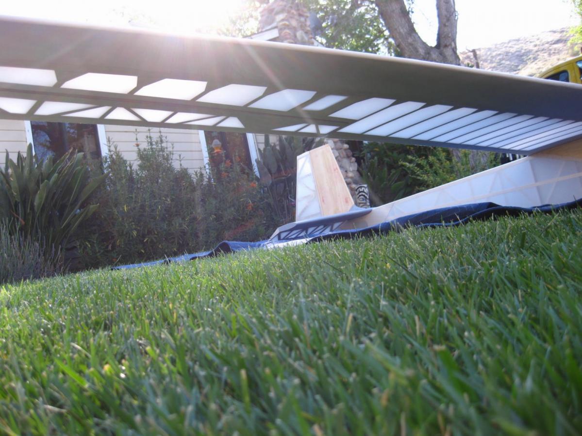

    Productive weekend covering Wings and Aileron up thru Poly-Brush stage........Then Inspection time.......
ID:	25919Click image for larger version
    Time to start painting the big stuff........and work on the dreaded canopy

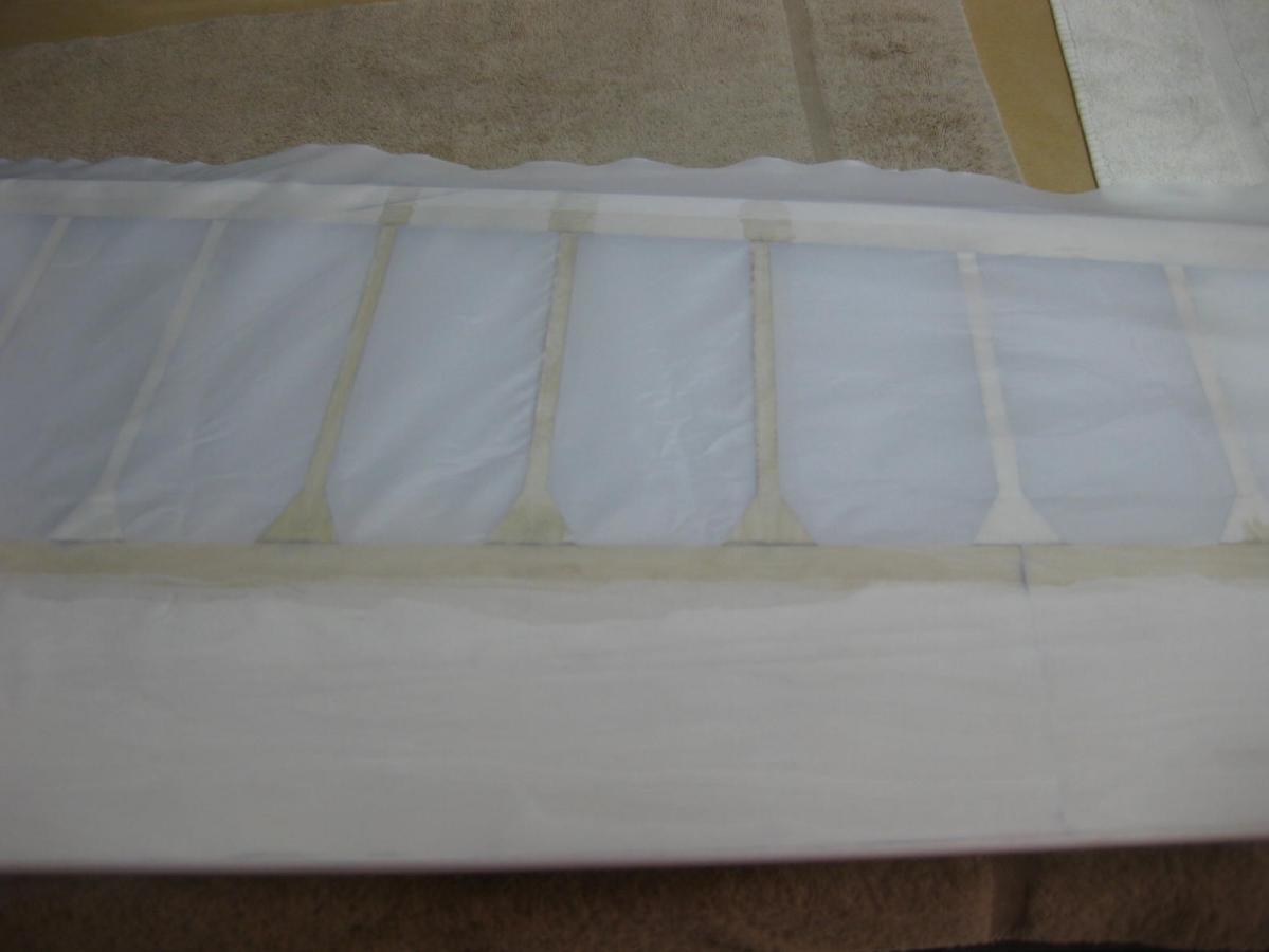

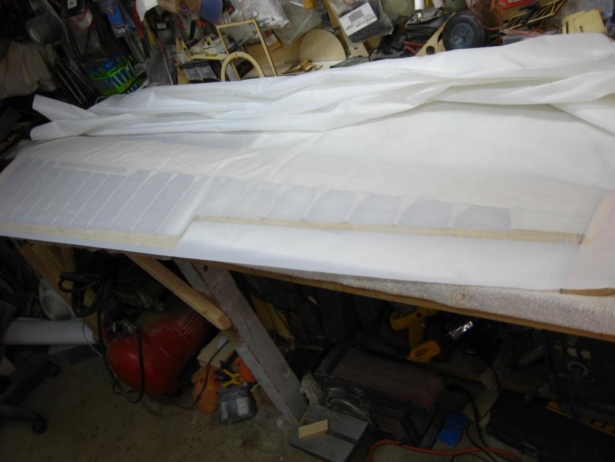

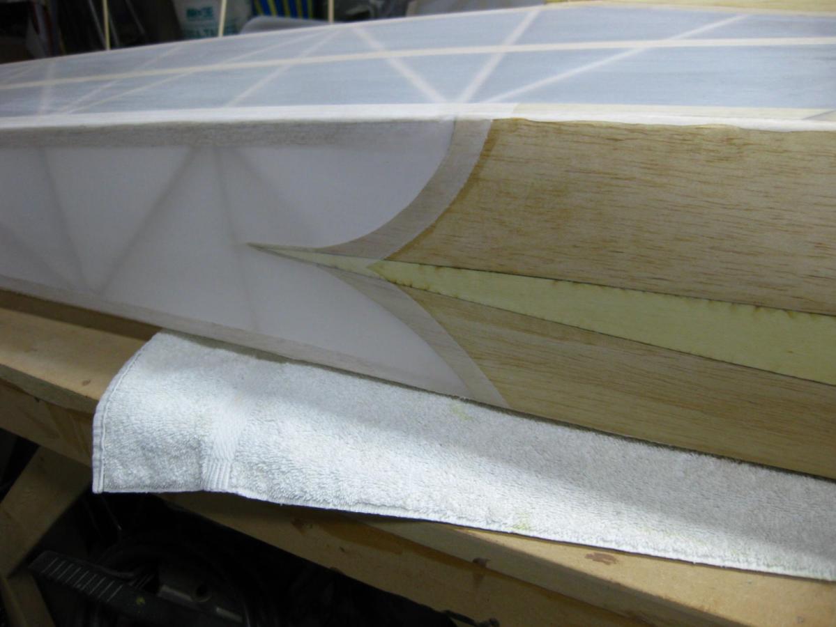

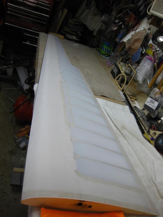

    The really nice thing about the Stits /PolyFiber fabric size is that you can cover the wing in one piece.....Yea..........overlap is on the bottom of the trailing edge.
    Starting from the top trailing edge, wrapping around and then securing at the bottom D-box.
    Click image for larger version  Name:	IMG_4413.JPG Views:	1 Size:	95.0 KB ID:	25883Click image for larger version  Name:	IMG_4414.JPG Views:	1 Size:	81.5 KB ID:	25884
    Since the wing is under-cambered, fabric is attached to cap strips with the PolyTak ( well its attached glued to the top cap strips too....but not till after shrinking )
    The under-cambered area was only shrunk to 250 F temperature , all the rest was to 275 F to get the fabric wrinkles out.
    Click image for larger version  Name:	IMG_4415.JPG Views:	2 Size:	52.2 KB ID:	25886
    Click image for larger version  Name:	IMG_4416.JPG Views:	1 Size:	56.0 KB ID:	25887

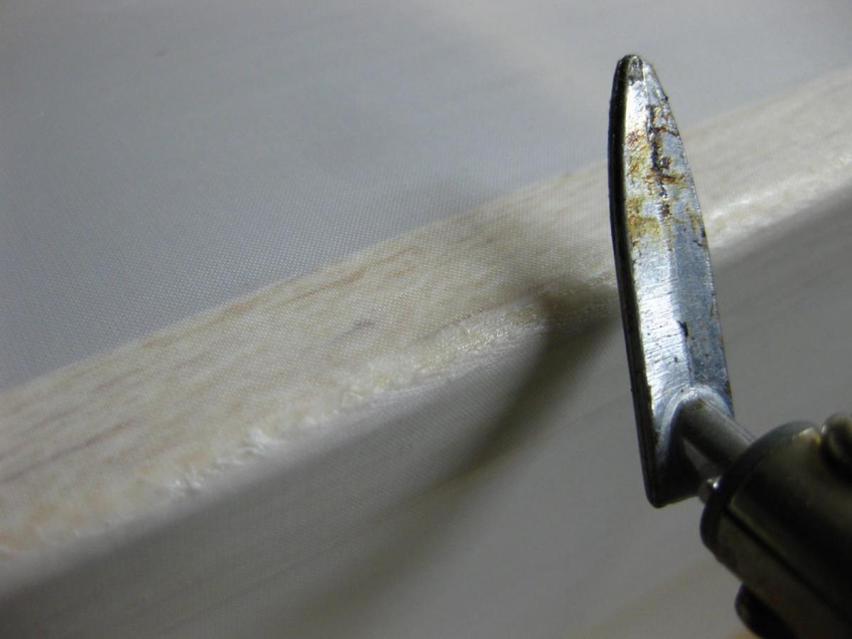

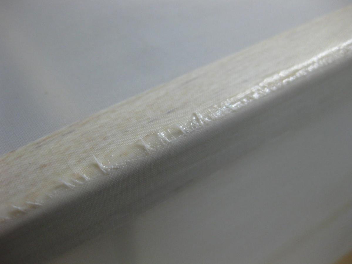

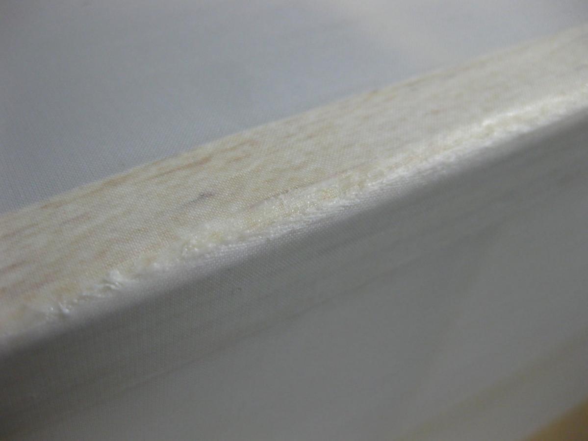

    After Fabric is attached, Second step is to brush on the Poly-Brush coating. Normally the Poly-Brush is tinted pink so you can see where you already applied the coating but the Swallow's case, a natural fabric look is desired over a lot of the airframe so Un-Tinted Poly-Brush is "brushed" on. Only thing here is to watch not to brush on too much and cause pooling and drips on the inner surface.
    After the Poly-Brush dries the fabric edges need some attention as they usually fray and stick up a bit. I found a quick pass with my trusty Top-Flight Trim Seal Tool set to high does a great job.
    Also use of a 600 grit sand paper / sanding stick helps clean off the iron surface as the Poly-Brush builds up and burns.

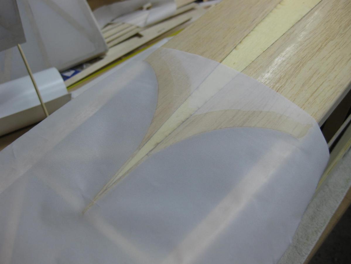

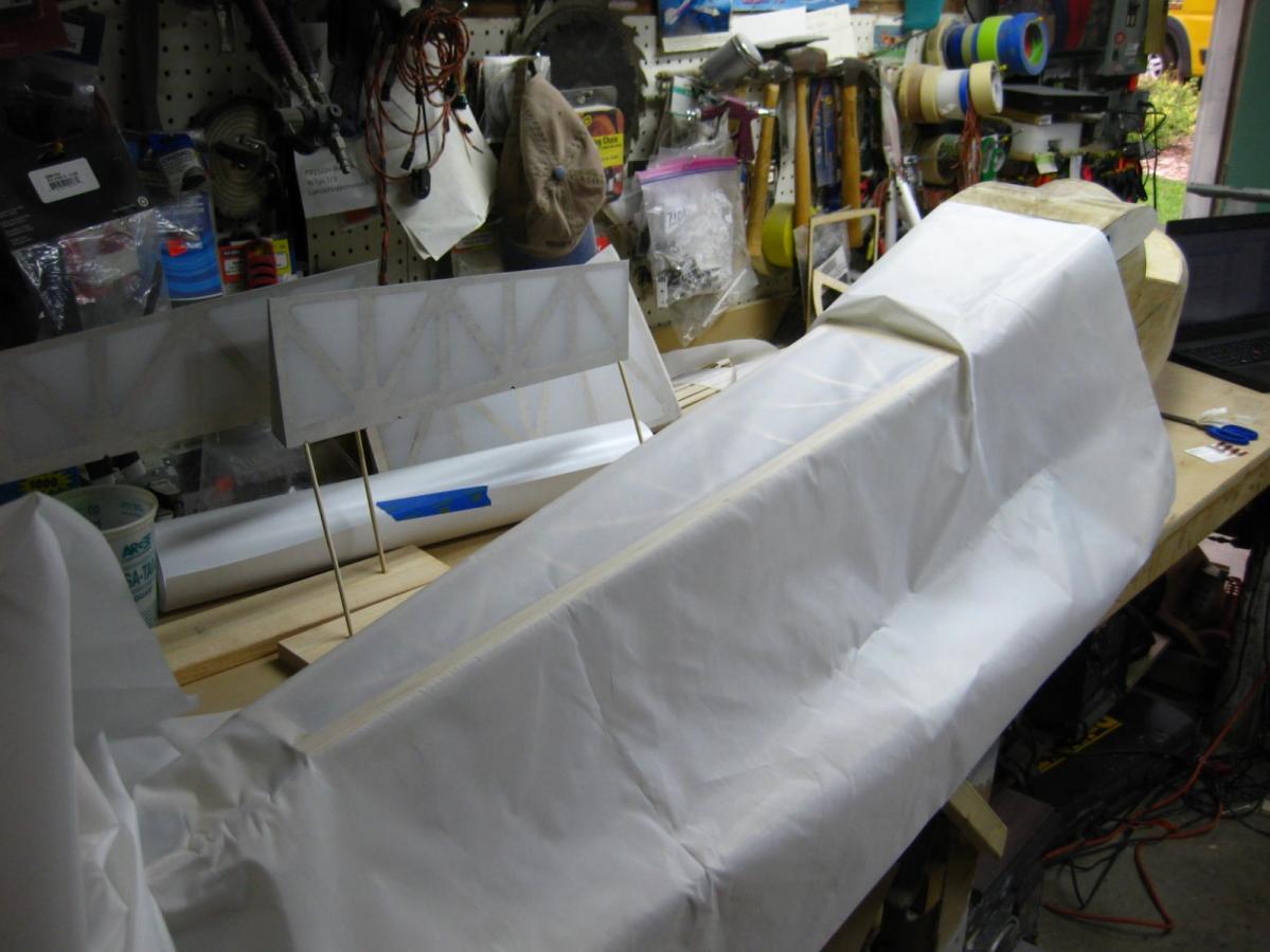

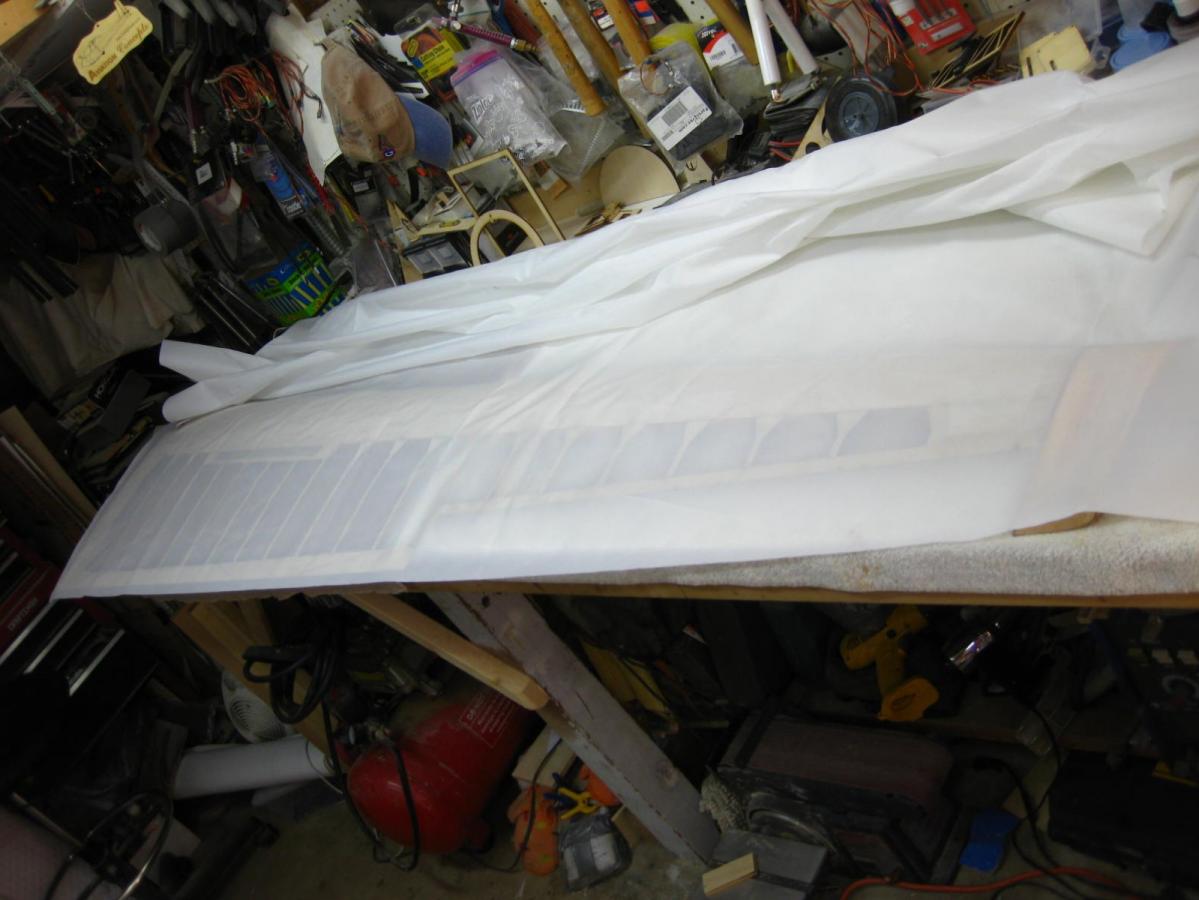

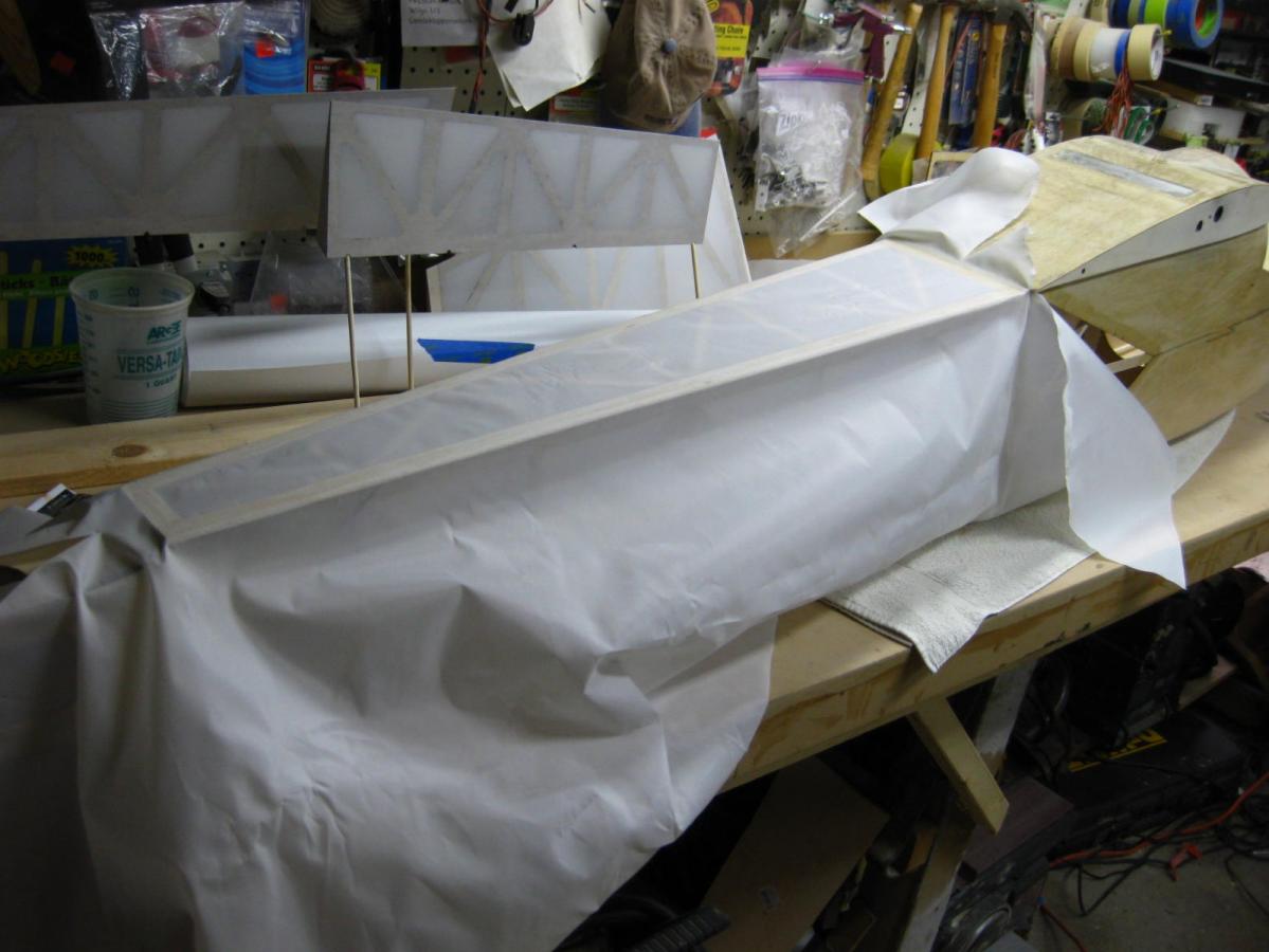

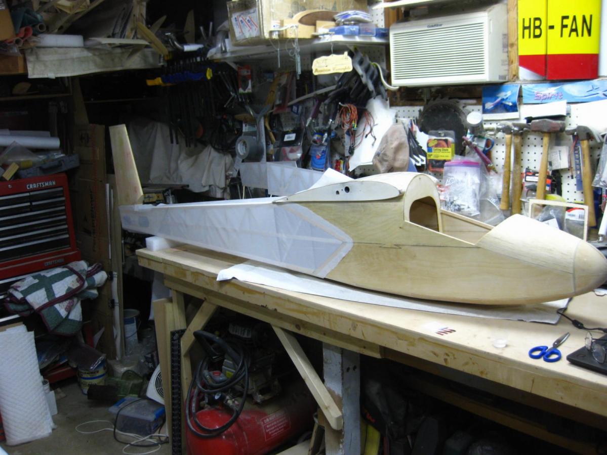

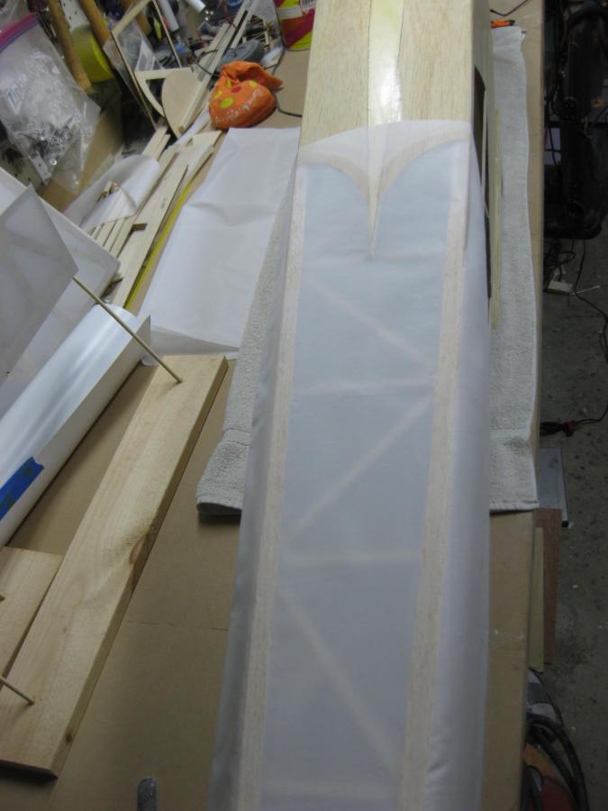

    Had a dickens' of a time finding my other 10 yd. order of PolyFiber Lite fabric ........but I was successful, so , ...On to the Fuselage
    Since the fabric is 60" wide and .....10 yds. long, it really give you a lot of options when covering..........
    Covering the bottom first , I'm really liking the modified application process as it leaves really smooth fabric attachment.
    Click image for larger version  Name:	IMG_4387.JPG Views:	1 Size:	97.6 KB ID:	25769Click image for larger version  Name:	IMG_4389.JPG Views:	2 Size:	60.3 KB ID:	25770Click image for larger version  Name:	IMG_4390.JPG Views:	1 Size:	51.2 KB ID:	25771

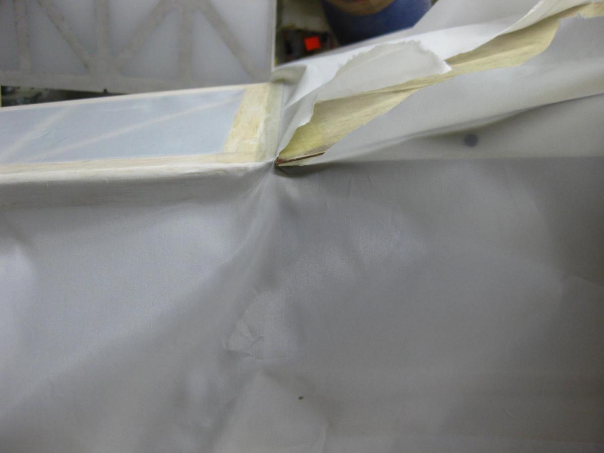

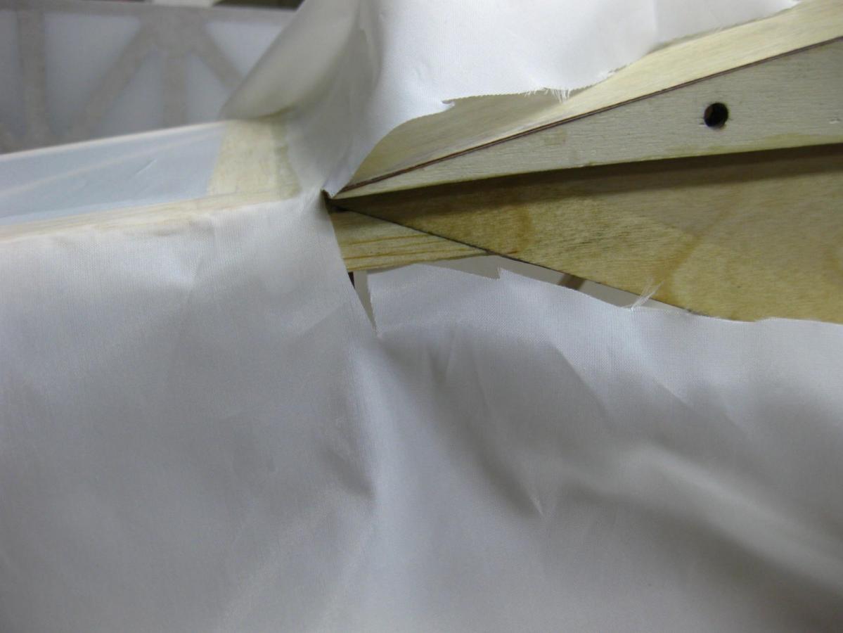

    Then came the top / sides......., trying to do it in one piece and of course .............I cut the wrong direction.....oops.
    Not to worry, as the PolyTak softens with the Painter's Solvent (MEK) and just lifts up.
    Click image for larger version  Name:	IMG_4393.JPG Views:	1 Size:	97.5 KB ID:	25772Click image for larger version  Name:	IMG_4395.JPG Views:	1 Size:	66.9 KB ID:	25773
    Once I got the fabric off, just applied another coat of thinned Poly-Tak and off to the Races again.
    Cut the right direction this time......
    Click image for larger version  Name:	IMG_4398.JPG Views:	1 Size:	53.5 KB ID:	25774Click image for larger version  Name:	IMG_4397.JPG Views:	1 Size:	92.0 KB ID:	25775
    Click image for larger version  Name:	IMG_4401.JPG Views:	1 Size:	130.5 KB ID:	25776Click image for larger version  Name:	IMG_4403.JPG Views:	1 Size:	85.8 KB ID:	25777

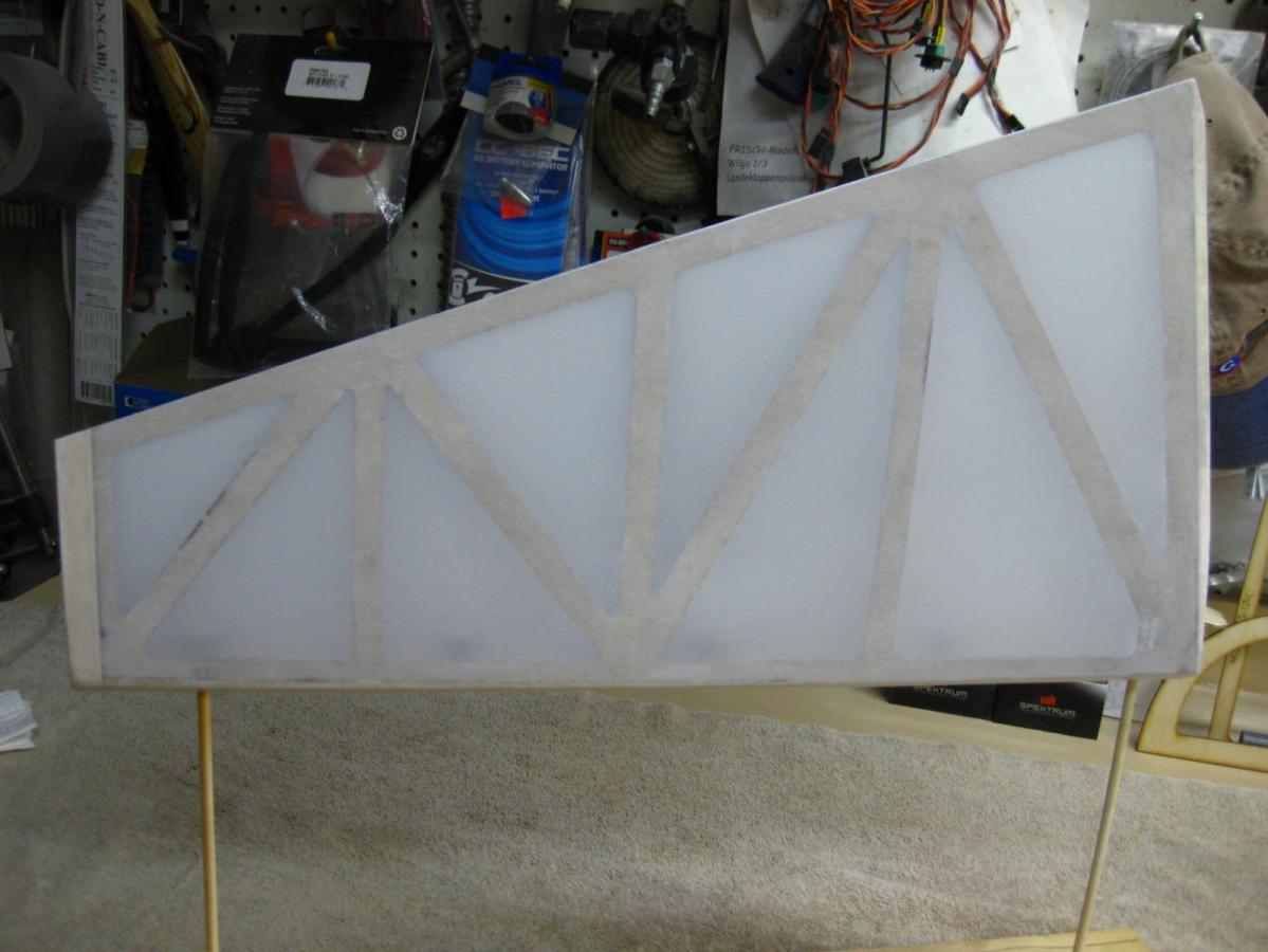

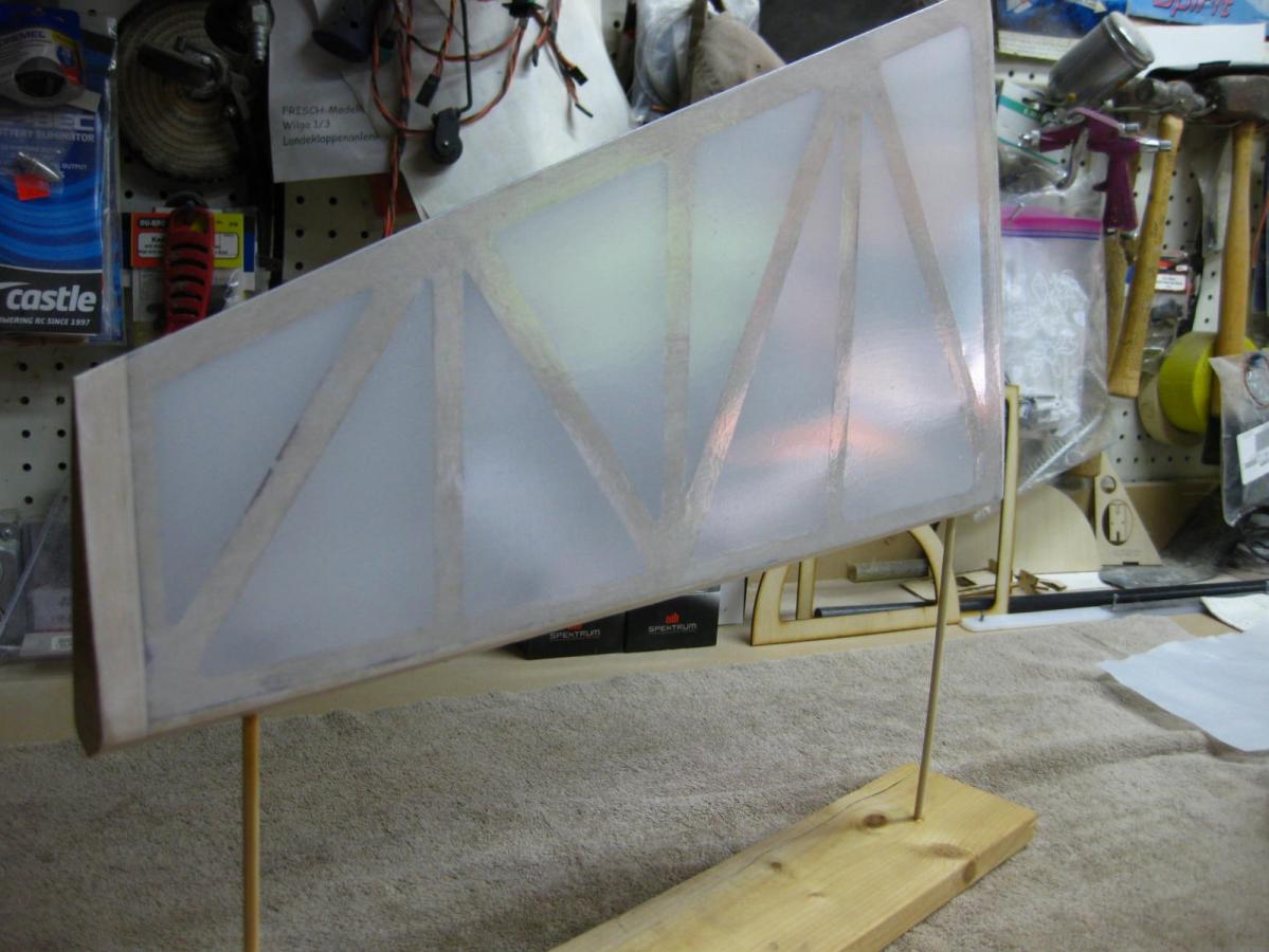

    Next step in the process is to Heat Smooth all the surfaces with the 200 F iron and a little pressure. It also helps remove some of the excess Poly-Tak too.
    After that its time to dial the Iron up to 225 F for the first shrinking - going over all of the open areas that aren't glued. Next is the same process a 250 F
    I don't recommend going any higher as there's a good chance that the structure will start to deform
    I held the elevator up to the morning sun ( contrast ) to check for any areas I might have missed.
ID:	25741Click image for larger version
Name:	Elevators contrast.JPG
    Then on to the first coat of Un-Tinted Poly-Brush to seal the fabric. It looks a lot better in this photo than the Contrast one........
Name:	Elevators polybrush.JPG

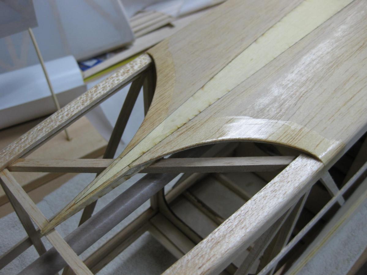

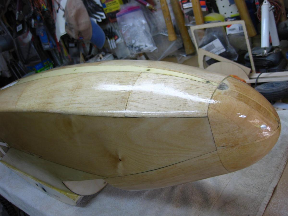

    Fuselage is looking a little Shinny after the weave fill coat of Epoxy, too bad I have to sand it all off.
