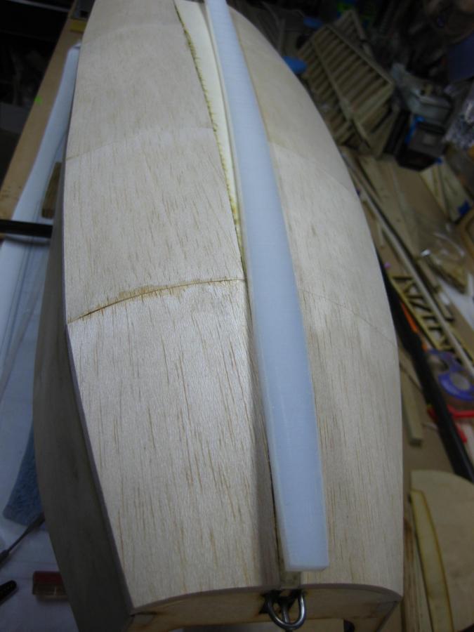

    Using 3/4" x 1/4" UHMW Polyethylene strip ( and skid plate ) similar to Dean Gradwell's Cherokee II ( and Gene's 1/3 Cherokee II)

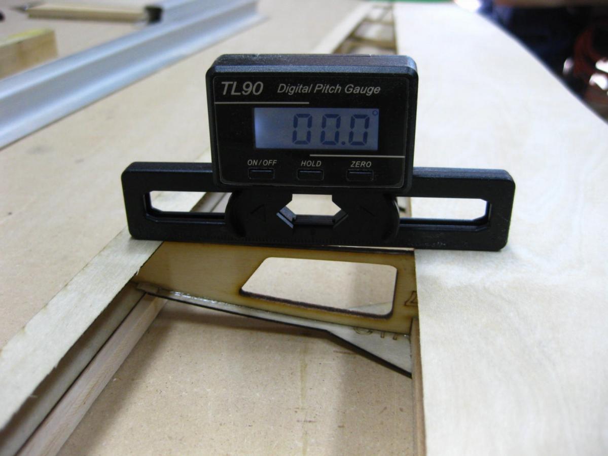

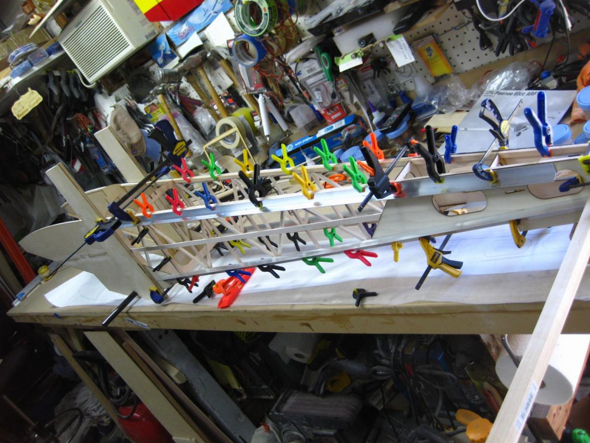

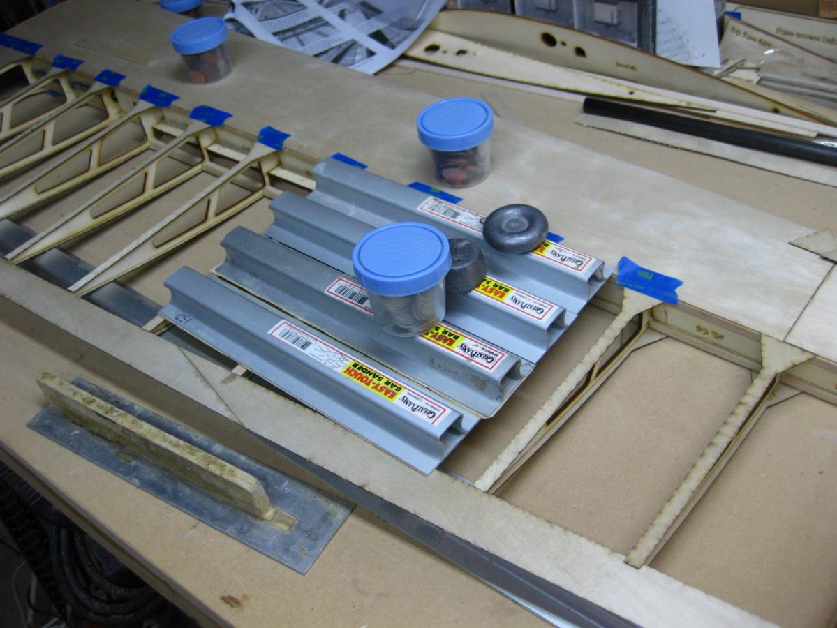

    Digital gauge was helpful to jig the wing up when applying the lower sheeting ( trying to avoid any twist ) Thanks to John Ellias for finding the TL90
    CA used when applying the cap strips and sanding bars to keep things level

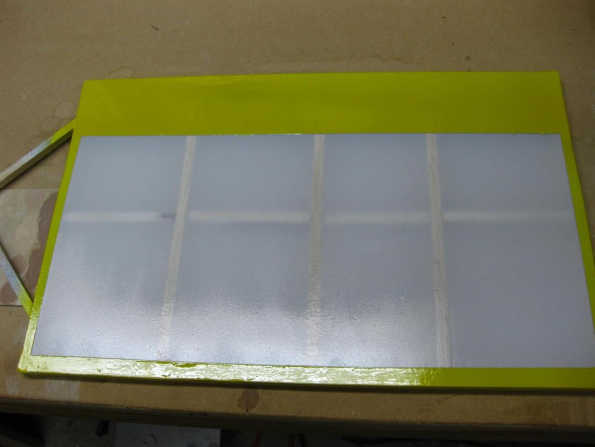

    Test fitting all the pieces for inspection and a test panel using Polyfiber process but PPG Omni LV for the Yellow so it will match .

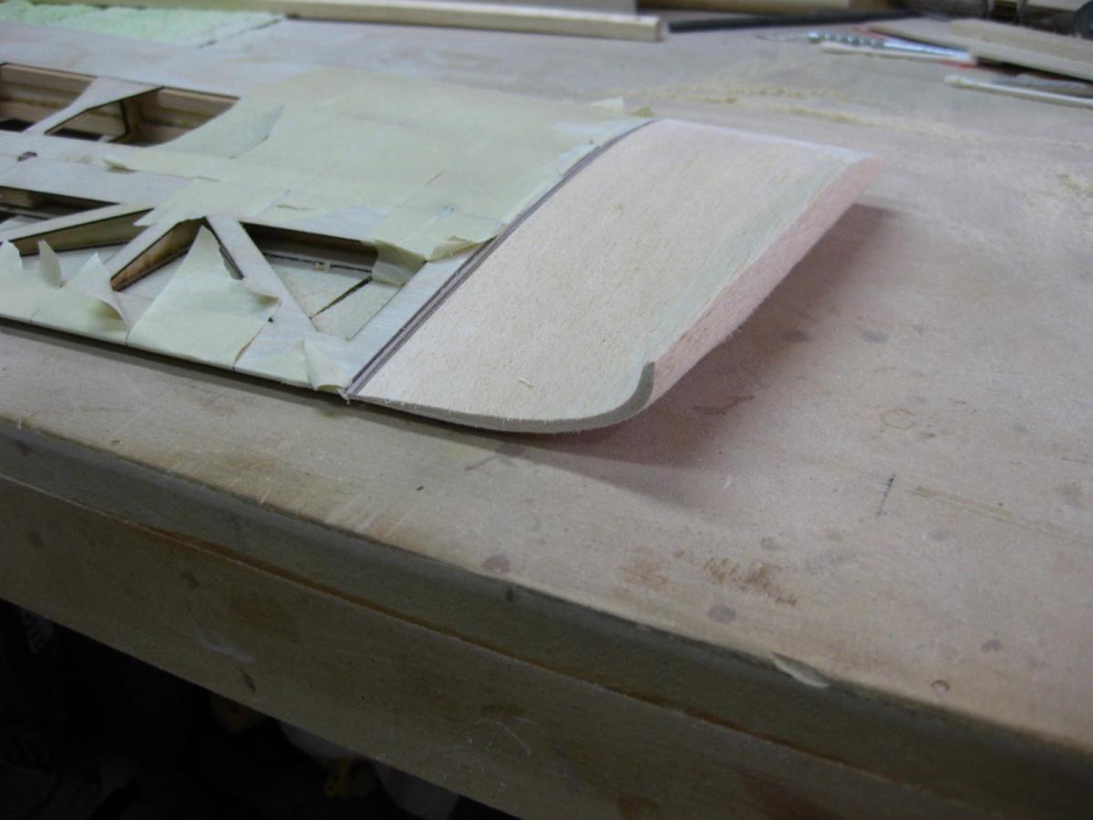

    1/8" Great Planes clear pin hinges for the ailerons and some artistic license in the wing tips - I really liked the Horton upswept tips on Dean's full-sized Cherokee so...... a 3"x1"x12" block of balsa and time with 80 grit sandpaper was required.

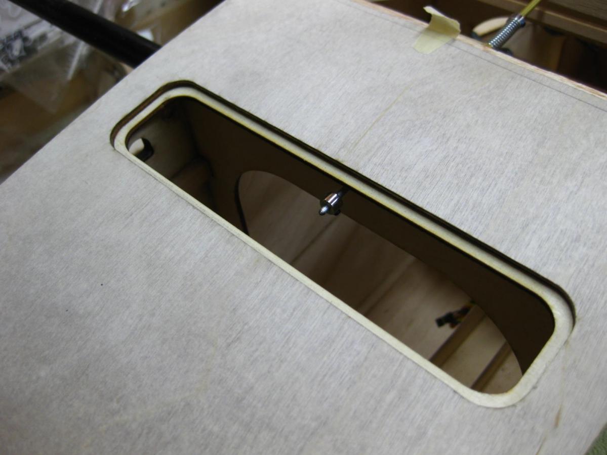

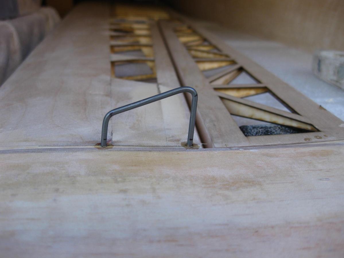

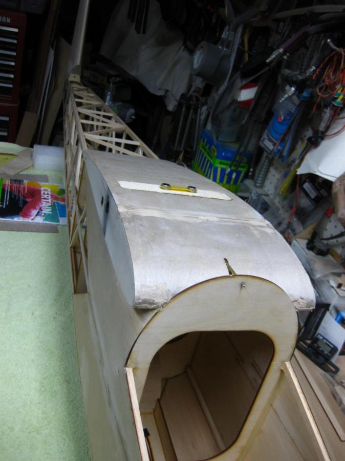

          My version of the canopy release ( accessed via the top hatch as I didn't want anything on the outside )

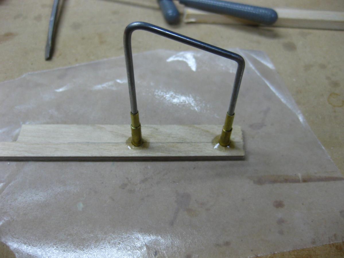

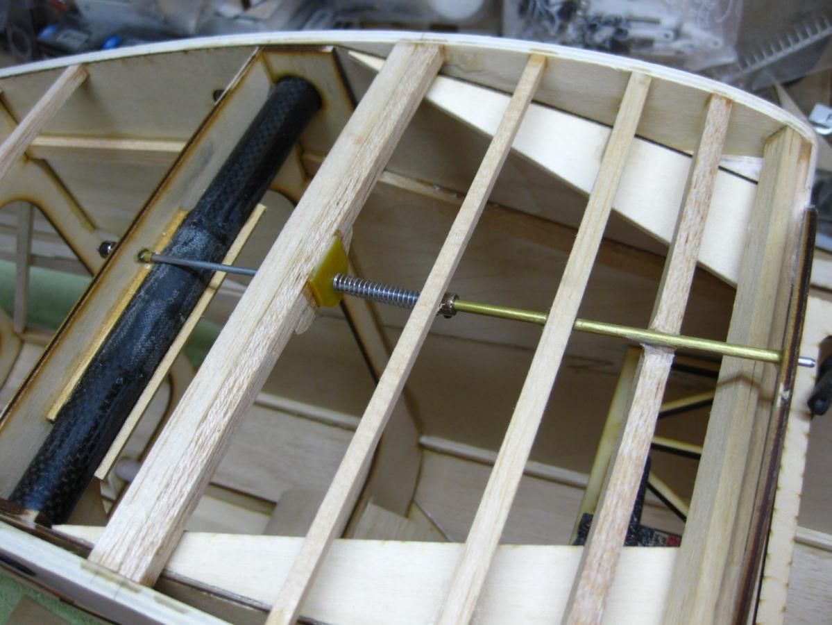

          Wing tip skids using 4-40 pushrod material and 1/8 brass tubing ( leftover from all the fuel tanks I've used ) and the drill jig ( copied from Gene's Cherokee II build ). Friction holds them in place.
          I'll probably solder a washer to the posts to prevent them from driving through in the event of a less than graceful landing.

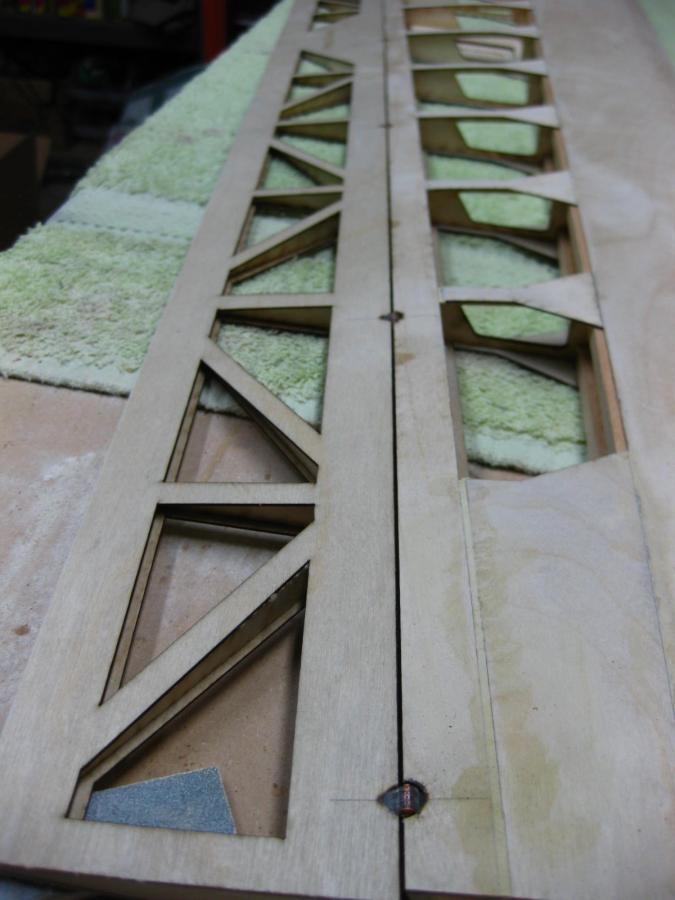

          For aileron spacing, I had to add another wing tip rib ( 1/8 lite-ply and 1/64 ply ) then I replaced the original wing tip rib with a 6-ply 1/8' rib to glue the Balsa to.

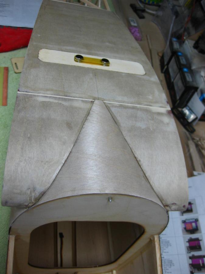

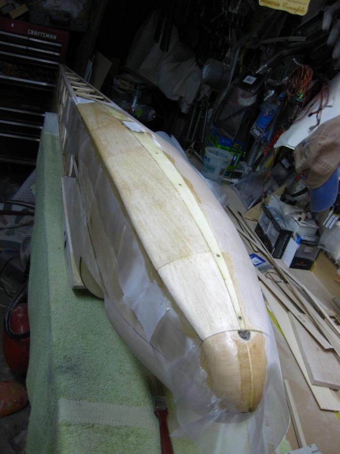

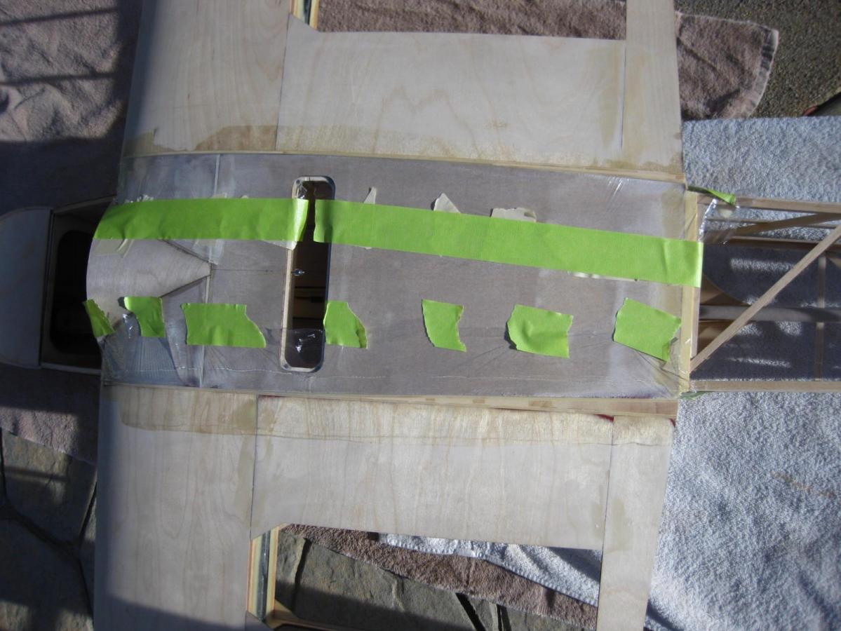

          Successfully coaxed the 1/64 plywood around the leading edge of the center section.. using a fair bit of water spray and the hot iron/glue technique.
          Magnets on the hatch access are my "removal tool" for getting the hatch off. Four small 4mm x 2mm magnets around the corners of the hatch hold it in place.
          Checking on the look of the wing tips with the ailerons installed

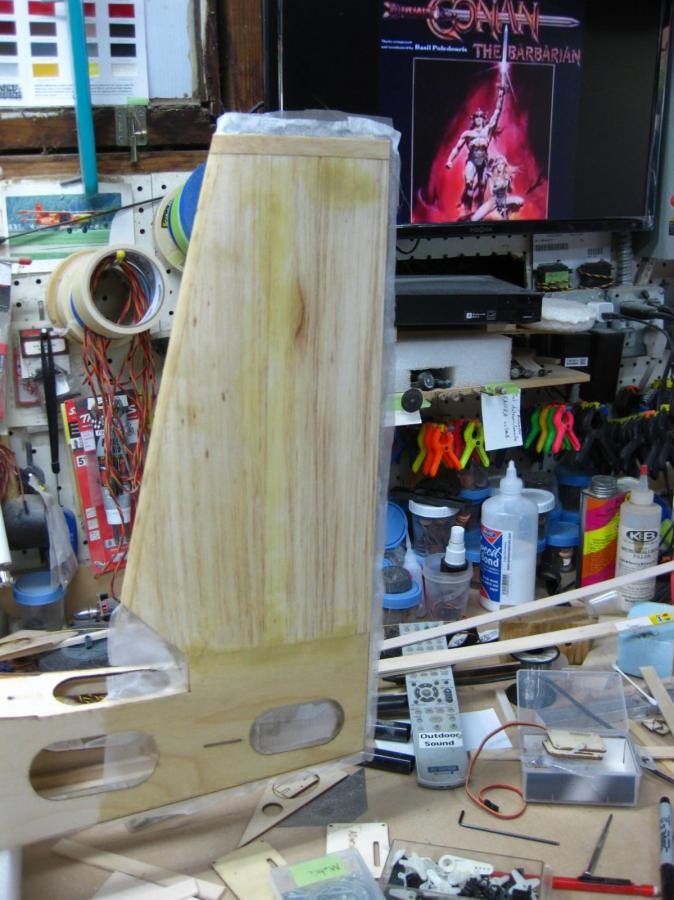

          Pre bent the canopy faring plywood before installation as it was flatting out on the narrow section at the back... Quart size paint can is the perfect form.
          Click image for larger version  Name:	IMG_4340.JPG Views:	1 Size:	126.5 KB ID:	25238Click image for larger version  Name:	IMG_4341.JPG Views:	1 Size:	54.8 KB ID:	25237
          Matching the wings to the fuselage with some minor error corrections as I built the root rib straight instead of at an angle ( to match the taper of the fuselage ).
          Click image for larger version  Name:	IMG_4343.JPG Views:	1 Size:	123.1 KB ID:	25239

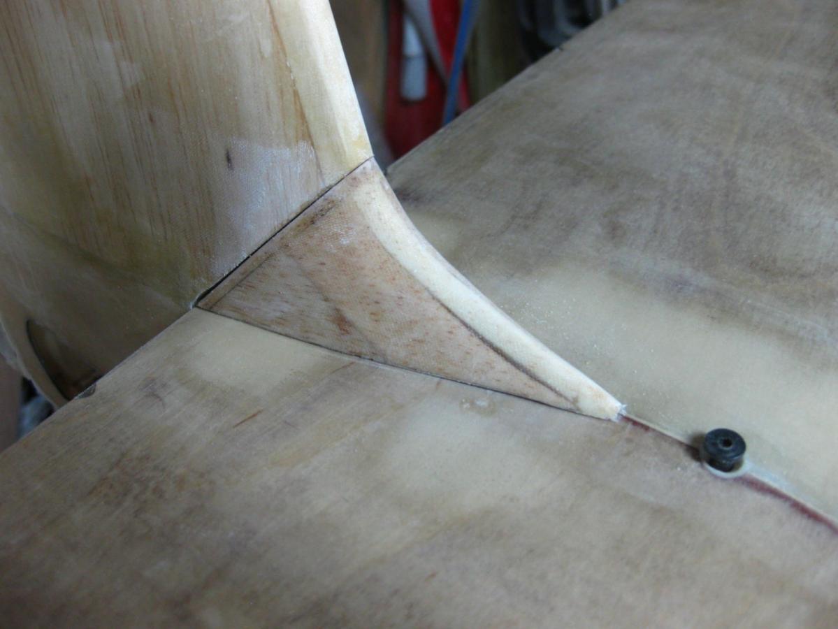

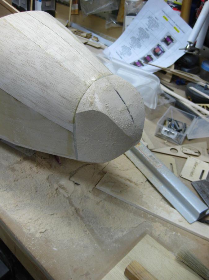

              And then...on to .... ..."Sculpting with Sandpaper"........ had to add some "extra" thickness to mine.... so I could sand ......oops.....Sculpt it to shape....
              Used a ).010 shim in-between the base and fin to allow for removal ----- I hope......
              the self-adhesive sand paper (150 grit ) attached to a popsicle stick worked great.

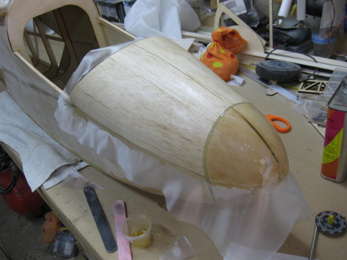

                  Actually that has already started, Wing tips , Stabilizer and Fin / Fin base are glassed/epoxy ( 0.5 oz glass ).
                  Figured if I glassed the Fin first there would be a slight safety margin while "shaping" the fin base........

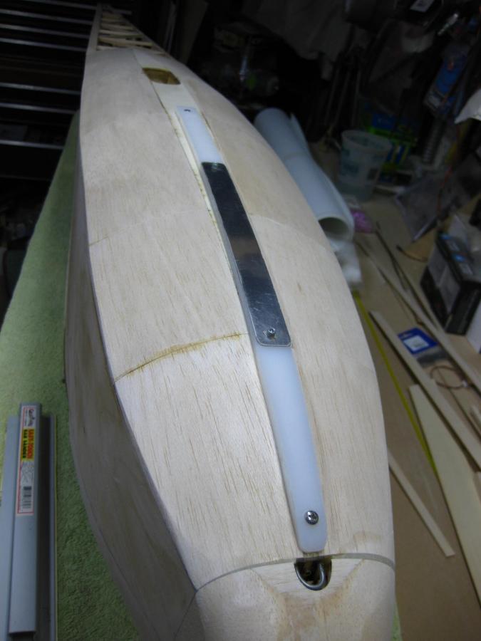

                      A little better detail of the bely/nose skid using the UHM material and stainless steel skid....
                      Socket head screws will be replaced with countersunk units.

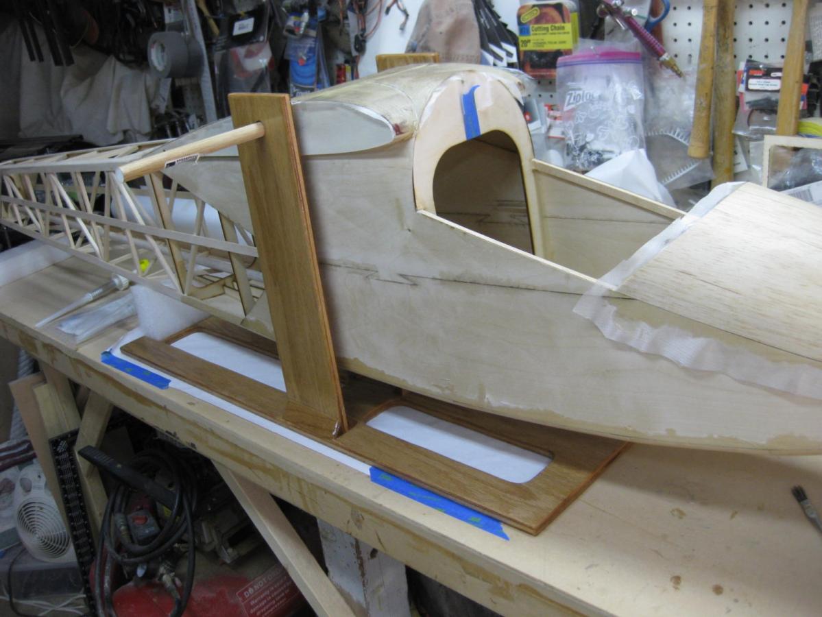

                      And fuselage transport jig in an effort to reduce Hanger Rash.
                      Click image for larger version  Name:	IMG_4363.JPG Views:	1 Size:	113.4 KB ID:	25702
