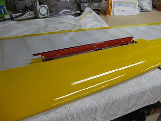

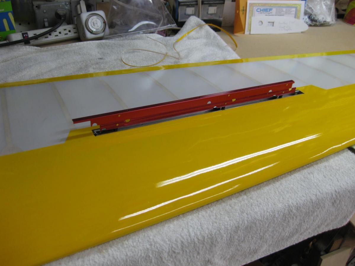

      While I wait for the Cockpit paint to cure, a splash of Red for the wings....I'll have to put the spoiler caps on eventually.

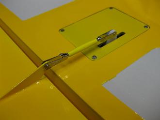

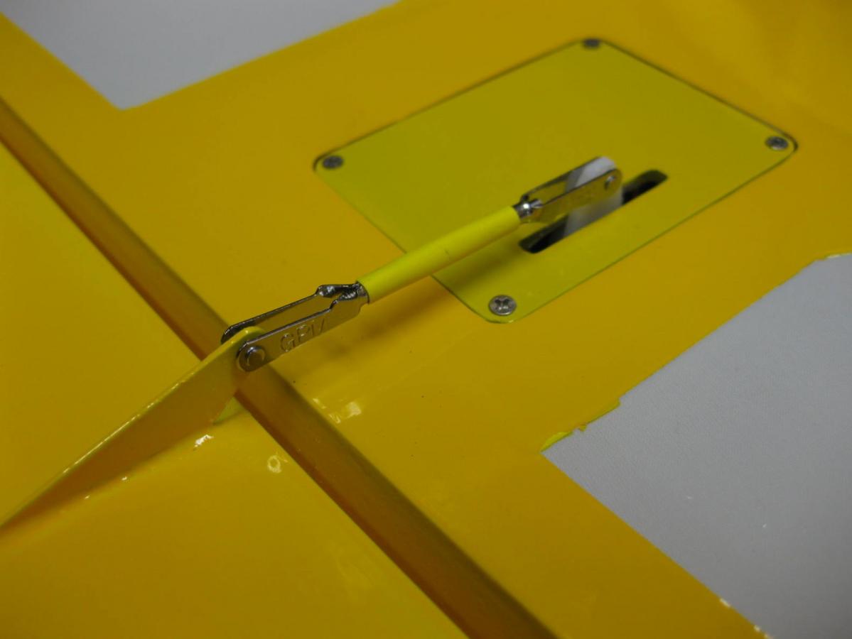

      Glued on the Aileron and connected the servo ( trimmed the servo horn and a little yellow shrink tubing to hide the threads. )

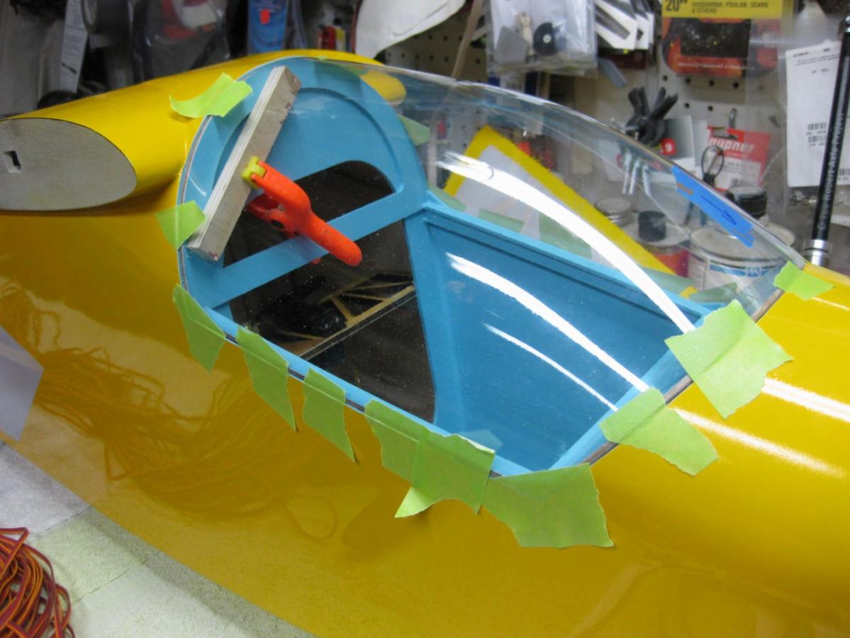

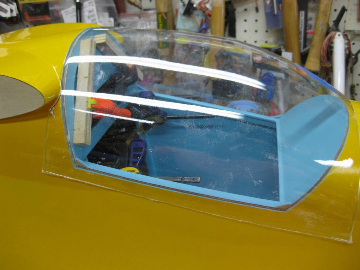

      Danger Will Robinson, Danger........Canopy installation........

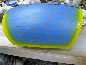

      After a minor comment from Jim......I put some blue tape on the front of the canopy with an Arrow.......

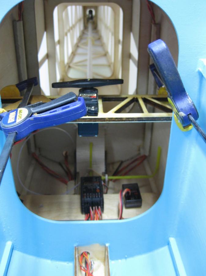

      Electronics integration completed so the Rudder tray was installed.
      • #49
        The moment of Truth - accompanied by some ZAP Formula 560 canopy glue.
        Now the interesting thing will be to get the orange clamp off....
        • Gene C
          Gene C commented
          Interesting situation? but I believe you can pull it off.
          You could have attached a thread to the clamp first and run it out through the tow release opening so you could just pull on it, or just put your hand through the wheel opening!
        • MarnochS
          MarnochS commented
          Got the clamp off,....combination of micro flyer pushrod with a Z-bend as the clamp has a small hole drilled in the arms .....and a carbon rod.
          Of course this is after I got the canopy unglued from the airframe.

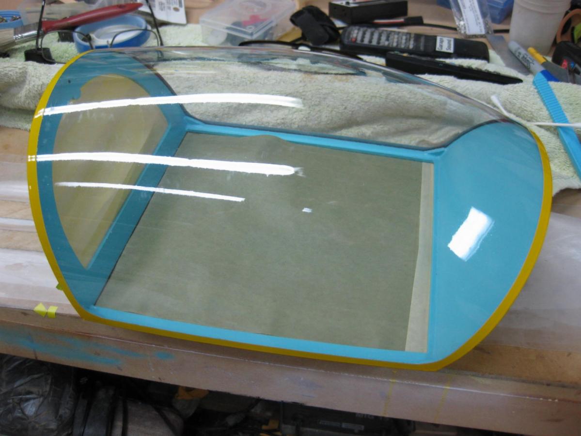

              trim on the canopy.......
