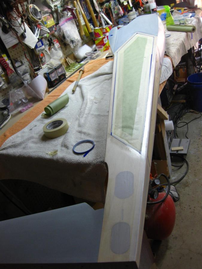

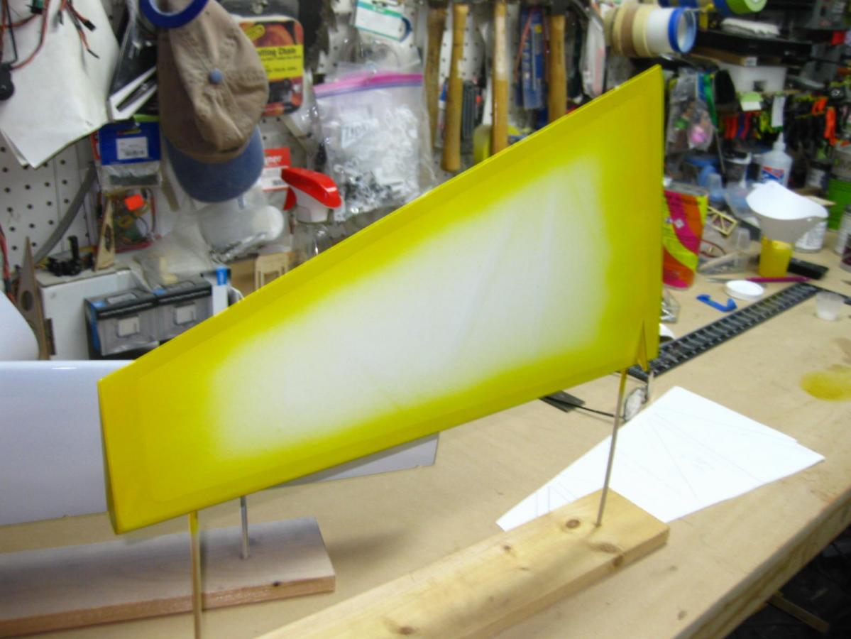

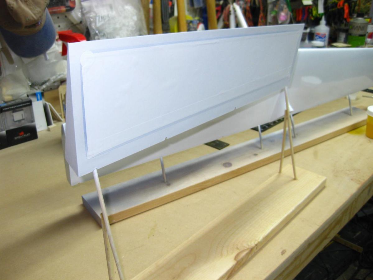

    And time to start masking the fabric area ( part 1 ) and add some primer..
ID:	26197Click image for larger version
ID:	26199Click image for larger version

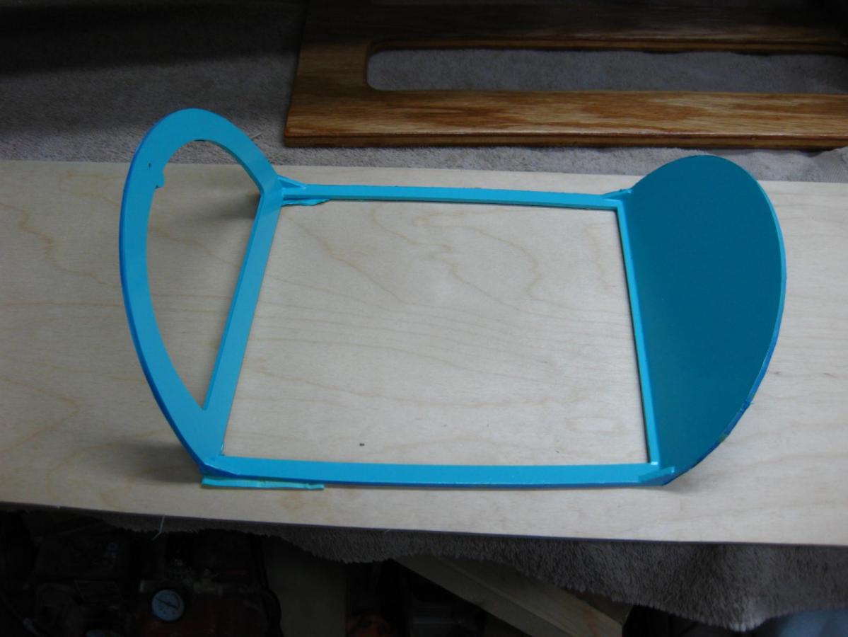

    Painted the Canopy frame light blue ( PPG Omini LV ) so it will match the rest of the Cockpit color.....

        Some masking........followed by a base layer of white..........followed by AeroThane 140 Orange-Yellow (thinned 20%)
        Pretty good gloss as you can see the paint mask backing paper on the stab.

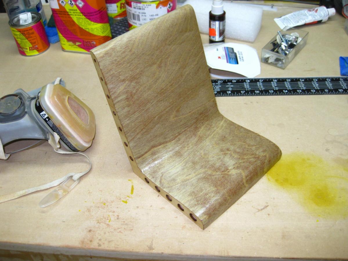

        And a coat of Spar Varnish on the constructed Seat.

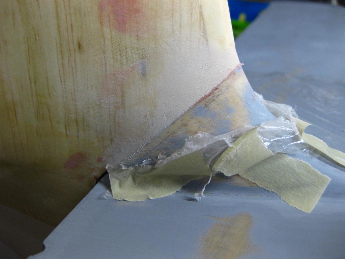

            Things were going along so well and then........I didn't fill the weave well enough on the D-box area.....( skipped the PolySpray step )
            Now I've got some sanding in my future.....nuts.......

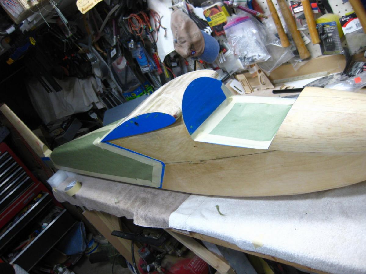

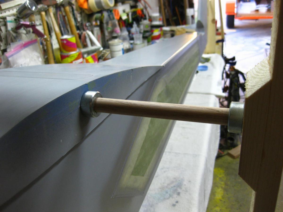

            Well - while I wait for paint to dry......moved on to sanding and masking the fuselage.......and filling the rear fabric that didn't get a clear coat
            Applying silver to the top of the rear fuselage section as it's going to be yellow and I didn't want the see-thru look.
ID:	26405Click image for larger version

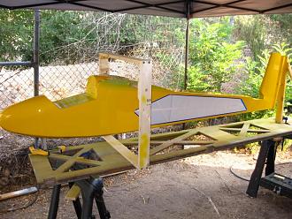

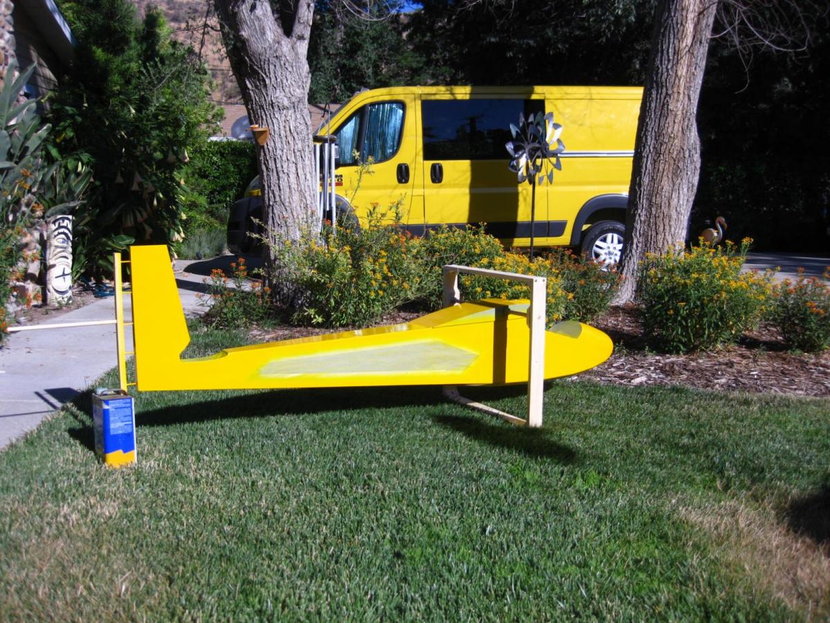

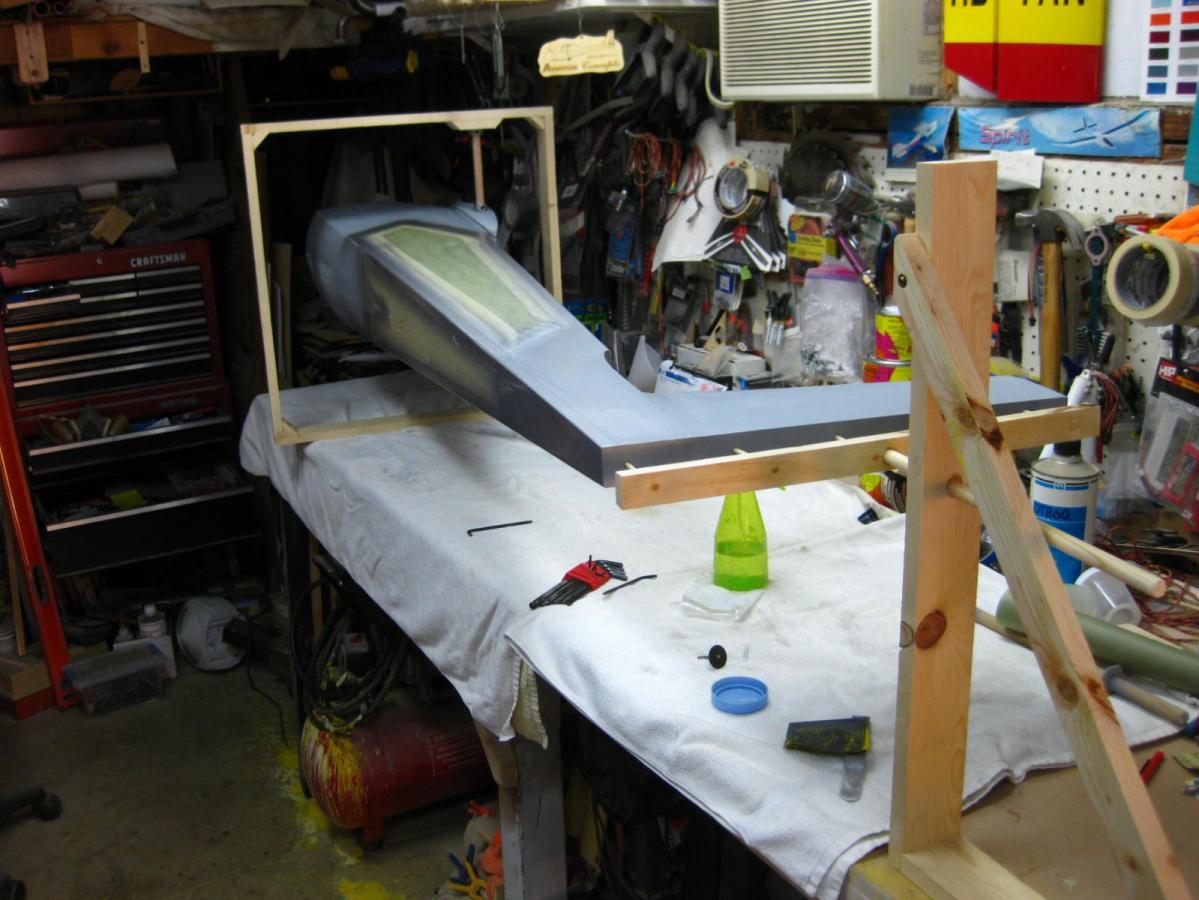

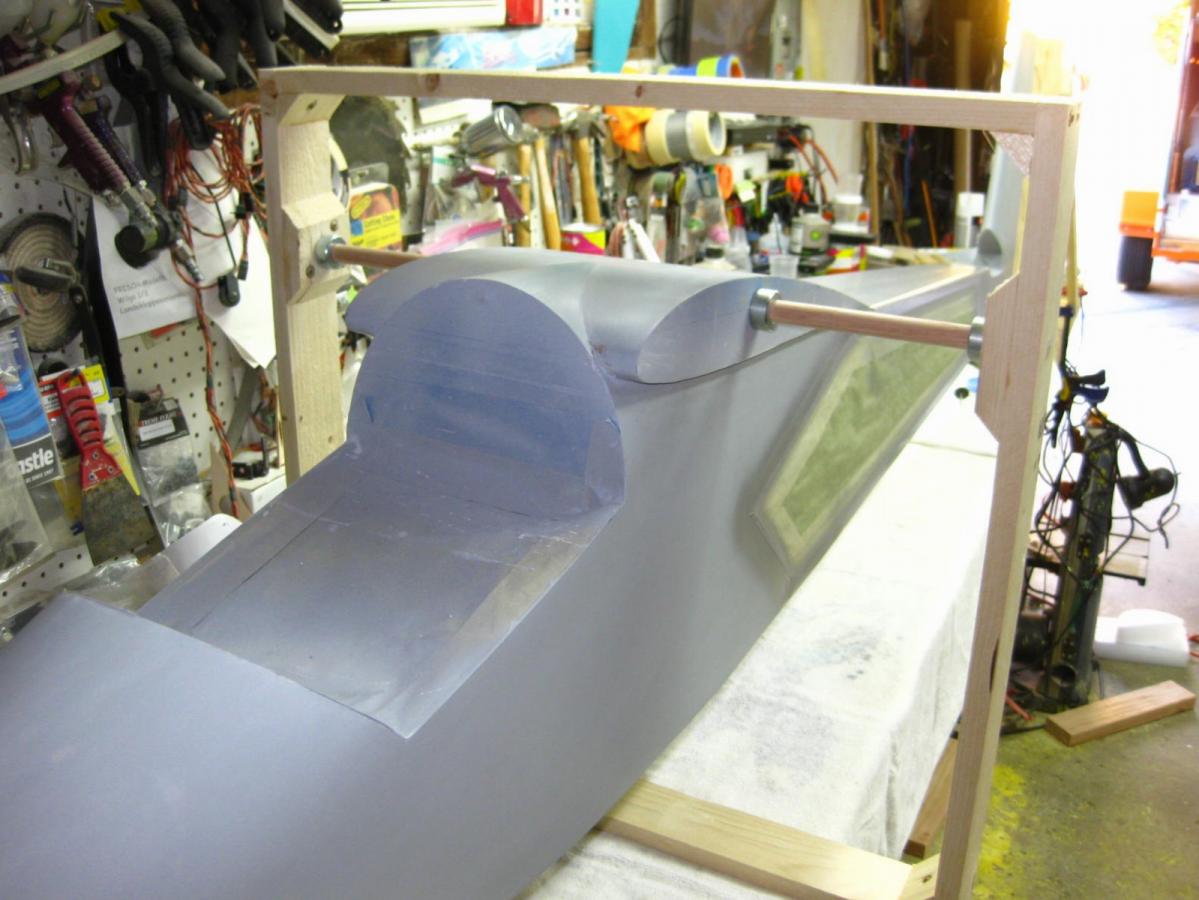

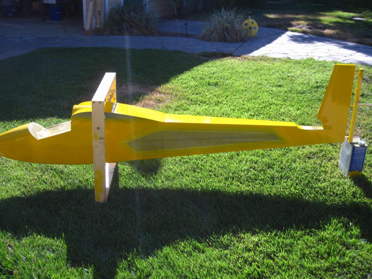

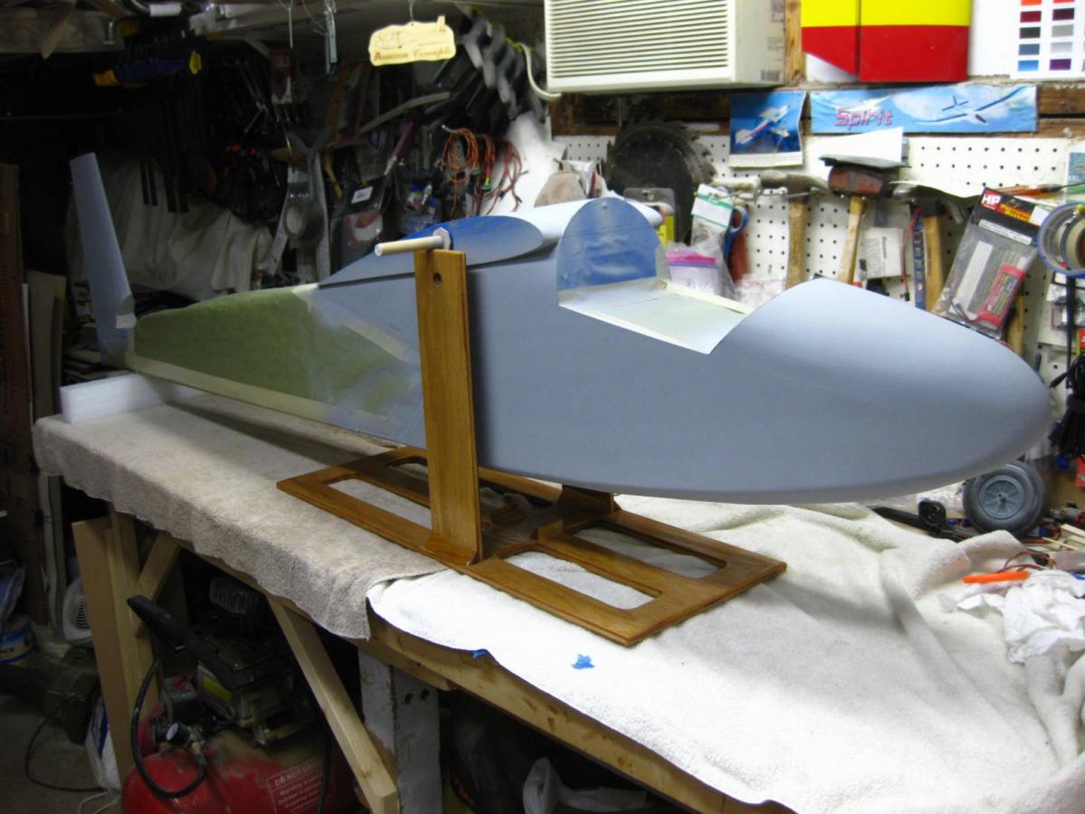

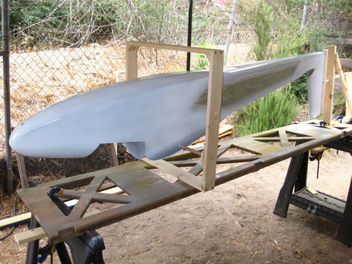

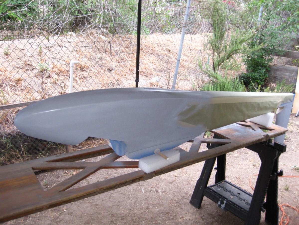

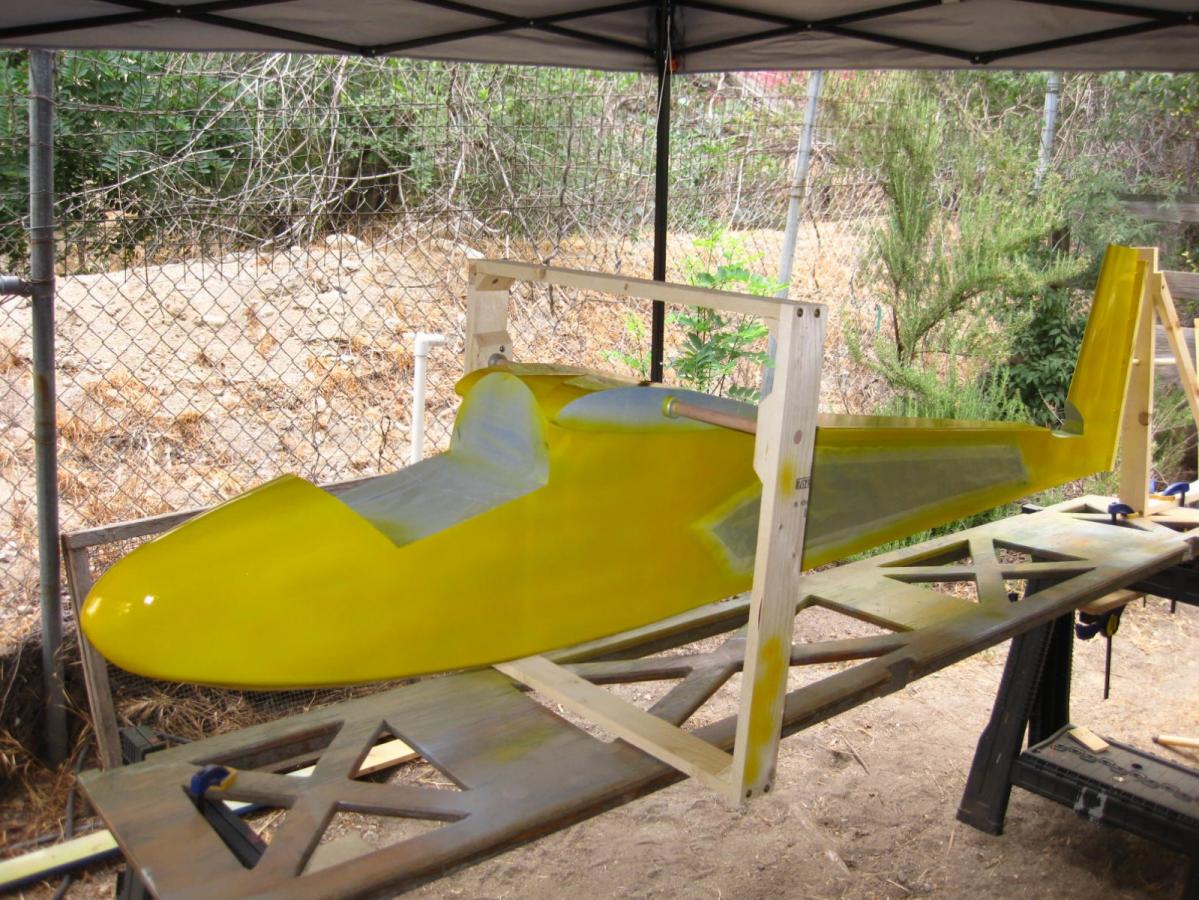

              worked out how to hold the fuselage while painting
              Click image for larger version  Name:	IMG_4487.JPG Views:	1 Size:	88.1 KB ID:	27262Click image for larger version  Name:	IMG_4488.JPG Views:	1 Size:	110.5 KB ID:	27263Click image for larger version  Name:	IMG_4486.JPG Views:	1 Size:	123.5 KB ID:	27264 Click image for larger version
              Two mist coats of white and then the yellow
              Click image for larger version  Name:	IMG_4491.JPG Views:	1 Size:	180.7 KB ID:	27266Click image for larger version  Name:	IMG_4492.JPG Views:	1 Size:	193.9 KB ID:	27265

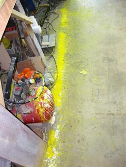

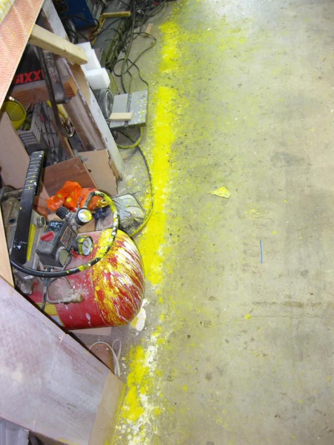

              Clean-up on aisle 2.........all the paint I sanded off my wings with 220 grit wet/dry and a spray bottle..
              Click image for larger version  Name:	IMG_4484.JPG Views:	1 Size:	88.5 KB ID:	27267

              That's a pretty slick fixture! That is really going to show up at altitude, too! Painting with yellow is murder. Takes a bit to get opaque... at least with dope it does! Red is sorta the same.
              • MarnochS
                MarnochS commented
                Yellow .....also known as ballasting with paint.....
                Ahahahaha!

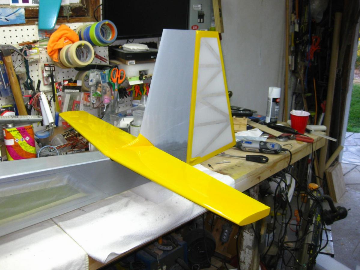

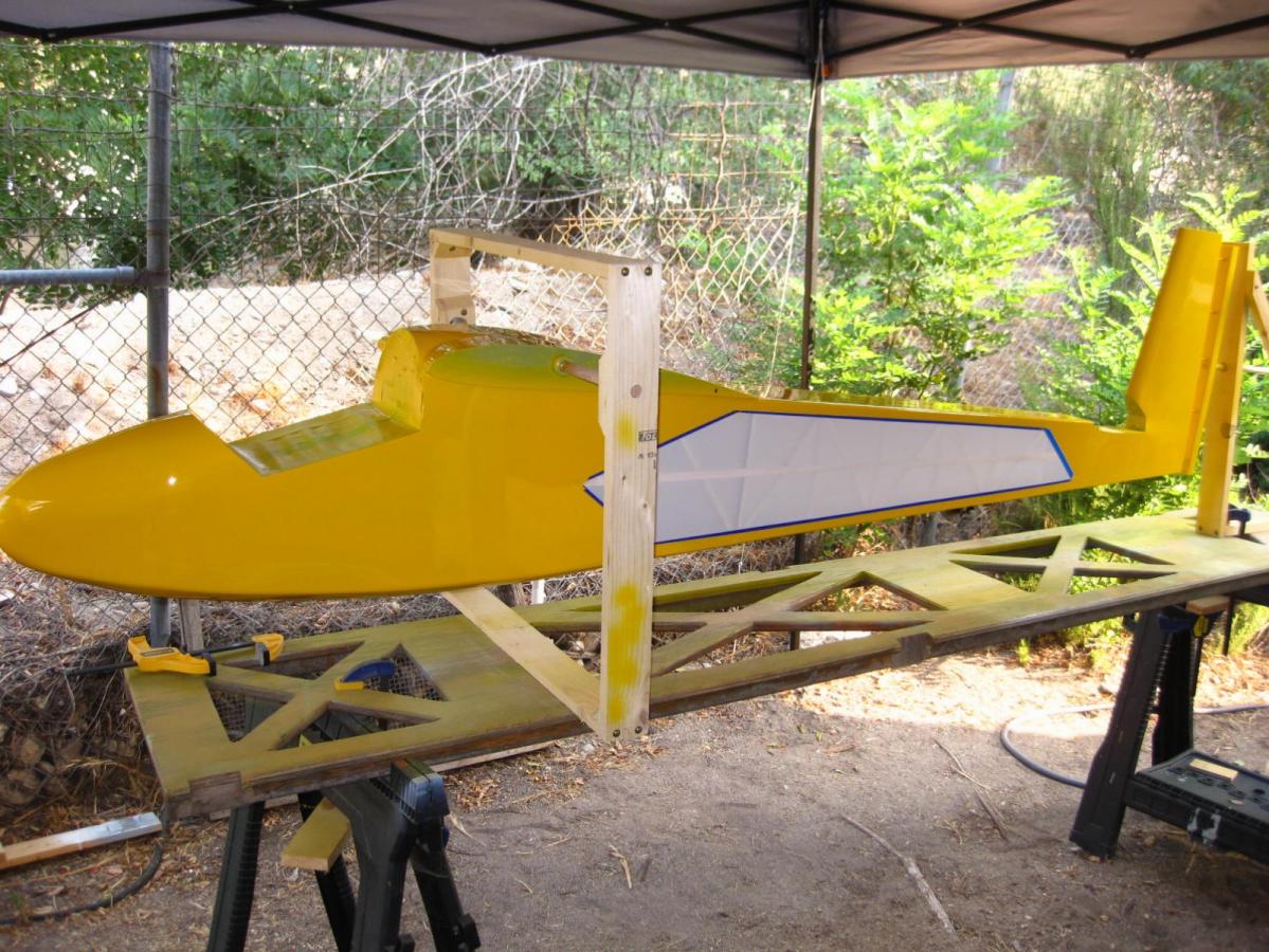

              Yellow............a quick color check with the "reference" subject..... ...the impulse to peel the masking tape back is nearly overwhelming.
              Click image for larger version  Name:	IMG_4493.JPG Views:	1 Size:	226.3 KB ID:	27292Click image for larger version  Name:	IMG_4494.JPG Views:	1 Size:	192.9 KB ID:	27293

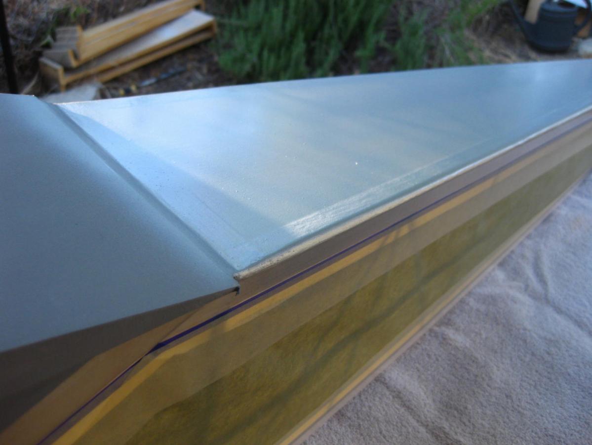

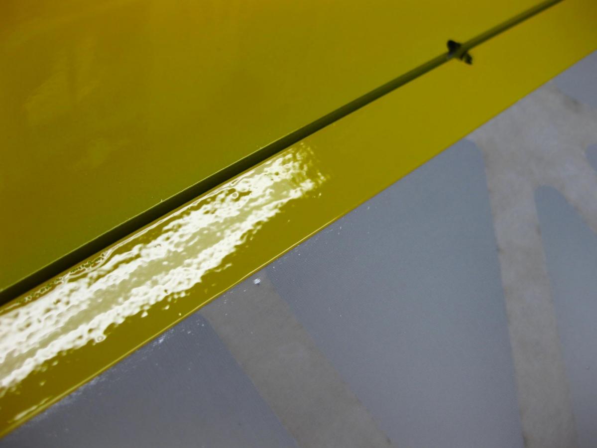

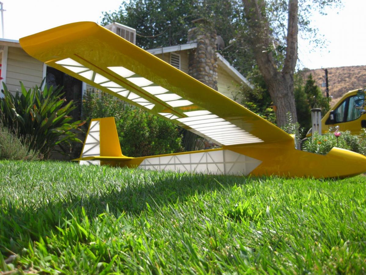

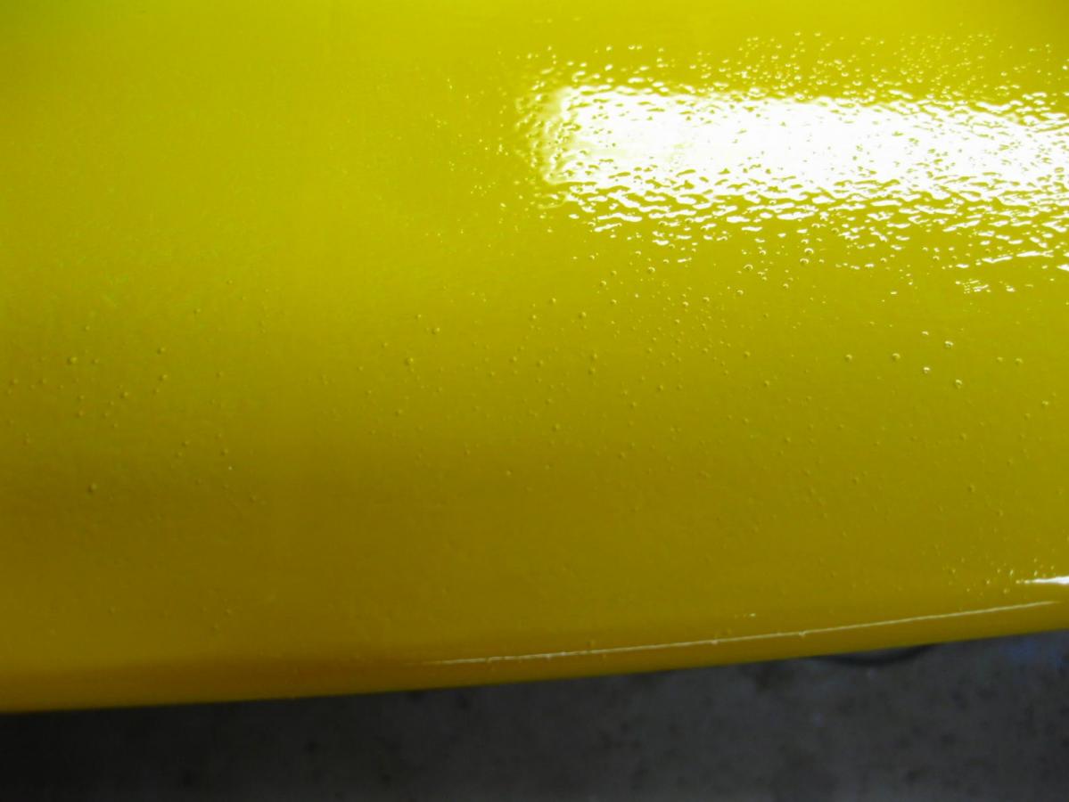

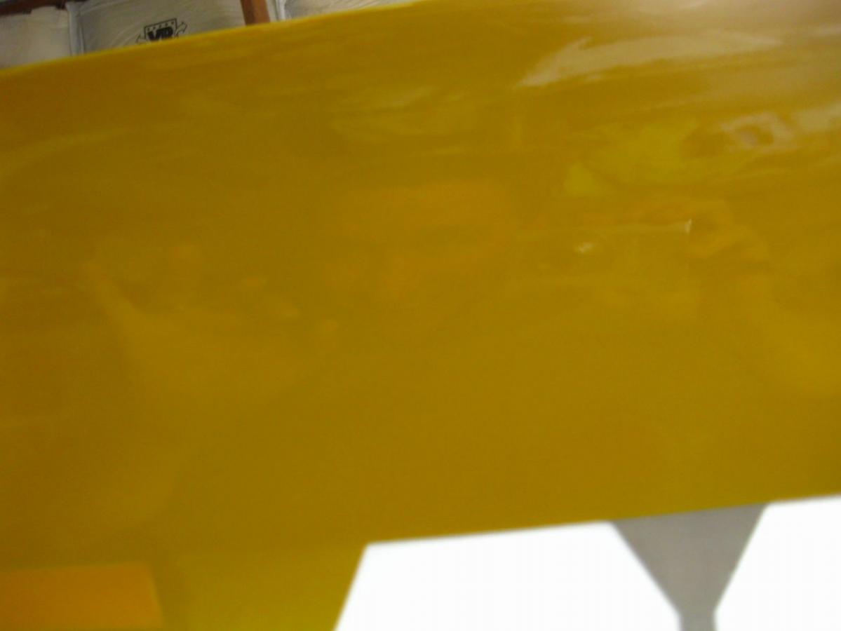

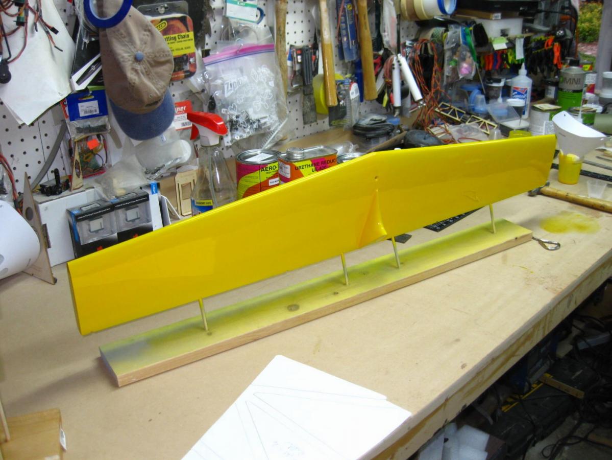

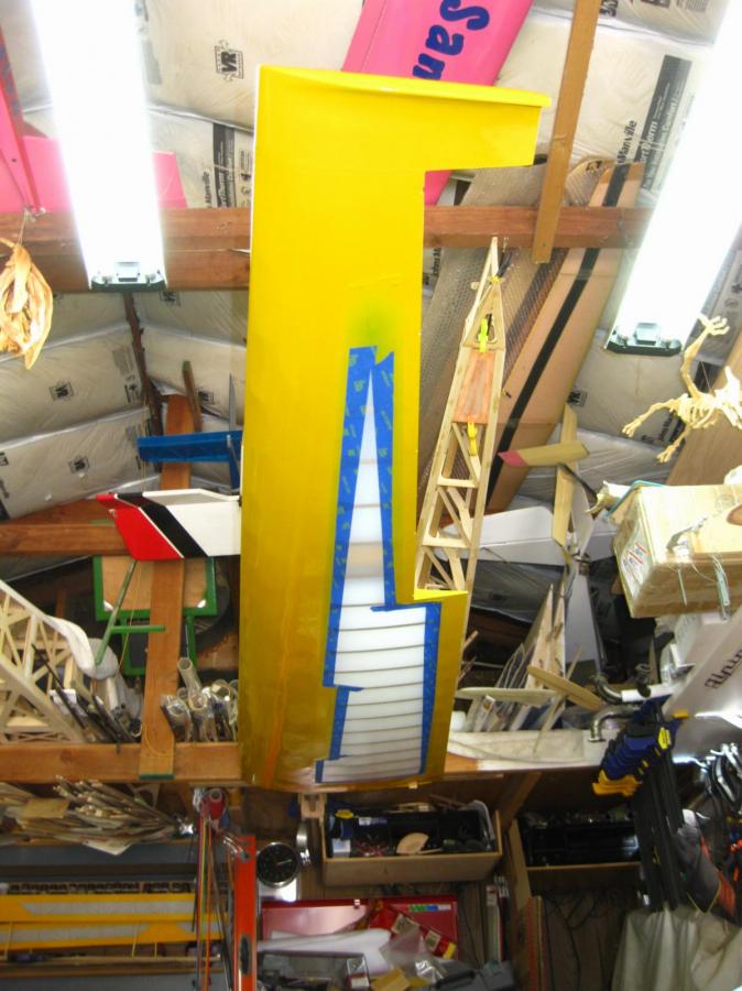

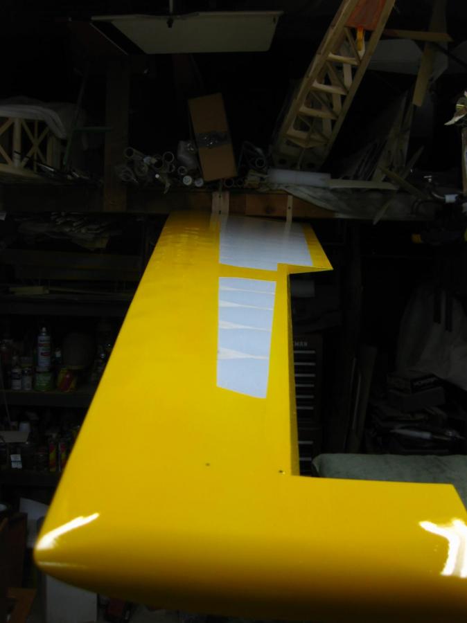

                Finally got over the wing painting hurdle.....................checking the "gloss"
ID:	27896​ Click image for larger version  Name:	IMG_4501.JPG Views:	1 Size:	34.7 KB ID:	27762

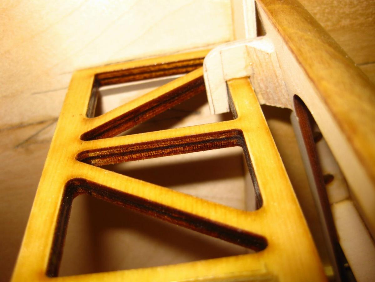

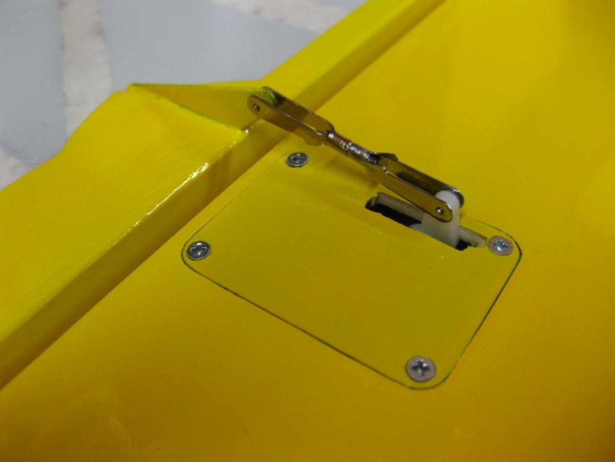

                Stabilizer completed. Used some DS368 servo horns and 2-56 threaded clevis that were cut down to fit and then it was glued together.
ID:	28577Click image for larger version
ID:	28578Click image for larger version

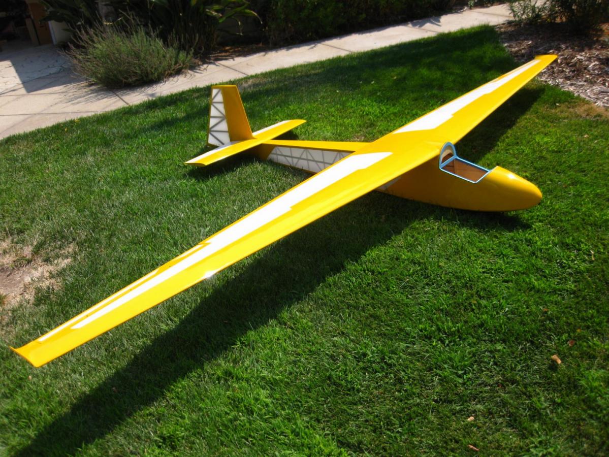

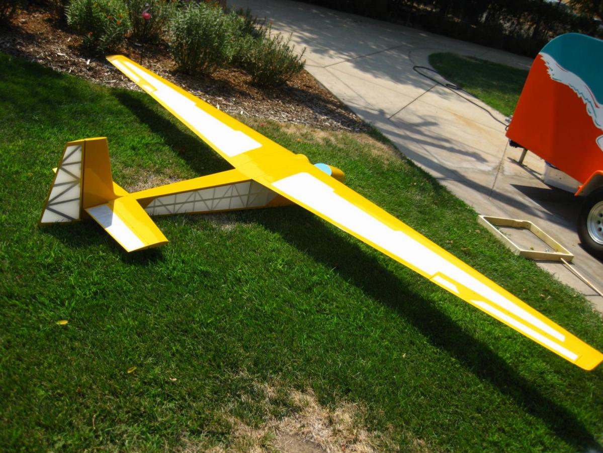

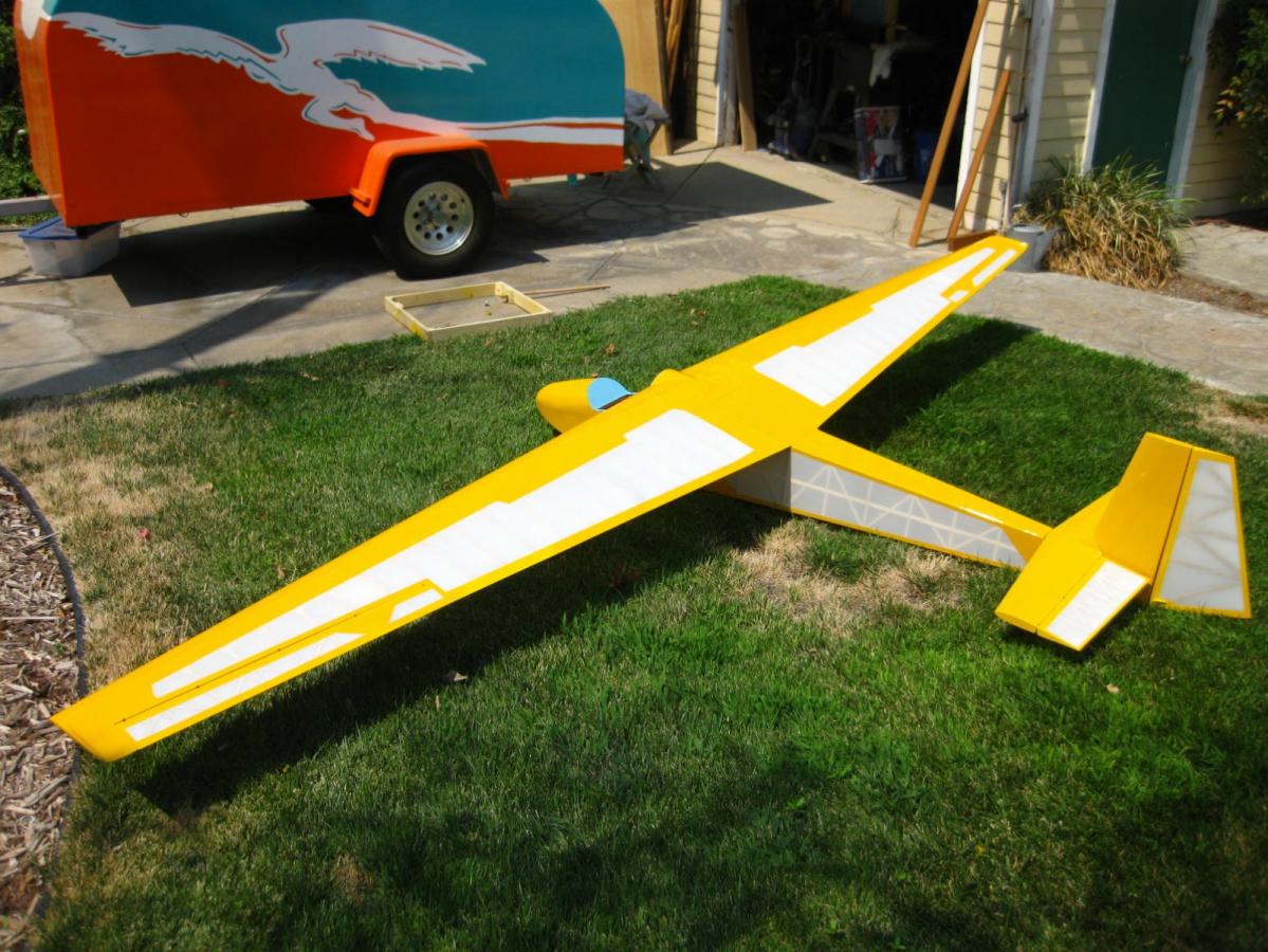

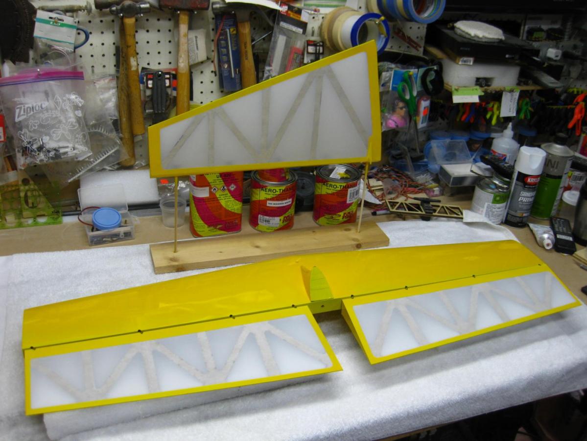

                As requested...... the Swallow that is Yellow
ID:	28597Click image for larger version
ID:	28595Click image for larger version
                90% done..............90% left to do......

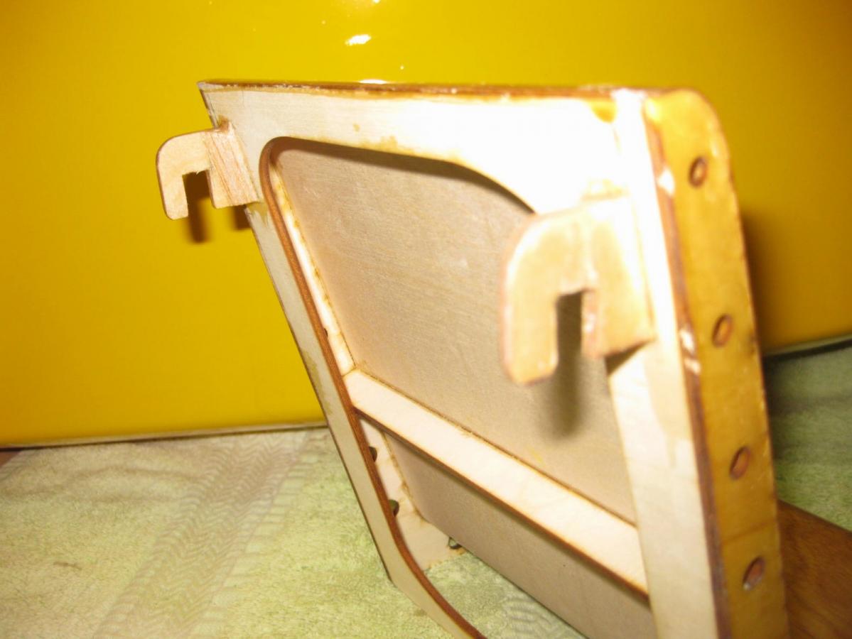

                      Big day for the Swallow.

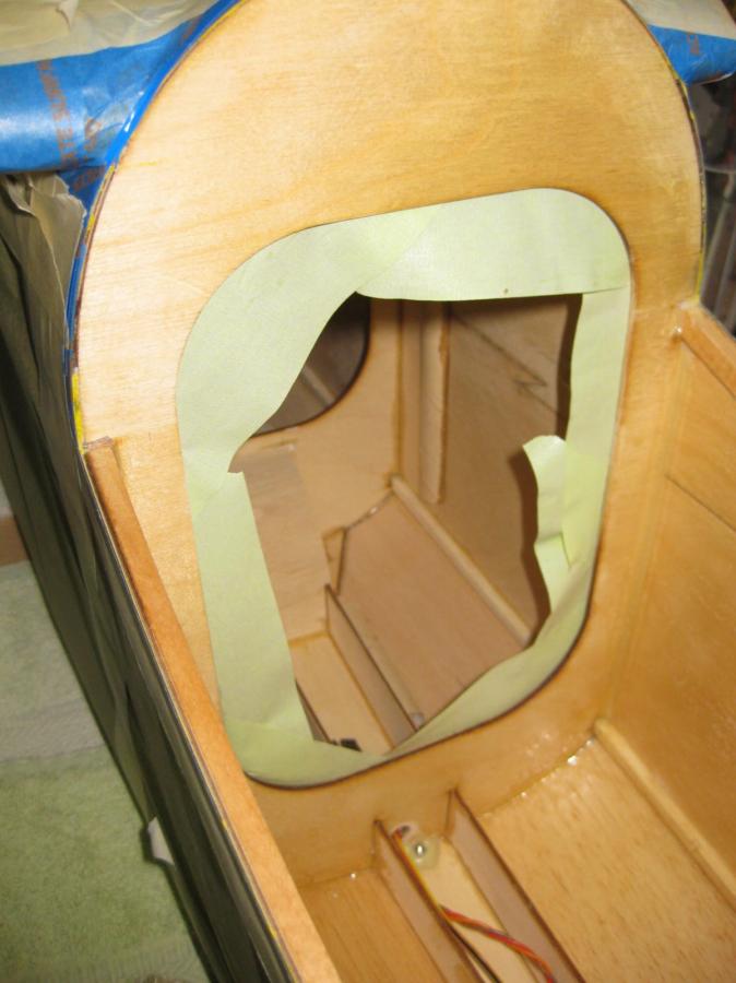

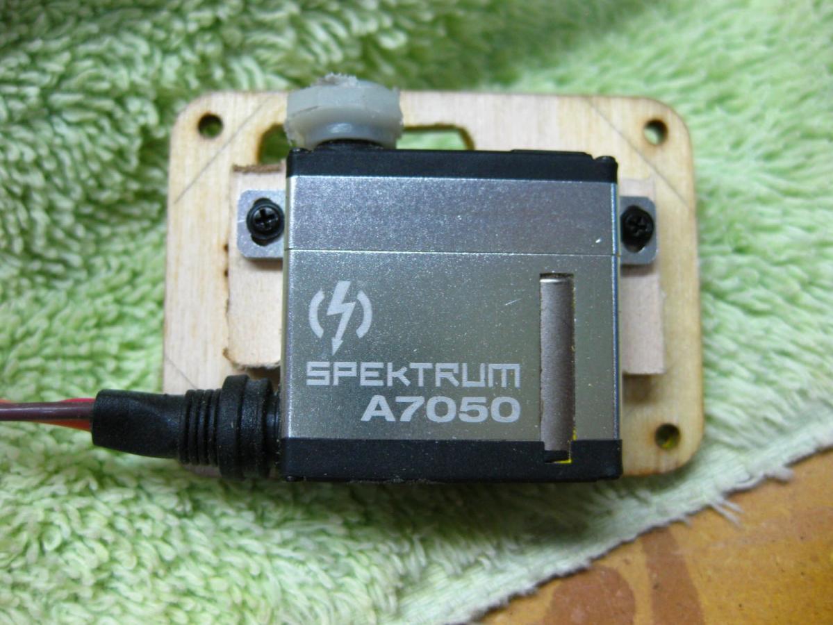

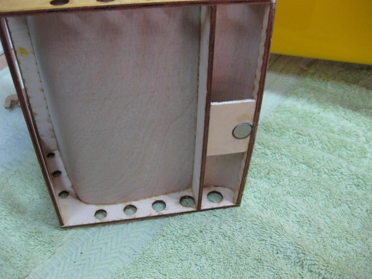

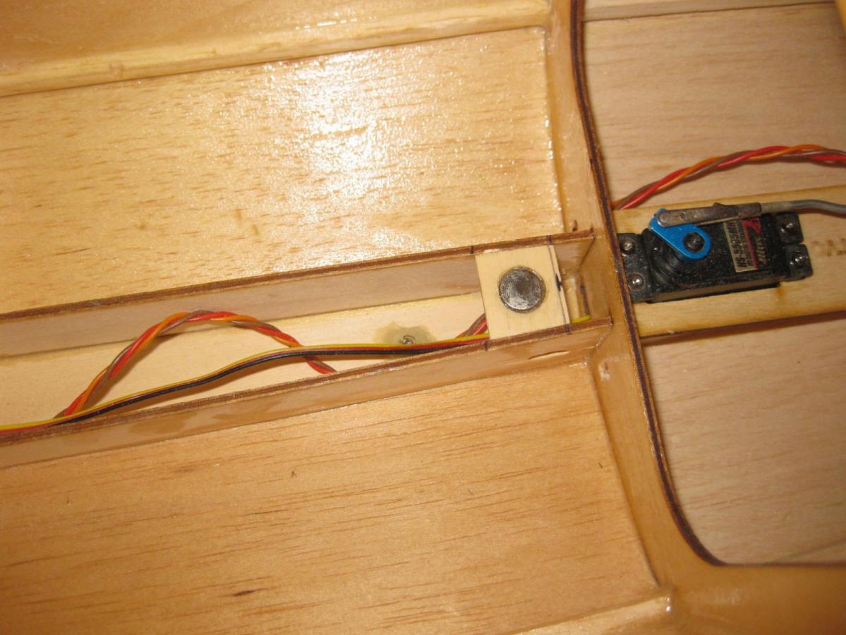

                      Seat mounted using the Rudder servo tray hooks on the back and a magnet on the front.
                      Click image for larger version  Name:	IMG_4542.JPG Views:	1 Size:	87.0 KB ID:	29607Click image for larger version  Name:	IMG_4544.JPG Views:	1 Size:	78.3 KB ID:	29602
                      Click image for larger version  Name:	IMG_4546.JPG Views:	1 Size:	117.0 KB ID:	29601Click image for larger version  Name:	IMG_4547.JPG Views:	1 Size:	119.3 KB ID:	29604

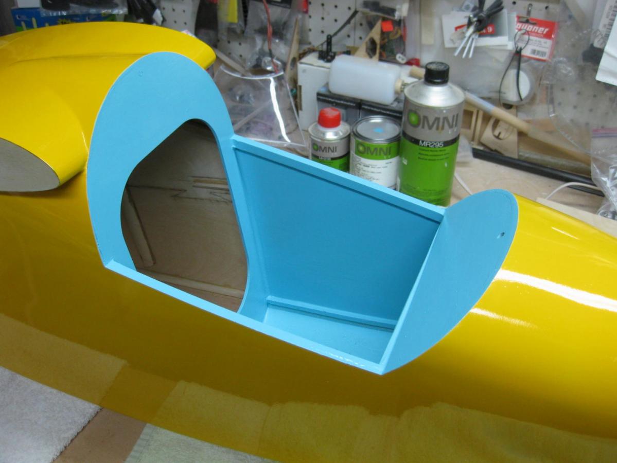

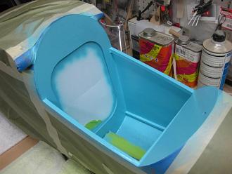

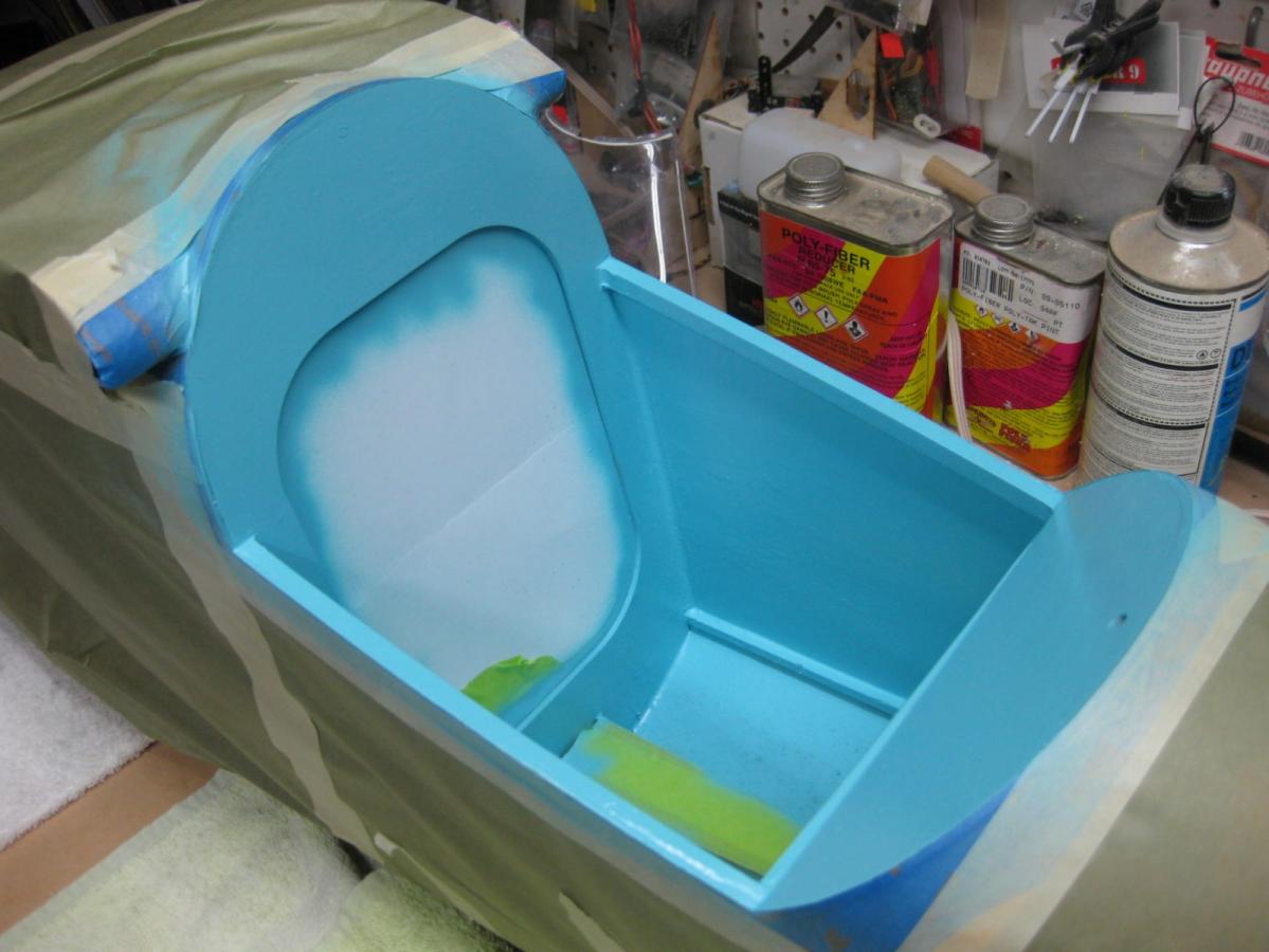

                      With the servo wires routed, it was time to paint the Cockpit light blue with my trusty Paasche Airbrush.
                      Click image for larger version  Name:	IMG_4548.JPG Views:	1 Size:	58.7 KB ID:	29603Click image for larger version  Name:	IMG_4550.JPG Views:	1 Size:	92.1 KB ID:	29600
                      I couldn't stand it any longer and had to take the masking off.......

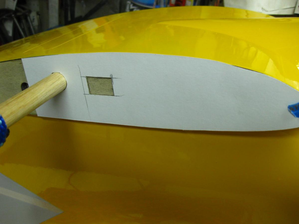

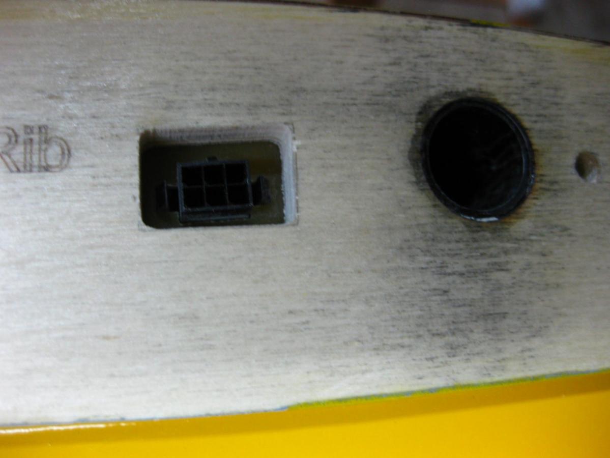

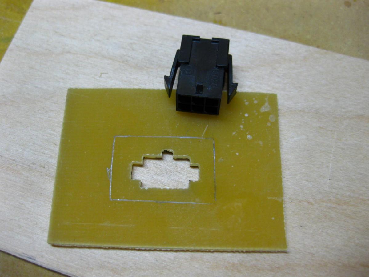

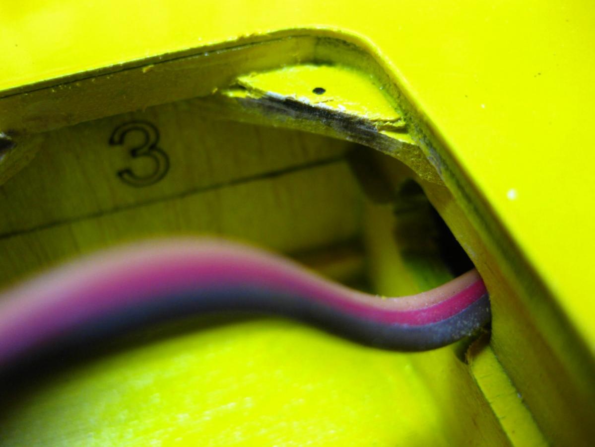

                      Going to try Molex MicroFit 3.0 locking connectors for the wing root. Since I didn't want any wires showing in the transparent covering, I ran the wires through the D-box area..... so a template was made to replicate the new hole location.
                      Click image for larger version  Name:	IMG_4537.JPG Views:	1 Size:	87.4 KB ID:	29606Click image for larger version  Name:	IMG_4536.JPG Views:	1 Size:	56.3 KB ID:	29605
                      Click image for larger version  Name:	IMG_4539.JPG Views:	1 Size:	74.1 KB ID:	29608
