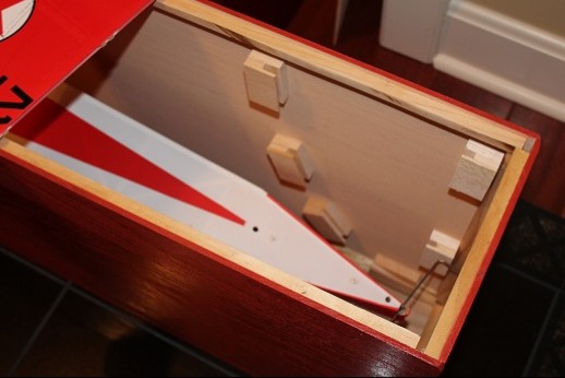

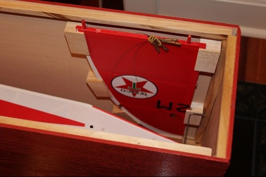

              The Eaglet fuselage had been riding to and fro aerotows on a cradle. I always worried something might fall on it since was exposed. The tail feathers had to be carefully wrapped then put in another sailplane box so there was always concern for damage or forgetting them altogether. I built a nice box and painted it red. The fuselage nestles nicely and the tail feathers are getting their own space within the box. Balsa 'friction clips' hold them in place. I don't know what the technical term for them is but here are a couple of pictures. Just pull upward to remove!

              The fin has its spot! Now on to the stabilizer, elevators and rudder. The struts will get space, too! Don't want them getting lonely!

                    Thanks Al! It works great keeping the silk covered tail surfaces from turning into potato chip shapes. I had been carefully stacking them then using books as weights to keep them flat.
