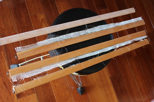

              The weather was fair so some work got done on the Eaglet's struts. 4oz. cloth and polyester resin put on then they were sanded. Once the weather gets warmer (need >~70 degrees) they'll get resin and microballoons for finish sanding prior to painting.

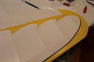

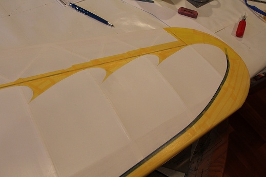

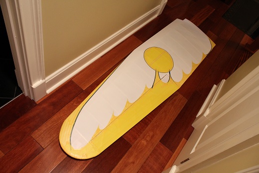

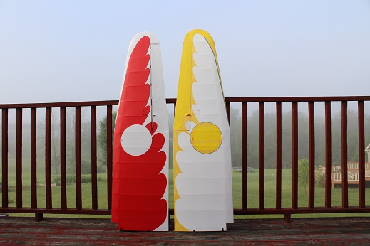

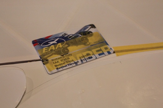

                I've been busy! Masking tape galore! The wing 'feathers' took forever to mask!!! They are done so that's all that matters. Vinyl (HyStick blue 1/4" and 1/8" found at auto paint supply stores locally) tape gives a better edge but some of the curves are too tight in radius to use it. The yellow tape is 'Nitto Tape', also found at auto paint supply stores. It is a lower tack that your regular masking tape and doesn't leave residue behind. Segments of yellow tape were stuck to a credit card size I.D. card. The paper mask used to pencil the 'feathers' onto the wing was used as a guide to cut the curves in the mask. Tedious but doable. Have good magnifying glasses! The SIG Light Red dope was thinned 50/50 and shot from my Badger Touch-up gun at 30lbs of pressure. The tape edges were burnished down using the back od a fingernail just prior to painting. The first 'mist' coats were sprayed at ~30" so that the taped edges would gradually be sealed. If you spray too heavy then the thinners can cause the tape to unstick which results in unwanted seepage. Some folks lay on a coat of paint that is the same color as the base coat to guard against this. Pick your poison. I'm just lazy and don't want to go through an extra step of cleaning the gun. Plus... while I wait for mist coats to flash I can sip a nice cool Sammy Smith Oatmeal Stout!
ID:	10433 Click image for larger version
ID:	10435 Click image for larger version
                Clear coat is next, followed by Texaco stickers. Stickers were used on the original so that is 'scale'! The struts needs surface prep then paint. All that is left then is radio install, pilot 'office' detail and lead for balance.

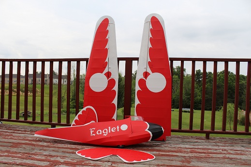

                            Jeremy, I haven't packed to see if bike will fit this year but if we do ride I can give you a tow! The Eaglet is clear coated and the skid and struts have a coat of resin and microballoons! Tonight, if the resin is cured hard enough (it's been unusually cool here in KY) they will get sanded in preparation for paint. Some lead has been added to the nose... more needed but will get done this weekend at final assembly. The turnbuckles on tail group will get safe-tied after proper rigging at trial field assembly. The pilot's sling seat will get fabbed and the stickers get placed. Whew! It's almost an 11th Hour thing!
