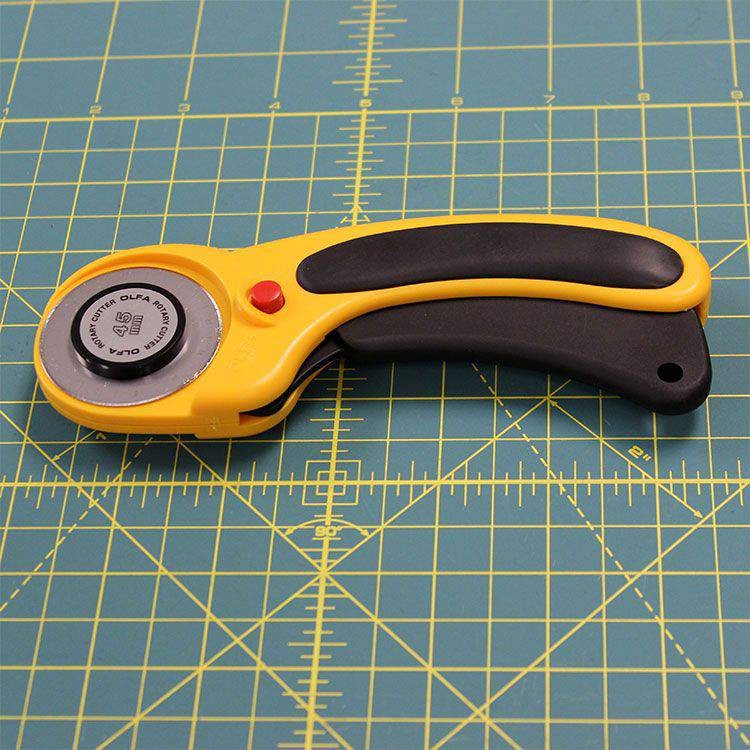

            • Just a small tip Gene, if you use a cutting wheel versus scissors, you will find the cloth will not fray!
              SCC​​​​​AAA TT TN
              • Not to confuse anyone with a Dremel cutting wheel but a pizza cutting wheel.
                This is what I use and it's available at Jo Ann's or Fiberglast.

                  Olfa are the best!

                  That's the problem in my situation, no cutting pad. To layout and cut the 0.075oz cloth I'd need a pad at least 38" w x 90" long. Butcher paper was spread out on the basement floor to lay the fabric on to mark and cut, but that's past history now.
              • Oh well, I would have taped down one or two layers of the wide blue tape.
                • Gene C
                  Gene C commented
                  That's a thought I'll have to cubbyhole for future use. Thanks,
