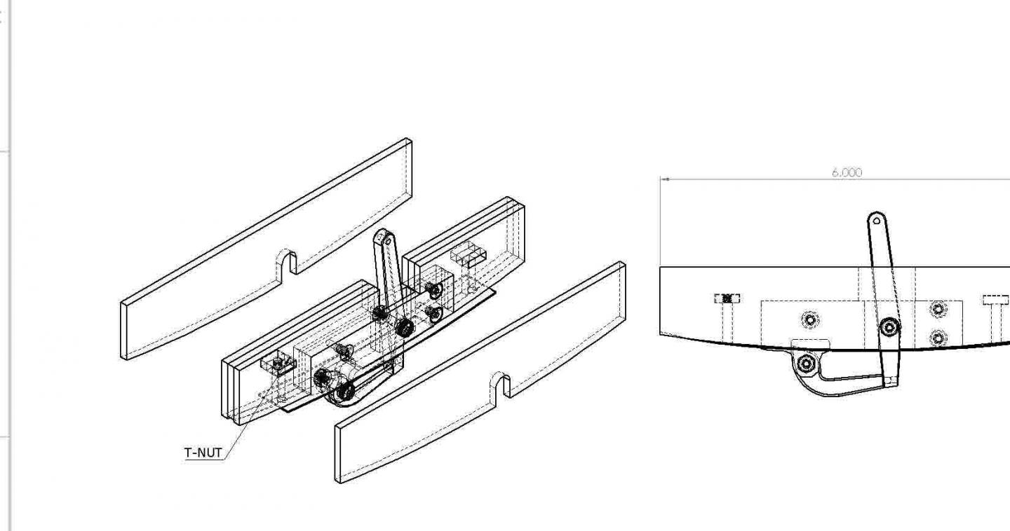

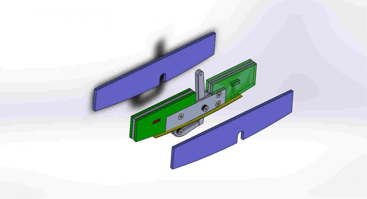

    Did some redesigning of the Tow release install this evening. This is a very rough design. But gives you guys some of the ideas or concepts that Gunny and myself talked about today. This system uses square-nuts inserted into the 3 keel plates which will hold the .020 thick spring steel cover plate. This would allow for tow-release removal for service if needed.

    • Mosquito
      Mosquito commented
      You could lock me in a dungeon with all the computers at my disposal and only let me out if I could add neat graphics like you did above, and I would be found by future explorers in the next century. Nicely displayed!
  • #82

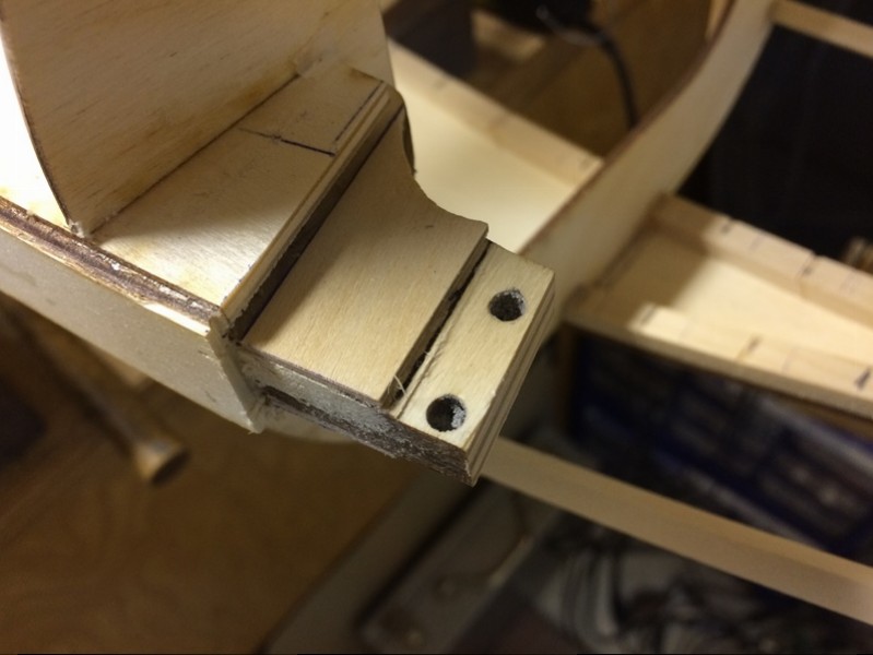

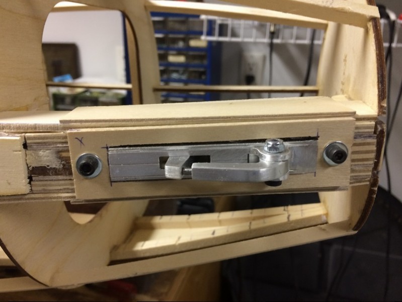

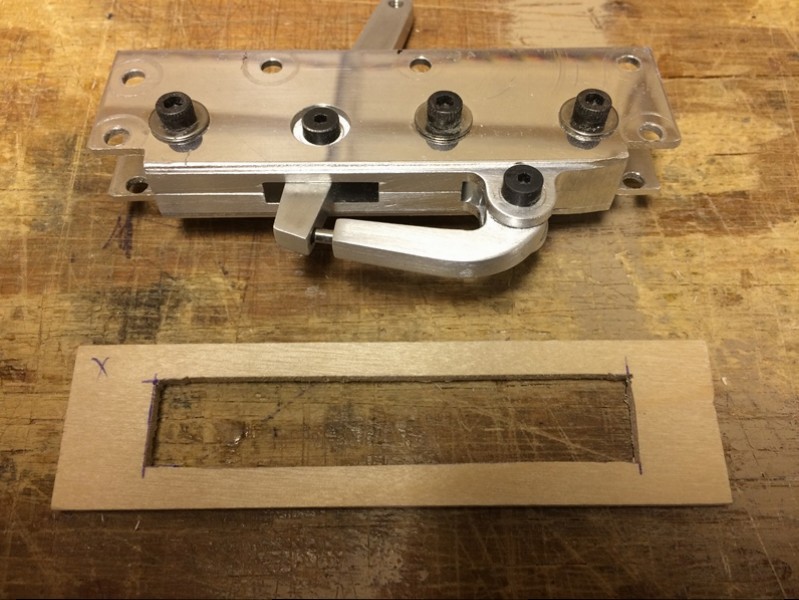

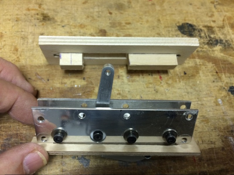

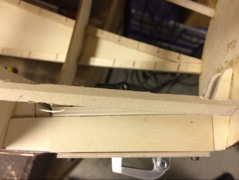

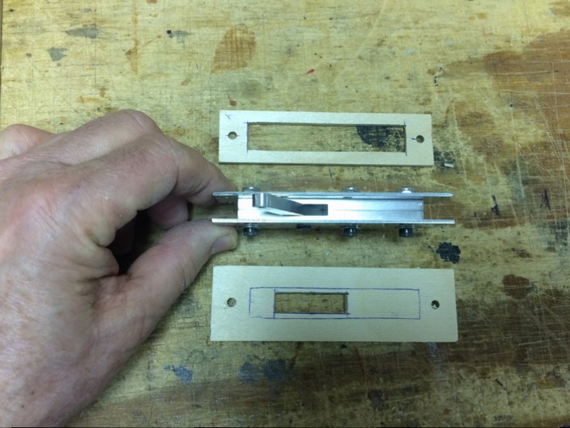

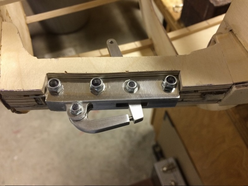

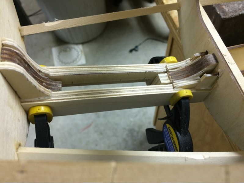

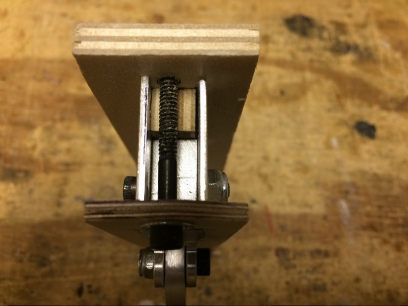

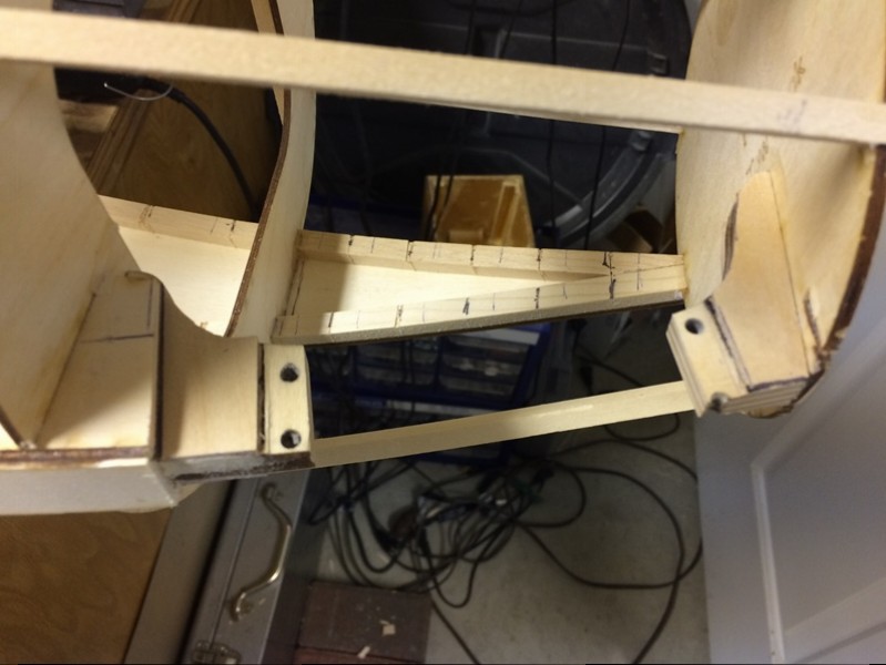

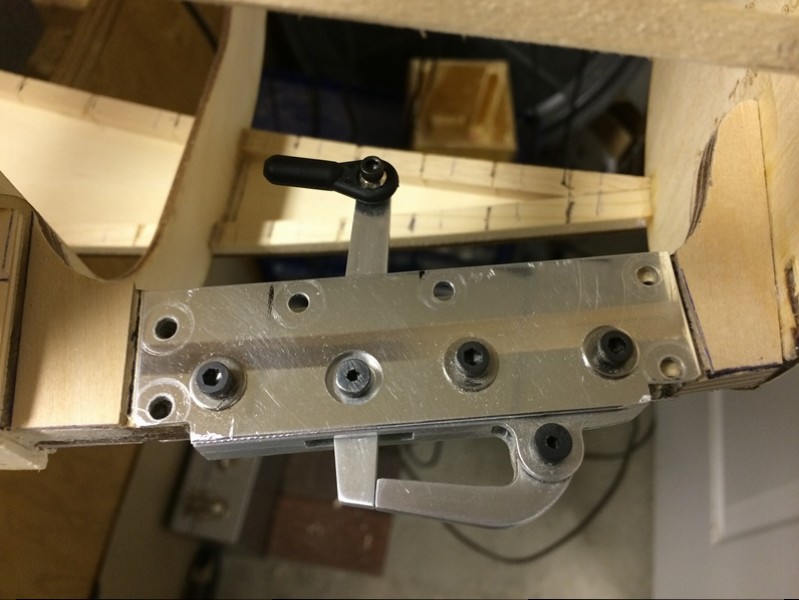

    Since the plane is going to need weight in the nose anyway, a little extra structure is not going to hurt. Here is my solution for a removable option.
    First, the release seems to have way too many through bolts so we took out six of them. Then we made a box that the release slides up into. It will be held in place by two vertical screws (one in front and one in back) that will thread up into a T-nut in a top plywood plate. basically, the release will be captured between a top and bottom plate that squeeze between the verticals of the keel.
    Not finished making all of the parts yet, but this gives the idea.

    • #83
      Right on Erich. There you go Jim.

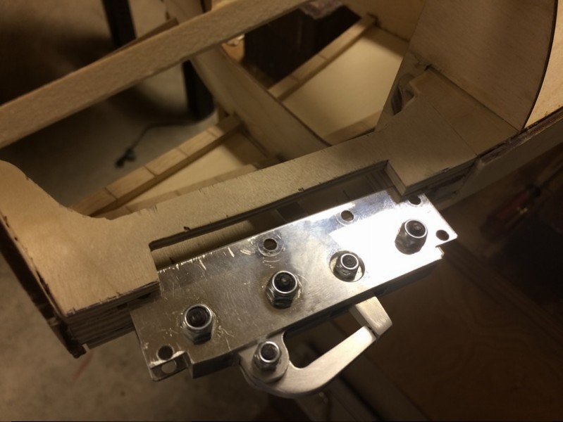

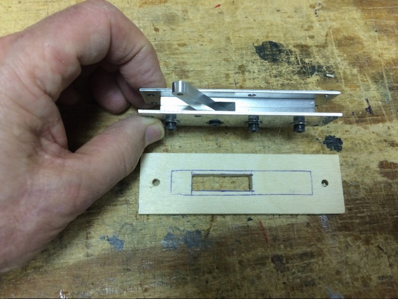

        Fabricated the top plate that will hold the T-nuts.
        Click image for larger version  Name:	13.JPG Views:	1 Size:	108.9 KB ID:	23299
        Release will be captured between top and bottom plates.
        Click image for larger version  Name:	14.JPG Views:	1 Size:	110.2 KB ID:	23303
        Needed to provide a lip around the bottom plate for the 1/8" thick balsa sheeting to attach to. It would be great if this bottom plate could be machined out of aluminum and have counter sunk 6-32 screw holes.
        Click image for larger version  Name:	15.JPG Views:	1 Size:	83.9 KB ID:	23302
        1/8' balsa sheeting will fill in level with the 1/8" thick bottom retainer plate. These plates squeeze the release between the side keel pieces...This will NOT pull out!!!!
        Click image for larger version  Name:	16.JPG Views:	1 Size:	67.4 KB ID:	23301

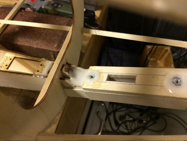

        Inside fuselage looking at top plate with T-nuts installed.
        Click image for larger version  Name:	17.JPG Views:	1 Size:	77.5 KB ID:	23300

          Just to be even more OCD about this, we put filler blocks into the top plate that further lock in the top of the aluminum mount.

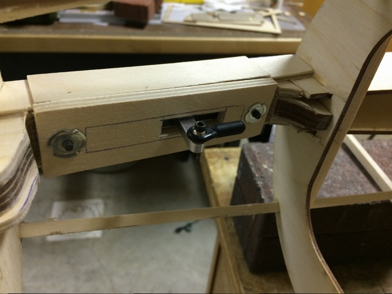

          Then the servo tray was installed and the T-nuts epoxied in place.

          Okay, I think I am happy with the tow release now!
            Jim would it be possible to countersink the bottom ply plate so you could install flat head screws! Would look a little cleaner.

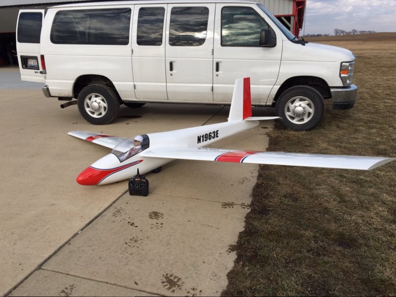

                That handsome young Aussie lad went flying today. Cold outside, I bet it left him happy and warm inside!

                  You beat me to it...
                  Note the new Spektrum iX12 transmitter that was used...
                  Peter says he did loops, rolls, stall turns, and a speed run/flutter test (to make sure it is Len grade)...very happy with results!!!
                    Staged! I wanna see in-flight pics! Anybody can hire a bum off the street to act as a model to hold a sailplane! So until then... I'm a Doubting Thomas! lol
