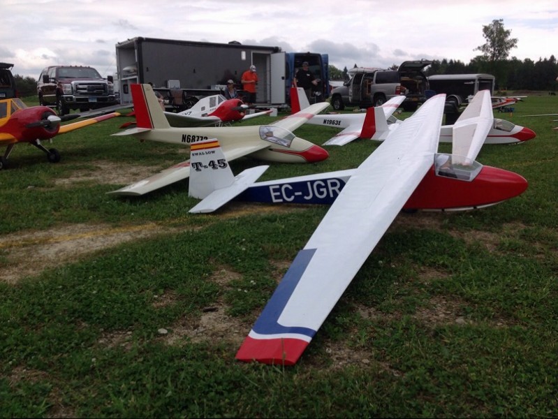

  • #61
    The Swallow sitting in a gaggle of Peter Goldsmith Designs models.

      No.152 issue of Vintage Glider News shows the Spanish EC-JGR flying!

    Great job on the covering scheme Jim.
      Thanks Erich!
      Got the maiden plus one late in the day today...what a sweet flying sailplane!!!
