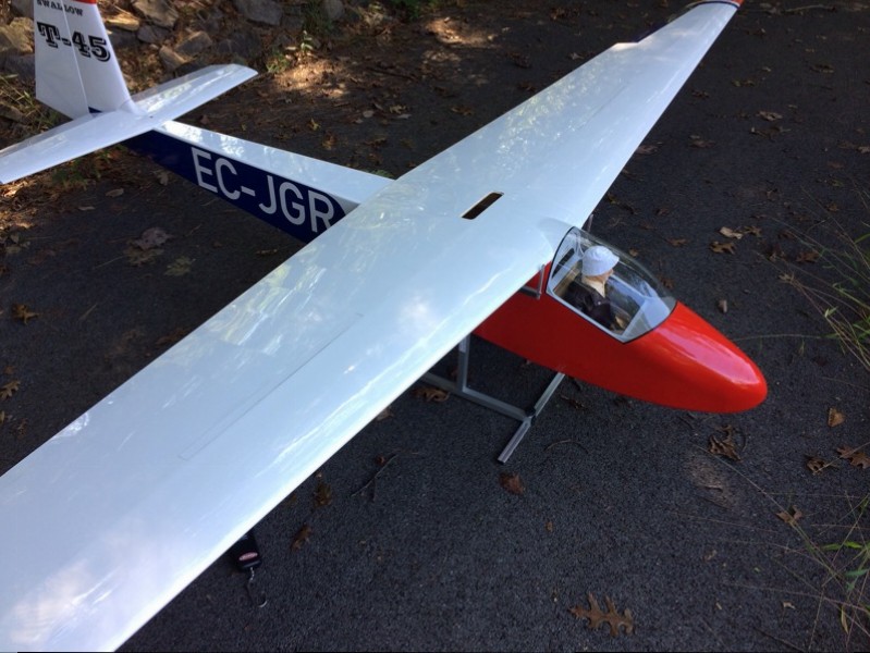

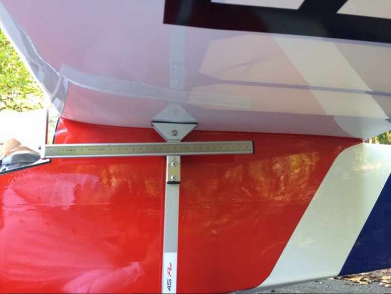

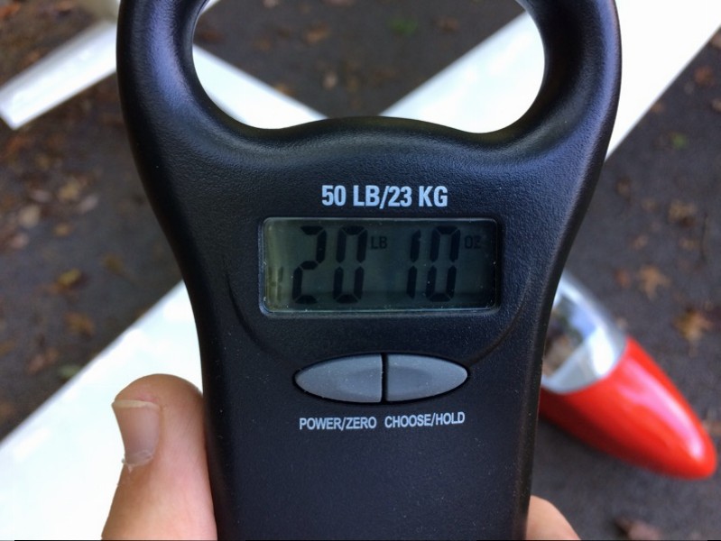

    Since completing the Swallow, about two dozen flights have been logged and the plane has been trimmed to suit my flying style. After making a number of adjustments to the balance point during the first flights, we have now flown the Swallow at different locations under different conditions and are very satisfied.
    Current AUW is 20 pounds 10 ounces
    Center of Gravity (measured at the root) is 179mm.

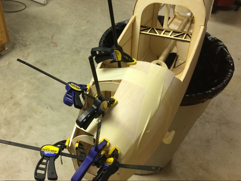

    Hi Dennis,

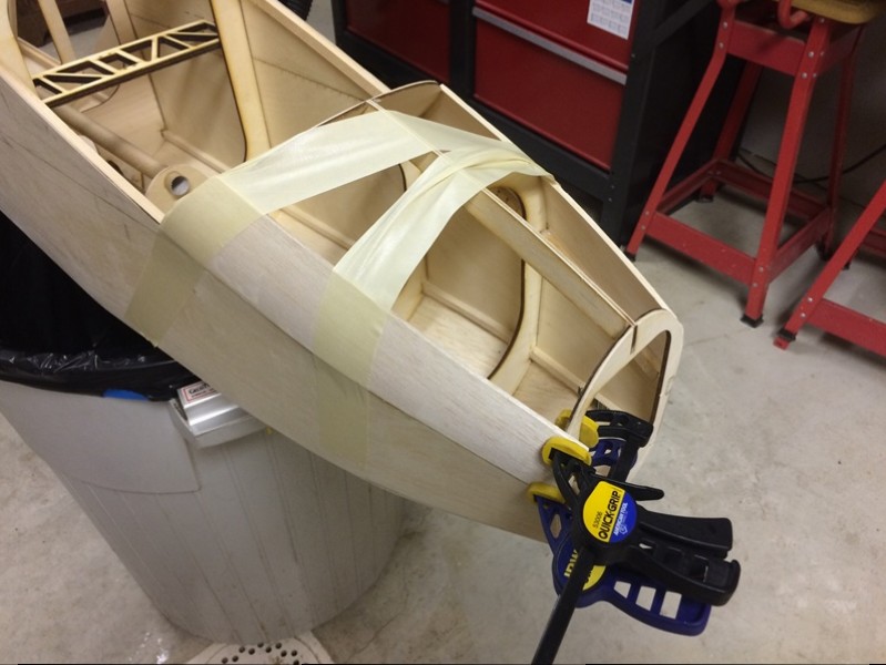

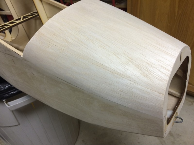

    It would be very easy to modify the canopy opening by adding another former before completing the top balsa sheeting. Then a new canopy frame could be made to fit the opening... and maybe the canopy supplied could be cut down to work on the new frame.
    My model is covered with Ultrakote and we used Deluxe Materials Cover Grip to lock the edges (love this stuff!!!).
    Here are some pictures taken around the time I was sheeting the top of the fuselage.

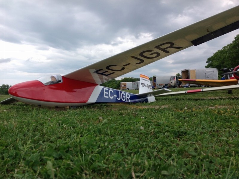

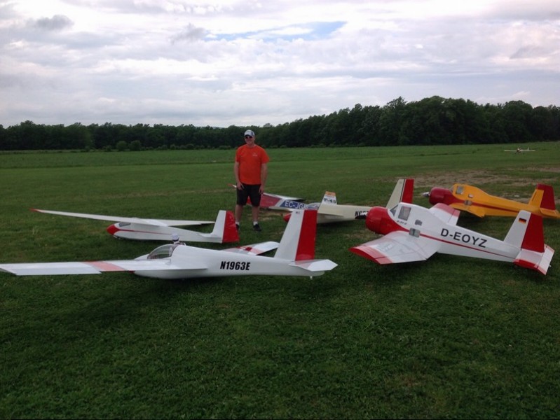

    The Swallow made numerous flights at both the Windy Ridge Aerotow and the Horizon Hobby Aerotow, so we have a fairly good read on its flying characteristics.
    A lot of people looked at the Swallow and asked questions about it. I'm sure there are other people out there with other questions, so don't be afraid to ask.
