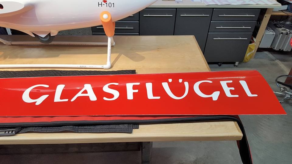

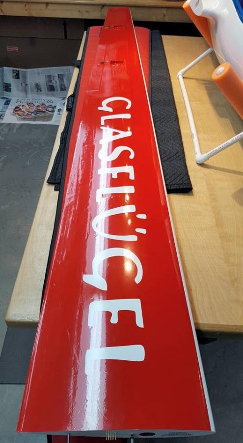

Today was a good day! Very good because somebody just made it into the paint booth!
Modellbau Hans Muller 7-meter Salto Restoration
We contracted with the same workshop quality assurance firm as Jim Dolly uses. The white paint inspector approves!
