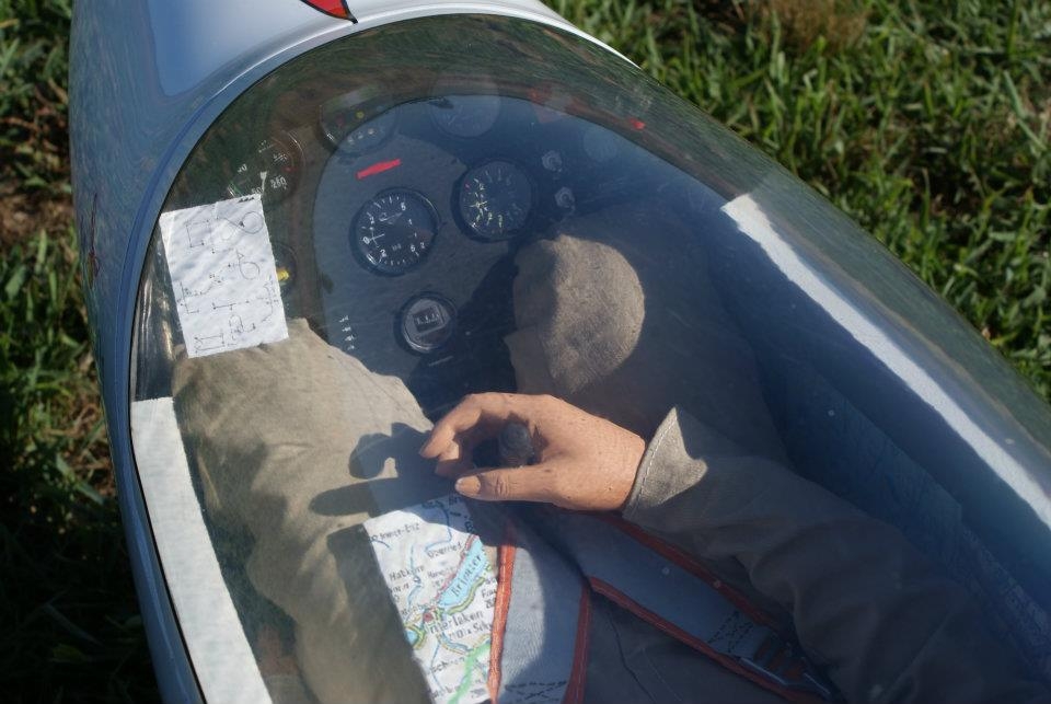

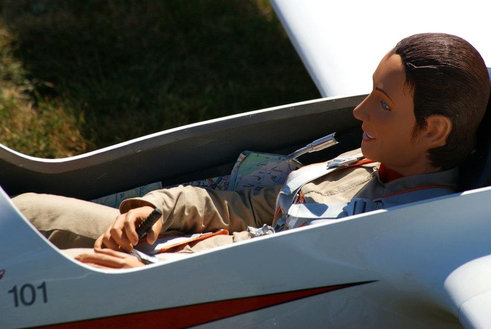

    Here's some "before" shots at Lacolle, Canada after I detailed the cockpit an removed all of the previous graphics...

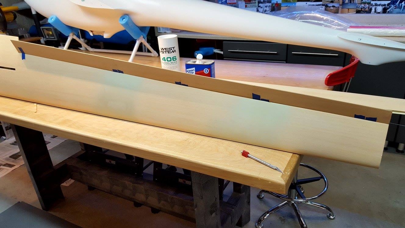

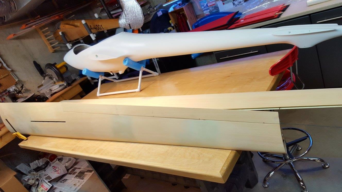

    A beautiful, warm, low humidity Saturday makes a great opportunity to paint!
    Photo 1: The prior wing repairs were a bit rough. I filled each with several coats of USC Pro Glaze and sanded with a 16" bar between each coat -- first filling the surfaces, then restoring a straight leading edge. The wings had also gotten several small dings in the LE over the years, so those were filled as well. Here you see the beginning of masking the patches with beige paint to blend better with the surrounding Obechi. More work here over the coming days.
    After debate, I will be going with 10-meter rolls of Ultracote as covering -- white top, red bottom -- versus sign vinyl as I want to save every ounce on such huge wings. Sign vinyl does leave a much nicer surface. This is a heavy plane, so saving every ounce is welcome. The long rolls of Ultracote mean no seams.

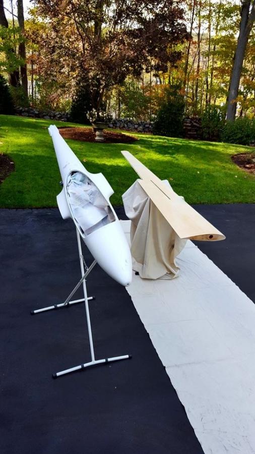

    Photo 2: After stripping off a thick layer of clear coat, filling 1.75 million pinholes and replacing old dry cracked body filler, the fuse is getting a final prime coat before going off to an auto body shop for a proper top coat. A swatch of Ultracote white will be used for the paint match. All of the red fuselage trim will be GONE. Dennis Brandt is applauding right now. ;-)

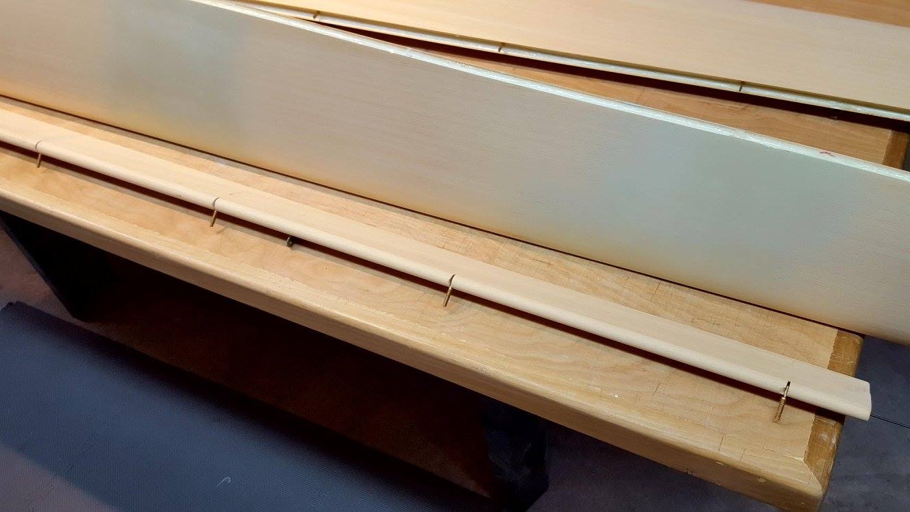

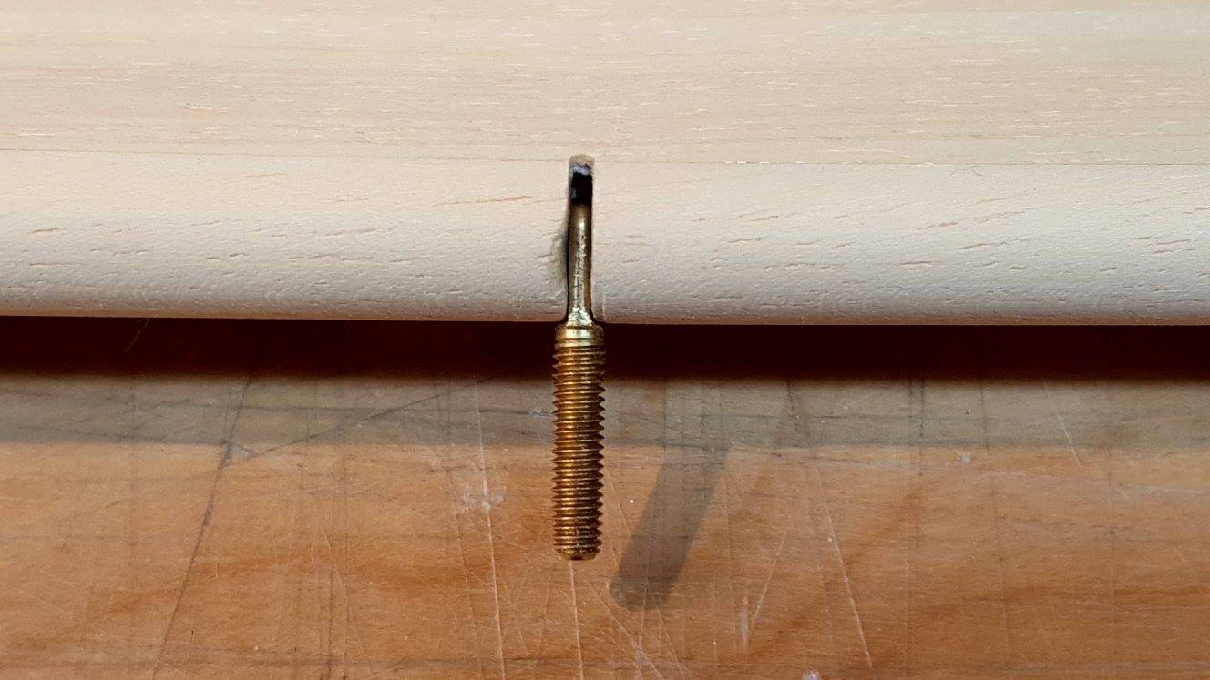

                I used four 4mm brass control arms for the new hinge points on the damaged aileron. The heads were ground flat and made longer. The areas torn out of the interior foam in the wing were filled with white Gorilla Glue -- once fully cured it was cleaned up and then drilled to accept the threaded ends of the control arms. Finally all four were put in place as one unit with slow cure epoxy thickened with colloidal silica. Blue tape added to make certain I didn't risk gluing the aileron into the concave section of the wing if any epoxy overflowed. Finally the aileron was flexed to full up position to make certain there will be equal travel to the other wing. Cure and done.
                You can just catch a glimpse of the other wing on the bench showing it's 6 aileron hinge points in place. Now both wings are identical.

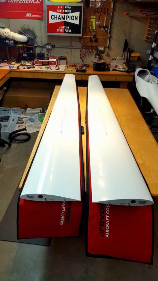

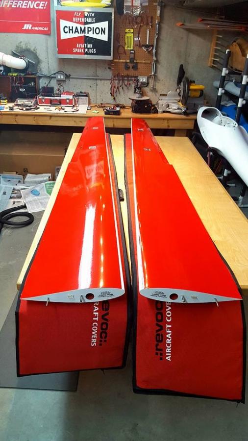

                  Finally made it back into the shop for some quality work time.

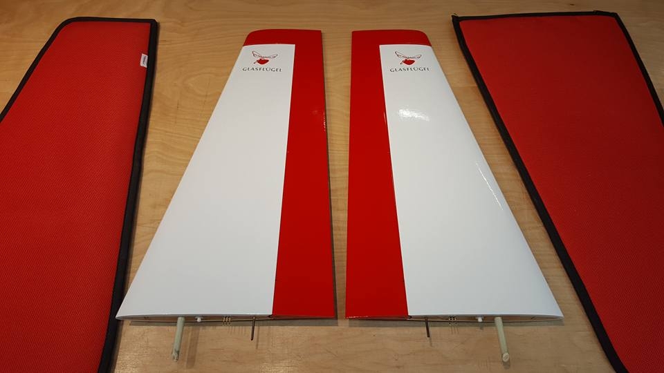

                  Wings and tips are fully covered. Like all restoration projects, there are some "might as well" additions -- when I looked at the gleaming white wings, it was also clear I needed to pull the airbrakes as they were significantly yellowed by comparison. Best of all, the black carbon patches in the wings, repair indentations and dings no longer show! Just 7 meters of shiny white and red. Only remaining step is to paint the white molded servo covers in a matching red. The wing bottoms used to have white ailerons and the white covers -- it just looked incomplete.

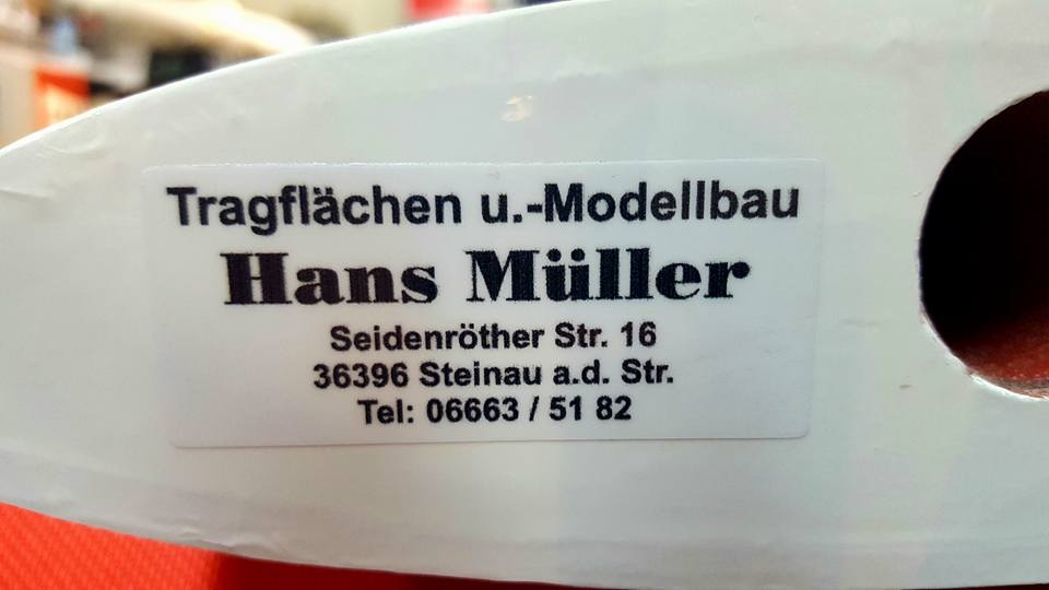

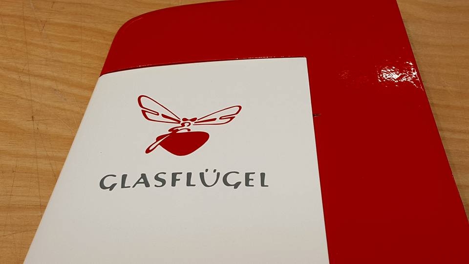

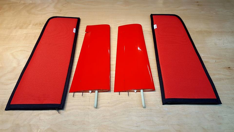

                  While we're going overboard with an old bird, Zbig at REVOC made me a custom set of wing, tip and v-tail covers for the model. Red, of course! Callie took one of Hans's old logo stickers and replicated them for me.
                  Fuselage goes to the paint shop in two weeks. We may make it by spring!

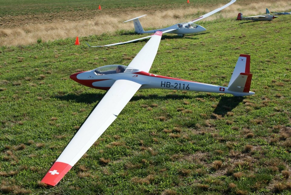

Name:	Salto (640x462).jpg
                  Ahhhhh. Yes, this Salto! Could some of the damage come from this flight? The Salto cut through those weeping willow branches like a hot knife through butter. Well, it did take some foliage with it. If you look closely at the top of the tree, there is a nice flat spot from the cut!
                  Great work on this ship Steve. I was lucky enough to tow this up maybe a couple of times but it was usually towed up with Larry and Kevin's big Balsa USA Super Cub. Glad to see it getting pretty'ed up!
                    Just so you know Steve...there was no damage on the maiden flight picture above from Tim...well, except to my Ego...everyone told me to go further back to set up to land, and of course I clipped the top of the tree...Honestly...I never saw the damage you found the first time you saw the plane. Dan never told me about the prior damage that you have discovered or I would have told you about that.
                    Anyway, I think about now I could finally fly the plane the way it was meant to be flown, but I never flew it fast enough like you can. Glad to see you restoring her to her glory. There is not another plane that I know of quite like this one...Han's planes are oneses....

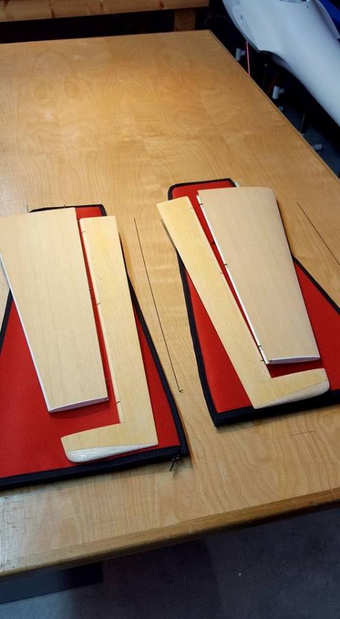

                      It's been a fun labor of love getting it back in shape. It was clear when I had those recovered wings and tips on the bench, the tails looked far less attractive. So that's today's project -- strip and recover.
                    Like I said, that's the thing about these projects... all the "might as well" items. The otherwise perfectly fine v-tails looked old next to the wings. So, strip, sand and recover. Now they look new too.
