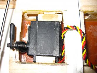

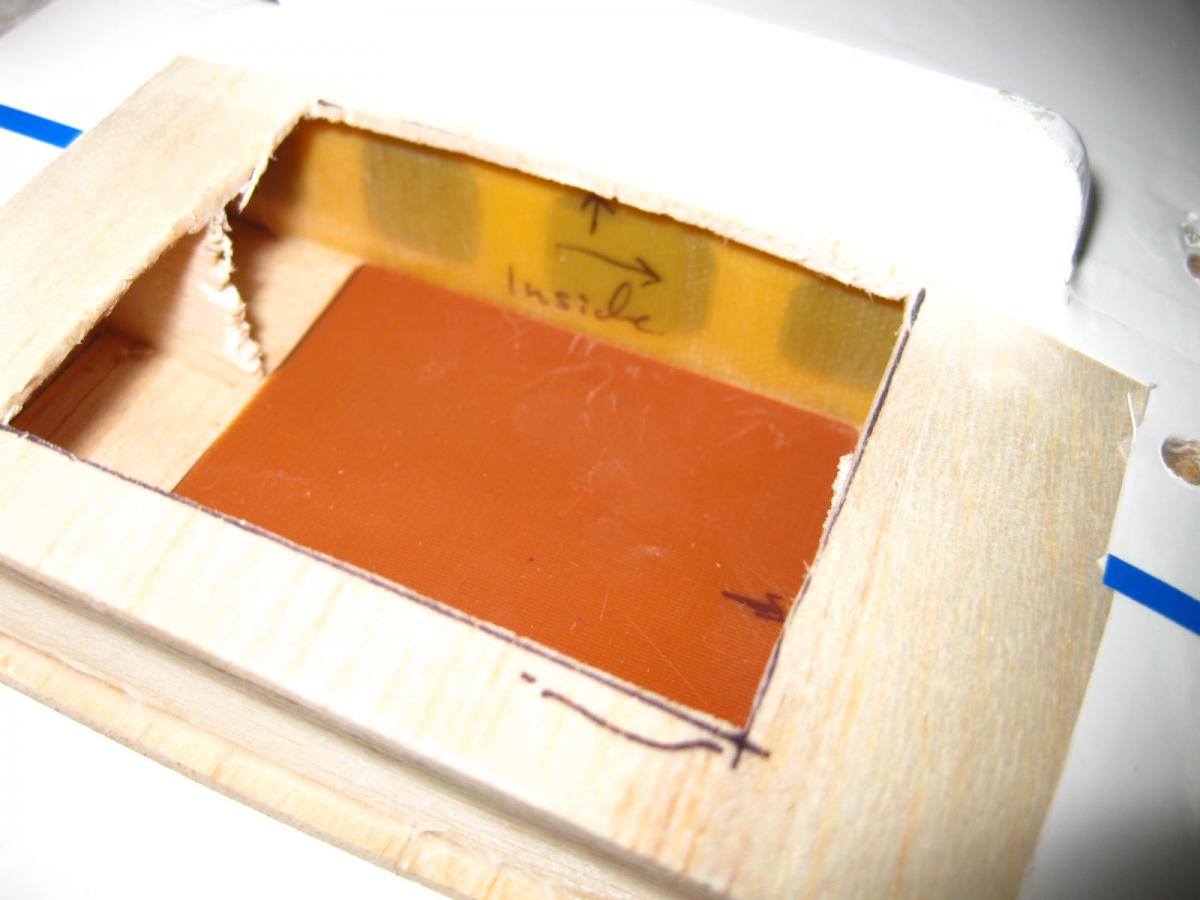

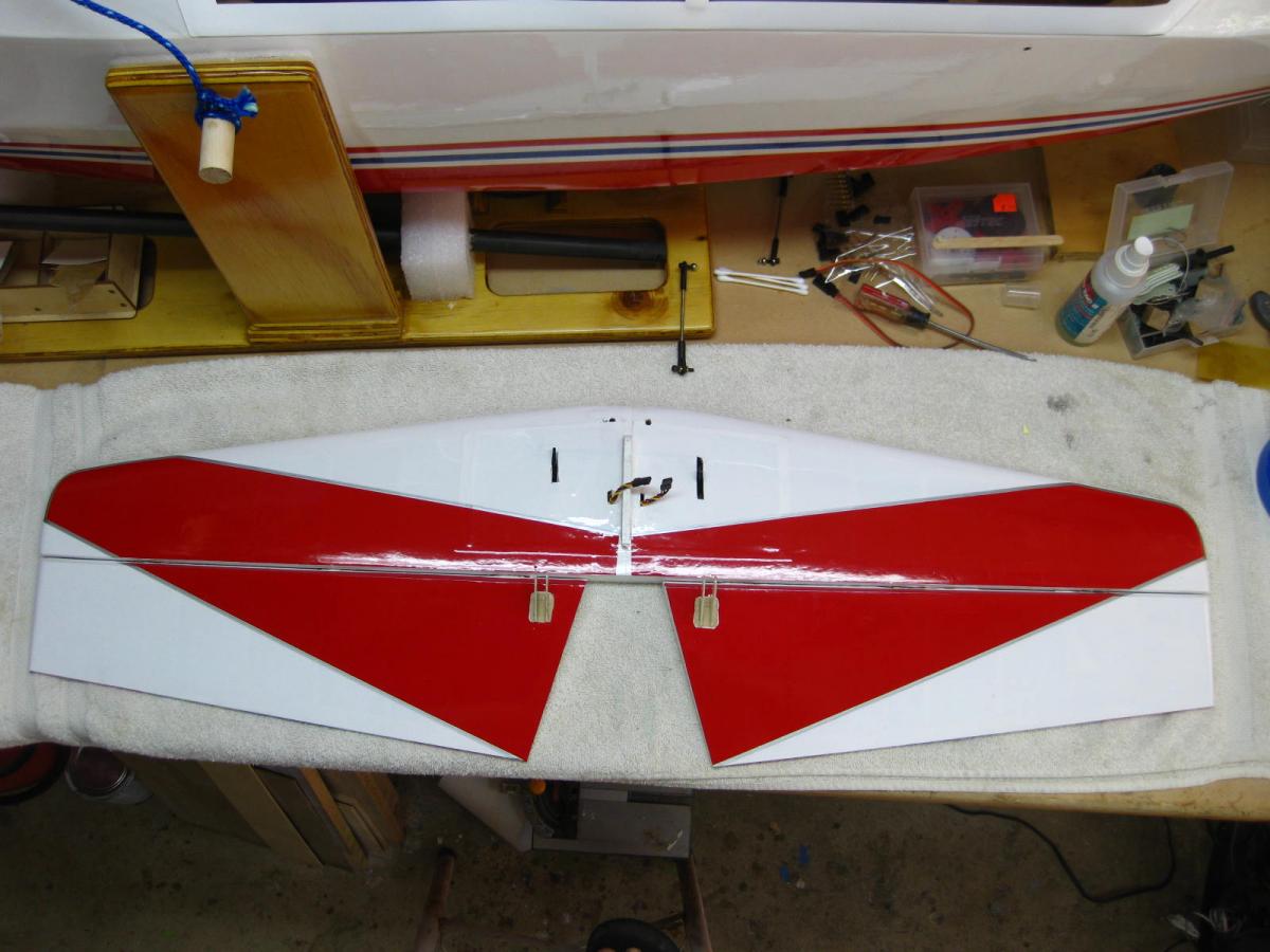

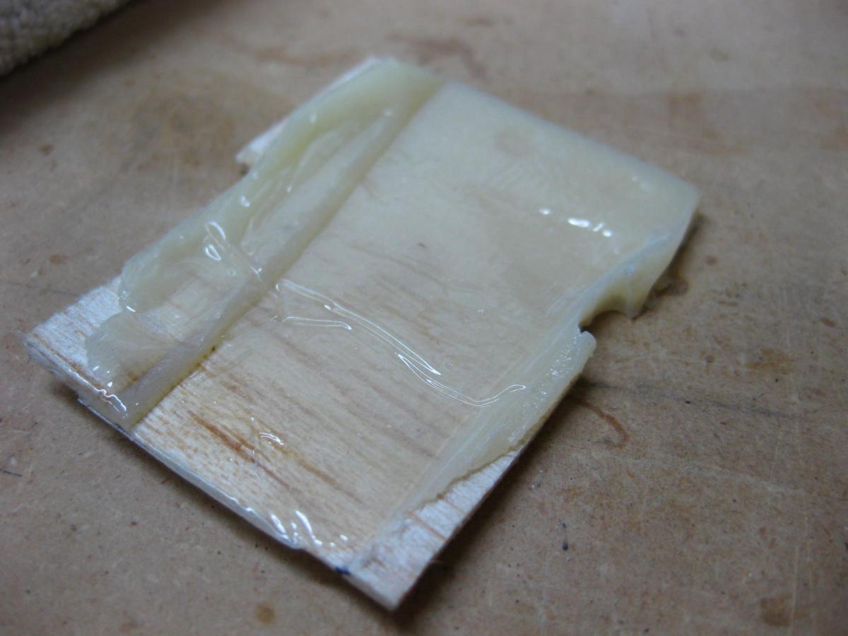

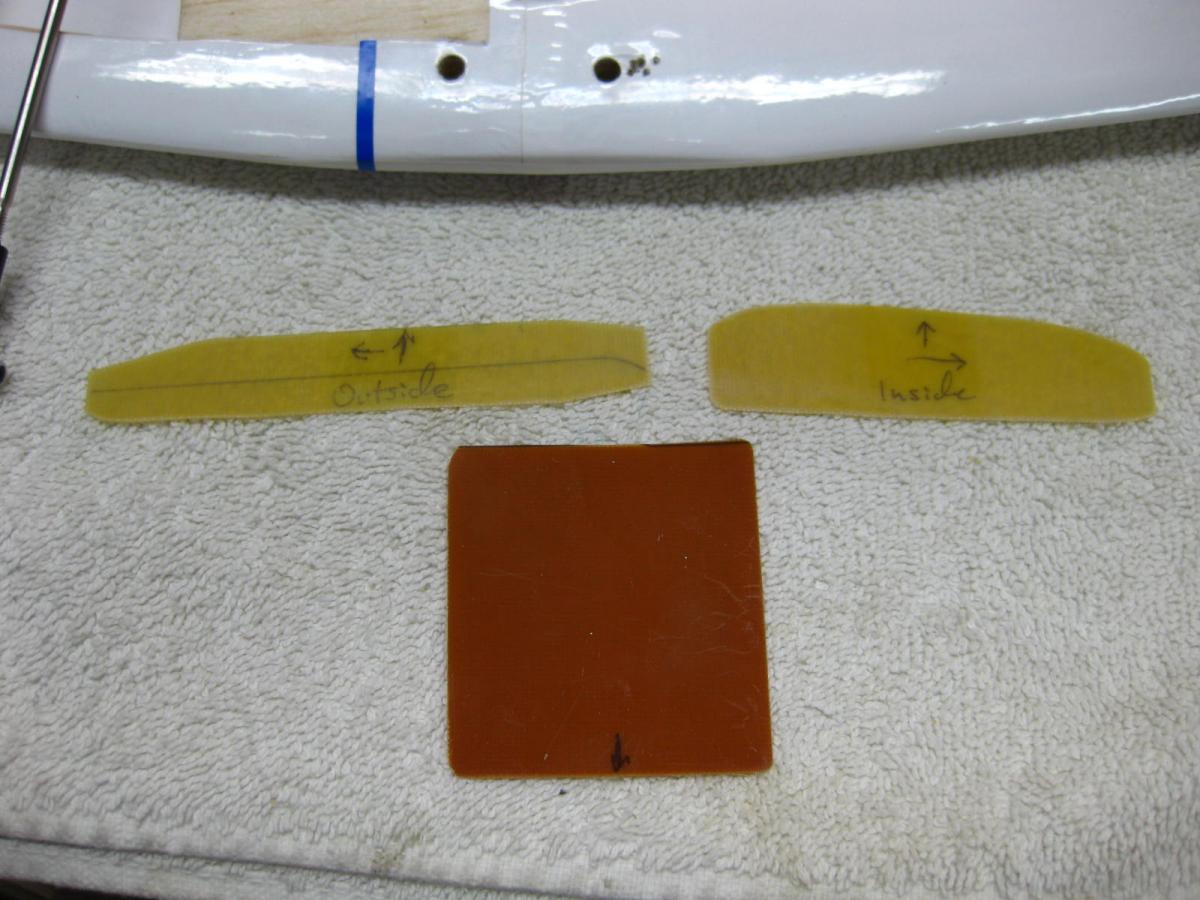

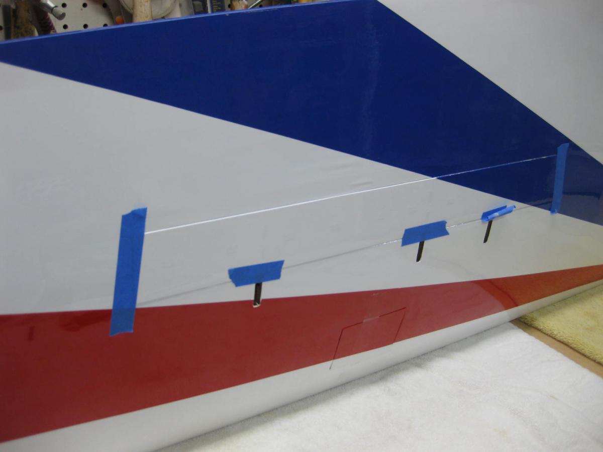

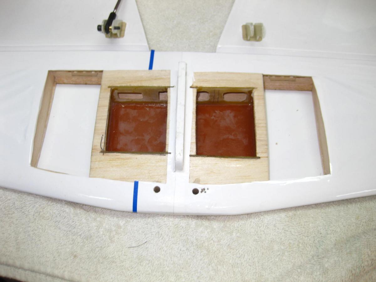

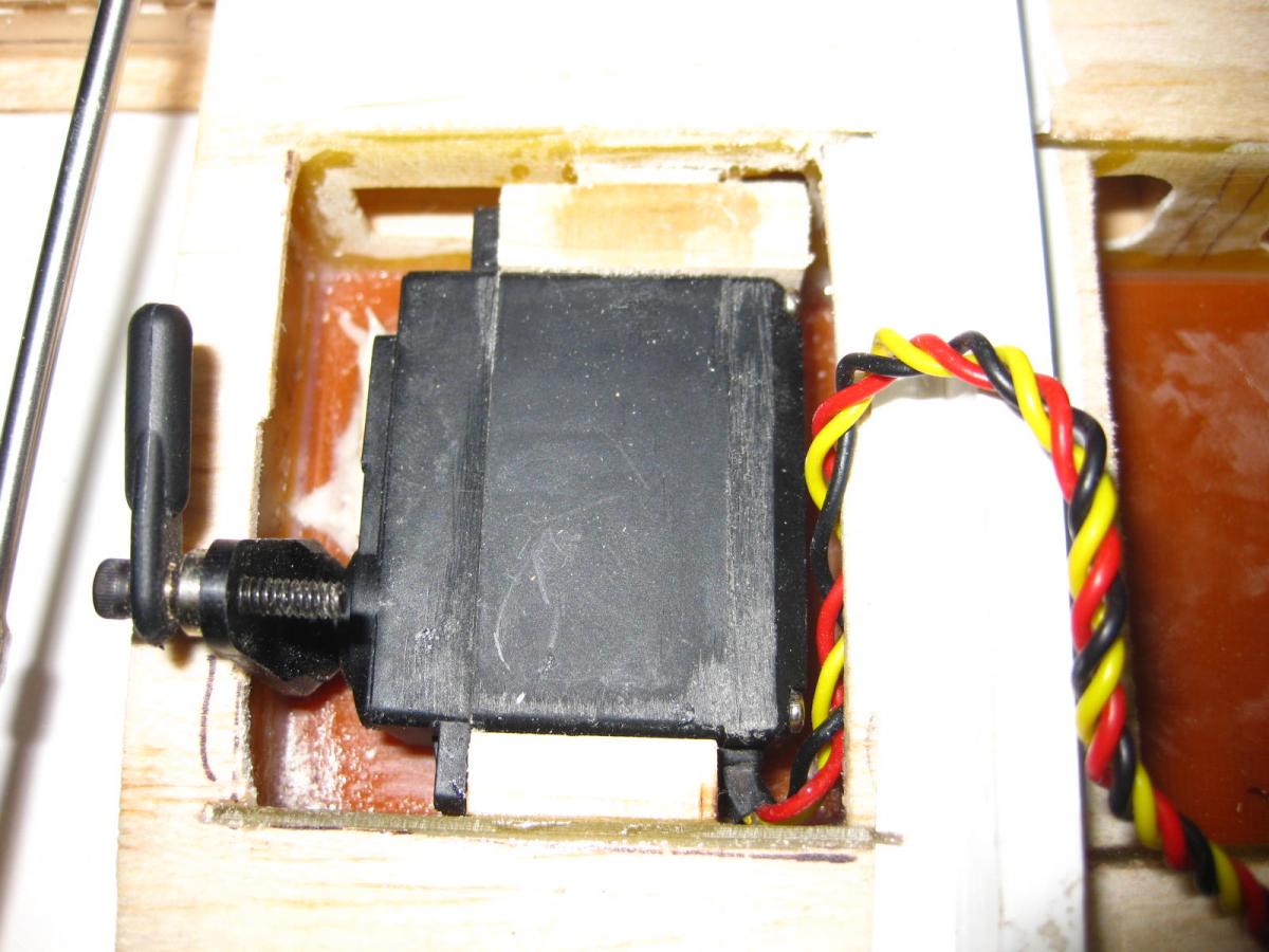

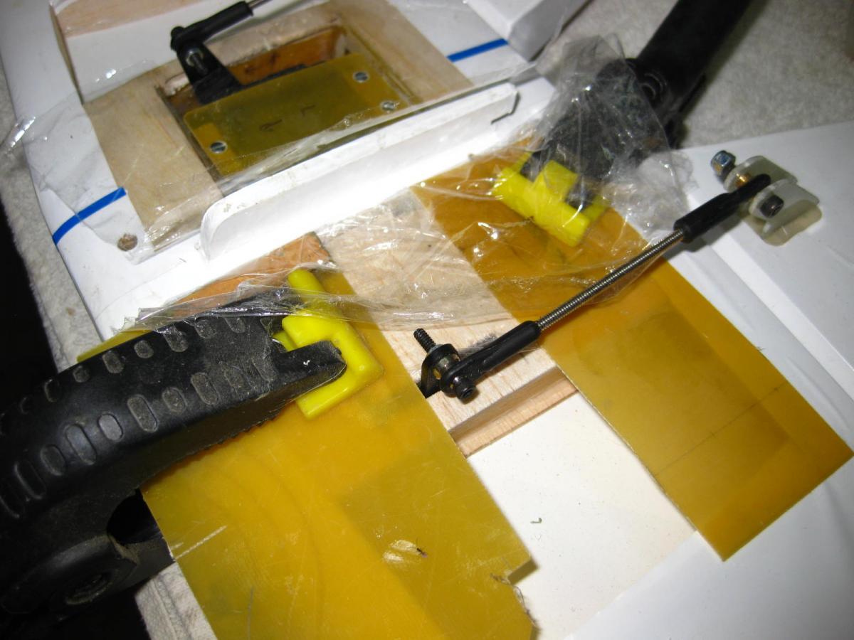

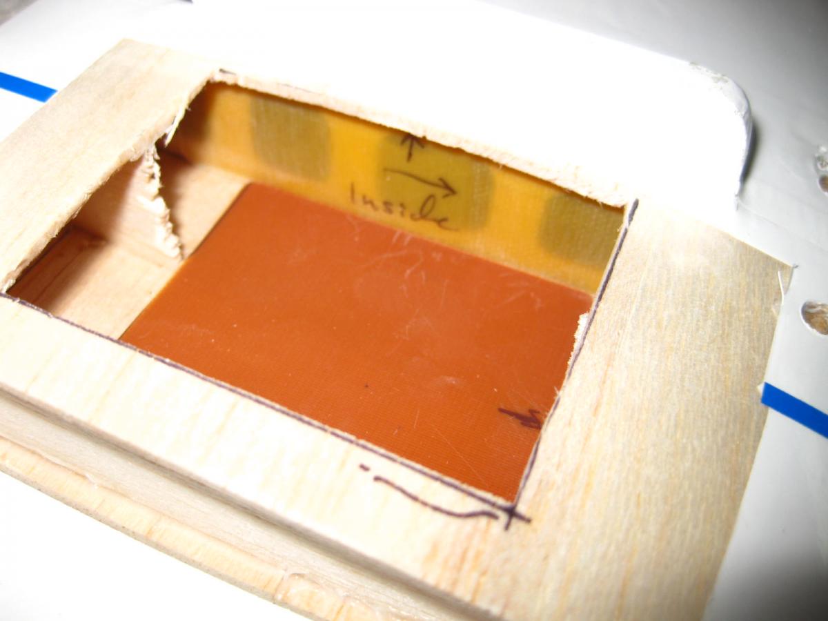

    Installing the Elevator servos in the Stab. Using some G10 0.020 and 0.030 material to frame up the servo bays
    WestSystem/Colloidal Silica mix to stick thing together.

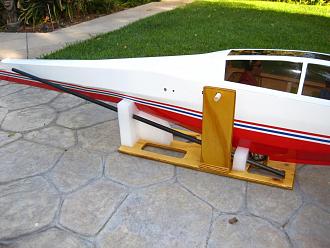

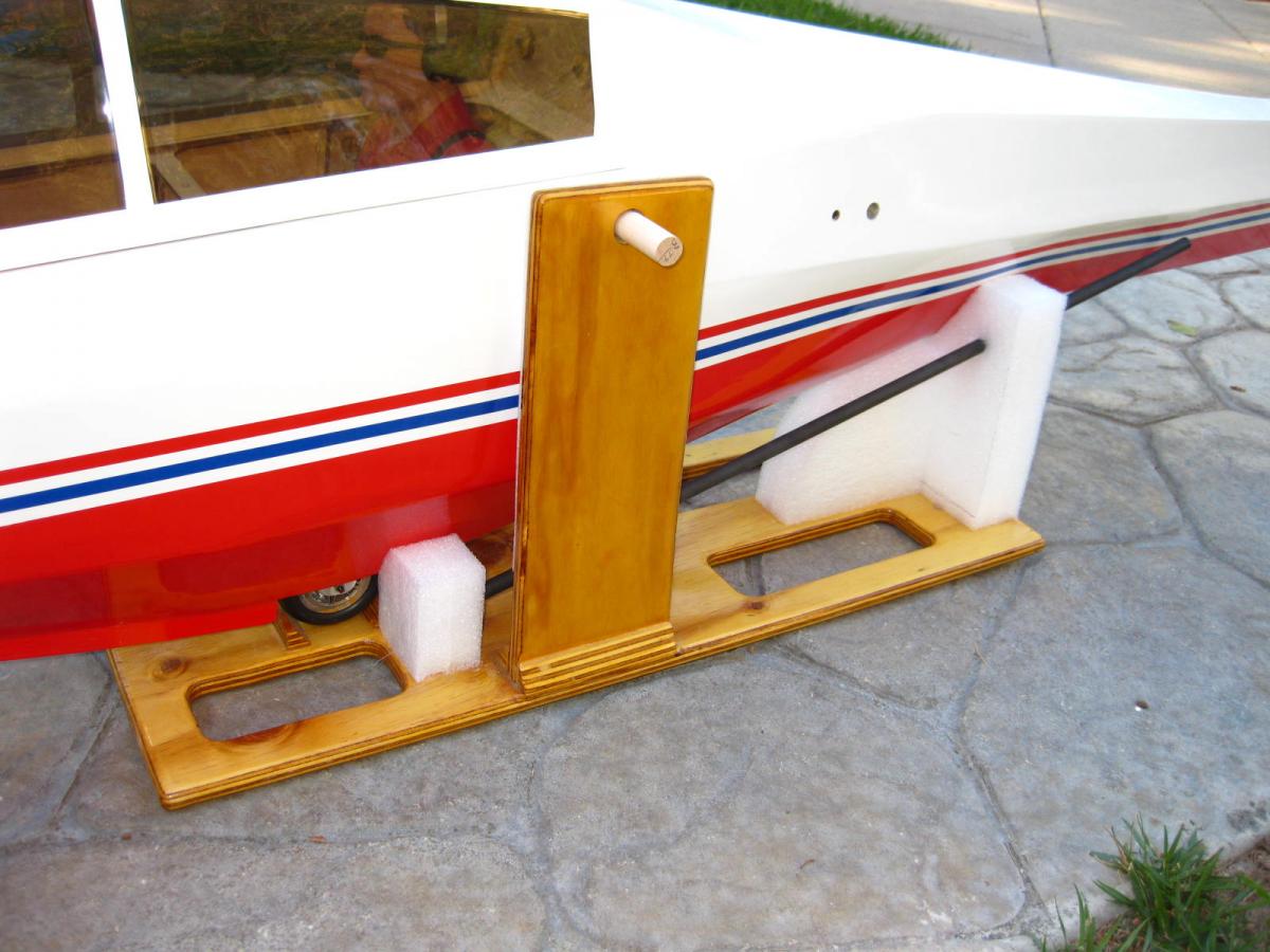

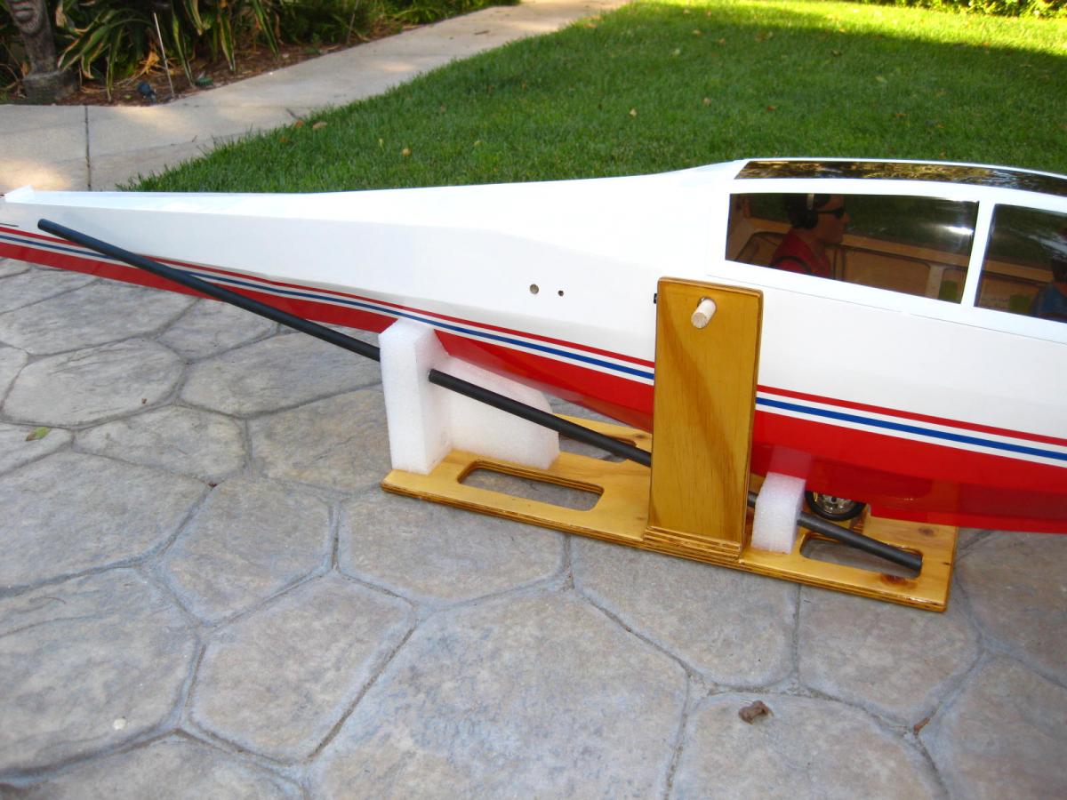

          In keeping with hanger rash avoidance protocol, here's my rendition of Dan's ( QuebecAerotowAssociation.com) Bergfalke fuselage transportation rig.
          Of course the main feature is keeping the wing rods with the fuselage...............I guess I'll have to make a leash for the stab ........

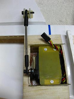

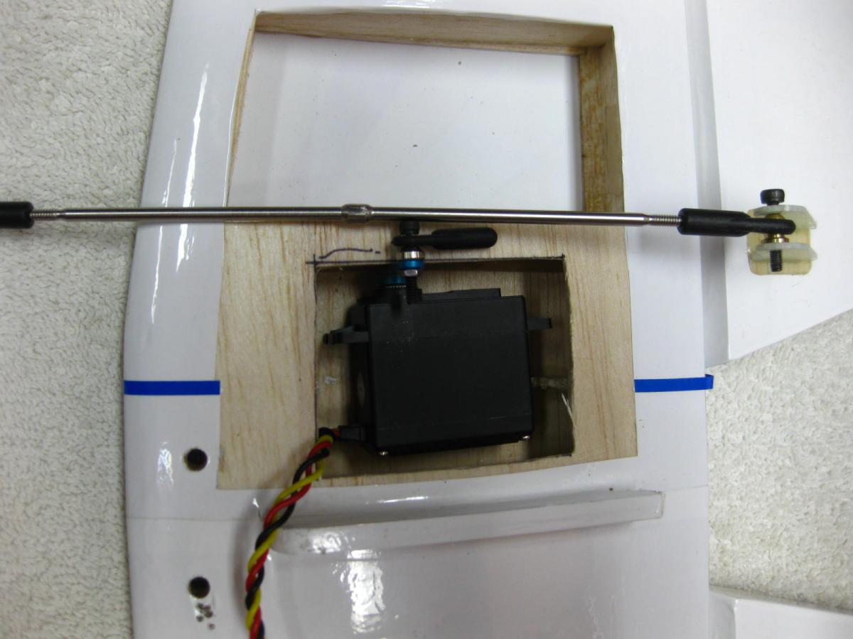

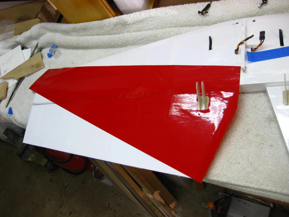

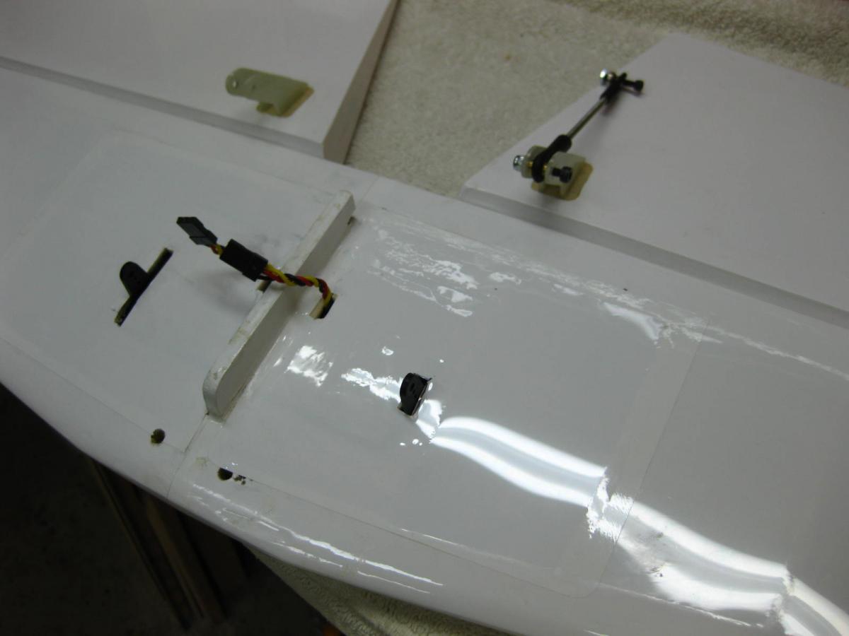

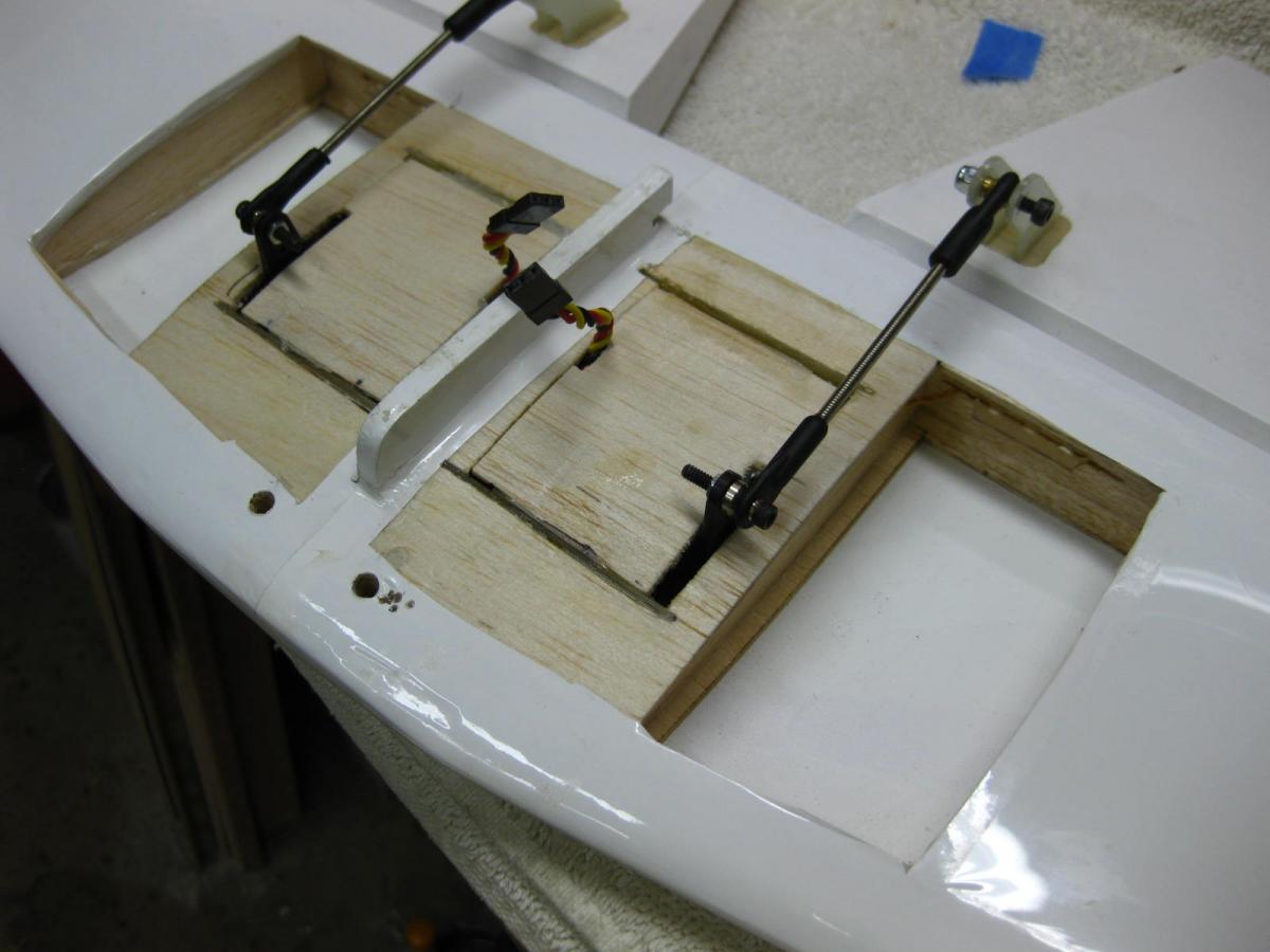

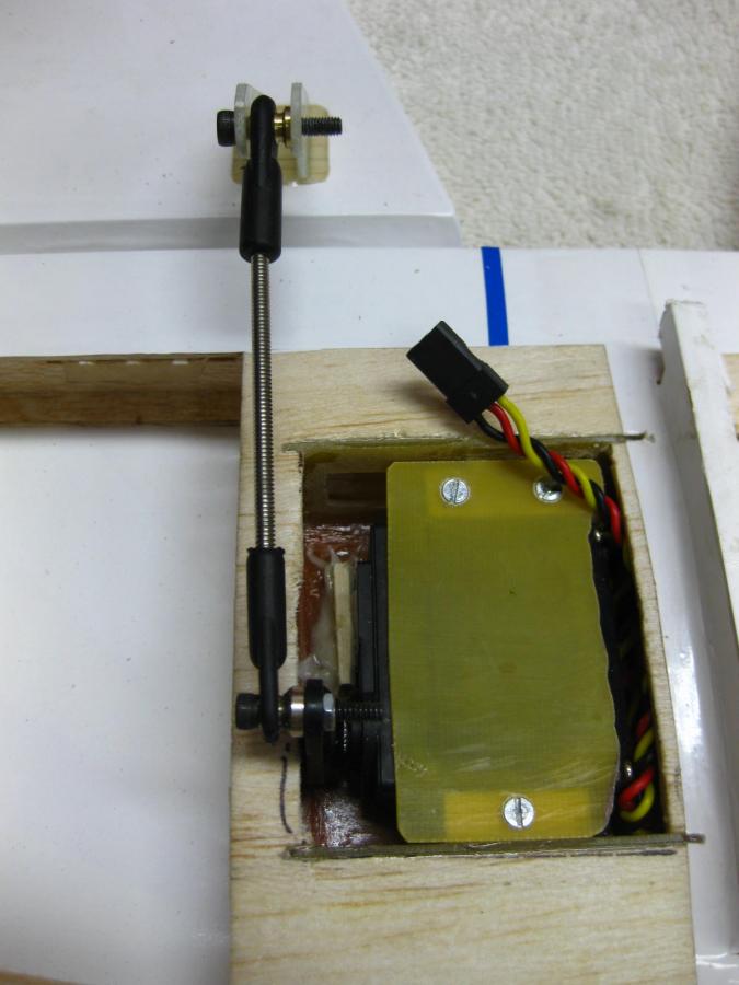

            Servos in the Stab update

            if I need to get to the servos, I'll just cut the Ultracote and then just tape it back on.
            Scott

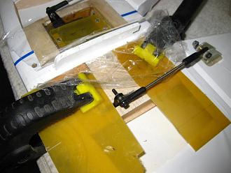

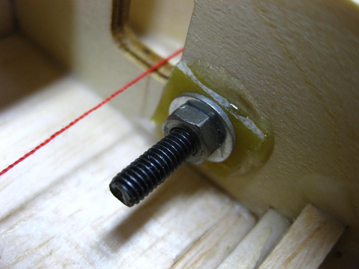

              Spoilers.....

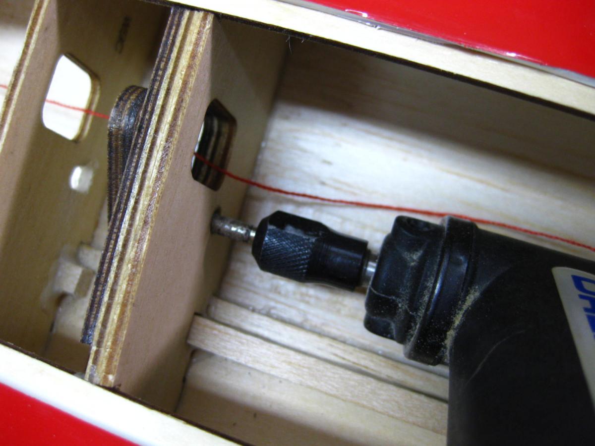

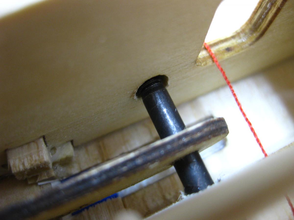

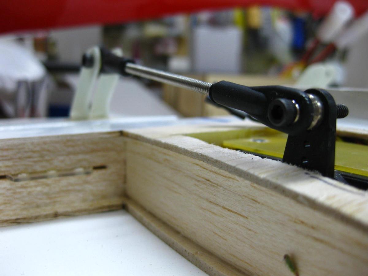

              As luck would have it, my laser cut spoiler attachment holes didn't line up
              so out came the 90 degree dremel attachment and a grinder to get things lined up ( with the spoiler taped in place )
ID:	4527 Click image for larger version

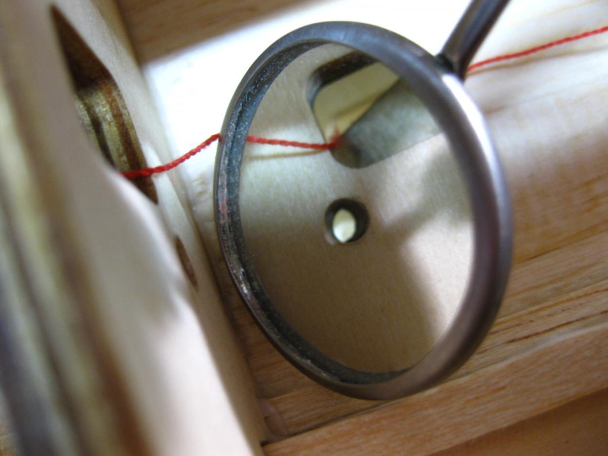

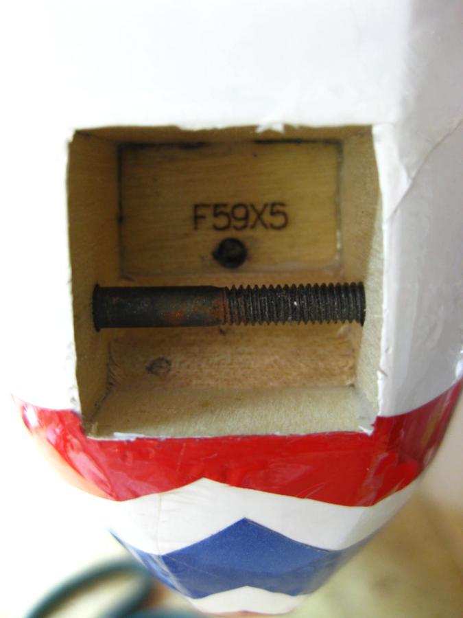

              This left a bit a play in the movement of the spoiler's action with the enlarged holes, so out came the G10 .060 material and some epoxy.
ID:	4529 Click image for larger version
              And of course, some longer 4mm socket head bolts (longer shank ) so the spoiler isn't moving on a threaded surface.
              Scott

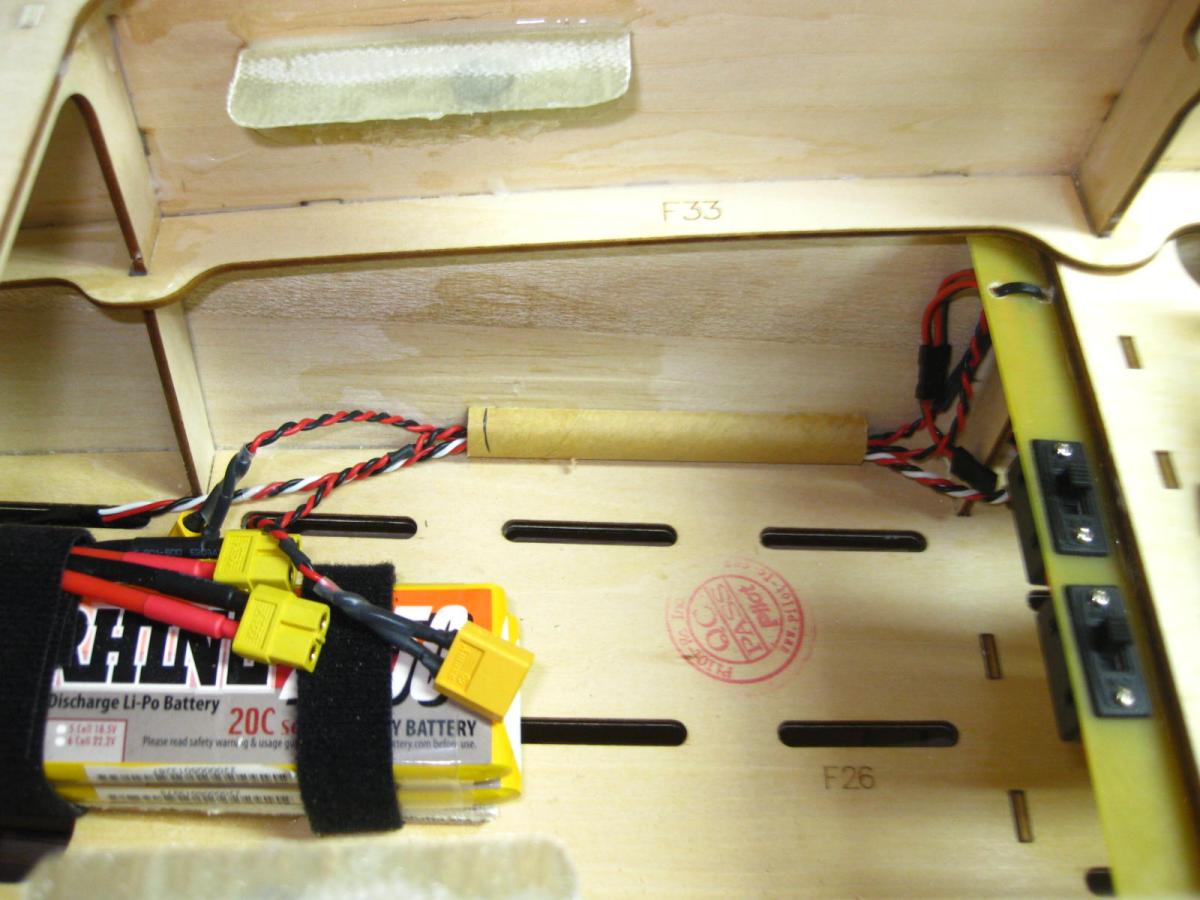

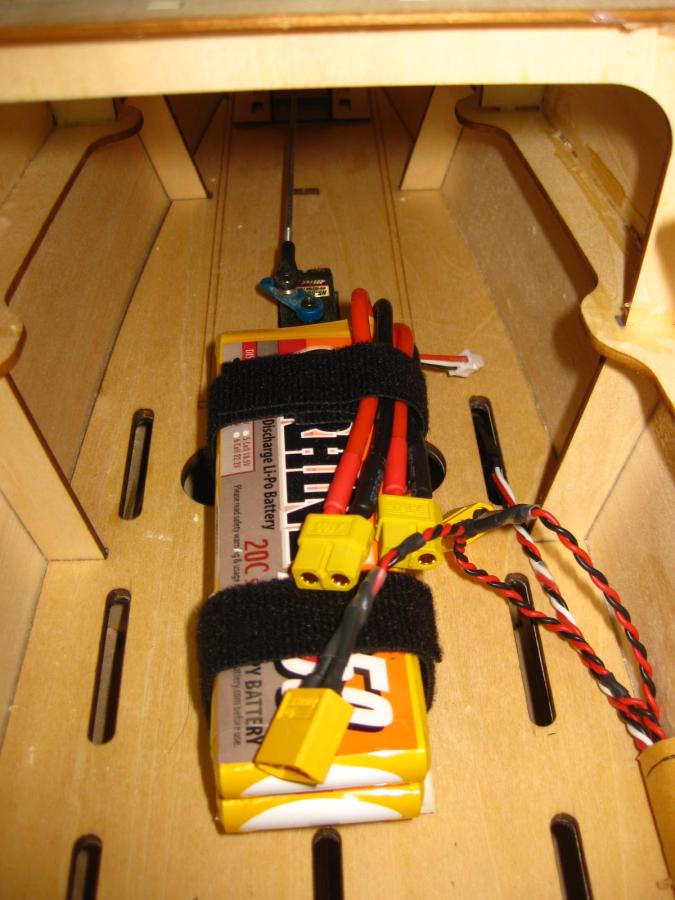

                Cockpit wiring and Tow Release

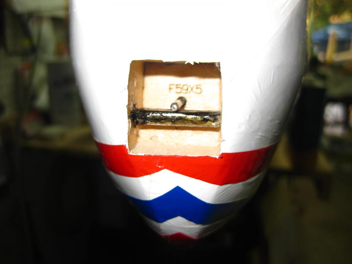

                In an attempt to keep from shredding the tow loop, I installed a sleeve on the 4mm bolt
ID:	4604 Click image for larger version

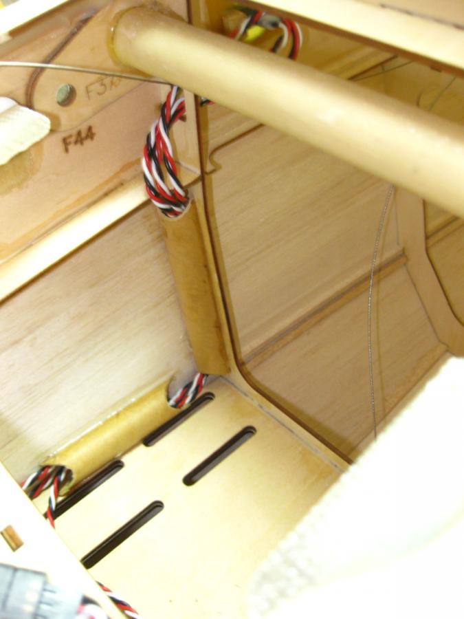

                trying to keep the wiring under control with 5/8" wing tube sockets
                I think I'll convert over to a Jeti SPS20 electronic switch with a magnetic key since the canopy is bolted on
