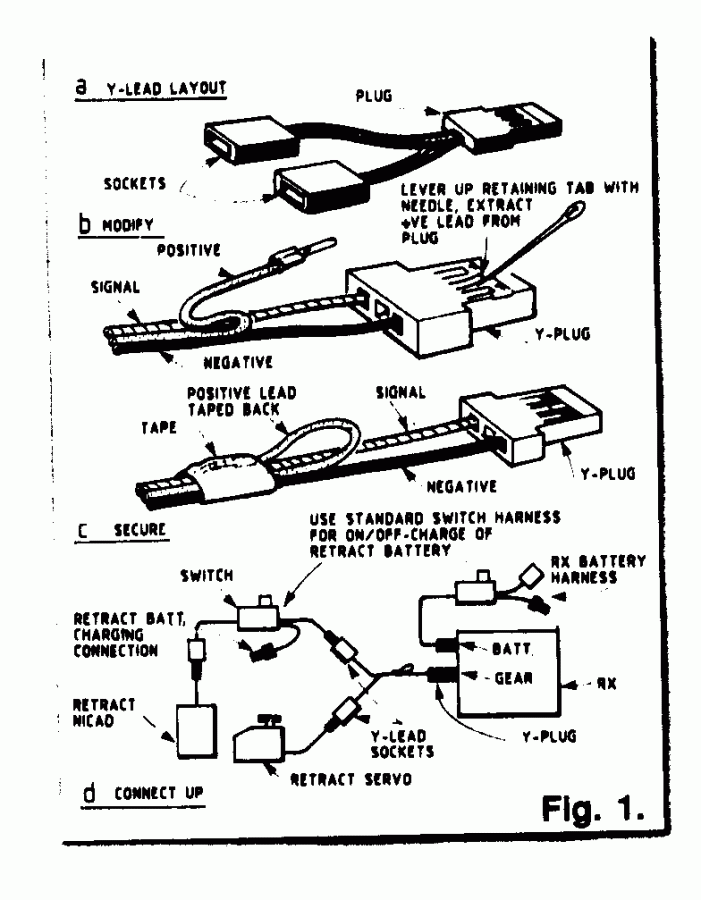

I have a 4.5m dg808 I will be building. It will have 9 or more standard size servos. My Rx will be a frisky r18. It has dual xt30 connections.
Should I wire the servos directly to a battery and only have the signal and ground going to the Rx or just not worry about it and plug everything directly into the Rx?
