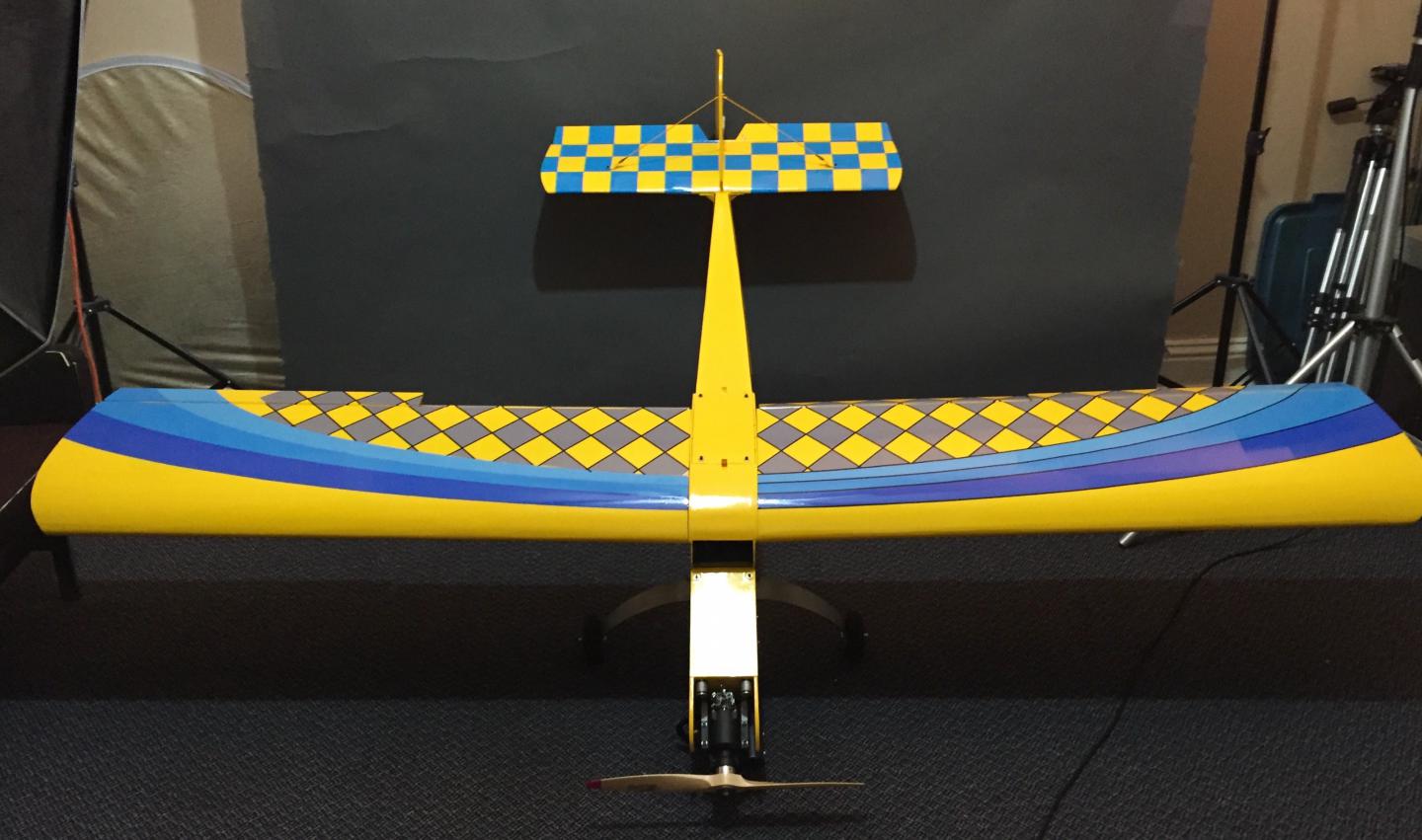

        I have the Senior Telemaster with a 25cc Roto gas engine that I thought I was going to use as a tow plane but changed my mind.
Name:	Telemaster graphic.jpg
