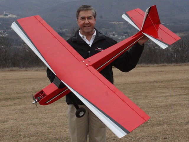

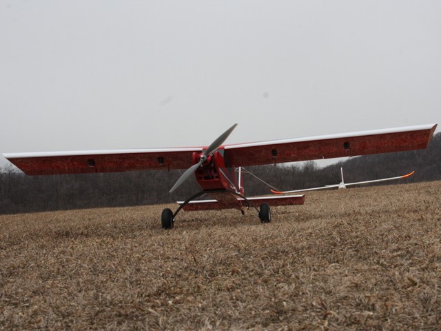

    After building four Telemaster 40 kits over a span of twenty-six years, and using the last two specifically as aero tow tugs, we were very excited to have the opportunity to build the new Hobby Express Deluxe Telemaster 40 kit shortly after its release.
    Hobby Express has the kit building instructions, complete with step-by-step color pictures, posted on their website (www.hobbyexpress.com). Just click on the “Support” tab under the Deluxe Telemaster 40 kit section and then click on the words “Deluxe Telemaster 40 Manual” to open and see the manual. The Deluxe Telemaster 40 kit is a quantum leap forward in kit design featuring full laser cut parts. Even the hinge slots are laser cut! Unlike the older kits, the Deluxe Telemaster 40 kit parts are designed to interlock in a way that makes it very easy to build a straight and true structure quickly. We were able to frame up the complete airframe in 22 hours and this was done using Titebond II (aliphatic resin) glue for most of the construction instead of instant (cyanoacrylate) glue!

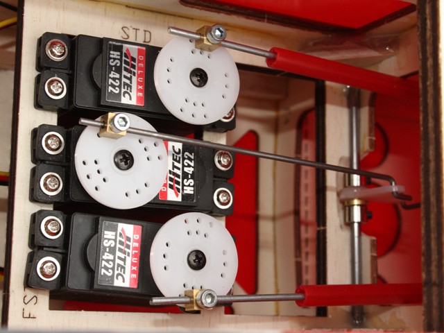

    The original Telemaster 40 kit had ailerons and offered flaps as an option. The Deluxe Telemaster 40 kit comes standard with ailerons, flaps, and a four-servo wing so each surface can be independently controlled. A basic 6-channel radio system can be used by coupling the two aileron servos with a Y-harness and the two flap servos with a Y-harness. For those with a more advanced radio system offering computerized mixing capability, the Deluxe Telemaster 40 can become a test bed for all sorts of wing control mixing. We like the “crow” function with flaps down and ailerons up for rapid descents and short field landings. This is of particular value in an airplane used for aero towing sailplanes.

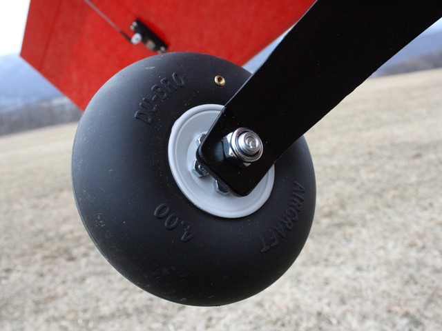

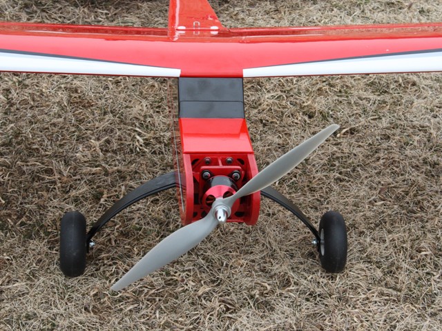

    A good tow plane needs a sturdy landing gear:
    • DUB789 - Super Strength Landing Gear
    • DUB247 - Axle Shafts 5/32”x1-1/4”
    • DUB140 - Dura-Collars 5/32”
    • DUB400RV - 4” Big Wheels
    • DUB375 - Tail Wheel Bracket .40 Size
    • DUB75TW - ¾”Tail Wheel

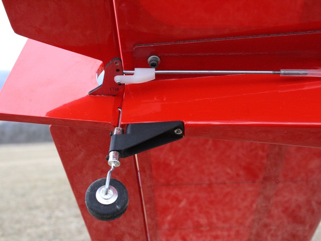

    Elevator and rudder control rods.
    • DUB500 - Lazer Pushrod 36”
    • DUB121 - EZ Connectors
    • DUB855 - E/Z Links 2-56

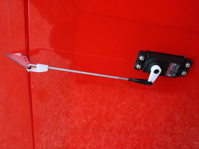

    Aileron and Flap control rods (included 2-56 wire plus these)
    • DUB109 - 2-56 Spring Steel Kwik Link Clevis

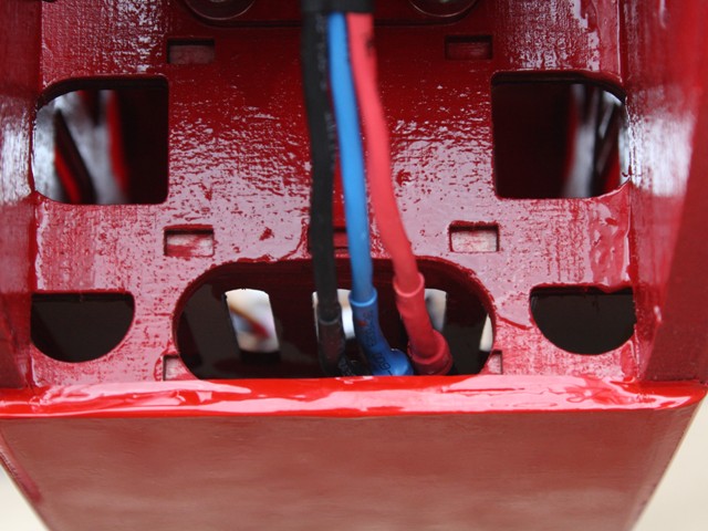

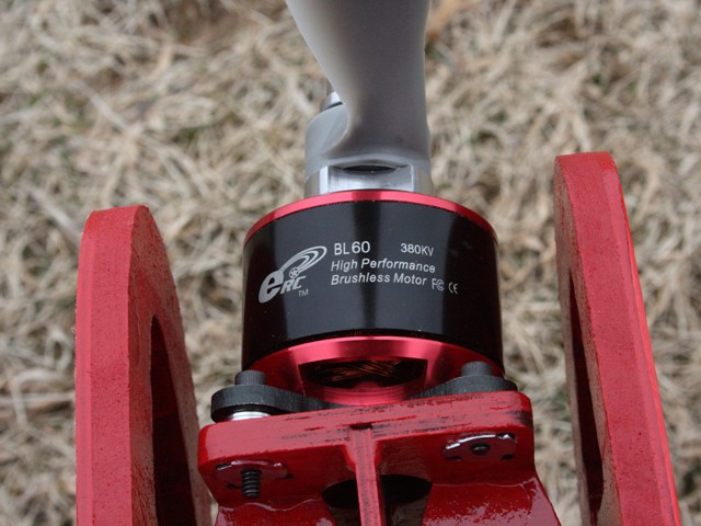

    Electric power (for models in this size class) has reached a point where it rivals the cost of glow power and exceeds the performance. In our experience, a 4-stroke glow engine is better than a 2-stroke engine for aero towing because of its low end torque. Electric motors have even better low end torque. As a rule of thumb, a tow plane typically needs a power system that is about half again larger than what would be used for a sport plane application. For our “Super” Deluxe Telemaster 40 tow plane, we opted for a .60-size electric power system from the Hobby Express eRC series (instead of the recommended .46-size motor):
    • ERCBL60 - eRC BL60 motor
    • ERCE085P - eRC 85A Brushless Programmable Opto ESC
    The prop we selected is an APC 15x8 Thin Electric:
    • LP15080E - APC 15x8 Thin Electric Prop
    We made an opening under the motor mount so that the ESC could slide in under the battery platform. This also gives cooling airflow straight through the controller and provides a nice area that protects the ESC.
    Our initial motor run was made with a 6-cell 5,000mAh 20c LiPo pack and produced 780 watts of power at 34 amps. We attached our fish scale and measured 8lbs. 7oz. of thrust. The AUW of our new Super Telemaster 40 Tow Plane is 8lbs. 3oz. so the thrust to weight ratio is greater than a 1:1! With this kind of power, we added plate washers to the left side of the motor mount to create right thrust. With a larger motor and with the extra drag of a sailplane on tow, the right thrust helps to keep the tow plane from yawing to the left and makes for better and straighter tows (and less need to hold right rudder).

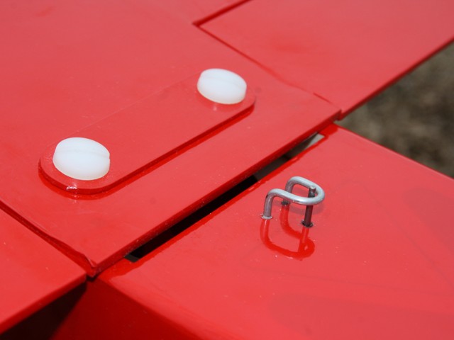

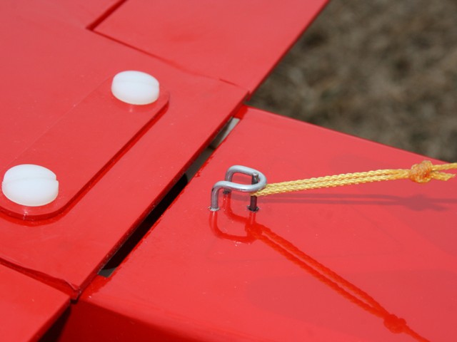

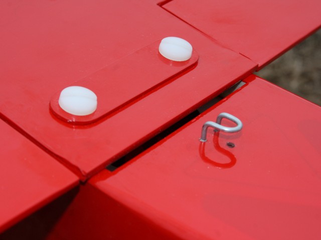

    Our homemade tow release mechanism has worked flawlessly. This same design has been used on numerous tow planes within our group and all have worked perfectly.

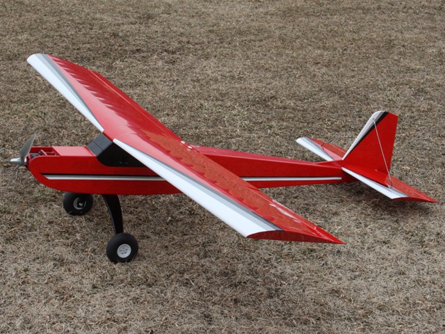

    We could not be more pleased with the new Deluxe Telemaster 40 kit. It is amazingly well designed, a joy to build, a great looking airplane, and best of all, it is made in the U.S.A. The cost is well worth it when you consider the value of your time and the building time saved with this new design. Also consider that a straight and true airframe is priceless!
    Comparing the new Deluxe Telemaster 40 using electric power to our older style kit built Telemaster 40 with a 4-stroke glow engine; the number of launches between refueling verses recharging is very equivalent. As for towing, the electric version does so with more power and authority than the glow version. Considering the cost for each system; it certainly appears to us that the electric version tops the glow version in both cost and performance.
    If you are looking at airplane kits with the intention of building a small tow plane, we feel that Hobby Express Deluxe Telemaster 40 is the segment defining model to meet your needs.
