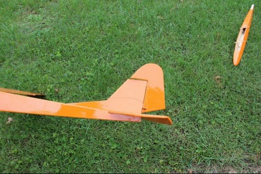

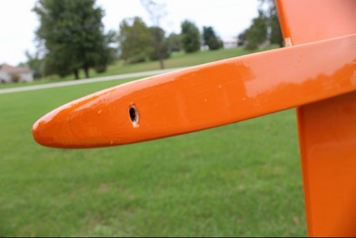

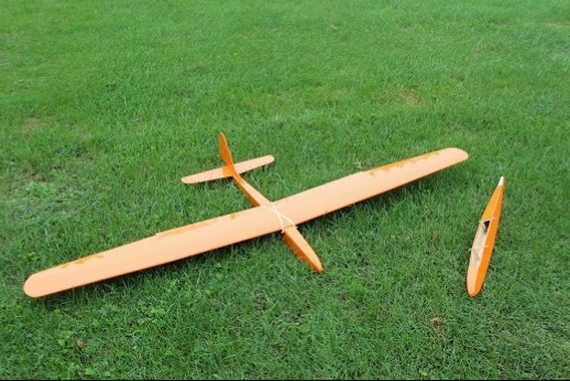

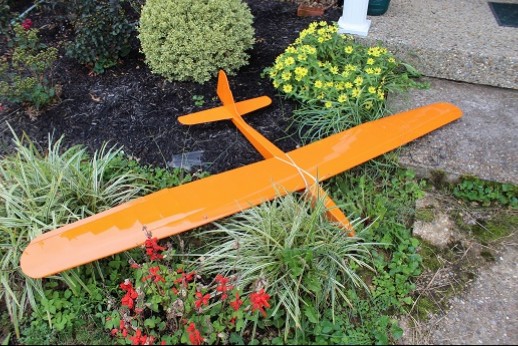

    Two Sig 'Riser' sailplane kits are being modified as aerotow trainers. Construction of the air frame is done with one. So far, it weighs 705g with two regulators, four Hitec 55 'Feather' servos, receiver battery and JR DS368 release servo. The fuselage of the second is finished. The other will get completed as soon as the first proves airworthy enough! The wings were 'straightened out' in lieu of the polyhedral design and strip ailerons were fashioned from the kit's TE. A retracting 'pin-in-slot' release was built into the nose. The tail feathers and wing tips were rounded... just for fun... and the rudder has pull-pull control. Spoilers were contemplated then dismissed because I wanted these to be very simple flyers... and I was lazy! Hopefully some interest will be generated when the 40 glow trainer tow plane and these are brought to the field and flights offered.

    Thanks to Joespeeder in Michigan for the idea! He had a couple of small sailplanes for folks to try out at Frankenmuth. Wish me luck!
    Absolutely great idea Mike. We did this back in 2010-2011 with an Easy Glider and a Telemaster 40 powered with an OS .52 4-stroke glow engine. Dozens and dozens of pilots had their first aerotow experience with it.
      Easy Glider is a great trainer and solid performer in light lift. I like those Risers too. Might take the air balance section of the rudder off though, or beef it up to prevent flutter on tow.
        Thanks for your concern! Hopefully, high speed towing will not be done so we can only hope flutter won't be an issue! The kit is designed with a rudder like this. I merely rounder the corners. At least the loads on the Hitec-55 'Feather' servo will be reduced. Hard points were added to the fin and stab so they can all be braced together in case a hard landing causes the fin to break loose. It is poorly designed IMHO. I 'doweled' the fin's LE to the bottom edge that is glued to the stab and have some large-ish gussets in there. Flight testing will commence as soon as nice weather arrives. It rained all weekend.

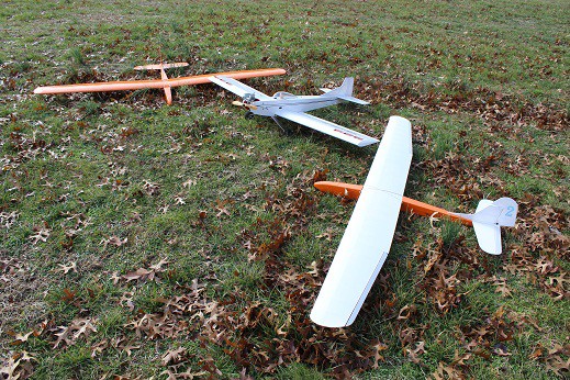

      To tow this Riser 100 locally ( and my just finished 1/4 scale hall cherokee) i have assembled all the bits and pieces to complete a stock H9 81" Ultra Stick.
      No doubt i will take it to regular aerotows in 2019 with a buddy box for others to try.

        I toyed with the idea of a wheel and spoilers but decided to KISS! I'm keeping the rubber band-on wing just in case of a ground loop at take-off. I fully sheeted the 'D' tube. I reduced the dihedral in the main joiner. There is ample material in the kit for this. Way to go Sig! I love Sig! One sailplane has kit wing plan form which is double taper and the other has a straight LE root to tip. The first one with the double taper has a little built in wash out. The one with the straight LE shouldn't need it. I just laminated a bunch of spar joiner 1/64" strips to 'fit the bend' of the spars for the straight LE one if that makes sense.
        The H9 Ultra Stick will have more than enough vitamins to pull the Riser!

      Well... the Sig Riser #1 was had a successful maiden flight being towed by Stephane with his foam Carbon Cub at the MRCA Aerotow. It flies really good. Stephane was able to find some lift even while it was lightly raining on an overcast day! We flew it four(?) times. Now... to finish Sig Riser #2!
        I had my longest flight at Cumberland this past weekend of over 75 minutes flying the Sig Riser! The Riser flies great and the rudder never came off!!! I'm going to finish the other one and put spoilers on it... it needs 'em! So... if you are looking to try soaring 'on the cheap' then get a Sig Riser and consider these mods to the wing. For such an inexpensive kit it offers a wealth of fun flying!!!
        BTW... tow was by a big Bidule with a DA180??? or some such engine this weekend. The Hitec 'Feather' servos are doing great service. The airframe can handle larger servos for peace of mind.

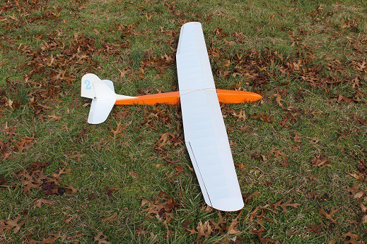

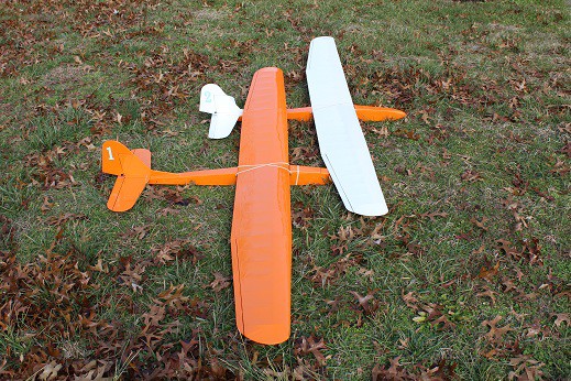

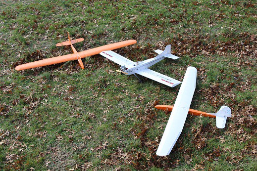

      Sig Riser #2 is completed airframe wise. It just needs the radio install. Riser #1 has double tapered outer panels and Riser #2 has a straight LE. A comparison can be made in the last picture. They are the same structure otherwise.

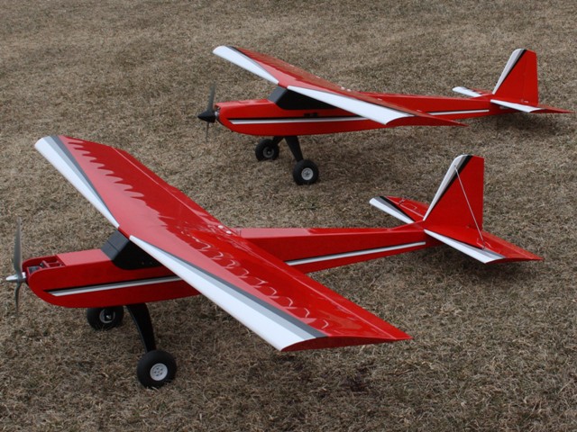

        This sure brings back memories...While you are mainly concentrating on the sailplane side, I was working more on the tow plane side. Here are two of the Telemaster 40 tow planes I built between 2007 and 2012:
        Click image for larger version  Name:	TM40 002.jpg Views:	0 Size:	116.2 KB ID:	39010
        The one in the rear was built in 2007 and had an OS .52 4-stroke glow engine. The one in the front had an electric motor running on a 4-cell LiPo. Performance was very similar between the two with these power systems.
        The electric version was built from the newer Deluxe kit (still offered by the present owner of the Telemaster designs). The older glow model was built from the original kit design.
        Click image for larger version  Name:	TM40 003.jpg Views:	0 Size:	95.8 KB ID:	39016

              Dustin- I eliminated the outer panel dihedral but kept the stock center wing joiner/dihedral angle. They really don't need the dihedral except to keep the models from catching a tip at take-off or landing. Also, I cut strip ailerons from the kit stock TE. They work just fine. I was lazy and 'didn't' but do put spoilers on that Gentle Lady! I was flying last Spring(or was it Summer?) and got caught in a boomer. It ended up being a 78' flight but at times it was at my limit of vision at '400 feet'. With a rubber band-on wing I couldn't do too much and was afraid of overspeeding if inverted to lose altitude.
              Memory isn't good. I reduced some of the dihedral in the center by cutting the wing joiner a little.
