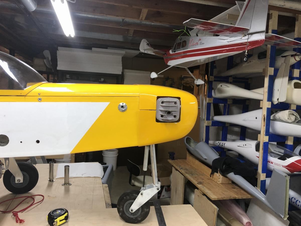

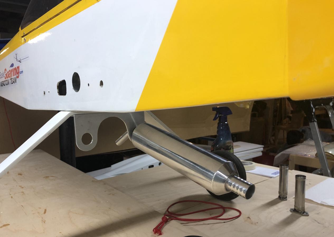

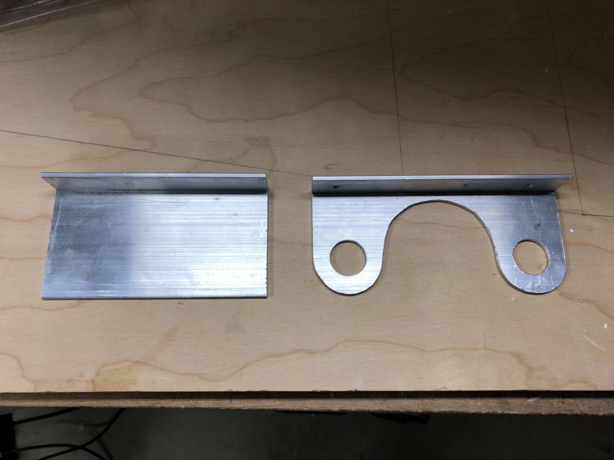

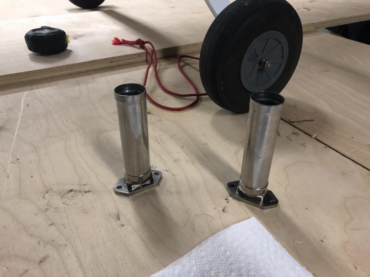

                          Brian, no, it seem that now the preferred way to do it is just splitting the cowl on the back if the cyclinders
                          I finally got around installing cans and cowl on my bidule
                          I picked some rear dump can that I will hold from the dump pipe, I transformed some L shape aluminum in a support yesterday and split the cowl today with the advises of Jim, tomorrow should be welding time
