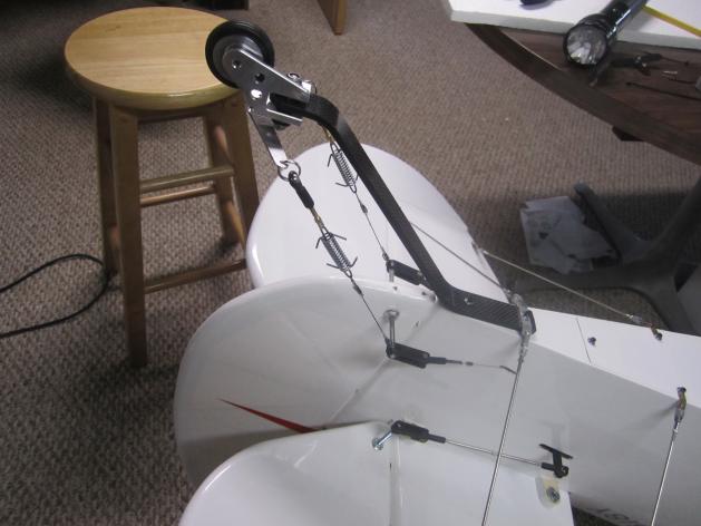

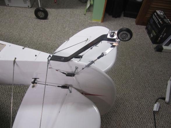

    Got the tailwheel mounted and connected. Went with the Whiterose Engineering Tailwheel.

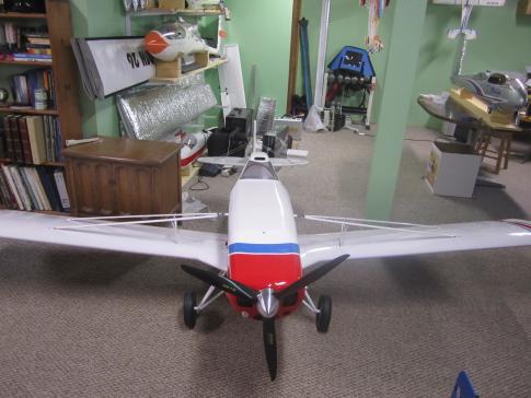

      Well, here it is. Done! Not really, need to balance, set throws, and do a littl programming. Thanks to all that guided me through this.

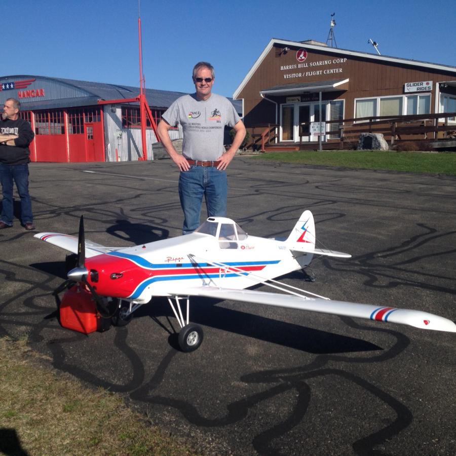

      • #78

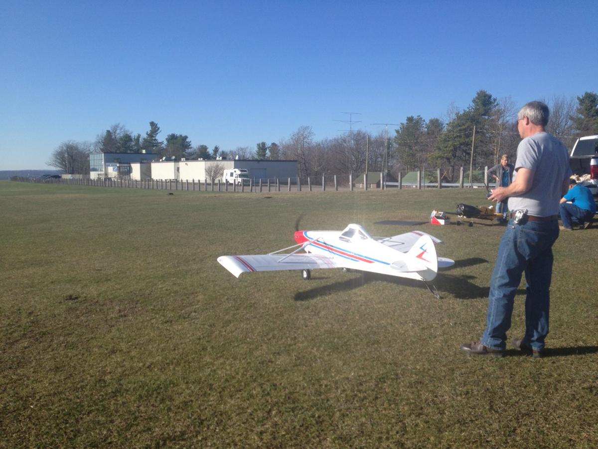

        Took the Pawnee for Maiden. Flew well and towed Kevin's 233 at Harris Hill. Cool.

        • #79
          Look at you two!!!!!
          Hard to believe only 3 years ago you just got serious about aerotowing. Very cool.
          Way to go guys!

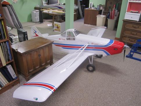

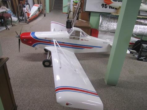

              Doing some work on the Pawnee, thought I would post pictures. Also wanted to show the new realistic pilot I got. Steve K Click image for larger version

                I like the shout out to Horizon Hobby with the N number also! 👍
