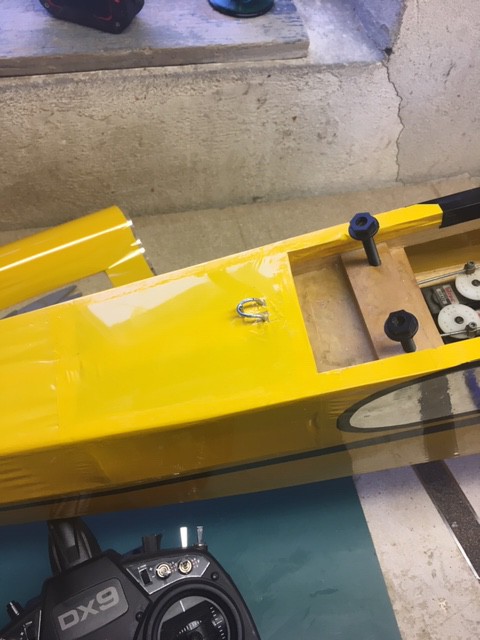

    I already fly a Telemaster 40. It's been on my list of things to do to put a tow release in it, so that's what I've done. I looked at the other threads about towing with a Telemaster 40 and came up with a plan for my tow release. It's a different from the other installs I've seen. Other installs have the tow release servo installed near the CG and using a bell crank. My Telemaster 40 is powered by an OS 56 Four Stroke, so the servo rails near the CG are full (throttle, elevator, rudder). Now, I already have the battery and receiver as far aft as possible to balance the airplane, so I don't think it will be a big deal installing the tow release servo behind the CG. I can just move my battery/receiver forward and still get things to balance. So that's what I've done.
    Click image for larger version  Name:	IMG_1336.JPG Views:	0 Size:	62.2 KB ID:	41544

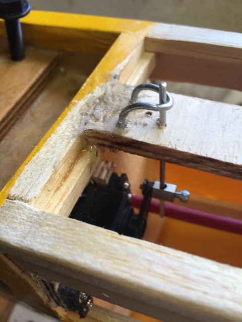

      Here is the finished modification. Stay tuned for step 2, build a Sig Riser .
