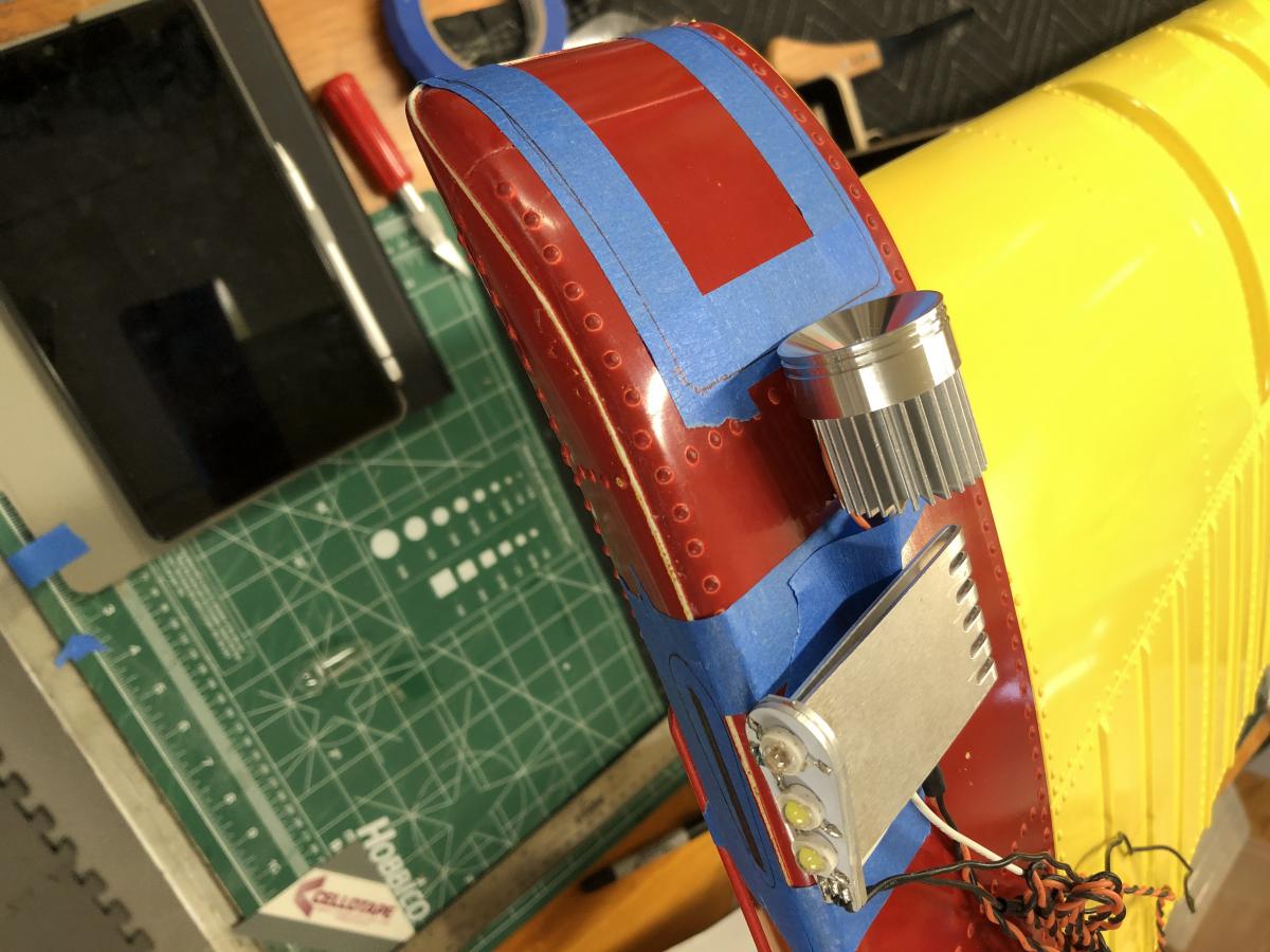

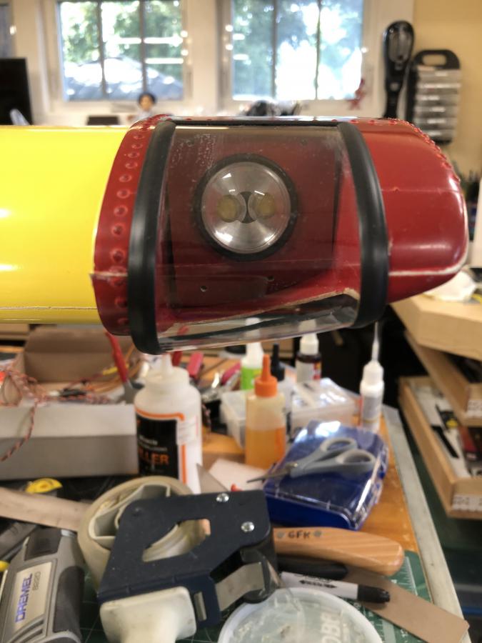

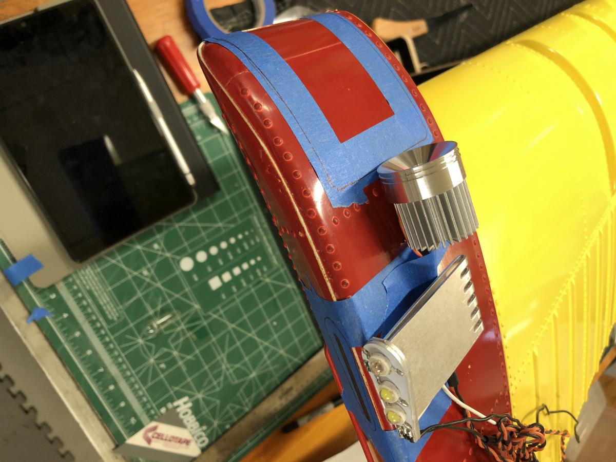

      Making good progress, but the motivation now is that it has become a build for a customer. Specs are nearly the same, slight changes in the Jeti and Powerbox stuff. Expect to finish up in a
      couple of weeks. Lots of wiring harnesses with all the lighting stuff.

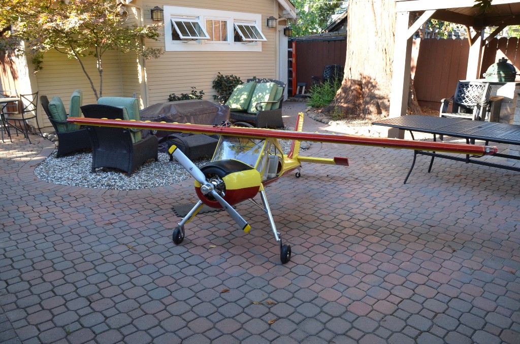

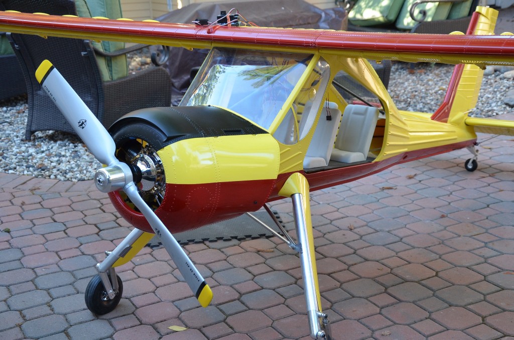

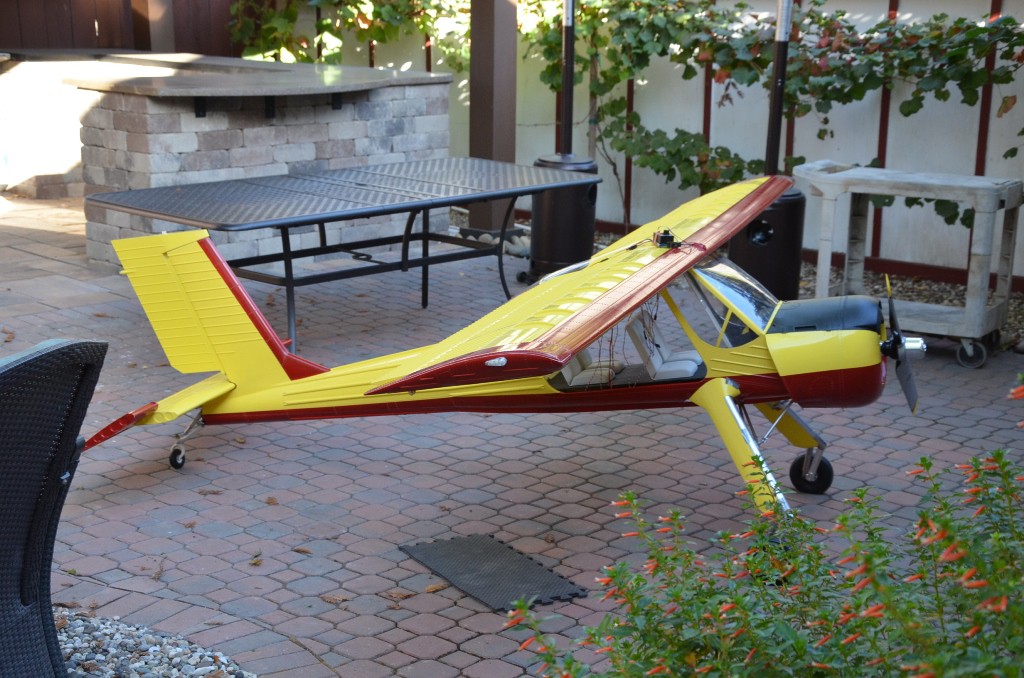

        The Wilga was completed in September and picked up by the client. Here are the finished photos. I will add a sequence of the construction photos and info in the next couple of days. The final RTF weight is 53 lbs with fuel. The spinner is custom made, still needs paint.
Name:	Wilga 35 done 1.jpg
ID:	43239 Click image for larger version
Name:	Wilga 35 done 2.jpg
ID:	43240 Click image for larger version
Name:	Wilga 35 done 3.jpg
