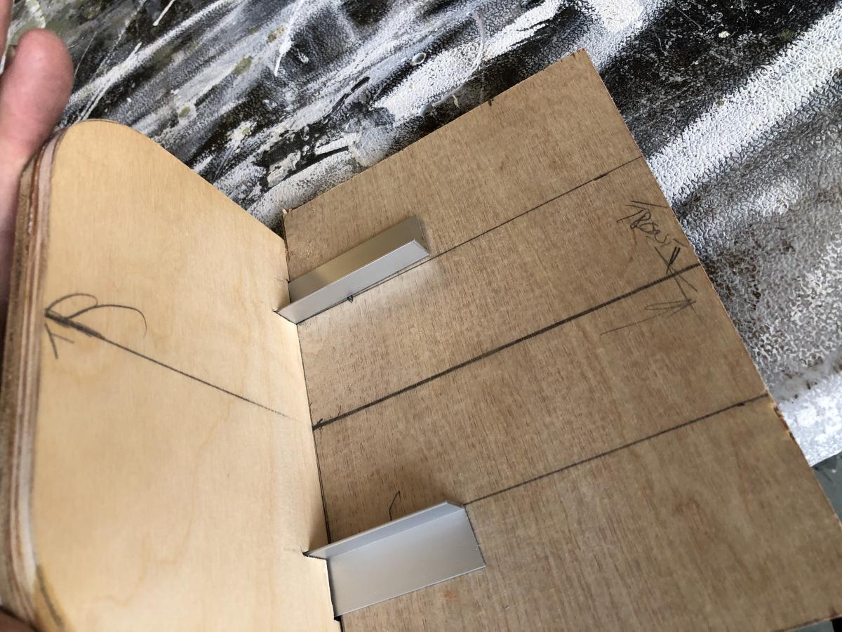

      mine is installed and rtf just need time off to take it out maybe this next weekend torosewood rc site in southern indiana. i have a few gliders to tow up and maiden also.....only worries i have are how strong the unit is since we do have a hempel ka 50 pounder to tow up. just worry the direct pull on the unit will be more than it can handle. i am going to source some of the fishing line for the loop into the winder as it came with and hope that is strong enough for the tow but fail safe if things go wrong... dont need my canopy and winder getting pulled away when under a large load towing.. just not the same as being through a rod in the original tow release bolted to the former.

          sounds like all will be fine. i did mount it with angle inside on the existing floor with extra srtips of ply under mounting area each side. i have done all i can time will tell. i think i will follow the lead of using a loop at the winder end to assit in breaking free if a slack line gets a yank under hvy load towing. and you are right the hempel has 5 deg of positive main wing incidence so it is a hang glider at best. slow and steady forward flight is all it will do.

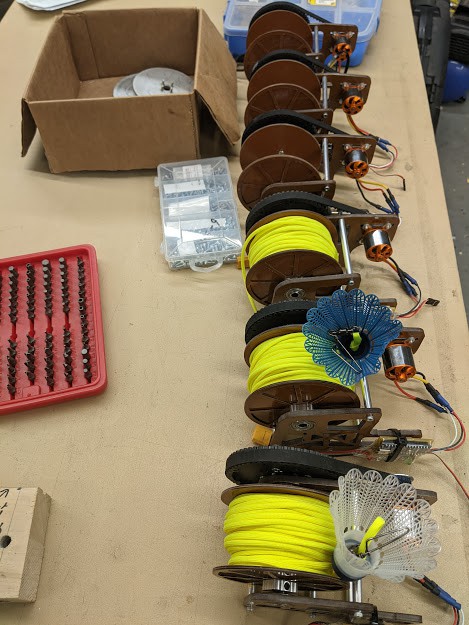

                        OK, fair warning. 2 of these winders of not spoken for. I will shelf them as ready to ship, but when they are gone... I'm not interested in making more till my PGD Birdog is built and a 6M ASG-29 rebuild is RTF. This will likely be all winter...
                        Holy cow there is a lot of work represented in this photo...Please enjoy!
                        Click image for larger version  Name:	image_16888.jpg Views:	232 Size:	92.6 KB ID:	42620
