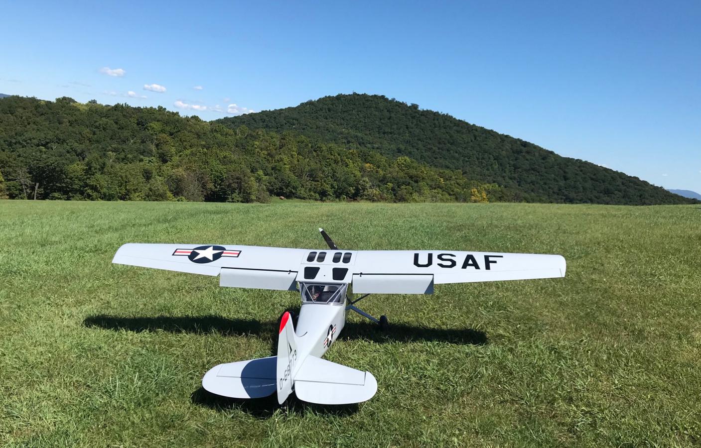

                    Got Flaps?

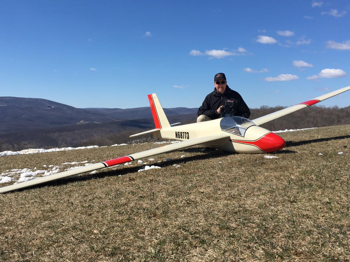

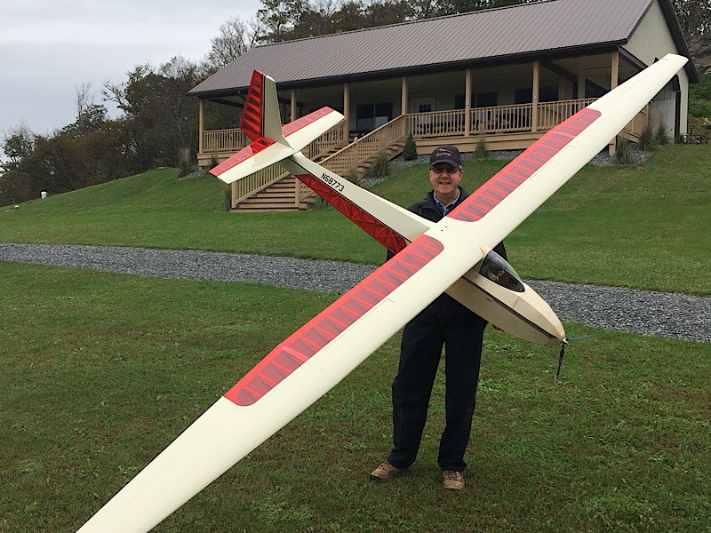

                              On a beautiful September evening, our Cessna L-19, Cmelak, and Schweizer TG-3 enjoyed some flight time.
