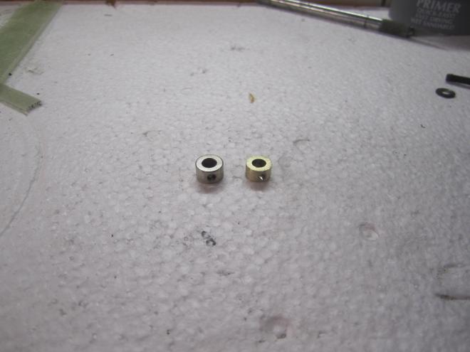

                Doing some maint on Porter #1
                There is a wheel collar at the bottom of the landing gear strut - after significant measuing, looks like I need a 4 mm wheel collar. Assuming that the OD of a 4mm wheel collar is 9mm.
                Can you verify this for me?
                Where can I get them?
                Thanks
                  Steve,
                  The original parts had brass spacers in these joints with a 4 mm bolt holding things together. The brass inserts were quickly worn out by pivoting on the threads of the bolts. As the parts failed, I substituted wheel collars that were close in size. Using a large milling file, the thickness of the wheel collar was reduced and the opening in the strut was drilled out slightly to match the diameter of the wheel collar. I think I even had to drill out the hole in the collar to allow the 4 mm to pass through.
                  I got longer 4 mm bolts that were not fully threaded (like a shoulder bolt) and cut off the excess length. This gives a smooth shaft for things to pivot on.
                  Seems to me that the wheel collar size was 1/8".
                    The wheel collars you put in were pretty worn. I had already started filing to get the thickness correct. The OD was too big and I did not want to open up the hole in the strut. So, I locked the wheel collar on a 3/16" drillbit, put the drill bit in the drillpress, then, held a file against it until I got to the correct diameter. Then drilled out the set screw as the hex pattern was gone. Worked pretty well. Thanks Jim

                      Make sure the bolt that goes through the collar has smooth shank where it passes through otherwise the threads act like a file and chew up the metal.
                        Thanks Len. Did that!
                          Steve,
                          If you can give me the outside diam of the collar and the inside, plus thickness, I can turn a few for you out of bronze. I have some bushing stock that would work well, I have some oilite bushing stock too.
                          len
                            Len,
                            OD=9mm
                            ID=4mm
                            Thickness=5mm
