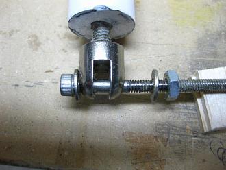

        I installed 2 inch bolts so the shoulder extends all the way through the pivoting surface. Then cut off the excess threads.
        Click image for larger version  Name:	IMG_4892.JPG Views:	1 Size:	104.4 KB ID:	34769

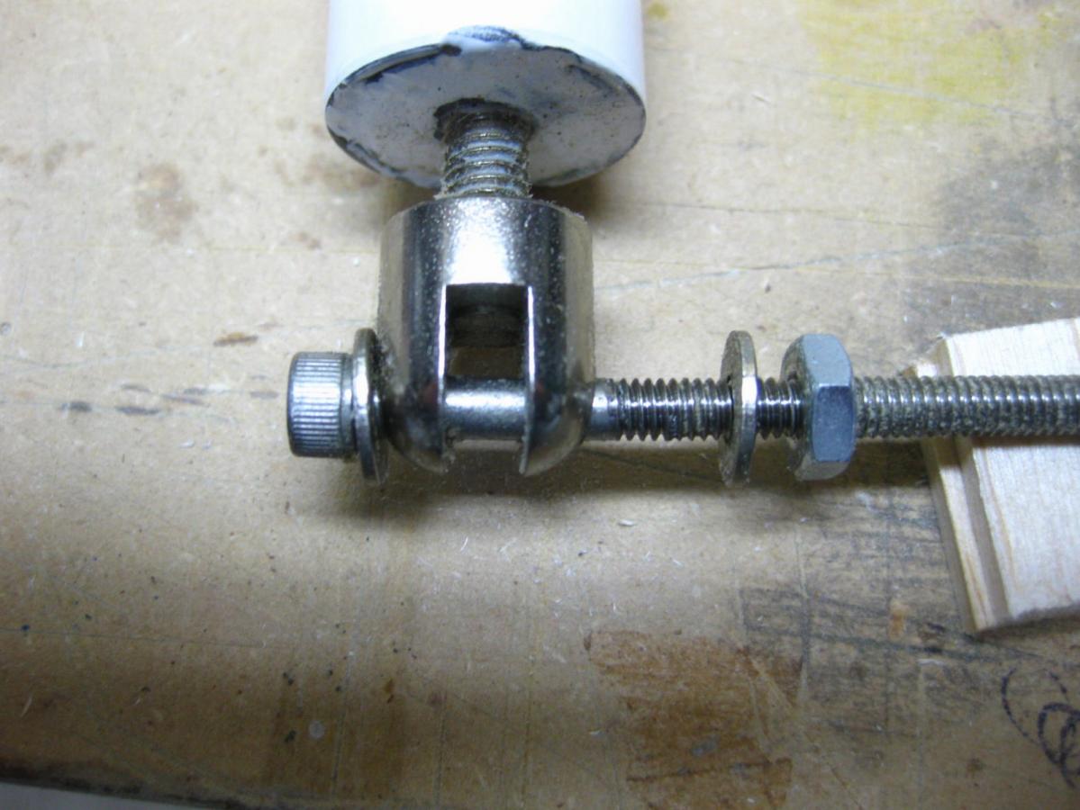

          The screw that is bent is the one that comes out of the cylinder

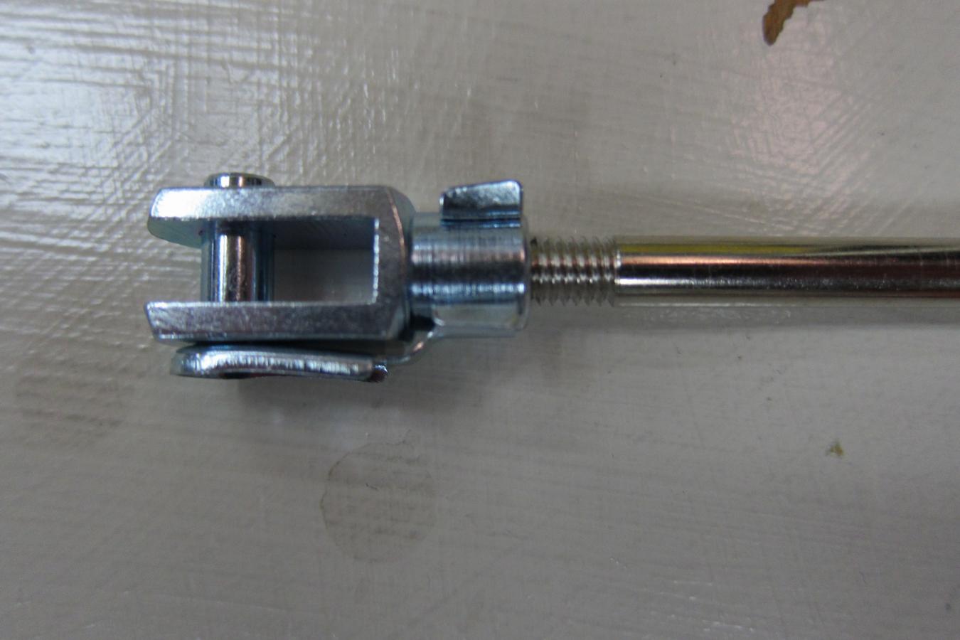

                Got the replacement landing gear and the shocks are included.Unfortunately the thread on the end of the piston is slightly different to the original and the shock end (clevis) does not fit. I cannot identify the new thread so cannot tap a new thread. AAArggg
ID:	35797 The new threaded rods I have here from HOrizon Hobby are 5 mm metric. I never received the original Pawnee Clevis, but rather ordered Metric ones from McMaster Carr as shown in this photo....Not sure if that will help your situation, but the McMaster Carr Clevis fits both the rod and the landing gear hole.

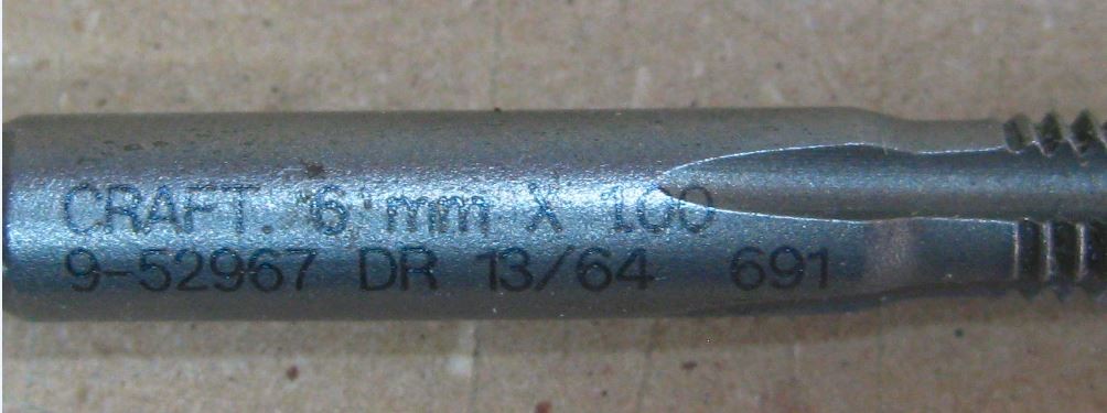

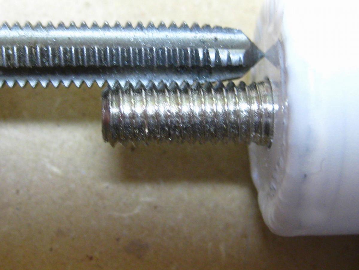

                    You can always hold a tap against the thread to see if they match. The spare set I have are 6mm x 1.00 pitch .

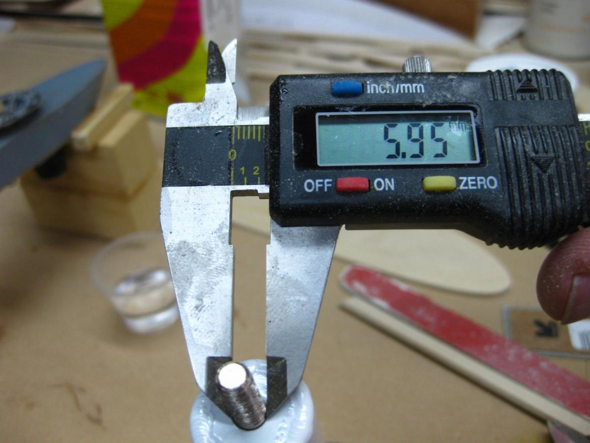

                    Or, you could measure the shaft diameter and then reference what thread pitch's are available for that diameter.
                    My metric tap and die set only has one pitch ( 1.00 ) for 6mm shaft.
                    Click image for larger version  Name:	IMG_4949.JPG Views:	1 Size:	96.4 KB ID:	35804Click image for larger version  Name:	Landing gear tap.JPG Views:	1 Size:	76.7 KB ID:	35806
                    Click image for larger version  Name:	IMG_4951.JPG Views:	1 Size:	92.5 KB ID:	35805
                      Eureka! You are right, 6mm it is. Can't believe I didn't spot this before. If the clevises fail due to the extra tappings I will try the McMasters Carr Clevis.Many thanks to you both.
