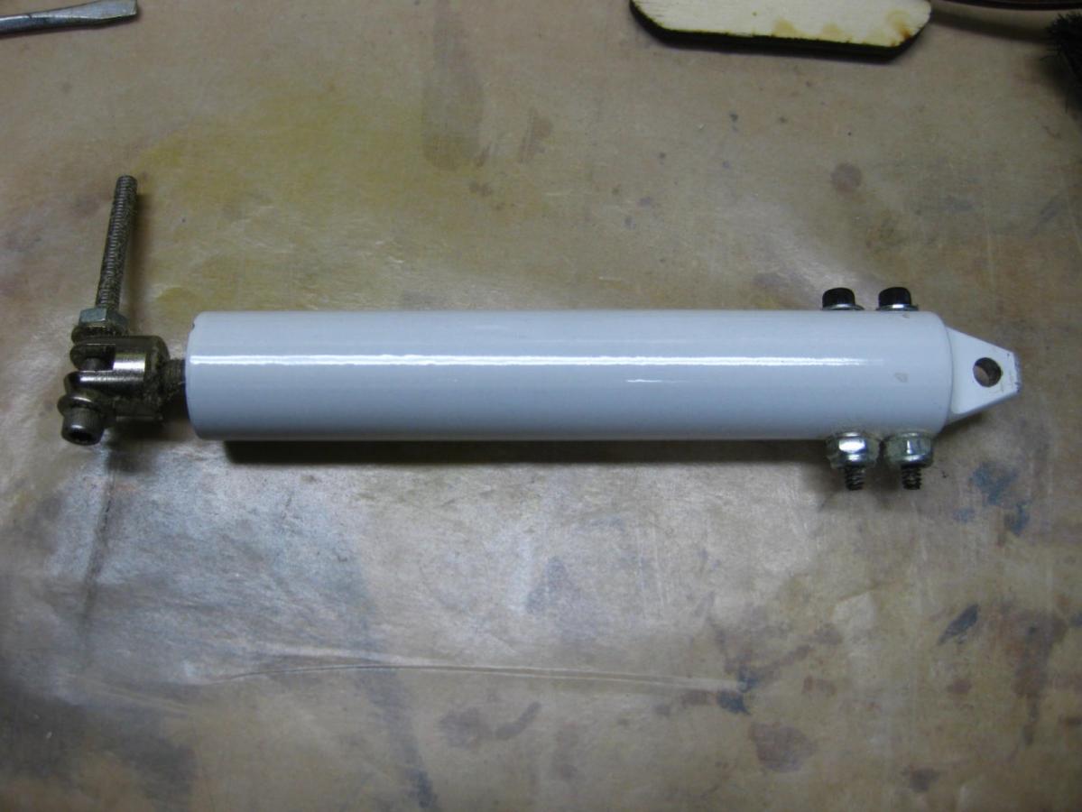

                          I have ordered the springs from McMasters that Jim recommended. Pardon my ignorance but can they be changed from the bottom? The top end is VERY securely installed with Loctite etc.
                            Unfortunately, the top of the shock assy is where the spring is changed from. Two bolts secure the cap in place.
                            the bottom piece comes off too and the piston is removed from the top .....and then the spring.
