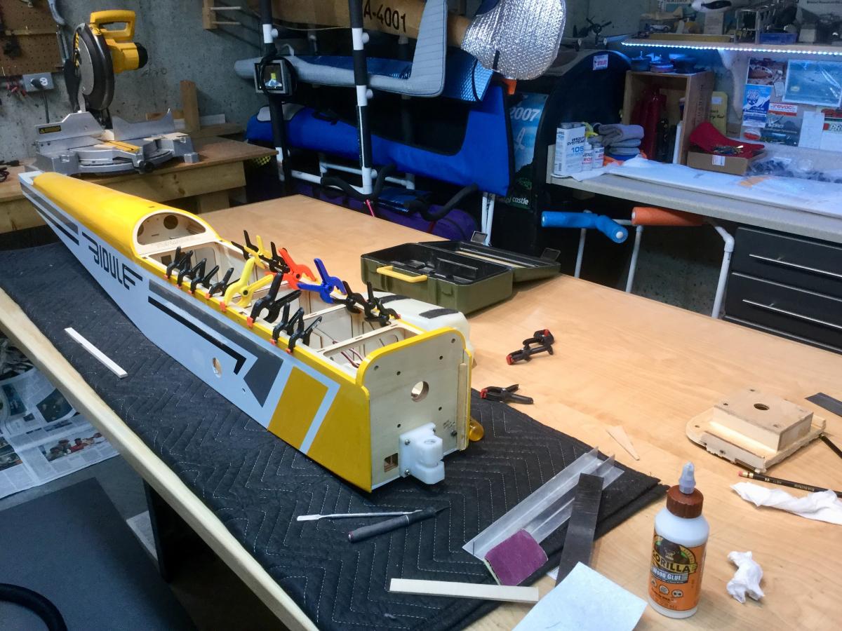

        The Budule 111 built by Jim and running a DA100 was a champ at the recent Cumberland Summer Soar. A great performer up to and including the 6.6 meter Arcus models.
        The rumored return of the #2 Bidule "120" is well on the way to completion. Wings done, tail done, fuselage reinforcements in place, recycled motor mount box installed, all the servos in the fuse, gear all set and ready to mount. No more progress for the next couple weeks due to work and travel, but then it's just a big push to make-up the headers and tubing leading to the tuned pipes, install wing clips, final assembly and radio programming.
        Click image for larger version  Name:	D5B80DDD-ED8F-48FD-92A8-5D266B501945.jpeg Views:	1 Size:	161.1 KB ID:	28453
        • Mosquito
          Mosquito commented
          Love the balsa triangle stock!
