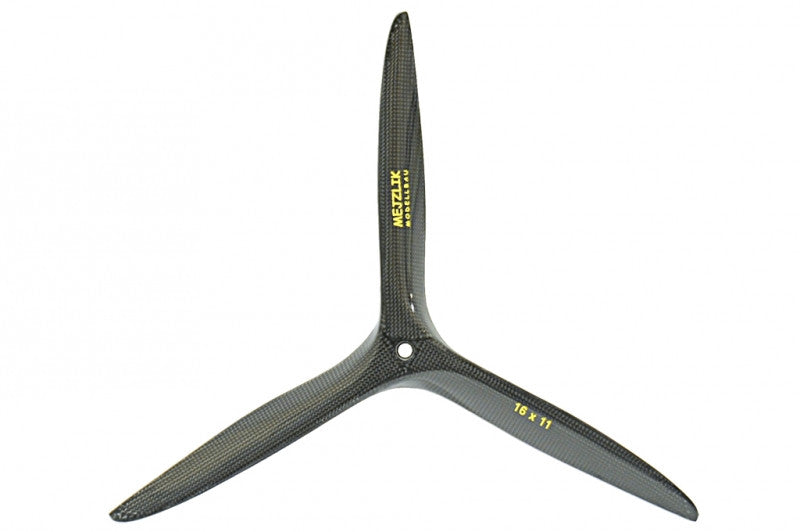

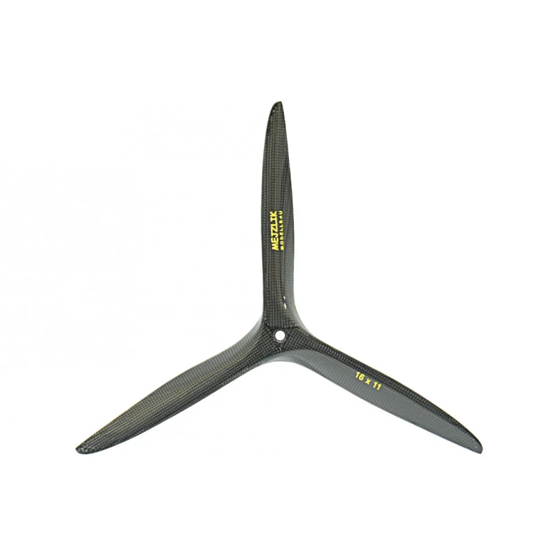

I'm using a DLE 170 on my Bidule with a 28.5x12S Mejzlik 3 blade carbon prop. The down side? $190 a pop! It is quiet and efficient. With the nose gear, I'm not concerned about a prop strike on the ground so the prop should last me a while. "Should" being the magic word.
Mejzlik Carbon props are the most popular props for most of the top large remote controlled acrobatic model pilots. It is almost a rule that eight out of every ten pilots of the most prestige world acrobatic competitions are using Mejzlik’s props. Be one of them! Mejzlik’s props are supporting higher performance and
