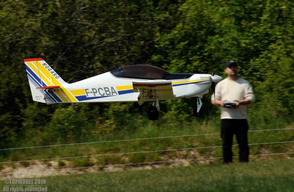

    It's time to put together this tug I picked up last summer from Icare-rc. It's a scale model of the "Midour" which is a two seat tricycle gear tow plane.
    The Midour is a double-seat, low-wing monoplane of conventional configuration, fitted with a fixed, tricycle undercarriage. Developed in the workshop of the ACBA using the wings of a Robin DR400, the Midour first flew in the early 1970s and four additional examples to the original design have been built, along with two modified versions.
    Although the Midour is sometimes equipped with only a single seat, a passenger can be carried behind the pilot, to assist in the release of gliders being towed.

    The Model version was another offering from Top Model Fr, which is the company producing the popular Bidule line of tow planes. Since this had the look of a real plane its a no brainer to get one and see how it works.
    Unpacking the box I was pleased to see a quality built model with a nicaae looking covering job. The fiberglass cowl is a two piece unit, pre painted and drilled to fit the fuse precisely and the landing gear is a really well made copy of the nose wheel on the Bidule. All three gear are shock absorbing struts with trailing link axles.

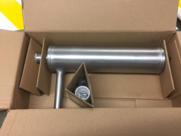

            The instructions call out for the MVVS 152, So I contacted MVVS in the Czech republic and ordered the motor, cans and headers which arrived about 3 weeks later. The company was very professional to deal with and the cost was about $600 cheaper than its equivalent.
            Click image for larger version  Name:	IMG_4656.jpg Views:	2 Size:	10.6 KB ID:	14792
            Canisters and couples were packed carefully

            Header are heavy wall aluminum, similar to the ZDZ setup

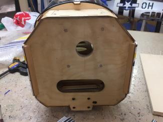

              Mounting the MVVS motor starts with filling in the holes drilled when we tried to install the DA 150.
              Click image for larger version  Name:	IMG_4682.jpg Views:	2 Size:	13.7 KB ID:	14801

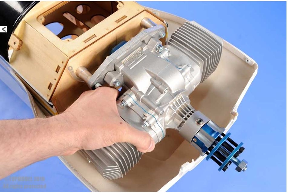

              Fitting the MVVS motor is next. It's a rear carb setup, so I need to make an extension for the upper motor mounting holes, otherwise the bolts will very close to the carb hole in the firewall.
              ( something to think about in future Bidule / ZDZ 180 install )
              A mount template was made and we began making the mounts.

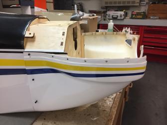

                The motor mount was fabricated but we had to put it on the sander due to some top cowl interference, a bit of grinding and "problem solved"
                Click image for larger version  Name:	IMG_4696.JPG Views:	1 Size:	9.4 KB ID:	14888
                Side view showing the dual spark plug in the head.
                Click image for larger version  Name:	IMG_4692.JPG Views:	1 Size:	8.6 KB ID:	14890
                Fitting the headers required a bit of "adjusting" to the existing opening. Nothing too major though
                Click image for larger version  Name:	IMG_4693.JPG Views:	1 Size:	8.9 KB ID:	14892
                Still working the opening here
                Click image for larger version  Name:	IMG_4708.JPG Views:	1 Size:	12.9 KB ID:	14889
                Finally we were able to line it all up Click image for larger version  Name:	IMG_4690.JPG Views:	1 Size:	8.3 KB ID:	14887
                Click image for larger version  Name:	IMG_4688.JPG Views:	1 Size:	9.1 KB ID:	14891
                Click image for larger version  Name:	IMG_4691.JPG Views:	1 Size:	13.4 KB ID:	14893
