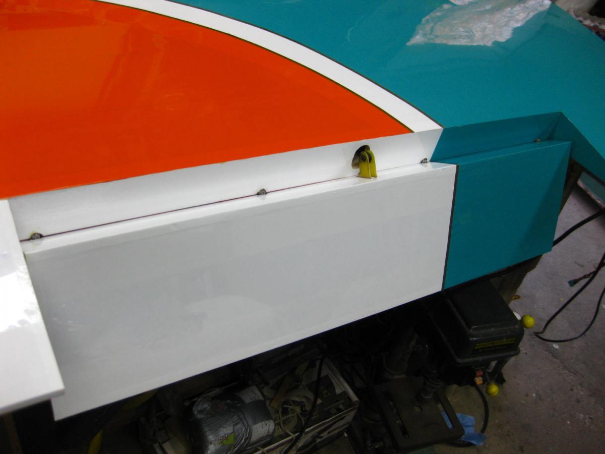

    Progress so far......converted the flaps to top driven 180 degree servo movement .... an effort to keep the flaps up when the power is off and lower current requirements when down

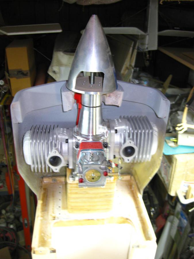

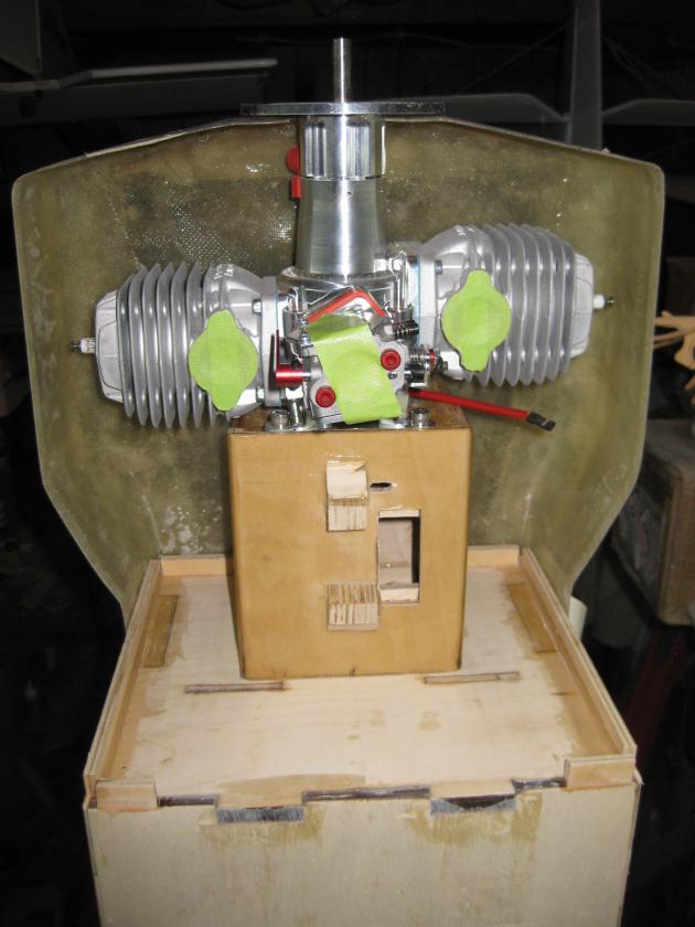

    Got stuck on the firewall forward section - was going to put a DA150 ....but found out the size of the engine was incompatible with my cowl.
    So I opted for a DA120 that was smaller than the MVVS 116 that was in my old one.......Then, because of the Bidule170 build, I found a DA170 would fit in the cowl (with some minor adjustment)
    Here is the DA 120 vs DA170 in the Cowl
ID:	11677 Click image for larger version

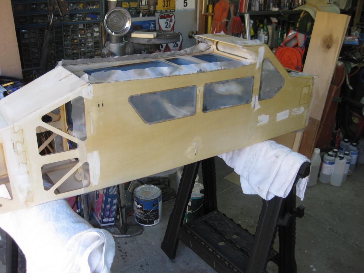

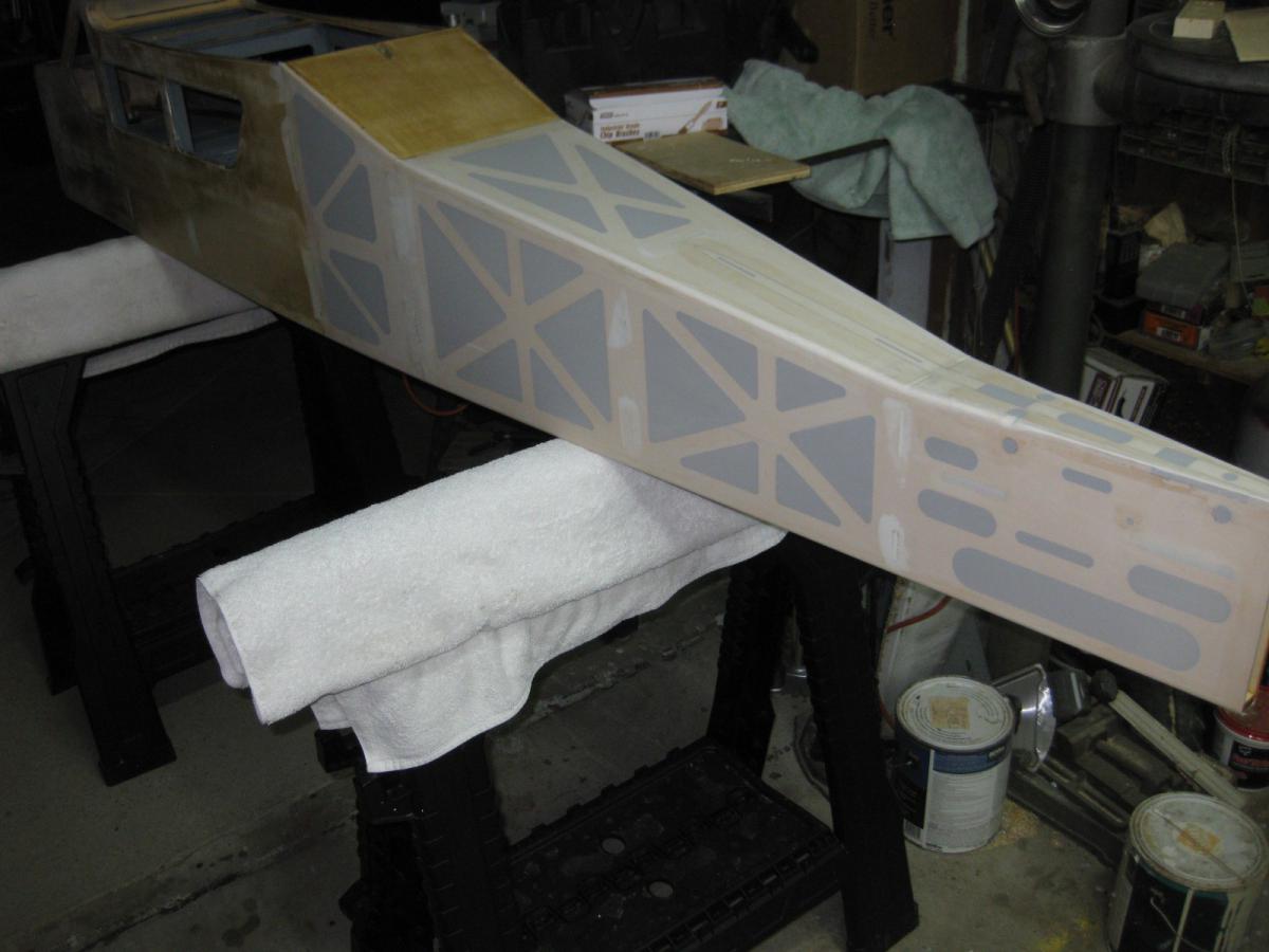

      Fiberglassing the front half and then Stits lite on the back half.
        I like the smell of Poly-Brush in the morning........

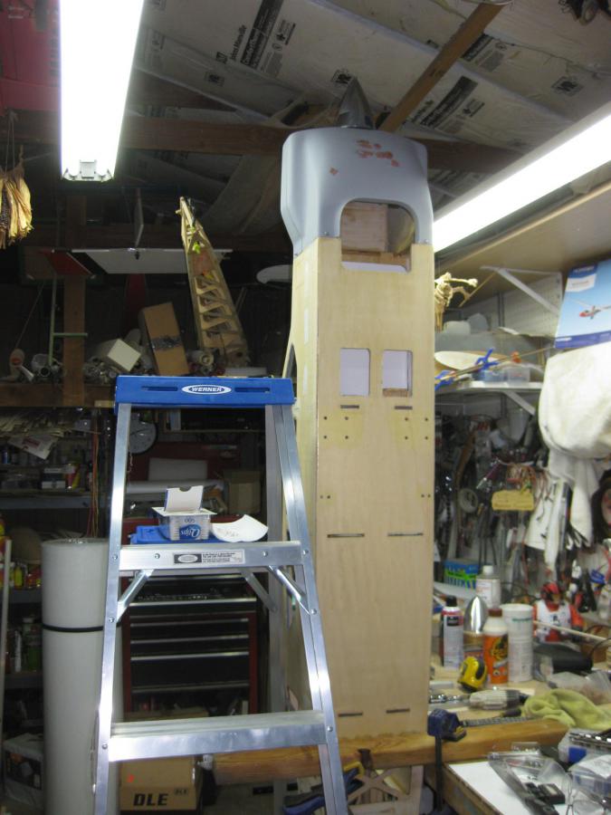

        Mounting the DLE-130 in the front

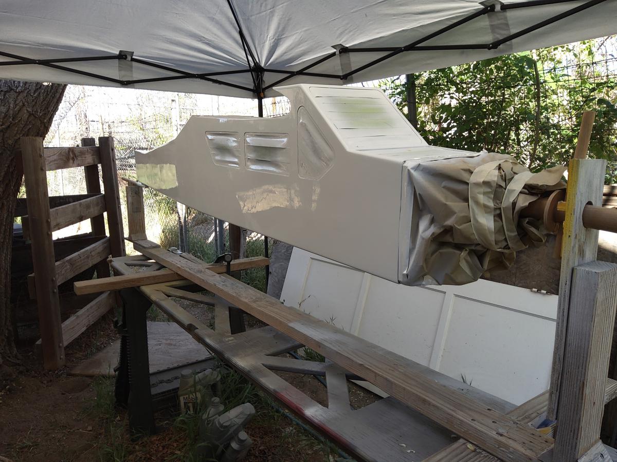

          After the standard Poly-Spray application ( so the covering won't be see thru ) it's on to the base white

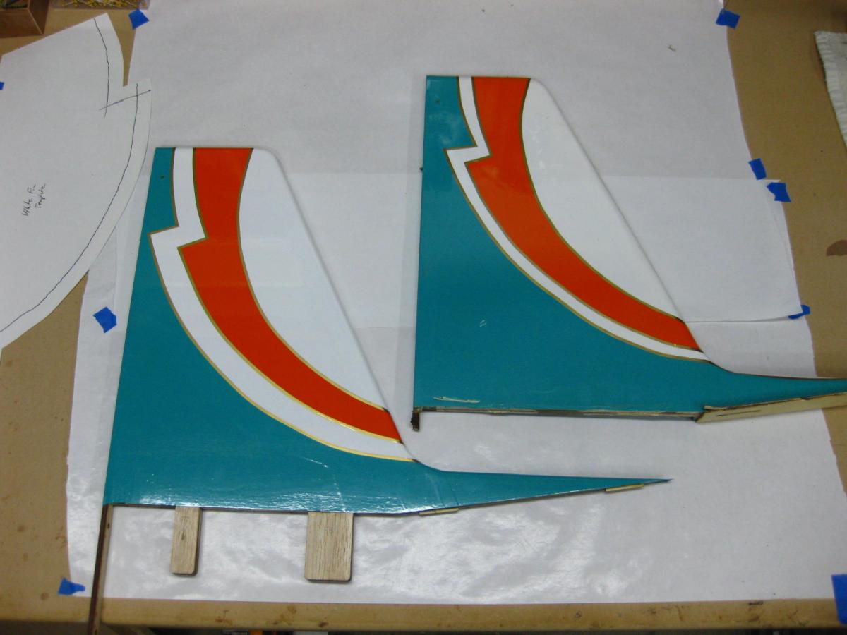

            Its been a while since I have seen the Payload Master, what are the parts in the forth picture of post 1?
              Hi Len,
              Fourth picture in post 1 is current fin/ rudder vs. old version

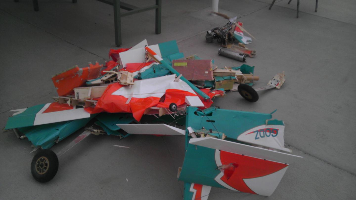

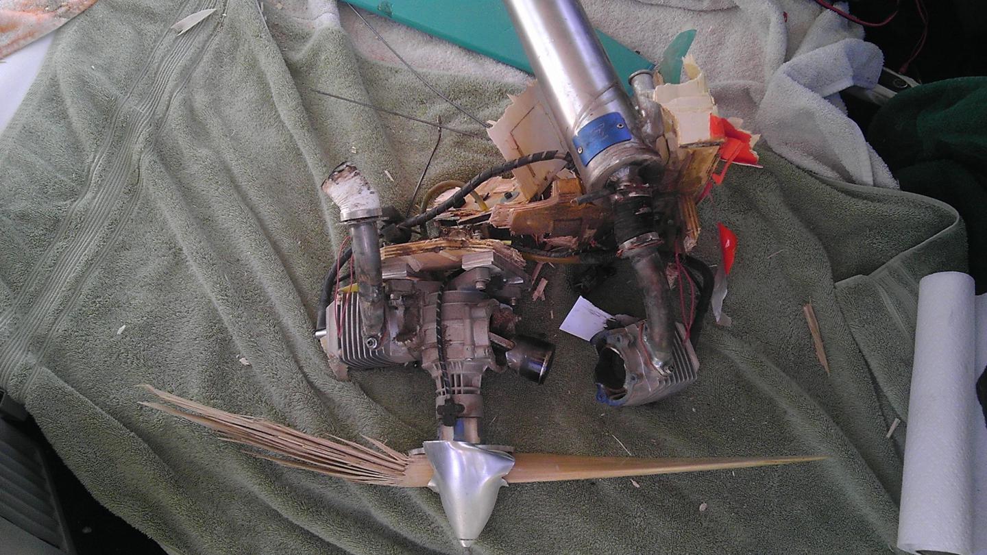

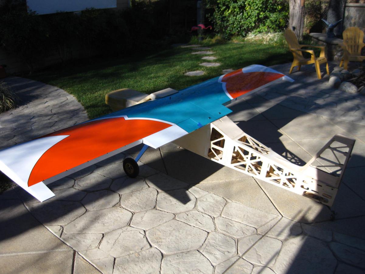

              Original PayLoad Master 100 suffered from depleted electron resources and "surface contact"
              the following "compact" photos are circa 2013

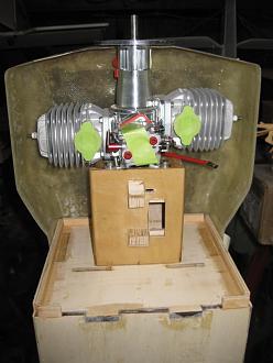

              Click image for larger version  Name:	IMAG0230.jpg Views:	0 Size:	82.1 KB ID:	44515 Click image for larger version  Name:	IMAG0231.jpg Views:	0 Size:	228.2 KB ID:	44514
              Decided to re-re-re-engine with the new DLE-130 so as to avoid making a new cowl ( didn't want the spark plug caps sticking out of the Icarus wing graphic on the front of the cowl )
              In looking over the Falcon Propeller chart, I won't be loosing that much performance from the 170/150 ( 32.5 kg thrust vs 38 Kg. )

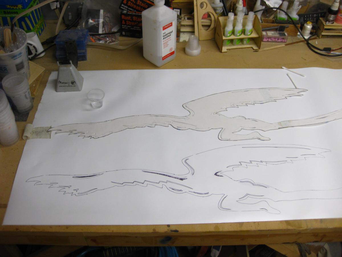

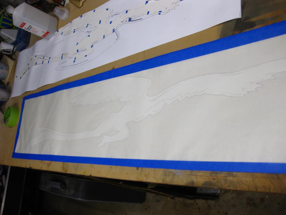

                Icarus image paint masks - cutout all the Accent details for this one.....then transferred to the paint masks .....and then cut them out .
ID:	48432 Click image for larger version

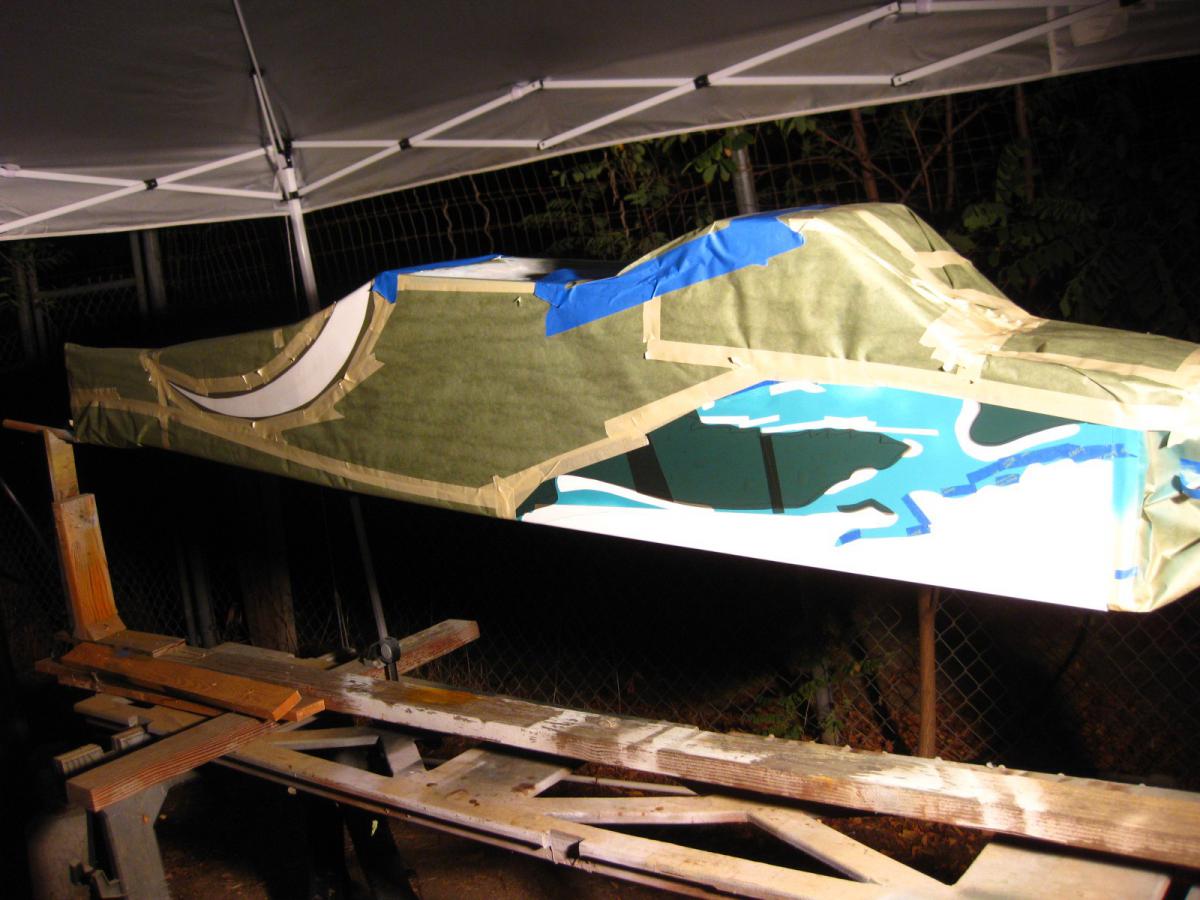

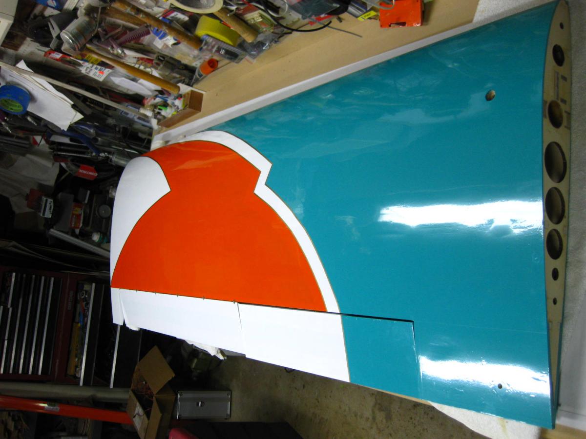

                Now I just have to find the big swoopy masks I used on the sides to cut out the ultracote.......

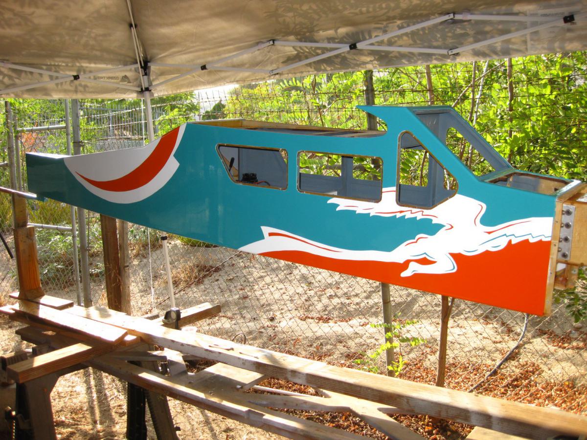

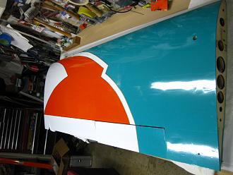

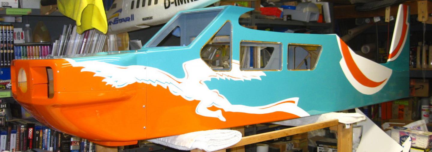

                  Had to cut out the left side Icarus graphic again as I placed it too high on the fuselage and there was no wing image below the window. Referenced some old pictures and got it a little lower so the accent lines will show up this time.
                  Now just waiting for paint to dry so I can mask off the Turquoise area and get some Omaha Orange.

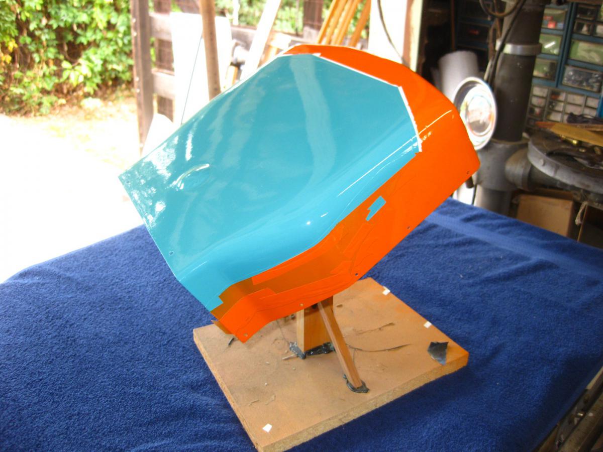

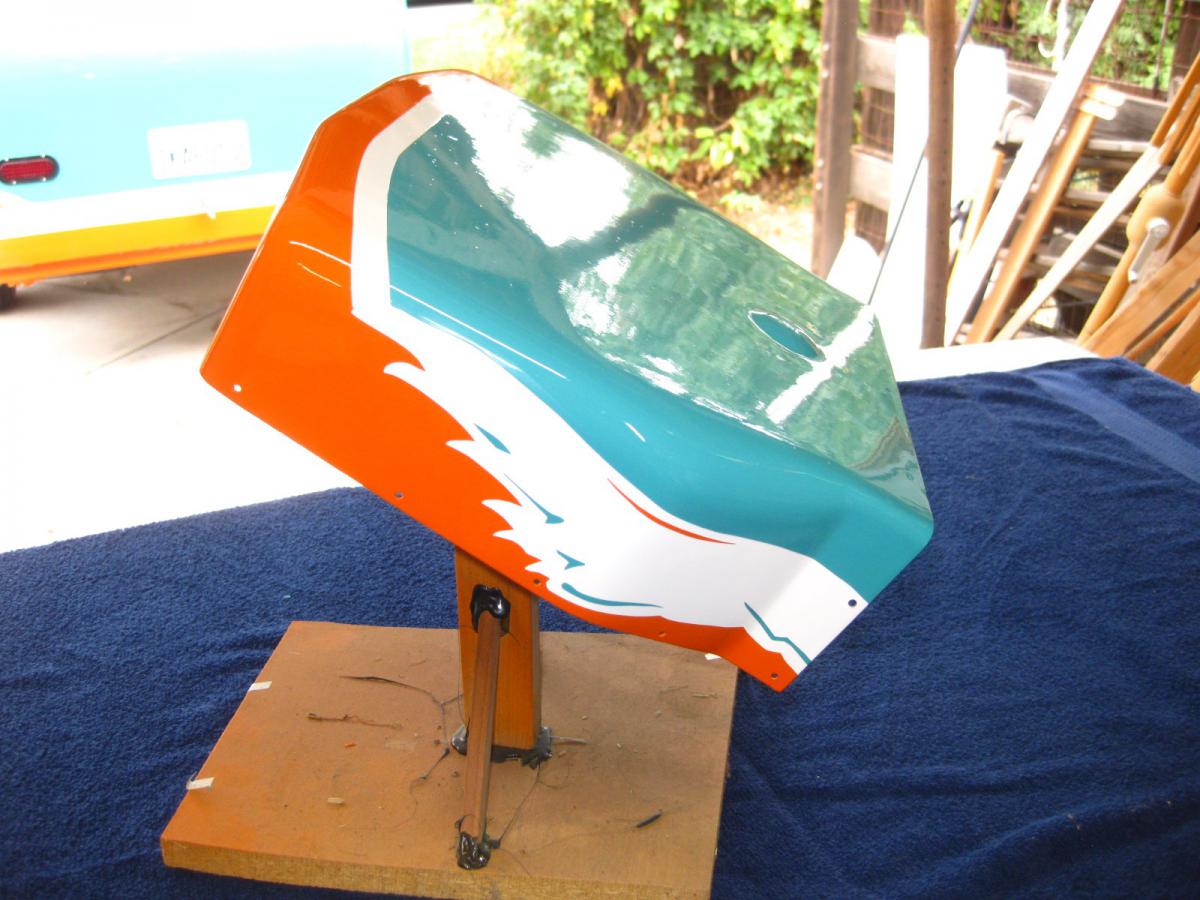

                  Upper Cowl waiting too for paint mask removal
                    i like it with the accent colors

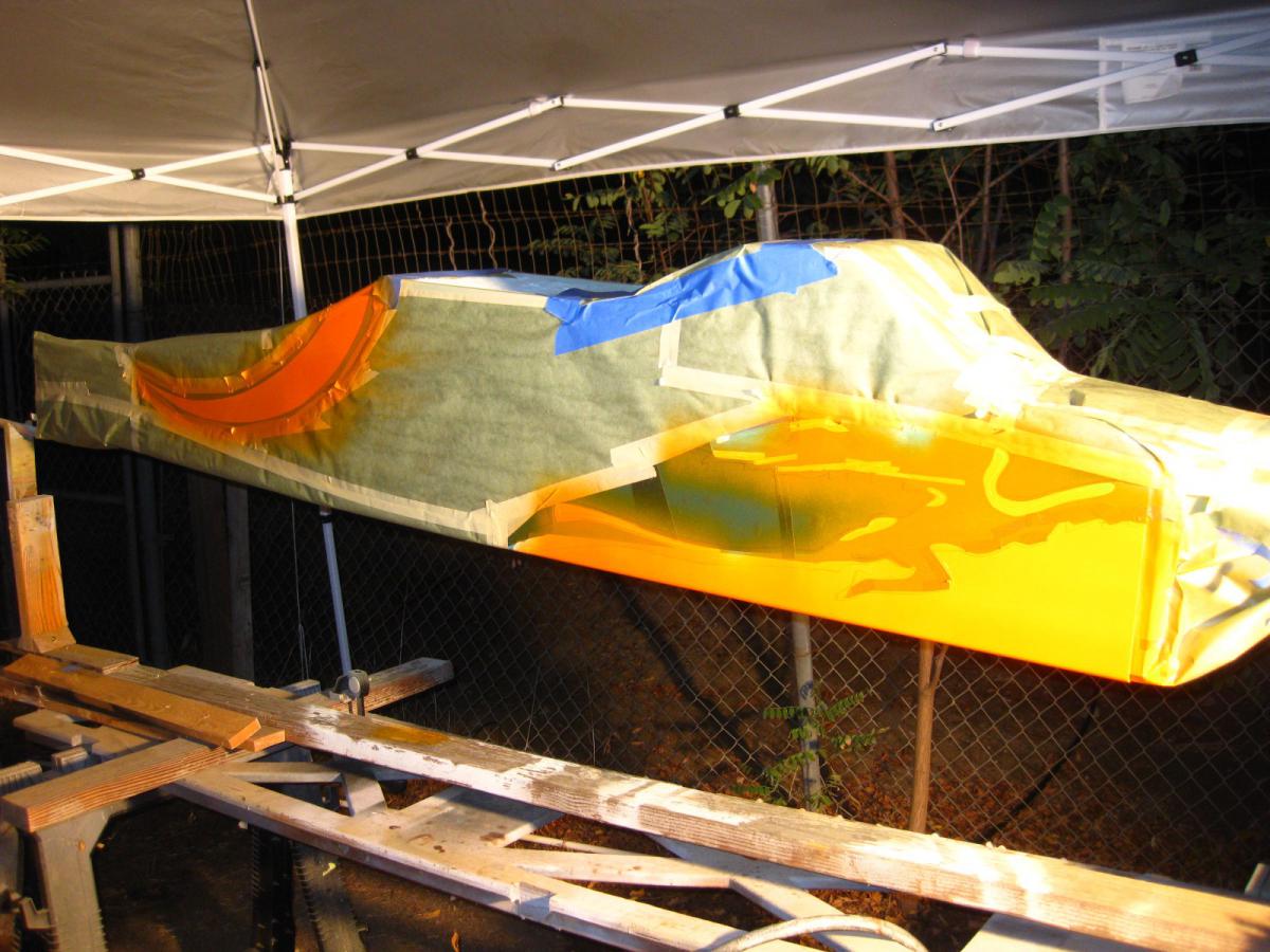

                        Meanwhile, ....back at the Masking / Painting Ranch.......it's going to be an Omaha Orange Sunrise ( first spray coat anyway ).
ID:	48447 Click image for larger version

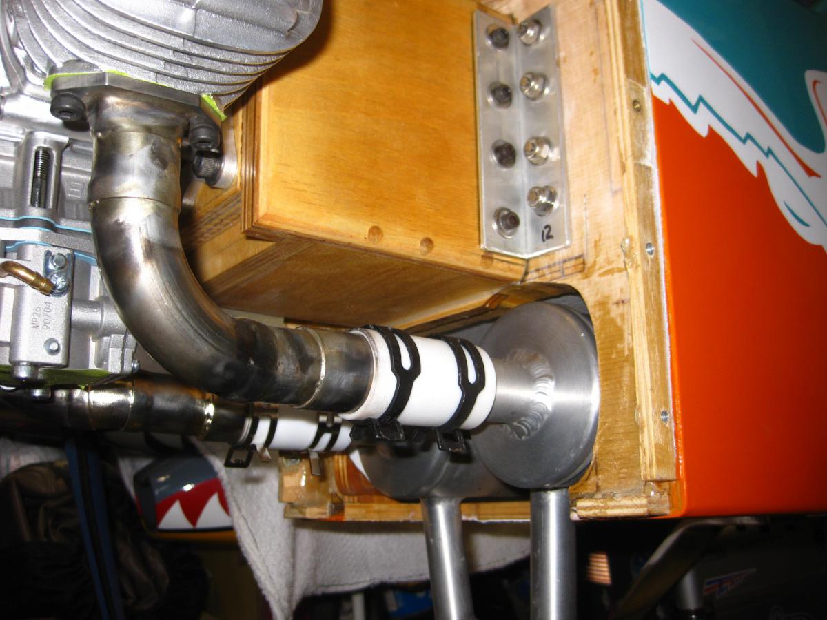

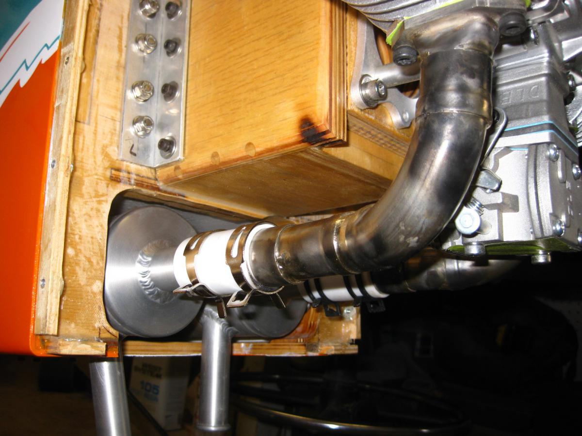

                            Exhaust headers completed, K&S exhaust stubs, 25mm elbows and 28mm connector tubes brazed together Using MVVS Canisters that are made for short header lengths.
                            Click image for larger version  Name:	IMG_6456.jpg Views:	0 Size:	122.6 KB ID:	48459 Click image for larger version  Name:	IMG_6455.jpg Views:	0 Size:	123.4 KB ID:	48461
                            Insulated the canister tunnel on this version
                            Click image for larger version  Name:	IMG_6453.jpg Views:	0 Size:	84.4 KB ID:	48460
