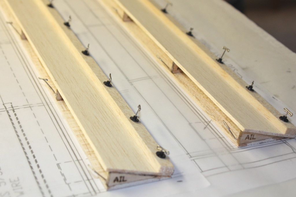

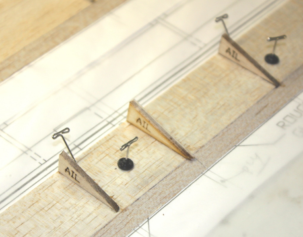

Cut the lower 3/32 balsa sheet for the aileron slightly oversize in width and bevel the edge. Pin the lower sheet over the plan. Glue all the ribs to the sheet. Note the two ribs where the control horn goes are 1/8 plywood. Use the cut-down Du-Bro #105 control horn to set the exact spacing of the two 1/8 plywood ribs. Cut the upper 3/32 balsa sheet slightly oversize in width and glue to the ribs and lower sheet. Use epoxy along the TE and CA for each rib. Pin a scrap balsa strip along the aft edge with plenty of pins. After the epoxy cures, unpin the aileron and sand the sheeting even with the front edge of the ribs. Check for straightness with a straightedge. Cut a slot in the bottom sheeting at the two 1/8 plywood ribs to fit the control horn.
Cut the 1/4 balsa aileron LE slightly oversize in width. Pin the aileron down to the building board with the front edge hanging off a bit. Apply some Titebond glue to the ends of the ribs and then use CA to glue the 1/4 balsa LE onto the aileron. Unpin the aileron and sand the LE even with the top and bottom sheeting.

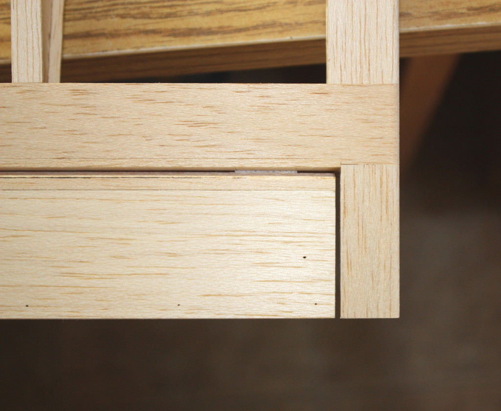

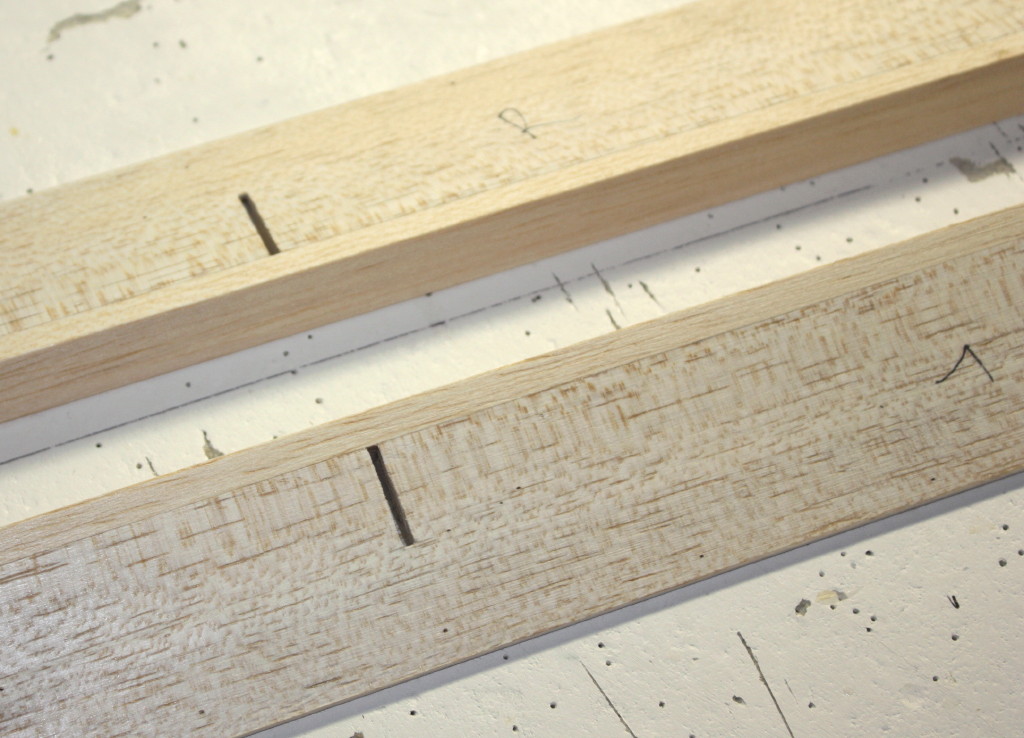

Refer to the plan for the location of the hinge line and mark this line on the aileron LE. Mark the position of the hinges and make the hinge slots with a #11 blade. Bevel the front of the aileron to the angles shown on the plan. Glue the cut-down control horn into the aileron.

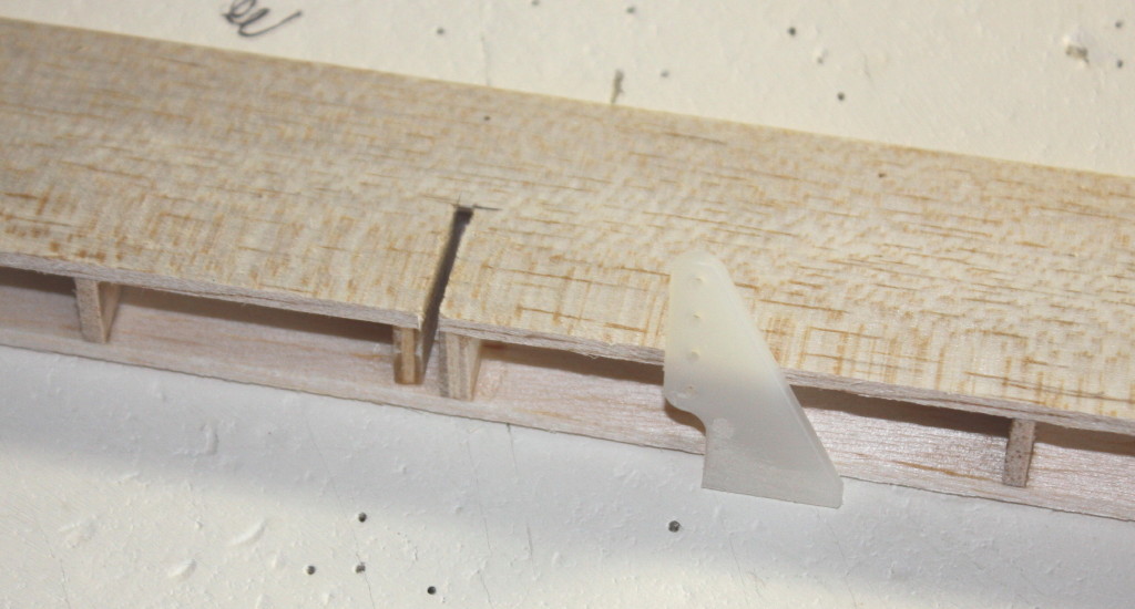

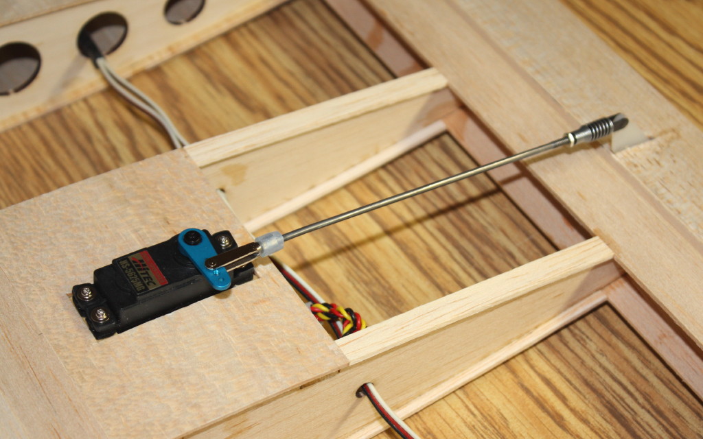

Carefully measure and mark the location of the hinge slots on the wing TE and cut the slots with a #11 blade. Temporarily mount the aileron servo to the wing. Make up the aileron pushrod linkage per the plan and attach it to the servo. Use an aluminum arm on the servo. Dry fit the aileron to the wing with the CA hinges and adjust the aileron pushrod. Check to be sure the gap at the root and tip end of the aileron is correct and adjust if required. Remove the aileron and the servo. The servo will be re-installed after covering and the excess wire tied down similar to the spoiler servo described previously.

1. Ribs glued to lower aileron sheet. Only one of the two 1/8 plywood ribs is shown here at the control horn location.

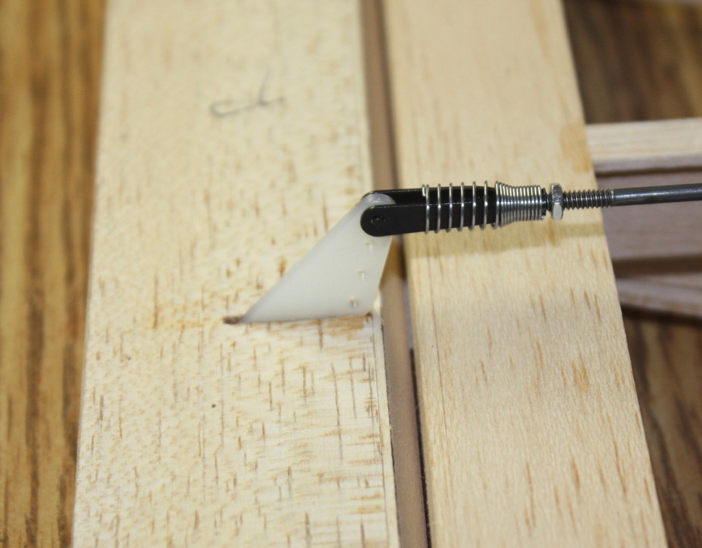

9. Close-up of control horn and 4-40 clevis
8. Aileron temporarily installed with servo and linkage
7. Hinge slot in wing TE

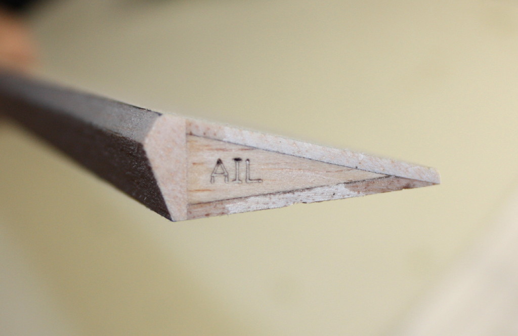

6. End view showing bevels
5. Hinge slot and beveled LE

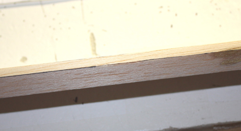

4. 1/4 balsa LE glued on and sanded even with the sheeting
3. Slot cut for the cut-down Du-Bro #105 control horn
2. Top sheet glued on using epoxy at the TE and CA at each rib. Note scrap balsa strip pined over the aft edge.
