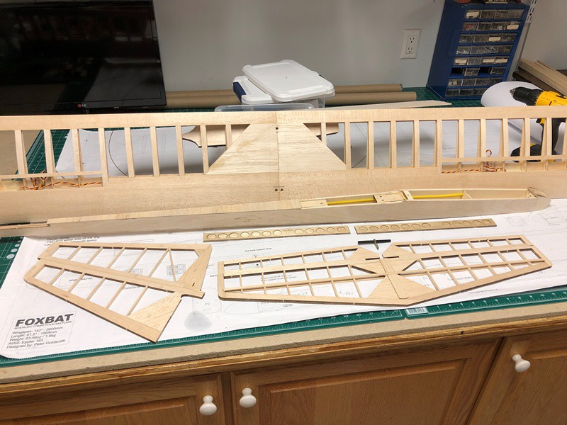

    Wingspan: 3.6m, 143"Length: 1565mm, 61.5"Weight: 1.6g, 54ozAirfoil: E1933 ch: Rudder, Elevator, SpoilerElectric option included The Foxbat design comes from Pete's youth. Yes at a very young age Pete was designing models. The Foxbat was designed originally in 1979 where it was campaigned on the competition circuit. It’s classic aspect ratio coupled with light wing loading makes it a wonderful Sailplane to fly. The kit is a fully authentic version of the original design, no compromise has been made to ensure its classic retro shape. If your into nostalgic competition you can’t look past the Foxbat. It’s very competitive with several National championships against its name. Super easy to build and can be flown as a electric or pure Sailplane. Although the Foxbat has a large wingspan, the wing disassembles into 3 pieces allowing it to fit in most vehicles with ease.. Kit includes all laser cut wood parts, all wood stock and skins for wings. Also included is a full size plan, electric motor install components and basic hardware for completion.Completion Items: Rud/Elev 2 x SPMSA5060Spoiler 2 x SPMSA7020Receiver SPMAR9030T Flight pack SPMB1450LFRX

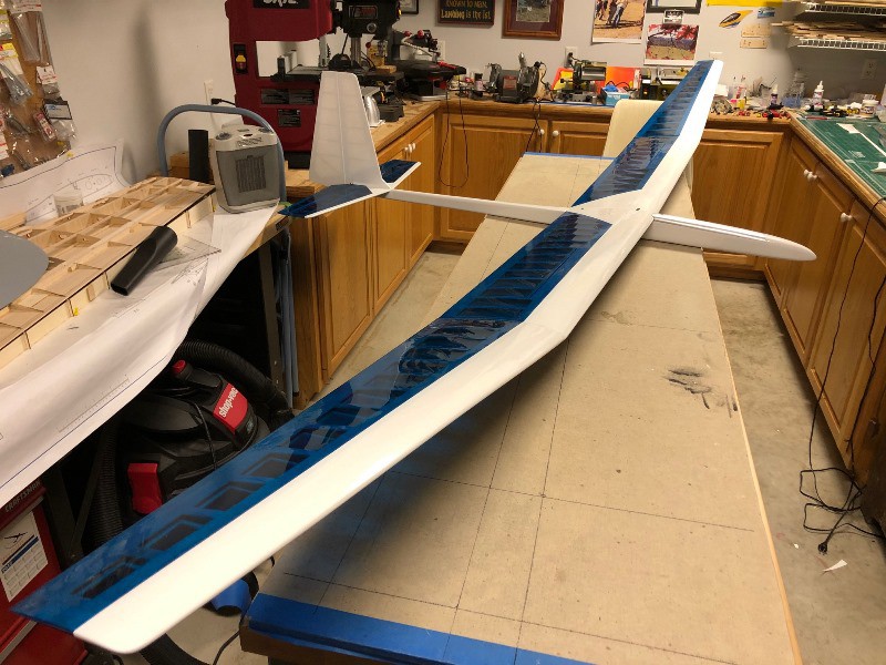

    After working on the kit off and on over the last year, we finished it on Saturday! Ours came in at 56 ounces ready to fly (required 8 oz. of nose weight to balance). Covering is UltraCote White and Transparent Blue.

    Wow Jim! Looks good!
      your covering skill are amazing jim..

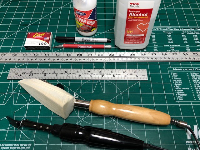

          Covering secrets revealed...
          • Sharp #11 blades/knife
          • Quality metal straight edge(s)
          • Sharpie marker (extra fine point)
          • Isopropyl alcohol (to remove sharpie marks)
          • Deluxe Materials Cover Grip
          • Covering iron with sock
          • Covering trim seal iron
          • Quality cutting mat

                Jim, I have never heard of Cover Grip before. I see it is used to help adhere covering to balsa,etc. Can you share how you use it when covering a model like the Foxbat?
                Larry
                  Cover Grip is avaiable from Horizon Hobby or any of its dealer network. It is water base with water cleanup and has no strong hazordous odor.
                  I thin it with a little water to the consistency of skim milk, then paint it on using a very small brush (1/4" wide Testors brush works great). A little bit goes a long way and it applies very quickly. It is applied around the perimeter of the area to be covered. The point is two fold, first to seal the wood surface and second to form a stronger bond between the wood surface and the covering adhesive. Let it dry completely and very lightly sand to remove wood fiber stubble that sticks out.
                  The adhesive back on Ultracote will stay "sticky" for some time after heat is removed. This is both good and bad. The good is the ability to move the covering slightly by dragging the covering iron over it. This helps remove wrinkles and puckers. The bad is unwanted edge movement can occur allowing the covering to sag and develop edge lift. Cover Grip helps make a stronger bond that keeps the edges stuck tight while the body of covering is heated to shrink it.
                  It seems to help minimize changes in covering going from cold to hot and back as seasons change. Covering seems to stay put and stay tight. Hope this helps.

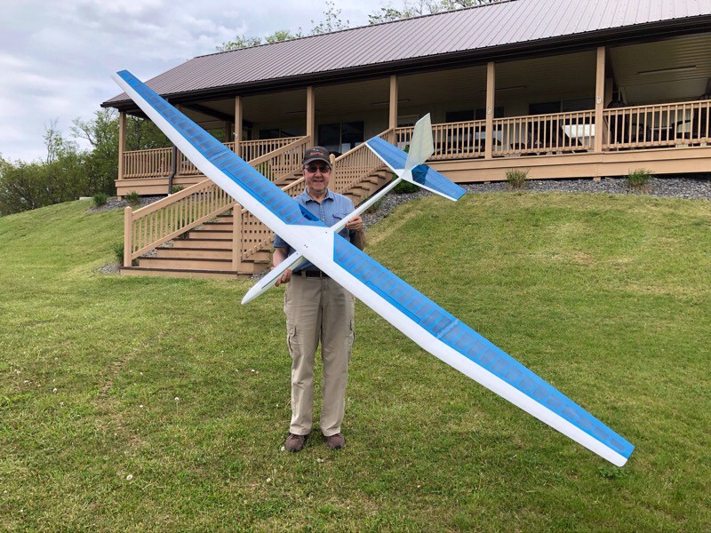

                    After weeks of cold, wet, or windy weather, we finally got the perfect maiden flight conditions. The Foxbat was launched using a high-start and, like all of the other PGD kits I've built, flew straight and true on the launch. Flight was stable and predictable and landing was light as a feather. Another successful kit build completed!

                      Another fine model from Dr. Jim 'BM' Dolly! (BM = Building Machine)
                    Many congratulate again Jim, looks great! Looking forward to seeing it fly first hand in July!
                      Really looks nice Jim.
                        Wow, that's really beautiful! Good job...
