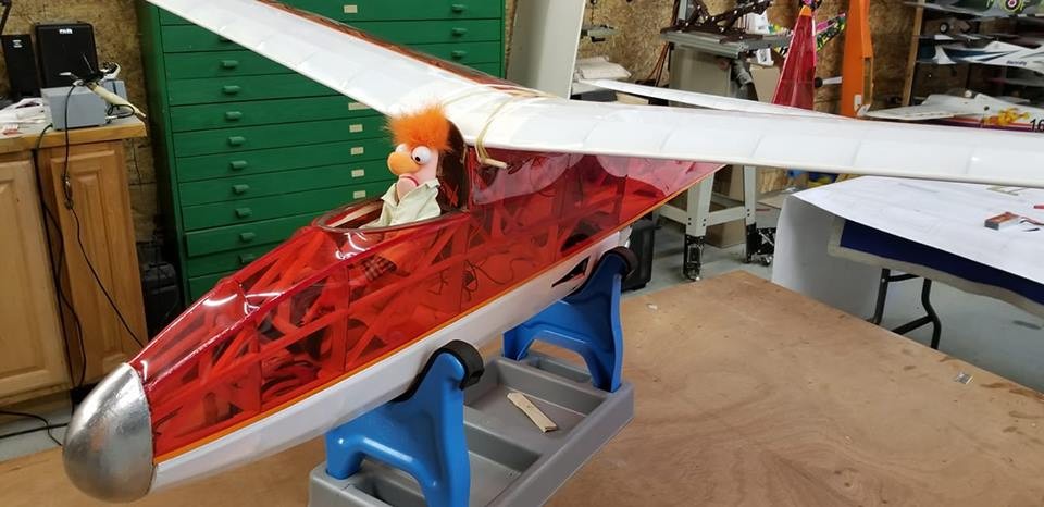

        I couldn't help myself, I had to put a bitchin' jet pilot dude in the cockpit!

          Nice Congrats on the maiden! I went a different route with my pilot
          Click image for larger version  Name:	image_12318.jpg Views:	1 Size:	94.1 KB ID:	31926
