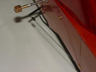

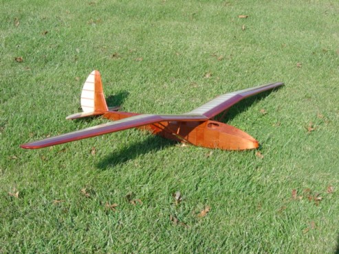

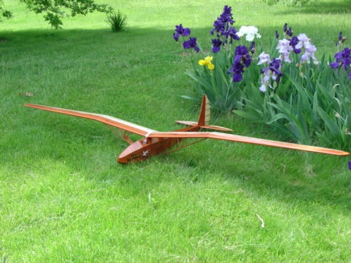

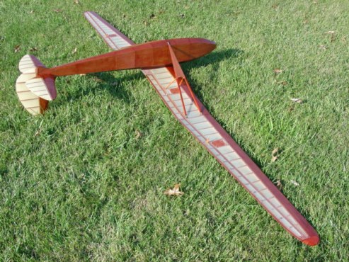

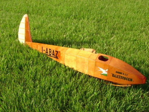

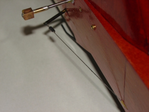

    More, more, more.... who-wah-hah-hah-hah-hahhhhhhh! This is the model without tail skid installed or graphics painted. I forgot to include a photo if the nice and tidy pull-pull cable on the rudder horn. All adjustment is inside the fuselage. Note the square drive on the elevator 'horn'. It engages the square tube receiver on the elevator when plugging the stabs onto fuselage. Orange lollipop?

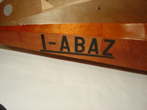

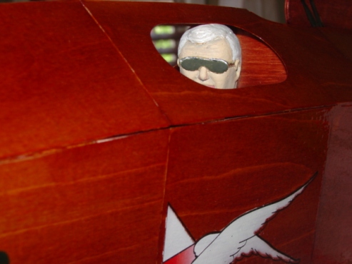

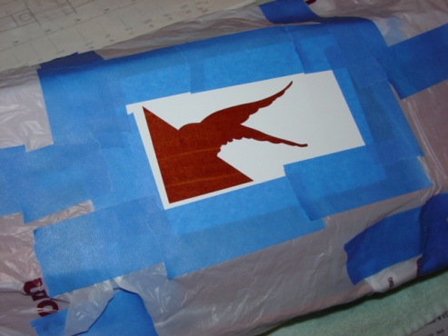

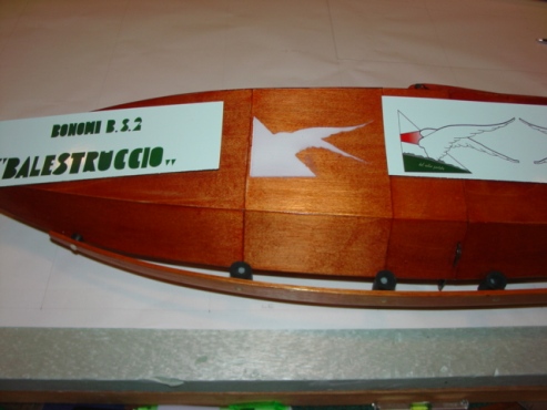

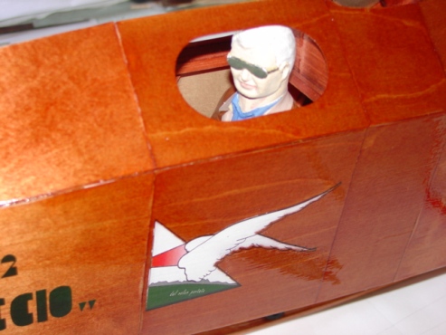

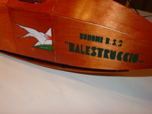

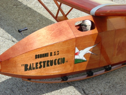

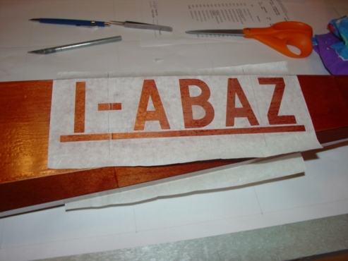

      Gary Sibert of 'Pink-It.net' provided 'winged emblem' and 'Balestruccio' stencils and decals. I made stencils for the I-ABAZ on fuselage. The pilot was made to resemble my friend, Vincenzo Pedrielli, whose book, input, 'winged emblem' details and generosity with his time when answering my many questions about the full scale 'Balestruccio' and its construction was so readily forthcoming. Thank you, Vincenzo!

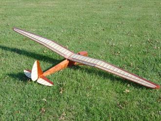

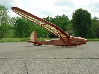

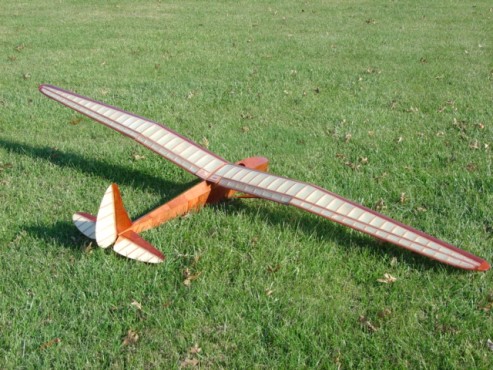

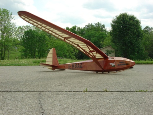

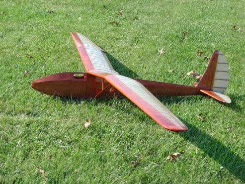

        Here's Vincenzo! I made a wing gap cover from lithoplate. There is a block let into one wing to receive the gap cover retaining screw. Here are some beauty shots. Many thanks to Len B. for the maiden test flight. Thanks again, Len! How many types of aircraft do you have in your log book now? lol I'll get some pics of it flying once I figure how to move some files around.

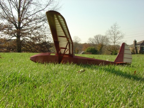

          Andy Grose took some great pictures of the 'Balestruccio' flying at Epp's Field near Huntsville, AL. The maiden was by Len B. at the Horizon Hobby Aerotow 2014(?) I 'dinked' it landing at Clover Creek last year. It's repairable but not without some valiant effort. Bummer. Of course I'm biased but it sure is a pretty thing on the wing!
