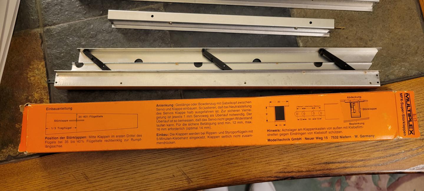

        How do you figure out what size air brakes to get? I can’t seem to find dimensioned drawings
          Old Multiplex spoiler box had some information. Unless you want to build them, you are stuck with stock sizes, e.g. 300mm, 370mm, etc. Click image for larger version
