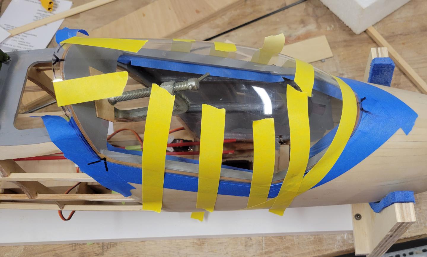

    Glue canopy to the frame with E6000 thinned with xylol. Then wait......
    Actually I did something useful while waiting. Put a new battery in the sailplane carrier (van). Over 6 years isn't too bad. Click image for larger version

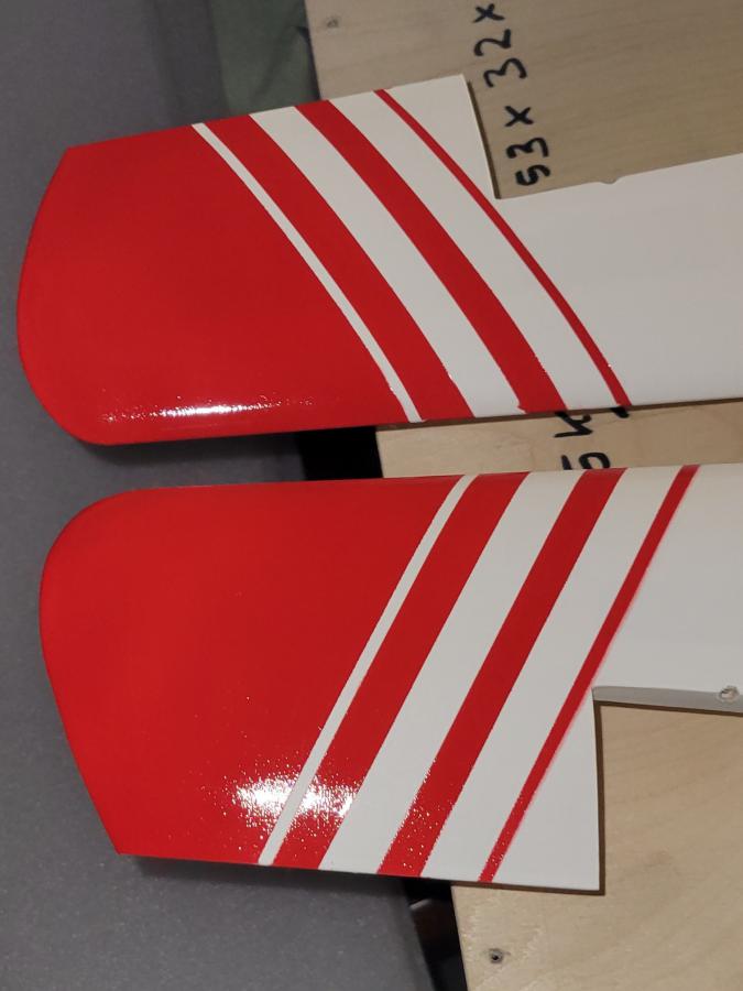

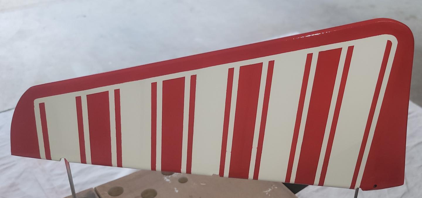

      It was warm enough today to do some painting. I need another day for the rudder....
      • #48
        Some painting done. I should be able to do hinging tomorrow.

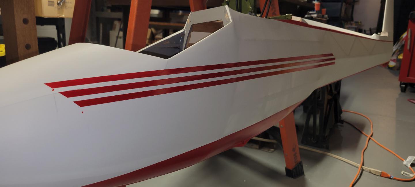

ID:	47626 Crazy Rudder mask
ID:	47628 Fuse stripes.

          • #50

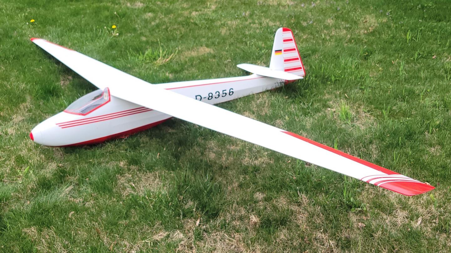

            Looks good, I have never been good at coming up with trim schemes.
            • mlachow
              mlachow commented
              It is sort of like the real D-8356. I did not find any pictures to really get the tip stripes and I messed up the fin layout a little on spacing. And fuse numbers should have been a little bigger. But those were older photos, I think D-8356 is being recovered. There are a few other III's that have interesting color schemes. I picked this one partly because I was trying Oratex and it was mostly white with enough red to help with visibility. I also expect it to be more of a morning and evening flyer in the fleet so I am not worried about visibility at higher altitudes for a smaller 4m model. The best place for finding some interesting colors is to search facebook. You can search for the sailplane name and if you find one interesting photo with a number on it, search for the number.
