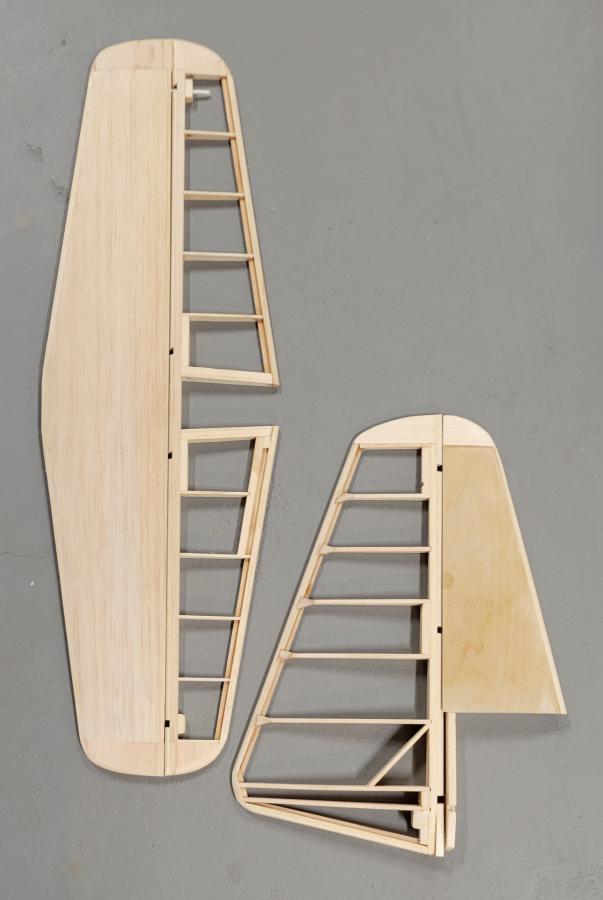

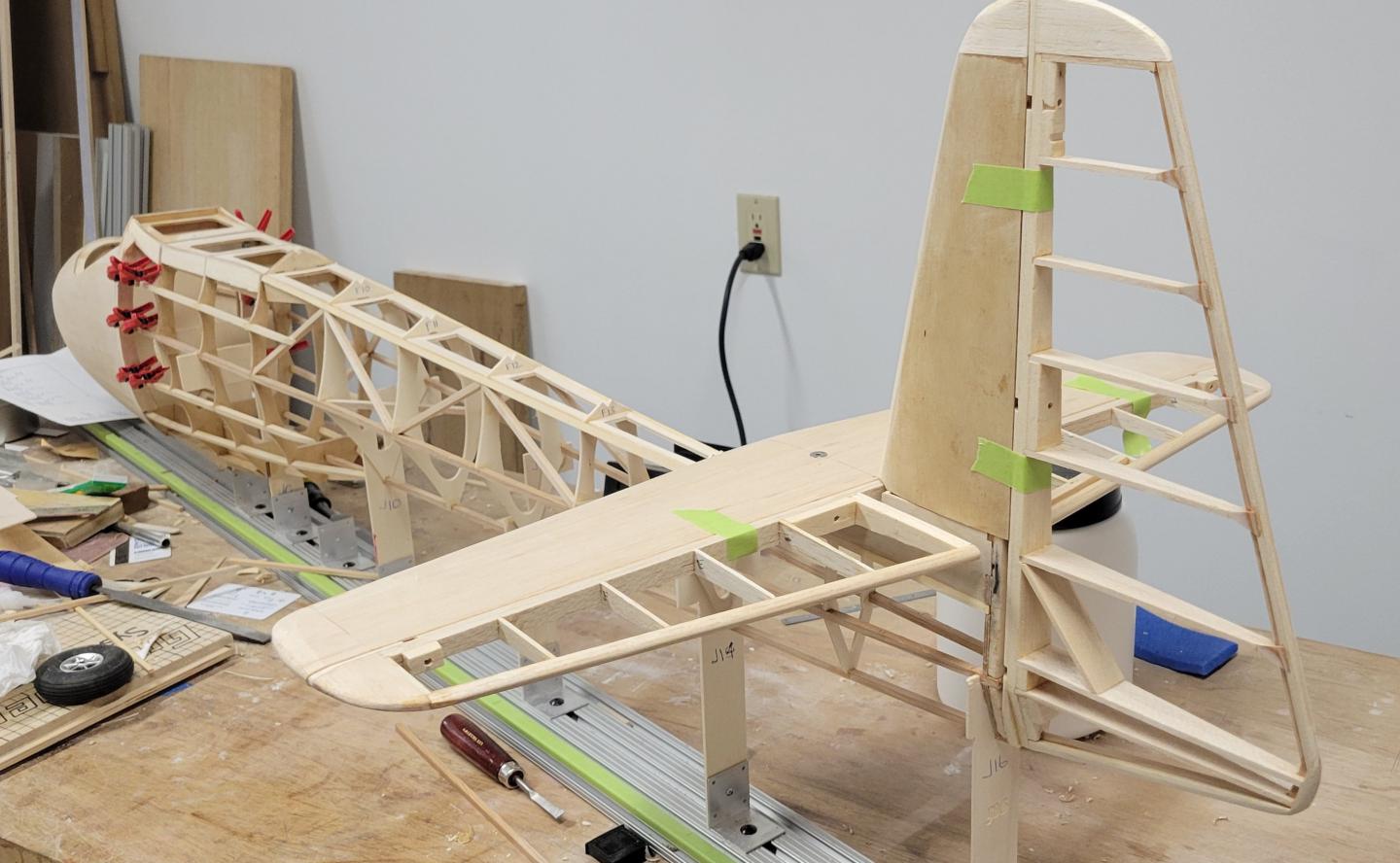

    Next up is the elevator. It is pretty simple. I will have to make a control horn to attach to the elevator in the middle. The tips were added to the stab. And the front, rounded part of the rudder has been added. The elevator trim tab still has to be cut in and added.
Name:	Tail Parts.jpg

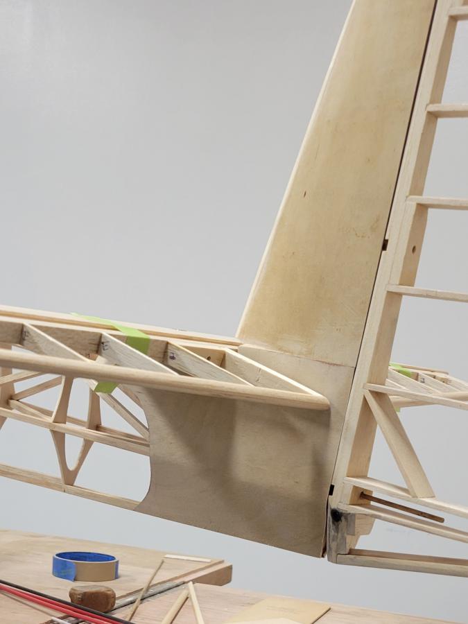

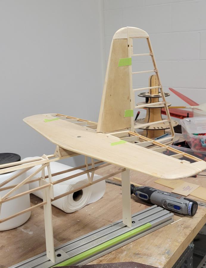

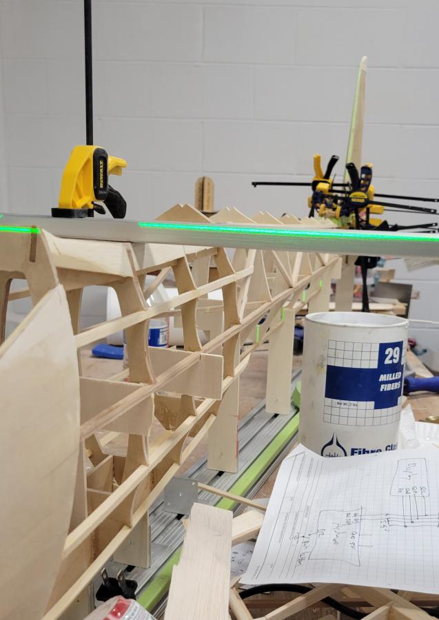

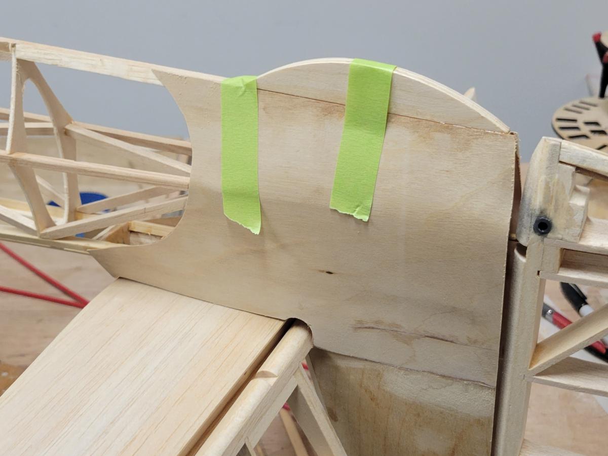

      Attaching the fin to the fuselage and build up stab mount. The rudder post was glued to the fuselage first. Time to get out the three-axis laser tor alignment. The fuselage is open so you can also see the light shining down between all the stations in the tail boom. The fin was still tilted a little forward but that is the next step.
Name:	Zug Add Fin (2).jpg

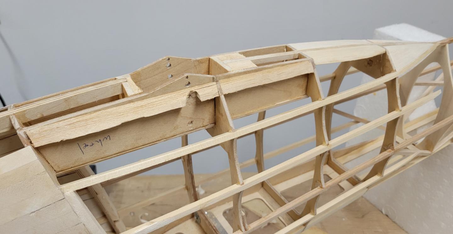

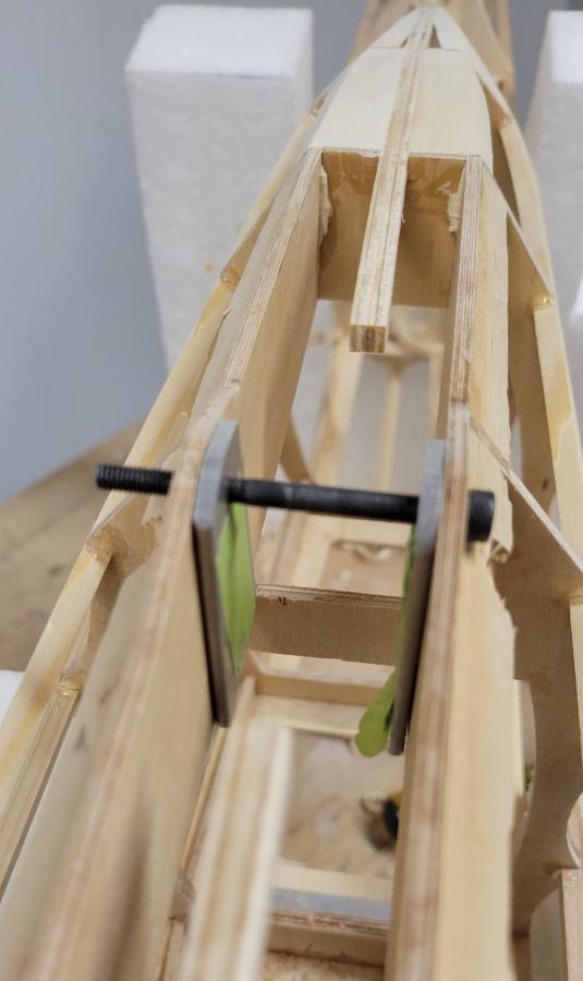

        I added a few extra blocks of balsa below the bolt plate for the stabilizer. After gluing in these pieces, the ply bolt plate was added on top.
Name:	Zug Stab Mount (2).jpg

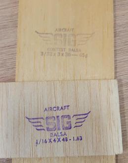

        A little vintage balsa going into a vintage sailplane.
Name:	Vintage Balsa.jpg
        The 1/16x4 is from around 1977

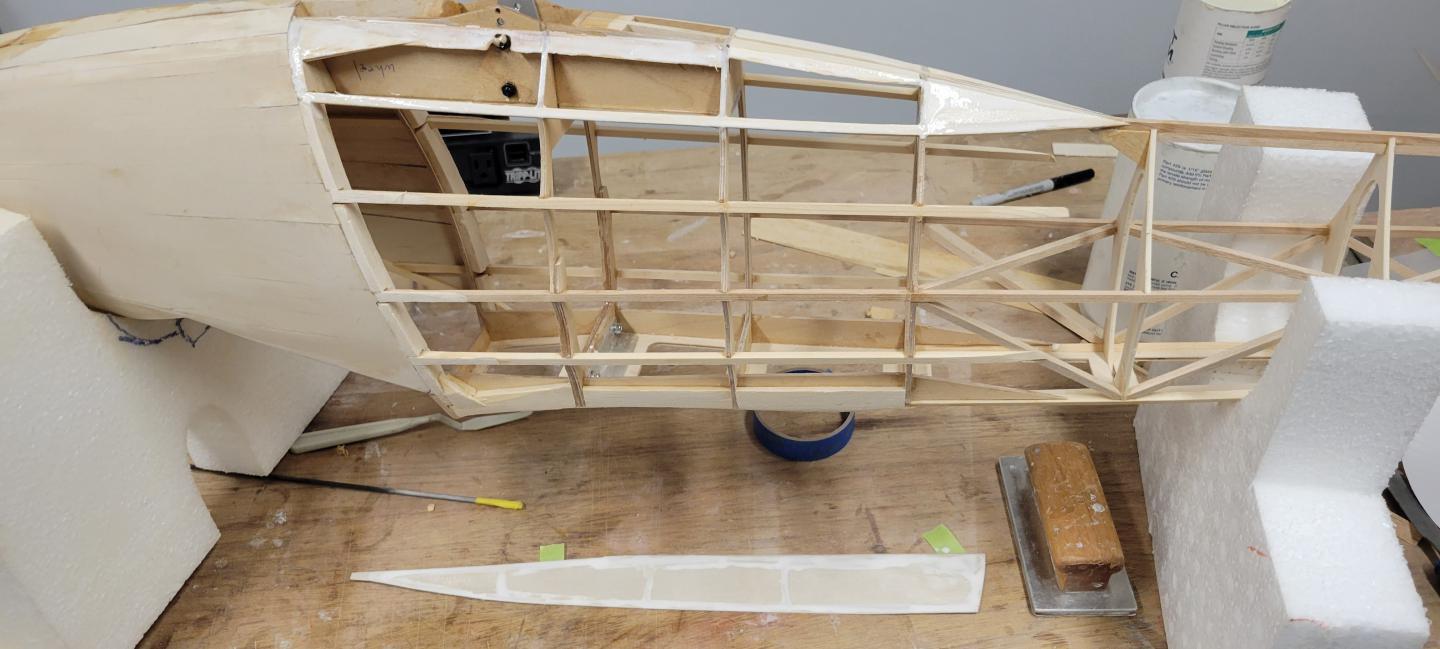

          The fuselage is off the fixture so now I can finish up work on the bottom near the front. The landing gear box needed a little work. I made some aluminum brackets to help out the 1/8 ply holding the wheel. It's a recycled Halco landing gear I cut up since the thickness was perfect Two M4 screws hold these to the ply box. Another long M4 goes through it all as the axel. A 50mm screw has just the right unthreaded length to make a nice axle.
Name:	Zug Landing Gear (1).jpg
ID:	46883 Click image for larger version
Name:	Zug Landing Gear (2).jpg

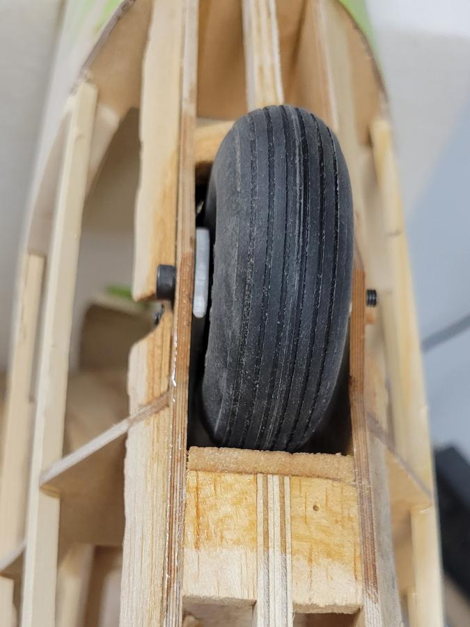

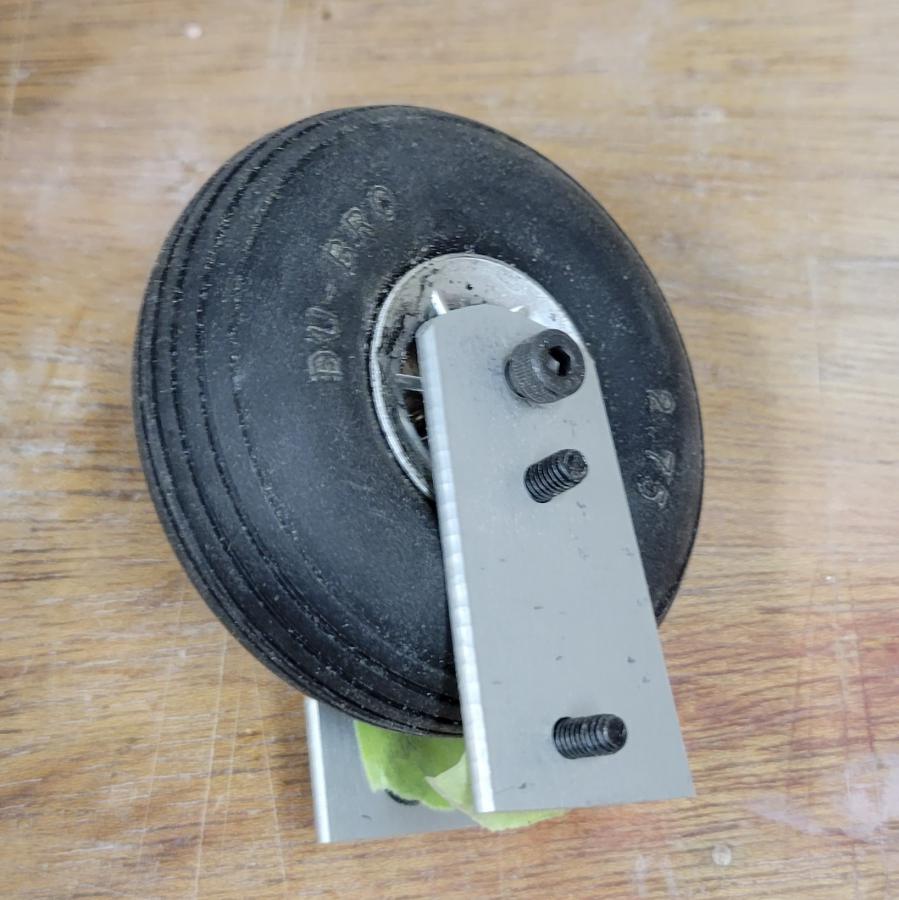

            Now all the wheel hardware gets installed. Everything fits, the wheel rolls and there is not a lot of play. One side of the gear mount is threaded. The bolt will get threaded in there and then another nut will get added to the end of the bolt to lock the axle in place.
Name:	Zug Wheel.jpg

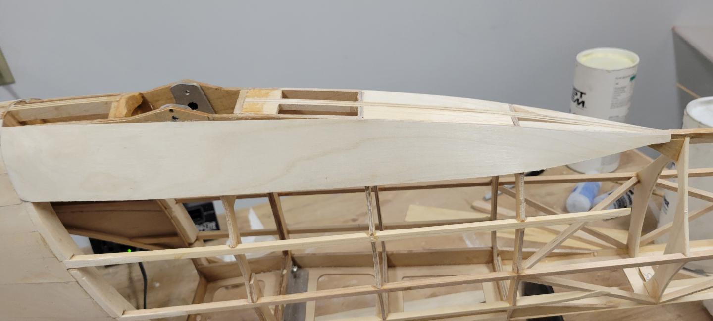

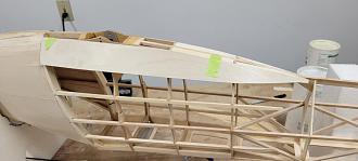

            Time to finish up more of the front sheeting. The remaining strips were glued to the bottom of the nose area. Now the entire front is planked with 1.5mm plywood. The gear box area gets covered in 0.8mm plywood. The sides are real easy, almost flat except right at the front. I started with a strip and then marked the top and bottom towards the tail to cut it down to shape.
Name:	Zug Lower Sheeting (3).jpg

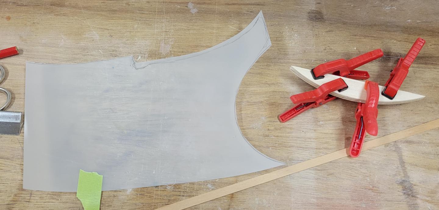

              I used some drafting mylar to trace the area for the sheeting in the back. The tail skid is just a simple outline, simple and light weight. The simple outline is what is printed in Martin Simons 3-vew drawing. Pictures I have collected from the Internet have other variations.

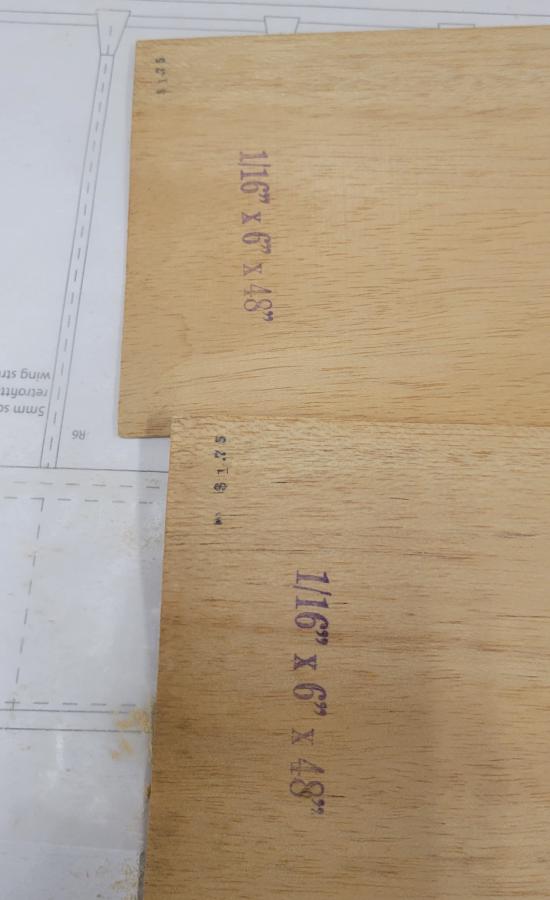

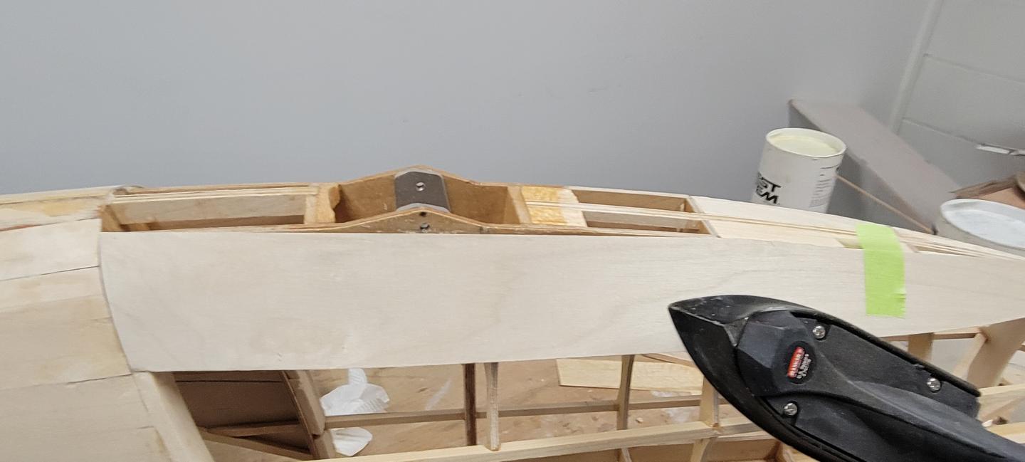

              The tail sheeting was ironed on. Plans call for 0.60mm ply but I haven't found any sources for that in the US. I am just using 0.40mm, 1/64 ply
Name:	Zug Tail Area (1).jpg

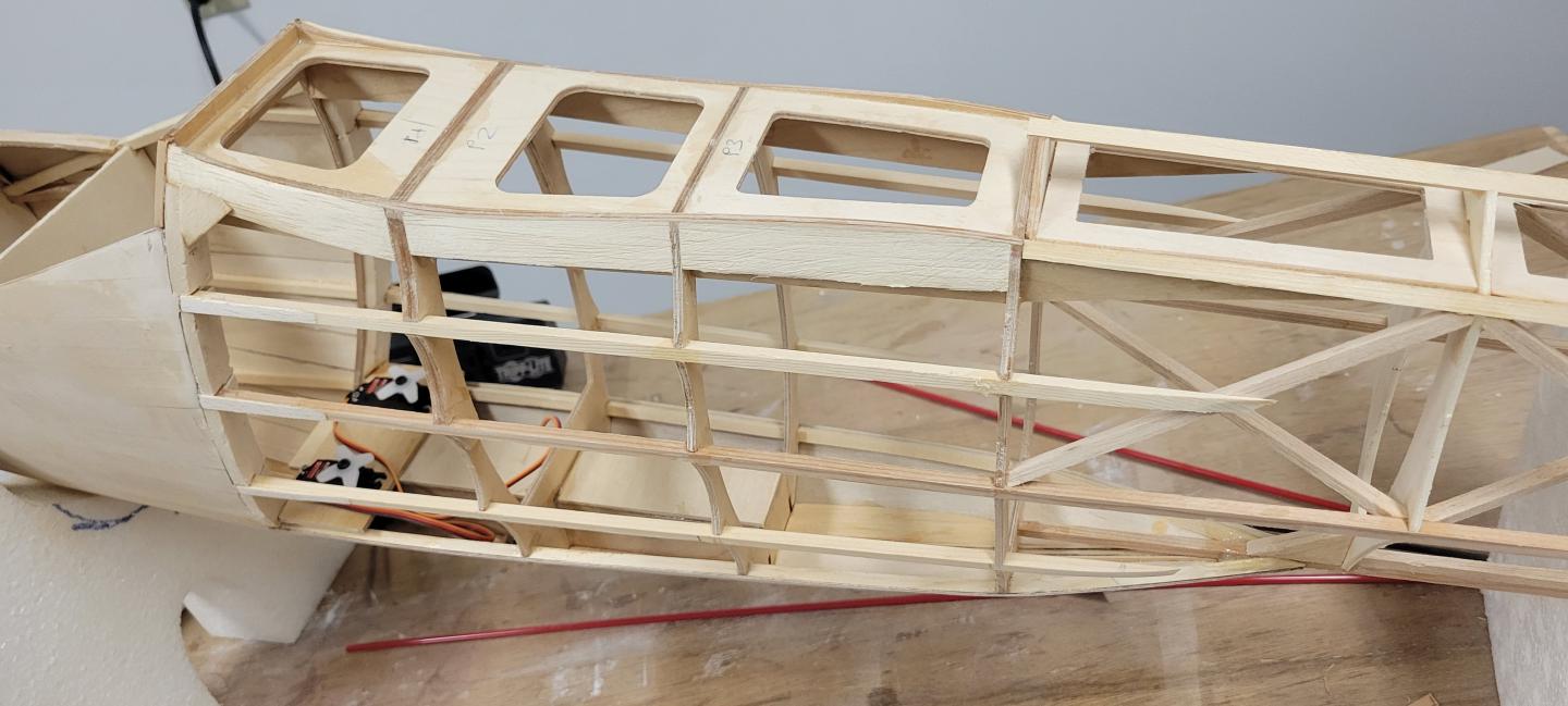

              The servo tray is installed up font down low.
Name:	Zug Tail Area (4).jpg

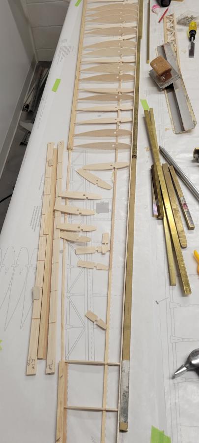

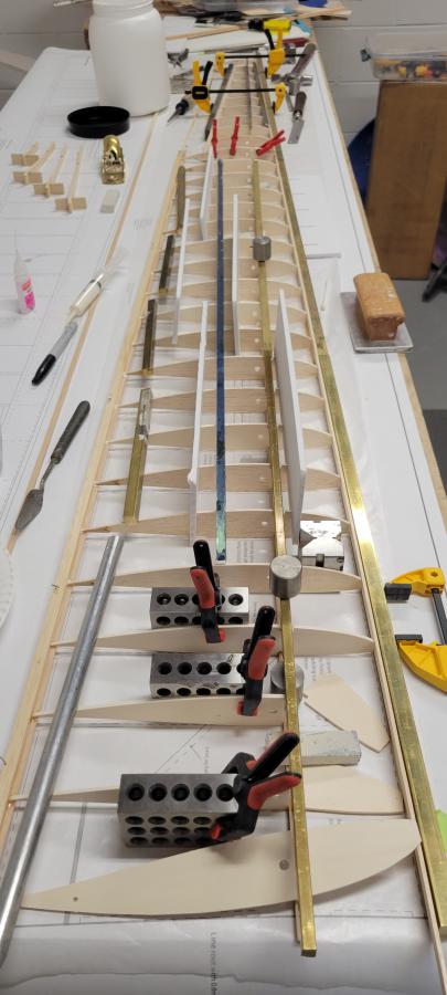

                The workbench was cleared and cleaned up. A few glue spots to remove to get the bench ready. I had to do minor tweaks make sure the bench was level before starting the wing. Nothing worse than a bench that is not quite true.

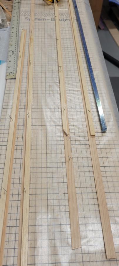

                The spar is long. I had some spruce that was almost long enough, but it still needed a little splicing. The spar also thins out on the last two bays since the ribs are so thin out there.
                I also laminated the trailing edge. It is 1.5mm spruce with a balsa strip added on top. Two TE strips and two shorter strips for the ailerons.
Name:	Zug Wing Prep (3).jpg

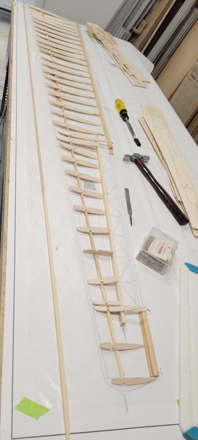

                The ribs were all checked and sanded to get them ready for the build. I used the LE of the ribs to precut the sub-leading edge strip close to size.
Name:	Zug Wing Prep (2).jpg

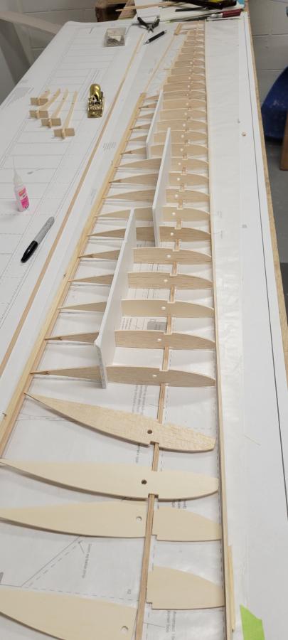

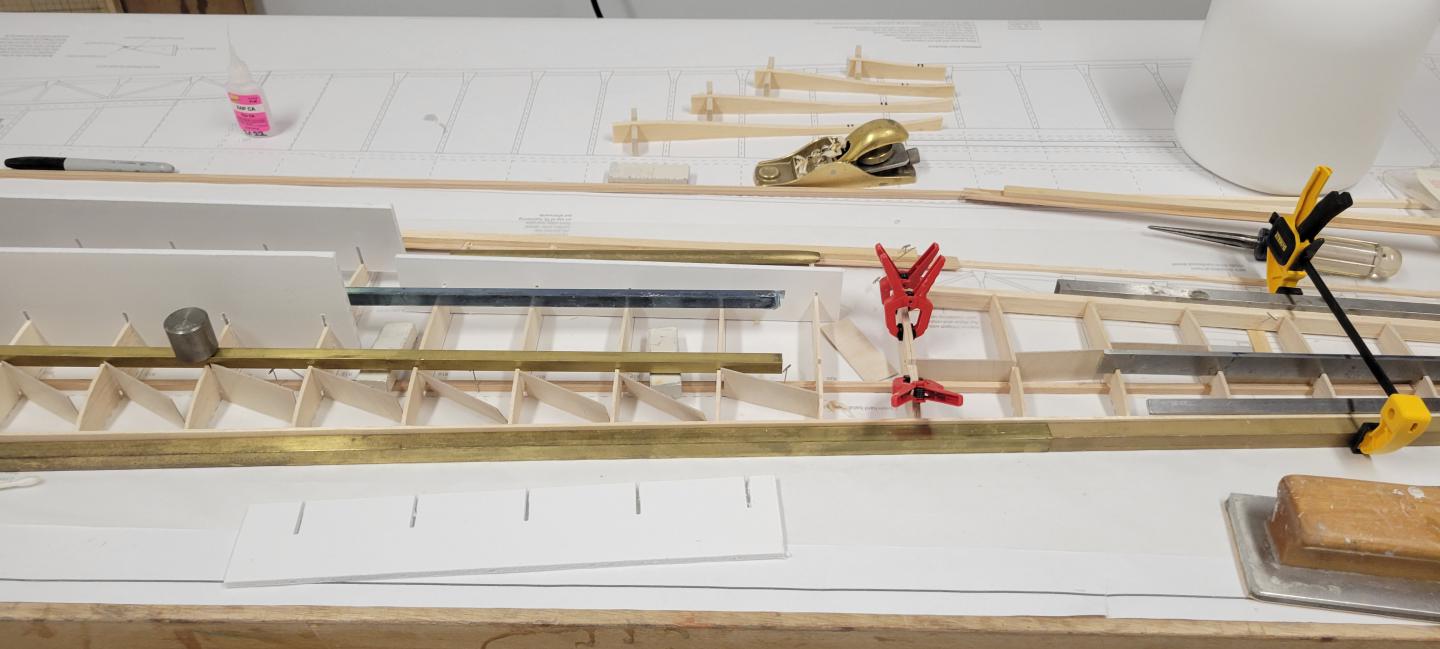

                I used some foam board and cut slots in the foam board at the rib spacing interval. This will help line things up quickly when gluing up the wing ribs. I also made a shim for the trailing edge. This way the spar sits flat on the building board and the TE is close to where it needs to be. There are four wing alignment jigs sitting on the bench. They get used later when the top sheeting is installed to lock in the proper wing alignment along the full span.
Name:	Zug Wing Prep (1).jpg

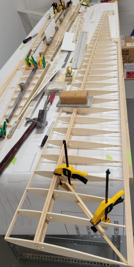

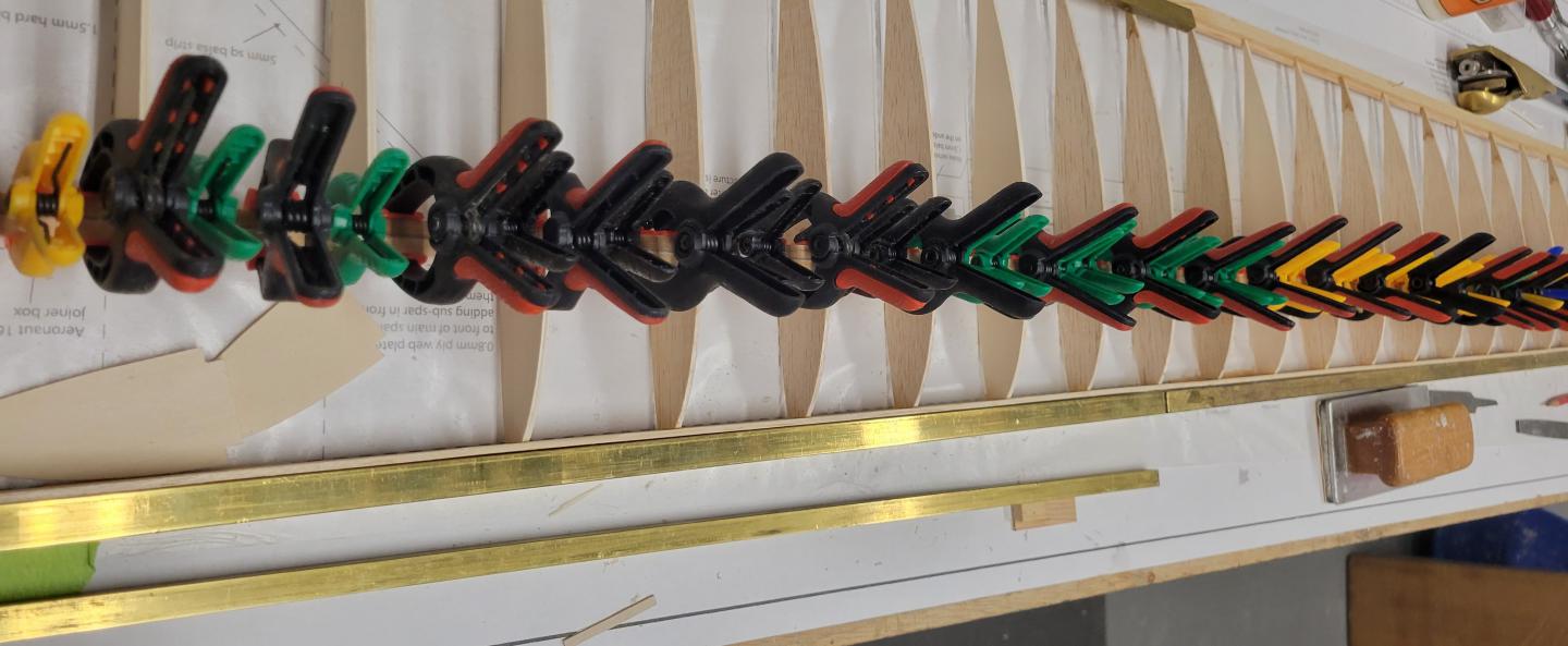

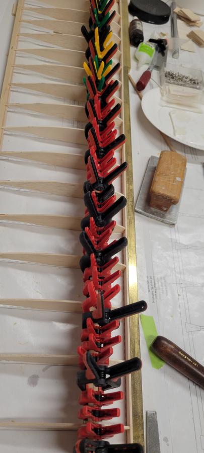

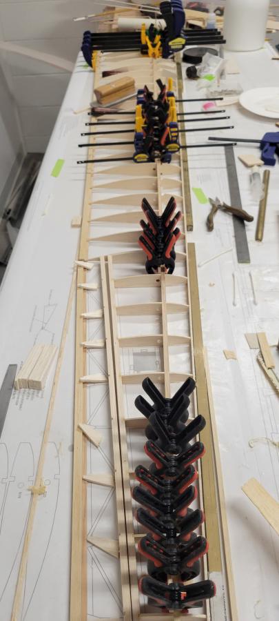

                Time for some glue and clamps. Lots of clamps.
                  I glue ribs in groups with the alignment guides. They hold the ribs nicely while applying glue. The ribs are glued to the trailing edge and the spar. I have a good collection of steel and brass strips. Great for holding things down and all in a straight line. I precut all the webs with the router. They are just sitting there for later use. The ribs at each end of the aileron are doubled. The TE of the wing in the aileron area also had notches precut for alignment.
Name:	Zug Wing Glue 1 (1).jpg
                  Some of the center plywood ribs were glued with epoxy. The joiner goes between the spar so those ribs are cut in two pieces.. You can also see the holes for the servo wires, predrilled. The sub LE is not yet glued. It has a few shims glued to it and it is just held against the ribs by the brass bar.

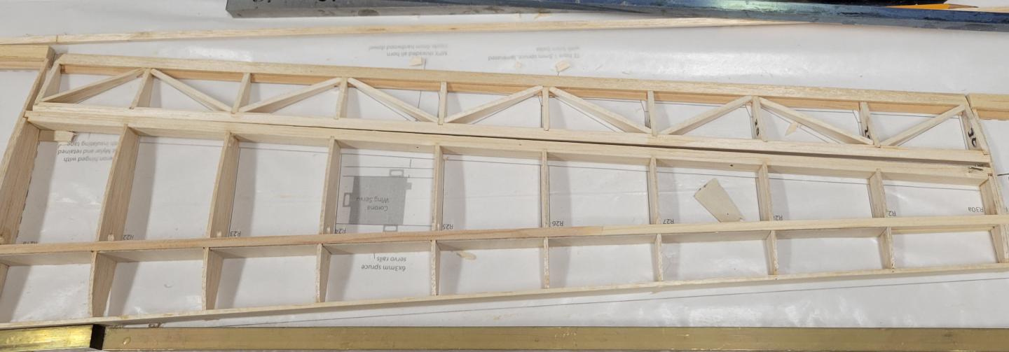

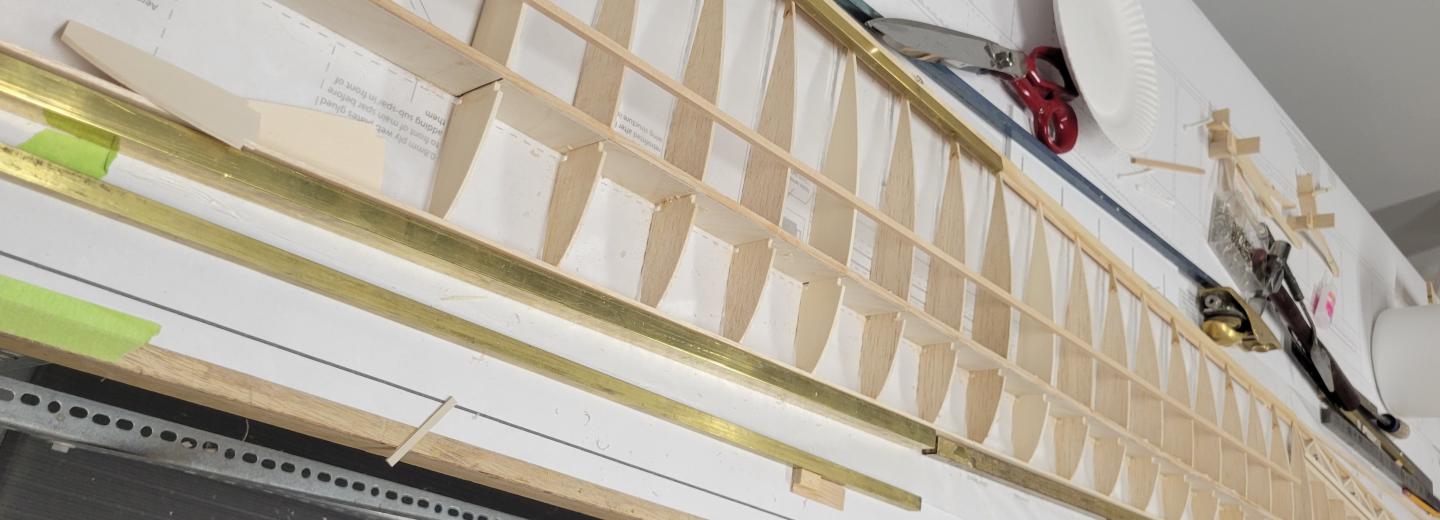

                  After the glue dries on the bottom spar, the top spar is glued in and the sub LE is glued in place. Now all the webs can start being glued in place. Sometimes I use bar clamps, other times I use some cauls and spring clamps.
Name:	Zug Wing Glue 2.jpg

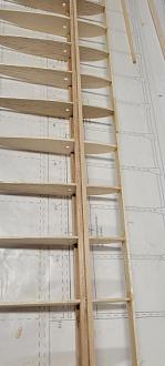

                    I didn't post everything last night. After the webs are all glued in, an additional 5mm sq spar is added in front of the web for the center part of the wing. You get a nice I beam. The recommended construction method was to glue in the first spar and web, then cut in the ribs for the second spar. I just cut a wider rib slot and made sure the rib was against the back of the slot. I also used q-tips to make sure no excess glue was in the rest of the slot. Only a little bit of cleanup with a file was required to fit the spar. A lot of the other work done today is dry but I want to wait overnight until removing it from the board. That way the glue is really dry and the epoxy is fully cured.
Name:	Zug Wing Double Spar (2).jpg

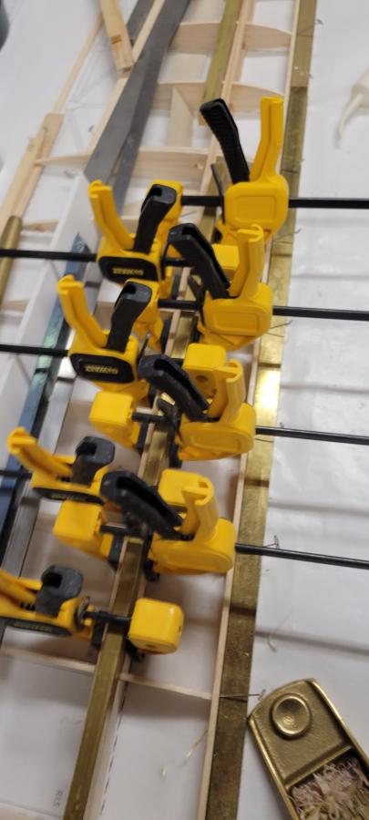

                    After gluing, get out a lot of clamps.
Name:	Zug Wing Double Spar (1).jpg

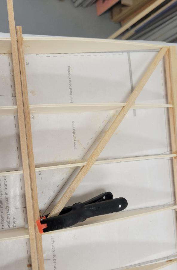

                      There are also a few spars to cut in. One on a diagonal near the root for the end of the sheeting.
                      Click image for larger version  Name:	Zug Wing Cut Ins (2).jpg Views:	0 Size:	43.5 KB ID:	46923

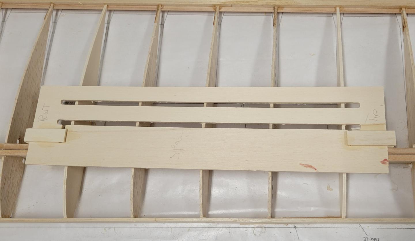

                      The other will be for the spoilers. These need to be cut on both wings on both the top and the bottom. I made a template to guide the cutting.
                      Click image for larger version  Name:	Zug Wing Cut Ins (1).jpg Views:	0 Size:	85.5 KB ID:	46924

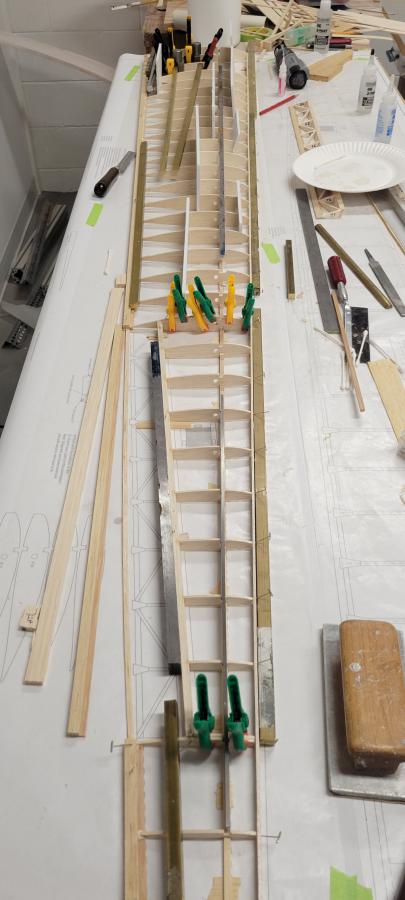

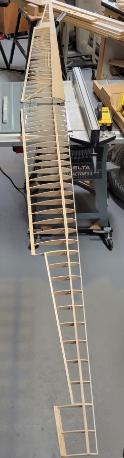

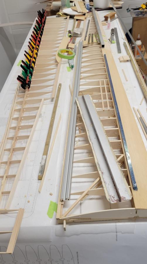

                        Time to start the second wing panel. Same thing over again, sand all the ribs and webs. Splice the spars. Glue...... Stopping for the day just before starting all the webs.
Name:	Zug Wing 2 (3).jpg
ID:	46928 Click image for larger version
Name:	Zug Wing 2 (4).jpg
ID:	46929 Click image for larger version
Name:	Zug Wing 2 (2).jpg

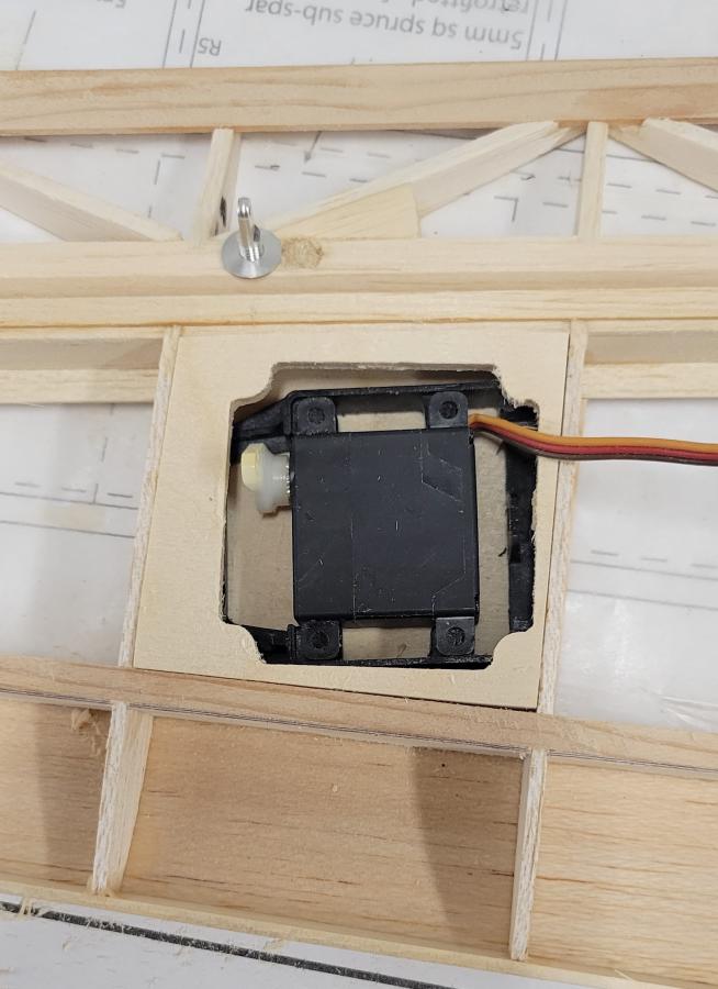

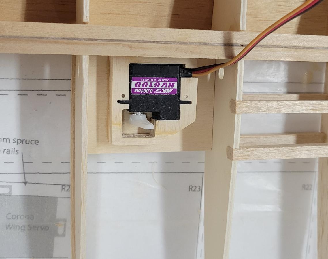

                            Both wings now have sheeting on one side now. I worked on some other wing details before final sheeting. The servo mounts for the ailerons were glued in.
Name:	Zug Wing Servos (2).jpg

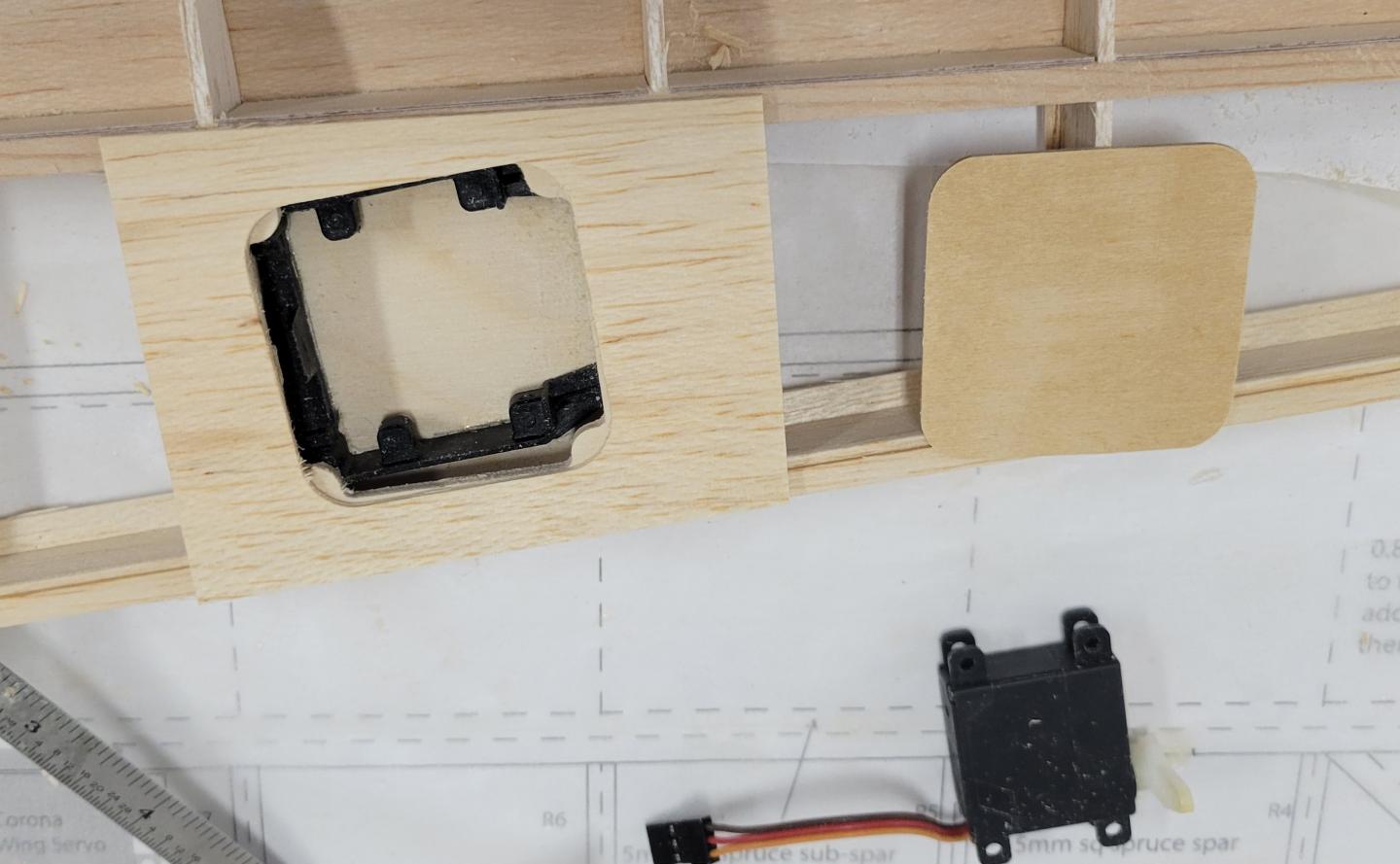

                            I also cut some balsa sheet with a nice hole and servo covers to screw on the wing.
Name:	Zug Wing Servos (1).jpg

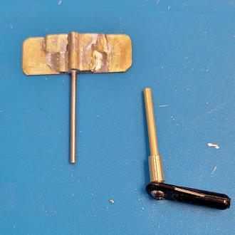

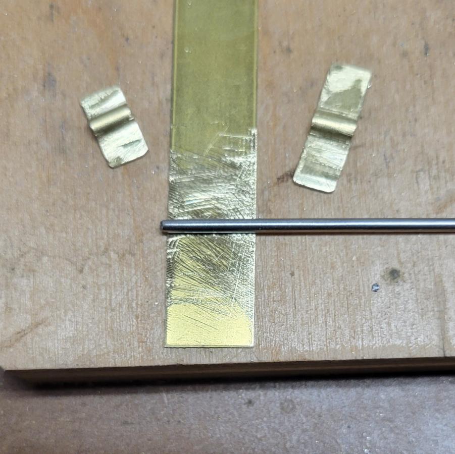

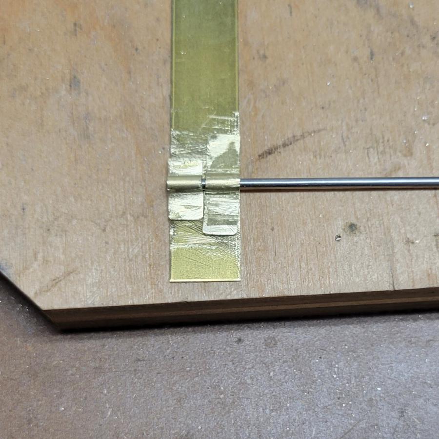

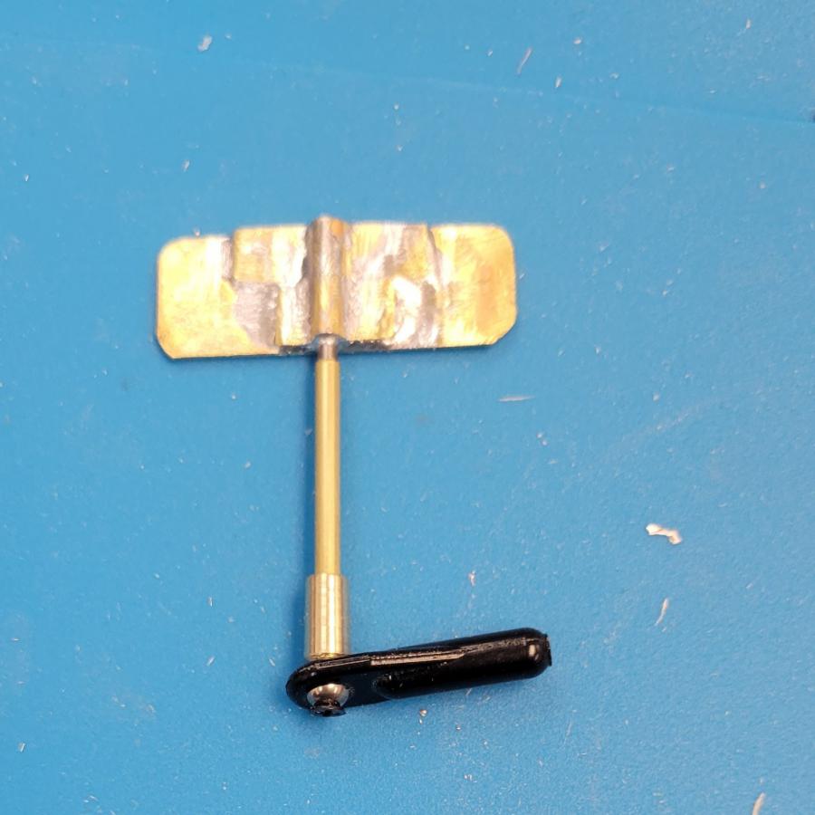

                              The elevator linkage will be a cross between the setup Chris Williams uses and a Pike Perfection. I used some brass sheet and made two straps so I could solder some music wire as the control horn. The elevator is one piece and this will be bolted to the cross piece. The linkage will end up inside the fuselage.
                              I put the big 4mm tip on the Hakko iron and got out the flux pen. No problem tinning the wire and the solder flowed nicely under the straps and even from the wire to under the straps.
Name:	Zug Elev Horn (4).jpg
ID:	46944 Click image for larger version
Name:	Zug Elev Horn (1).jpg
                              Cleaning up a little and you get a nice horn. I might need to bend a little angle in the wire.
Name:	Zug Elev Horn (2).jpg
                              The second piece is a length of brass tubing and a little piece of brass I machined to accept the tube on the one end. The other end is tapped for a M2 screw to hold on the ball link. The pushrod will need a support guide under it near the elevator. The elevator horn just slides into the brass tubing when the tail is installed. I will need to trim the wire length a little and the ball link i the photo is sitting 90 to the real pushrod direction since it is just flat on the soldering pad.
Name:	Zug Elev Horn (3).jpg
