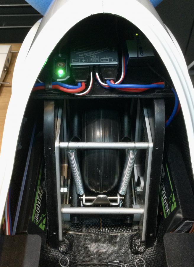

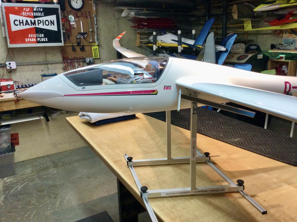

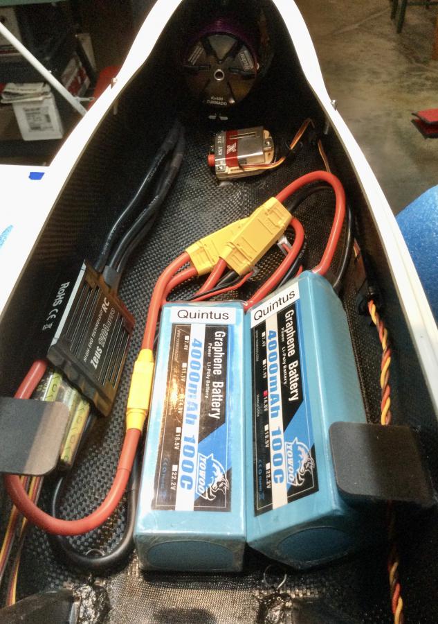

Still doing some deciding on where I want to place things. Powerbox Pioneer + 2x 2200 mAh receiver packs up over the retract to give more flexibility to where everything goes down below under the seat pan, or the two 4000 mAh flight packs. In either case, a more structurally sound shelf will be a nice add.

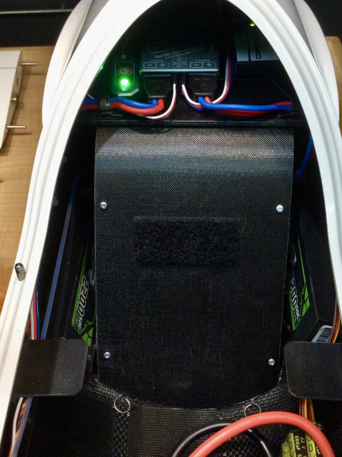

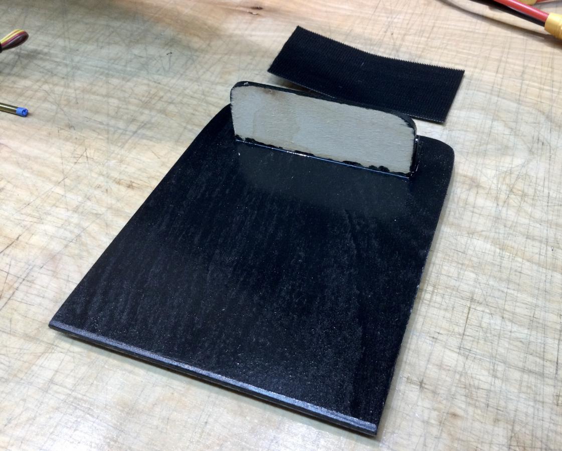

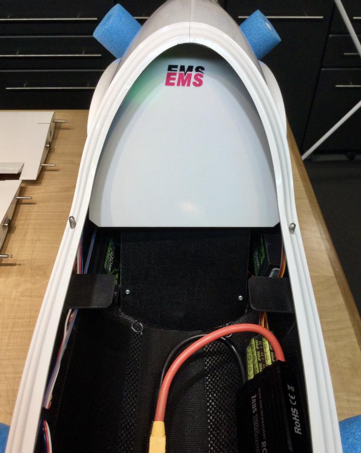

The shelf now sealed since the bottom becomes part of the retract fender and has a strong back that will have heavy duty Velcro.

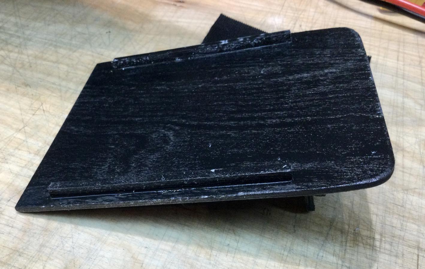

The bottom of the shelf has two alignment rails mostly to create greater glue area when it is epoxied to the top of the retract frame.
