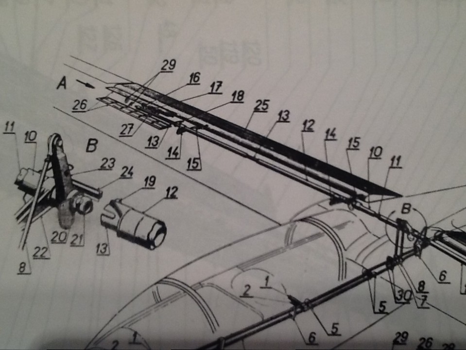

                Ive just been looking at your flower flap design details and have a question. I’m designing something similar and have decided I need a servo driving each end of the flap to avoid binding. Are you using two servos? If not, how does the design avoid binding caused by the potential for the two ends not moving exactly the same way?
                thanks

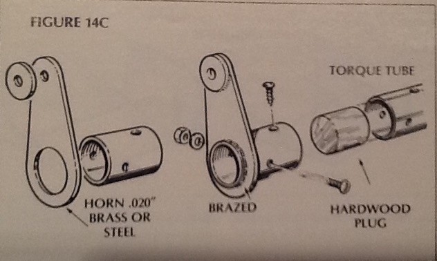

                  thank you for your inquiry... Very good question! Just like the full size Blanik, it has 2 motion transfer arms connected to a torsion tube. So, to answer your question, yes... you must have two pushrods, one at or near each end to avoid binding. It's easier to use two digital Hightec programmable servos so you can fine tune both ends and mid points of the servo travel with a programmer. Or you can use a "match box" device.
                  However..... It can be done with one servo.

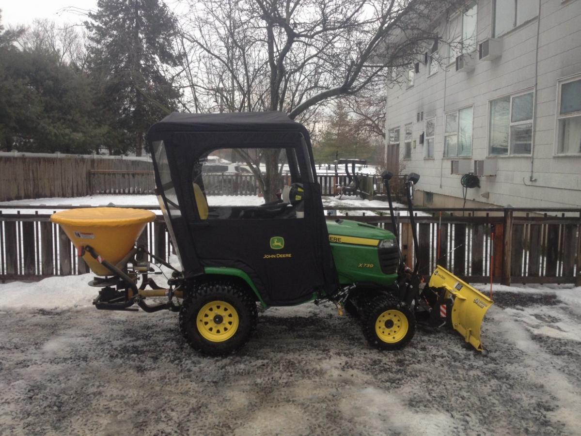

                        I guess I have to spill the beans... I'm very active in another forum!
                        Uhhh, a John Deere tractor forum. Been very very busy designing and fabricating new inventions. I'm up to 99 mods.

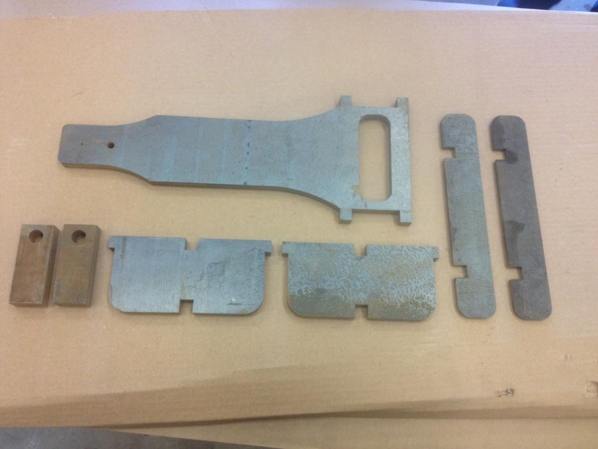

                        i like playing with waterjet cut 1/2" thick steel parts that I designed and watch them come together. Click image for larger version

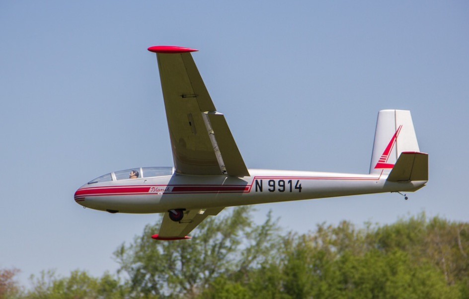

                            Gunny you're a master! Like the shot of the Blanik in the air. Is that full extension?
                            Mark
