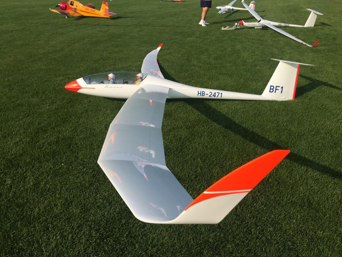

      Photo #1 settles a lot of questions.
