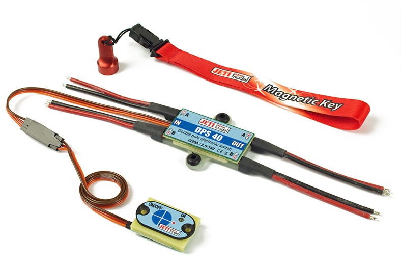

    Does anyone know if you can use a Magnetic type switch with the Specktrum Powersafe RX. In the instruction book that came with the RX it says other types of switches won't work with it
    Like the photo.....

    Nope,
    Wont work, tried it before.
      Thanks Len
        Do away with the switch....just install a charge jack receptacle on the side of the plane and use a bind plug. No moving parts. I have that installed on my Pegasus and on a Pawnee I'm assembling.
