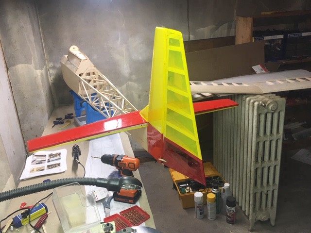

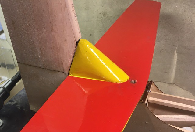

    I forgot about the stab/fin bridge (or w/e it's called ). So, I built it and covered it.

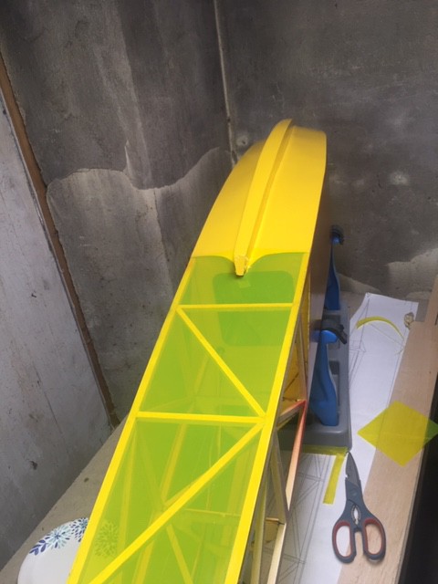

      Tail covered, fin installed.

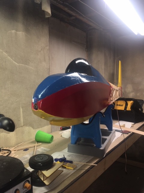

        I've been busy doing all the little things you have to do to finish a sailplane like this one. Today I have something I'd like to share. I've finished painting the front of the fuselage. It's been covered with fiberglass cloth and painted with spray paint. I really like the way it looks.
